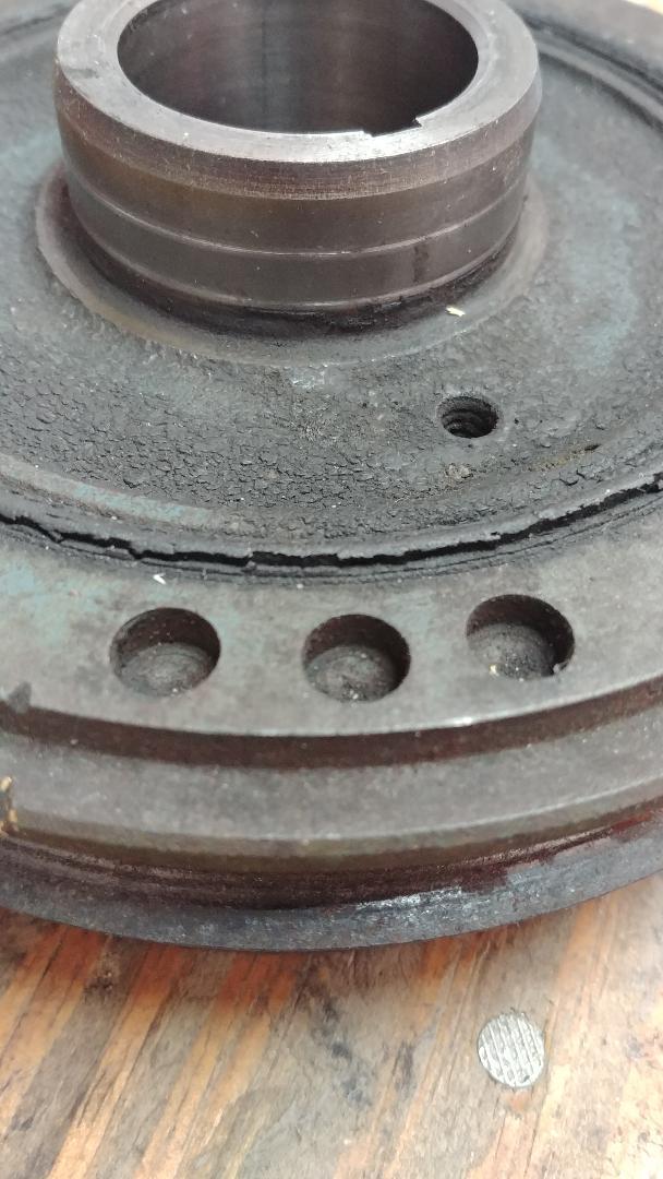

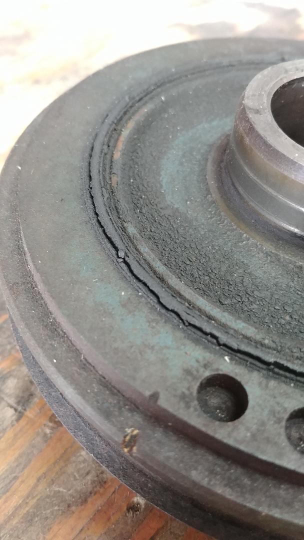

A few months back I had to replace my harmonic balancer on my 77 280z with an aftermarket one. I damaged my stock one reinstalling it after replacing a leaky front main. It's in my "Tackling 2 leaks, rad and front main" thread. Since then I have acquired a stock one from a 75. I would like your opinion on the condition of it from the pics I loaded. Do you think I should have it rebuilt due to the crack in the rubber? Also just noticed a groove in the snout. I measure 1.88 inches above and below the grove and 1.86 inside the groove. I'm thinking the groove isn't going to cause a problem but want your opinion. And not sure I should use it with the crack in the rubber. If you guys feel the same I'll send it off to be rebuilt. I'm not racing it. Just some spirited driving occasionally.
Thanks

The groove is on the outside of the "snout" for lack of proper name.
It might be called the "hub". it fits inside the front main seal. You can see it, it's a shinny groove.
I was thinking I would have to send it in for rebuild.

I had my stock balancer rebuilt and based on the condition of yours, I would do the same thing.  I used Dale Manufacturing, link below and the work was just as expected at a very reasonable price.  Regarding the grooves in the snout, a repair sleeve is what you need.  Any competent machine shot can install one for you to regain the stock spec.  I would look in to getting the sleeve done first before having it rebuilt.
http://www.hbrepair.com/
Thanks Hardway. I may end up looking for a good used one again. I'll know what to look for this time. Haven't decided yet though.
Edited by rcb280z
FYI, the sleeves are typically from SKF, Speedy Sleeve or Timkens Redi Sleeve, at least that's the only one's I've seen.
No, check that, I've also seen listing for these sleeves on RockAuto too. Point here is that they are easy to use and install yourselves. Don't be afraid to try.
