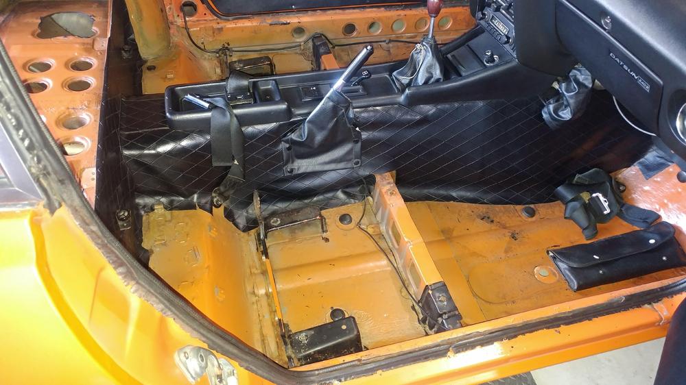

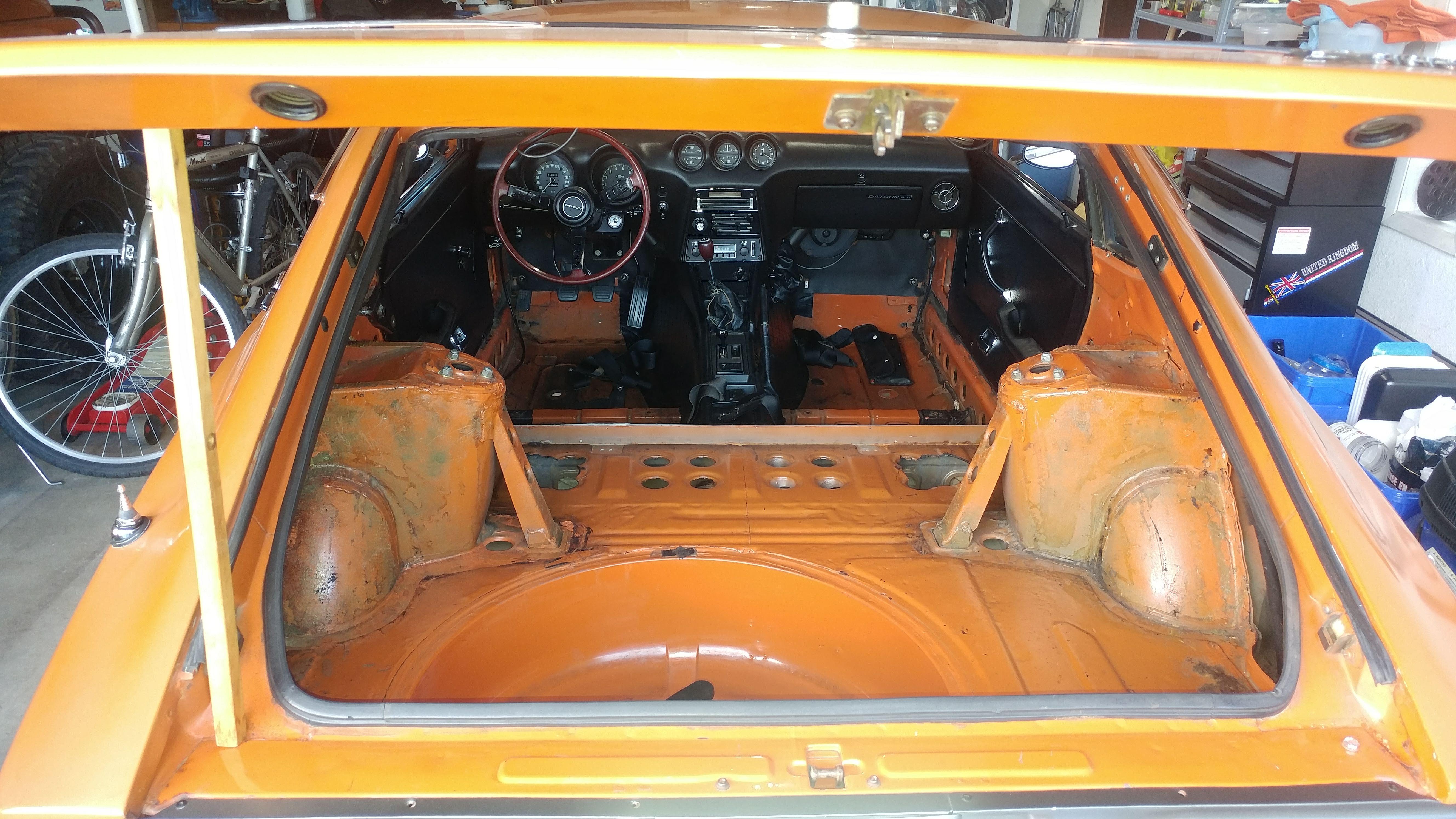

Step one will be removing most of the interior so that I can show the complete car to a few restoration shops before the major disassembly is started. The shops I have been talking with so far have a waiting list of about six months so I will have all winter to do the disassembly.

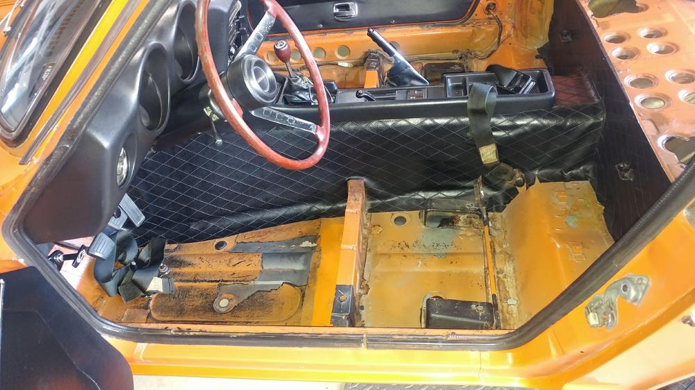

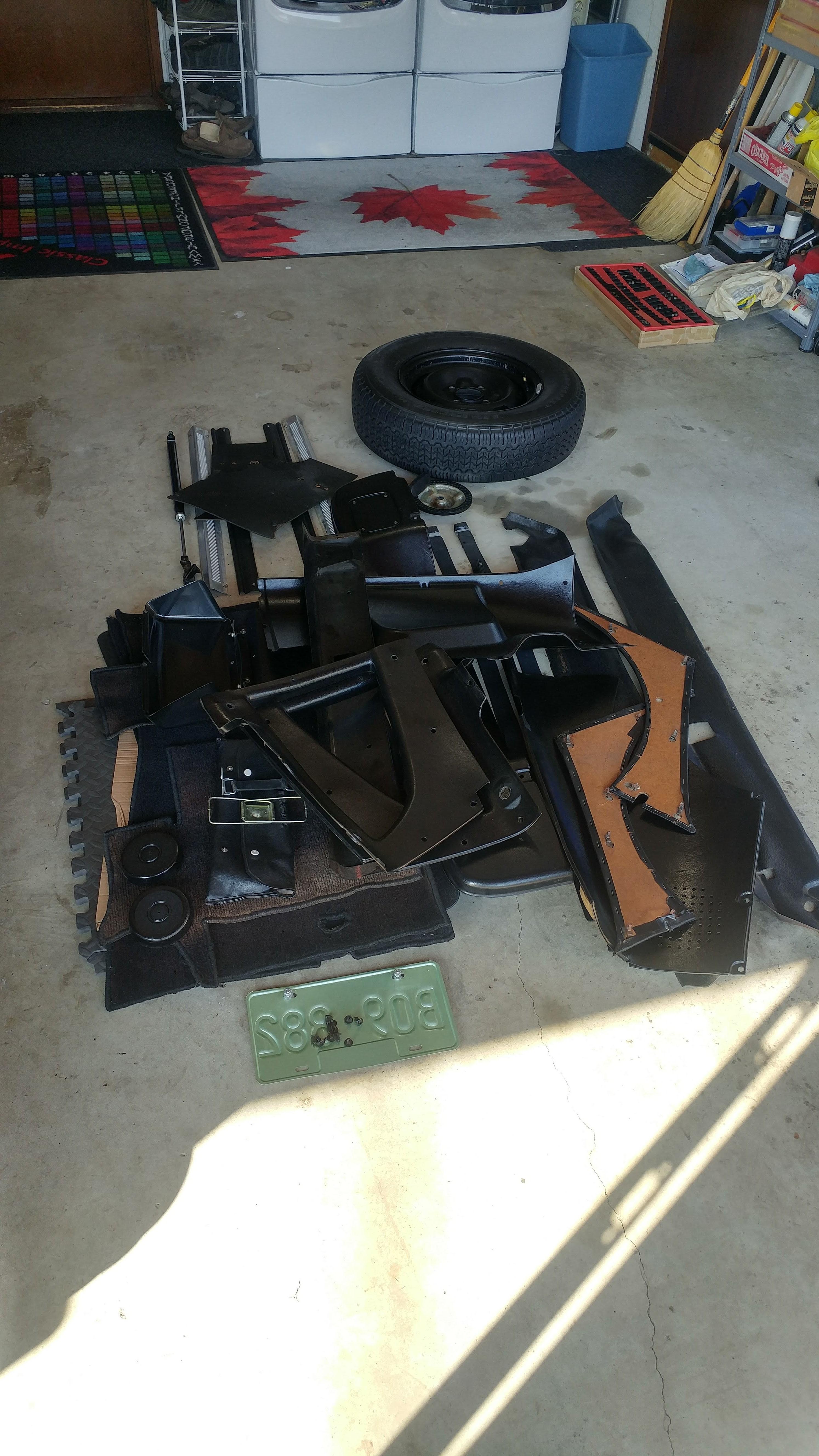

Right now I am working on removing most of the interior, so that the resto shops I am talking to can fully access the car to give me reasonable estimates before I get into the major disassembly.

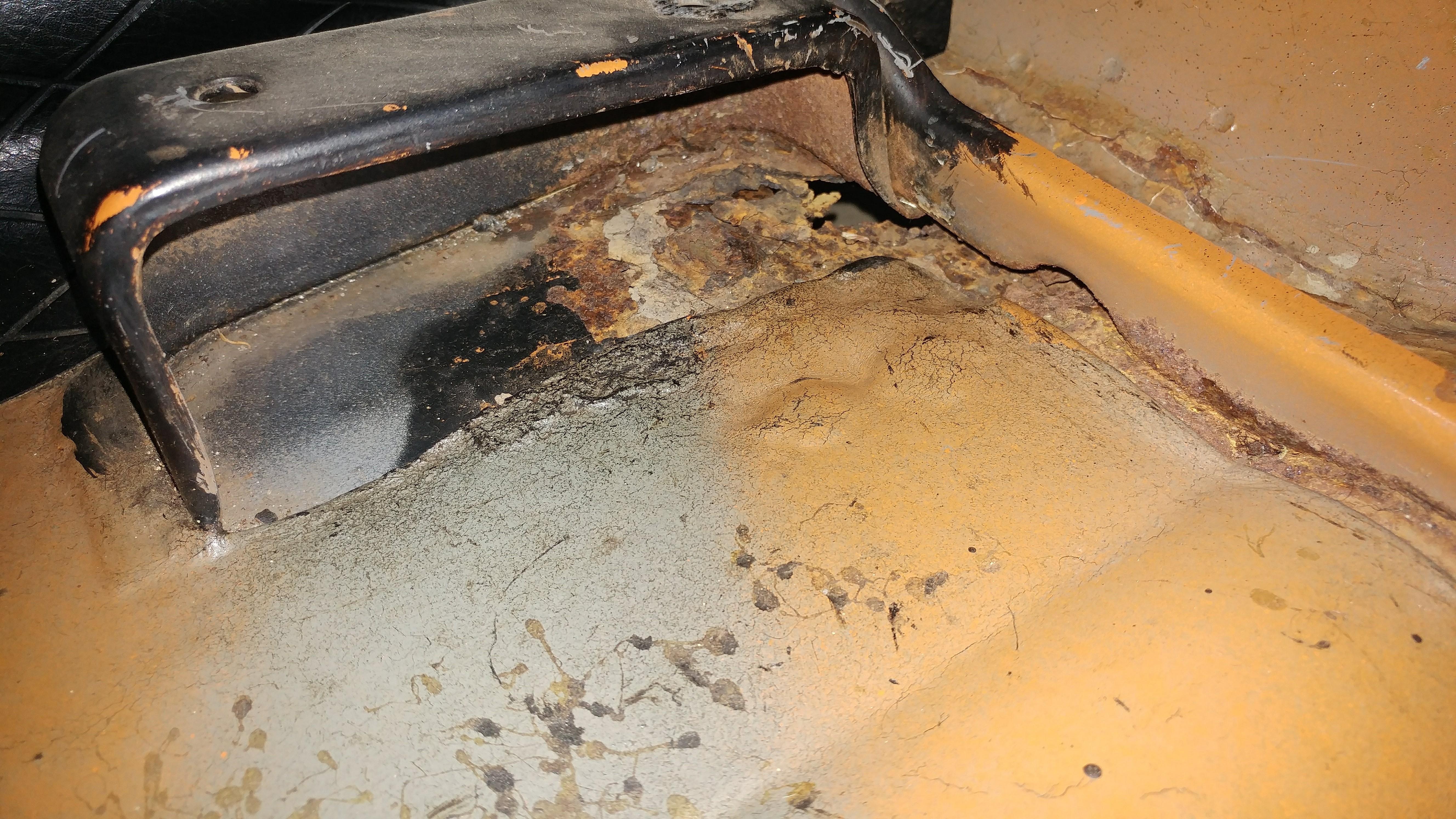

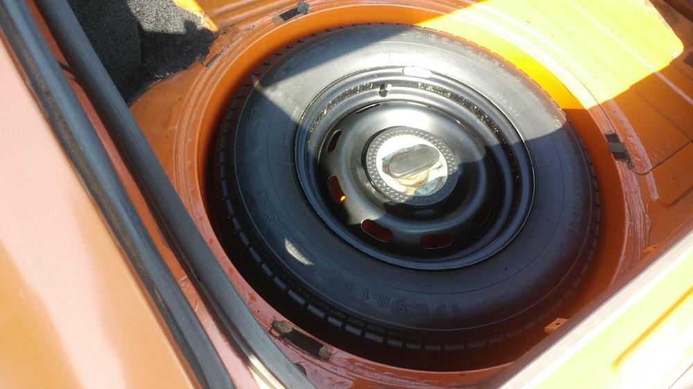

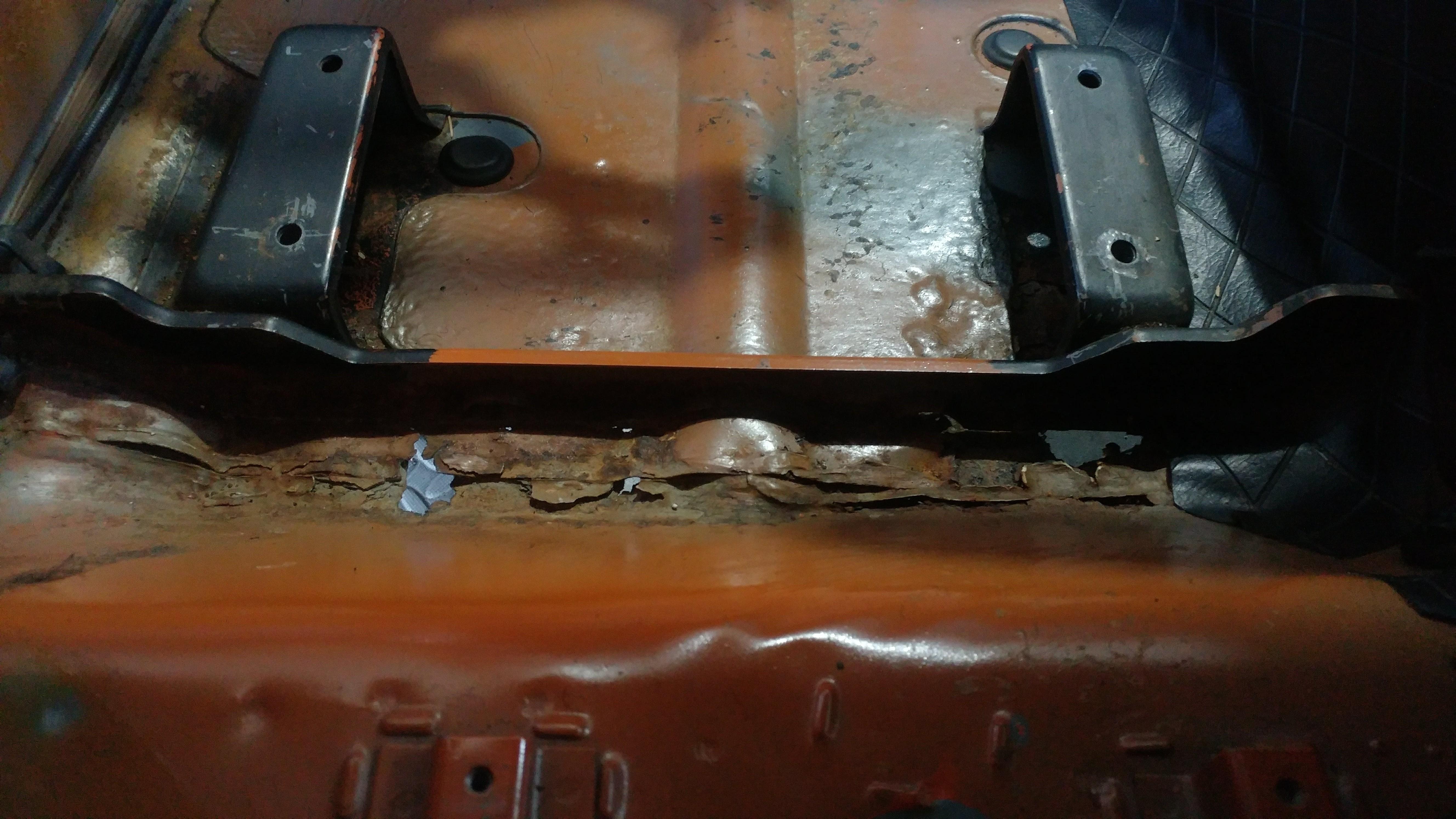

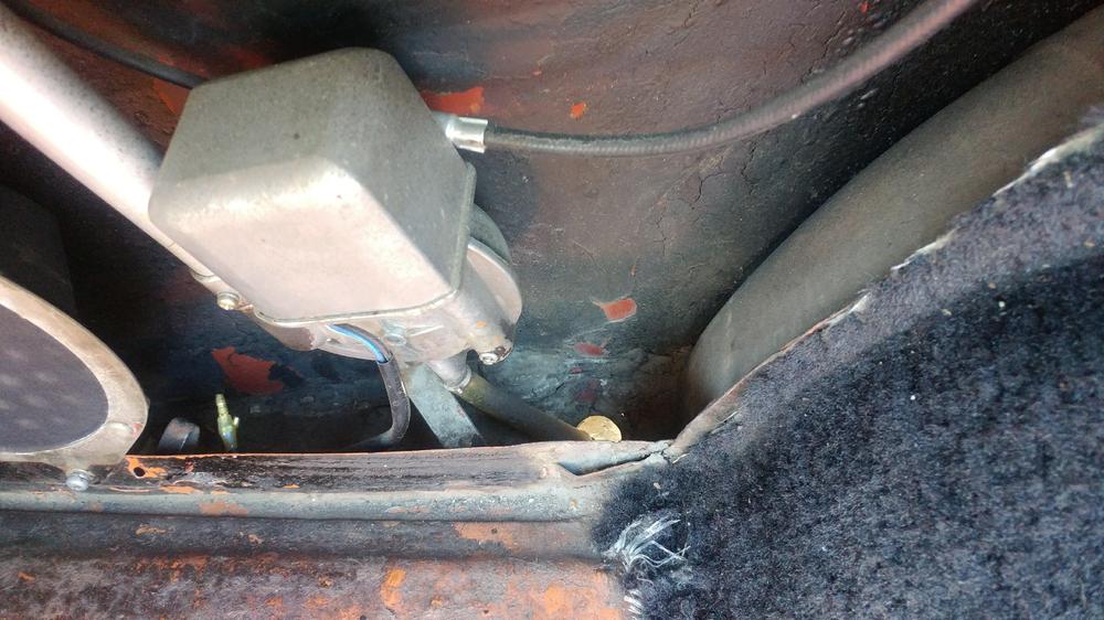

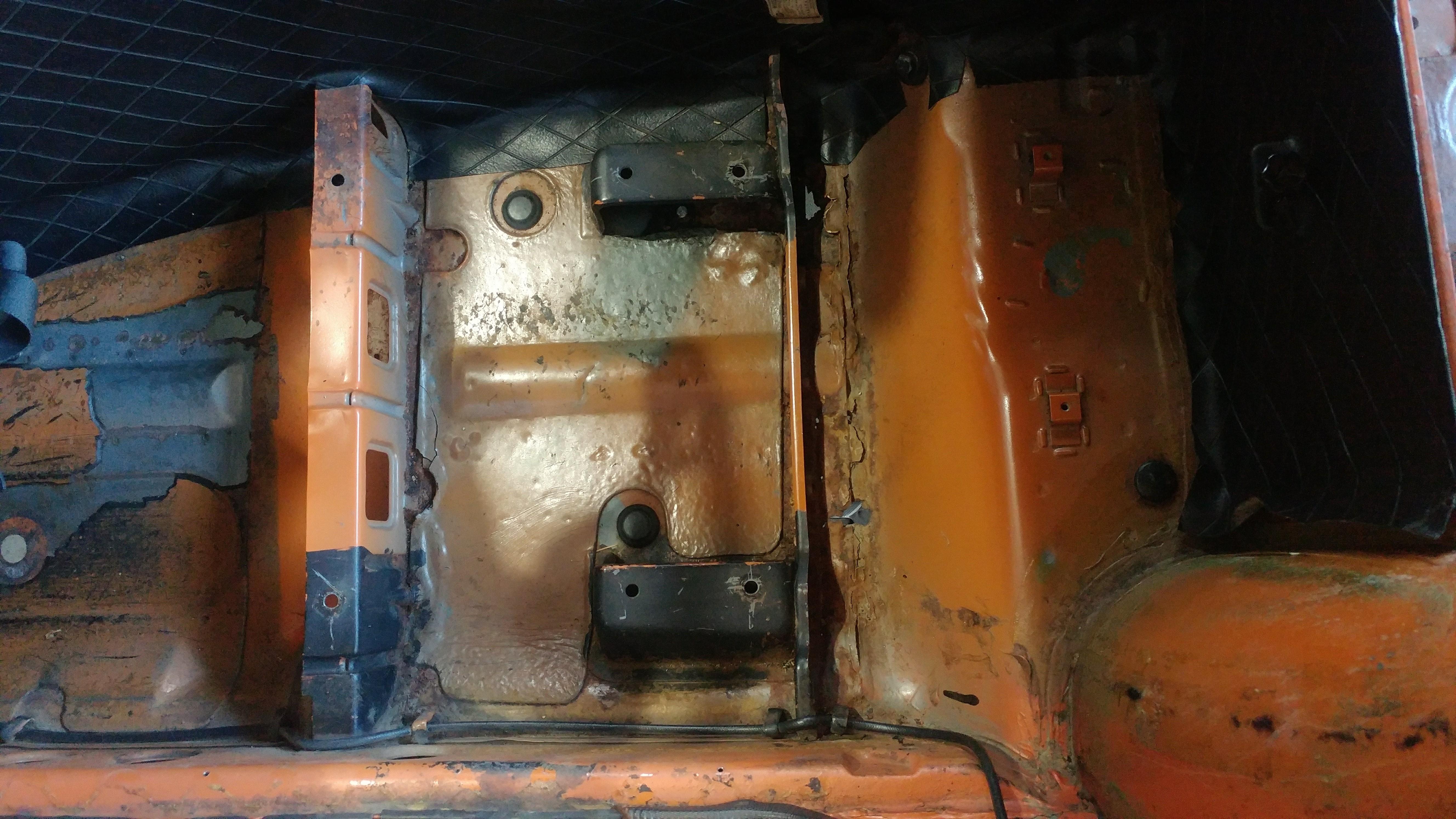

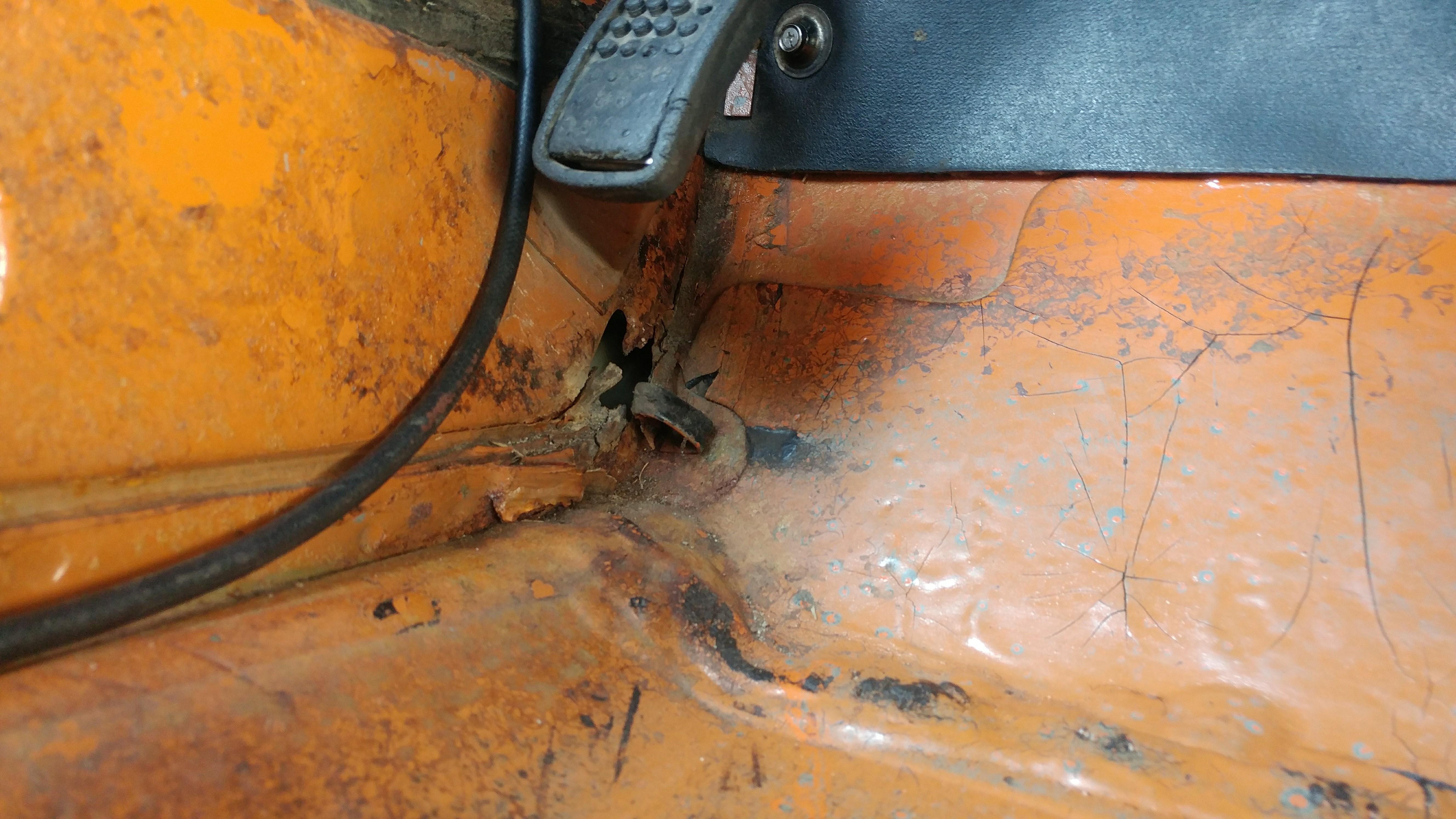

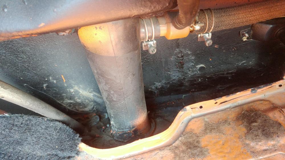

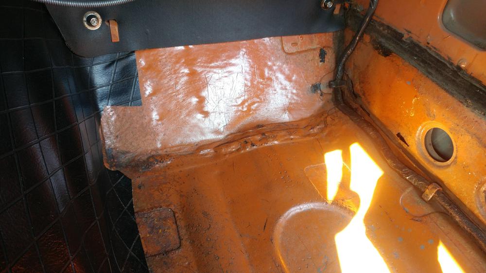

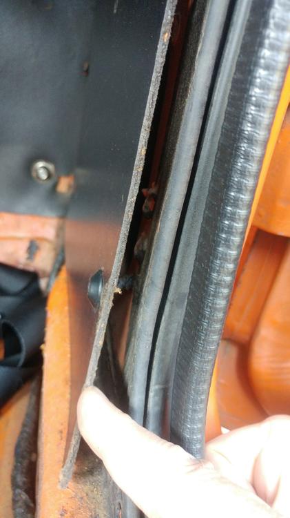

Got enough of the interior out to get a good visual of the problem areas, here is what I found.
20180902_185855.jpg20180902_185930.jpg20180901_160447.jpg20180901_160519.jpg20180902_185009.jpg20180902_185048.jpg20180902_185127.jpg20180901_160608.jpg20180901_141020.jpg20180901_141154.jpg20180901_160752.jpg20180901_160710.jpg
Luckily so far I have only broken this one retainer on the RH kick panel,  not sure how I could have saved it.
Overall I'm not too shocked with what I have found and I won't be pulling much more until I have selected a restoration shop to work with. I want to keep the car drivable as long as possible.

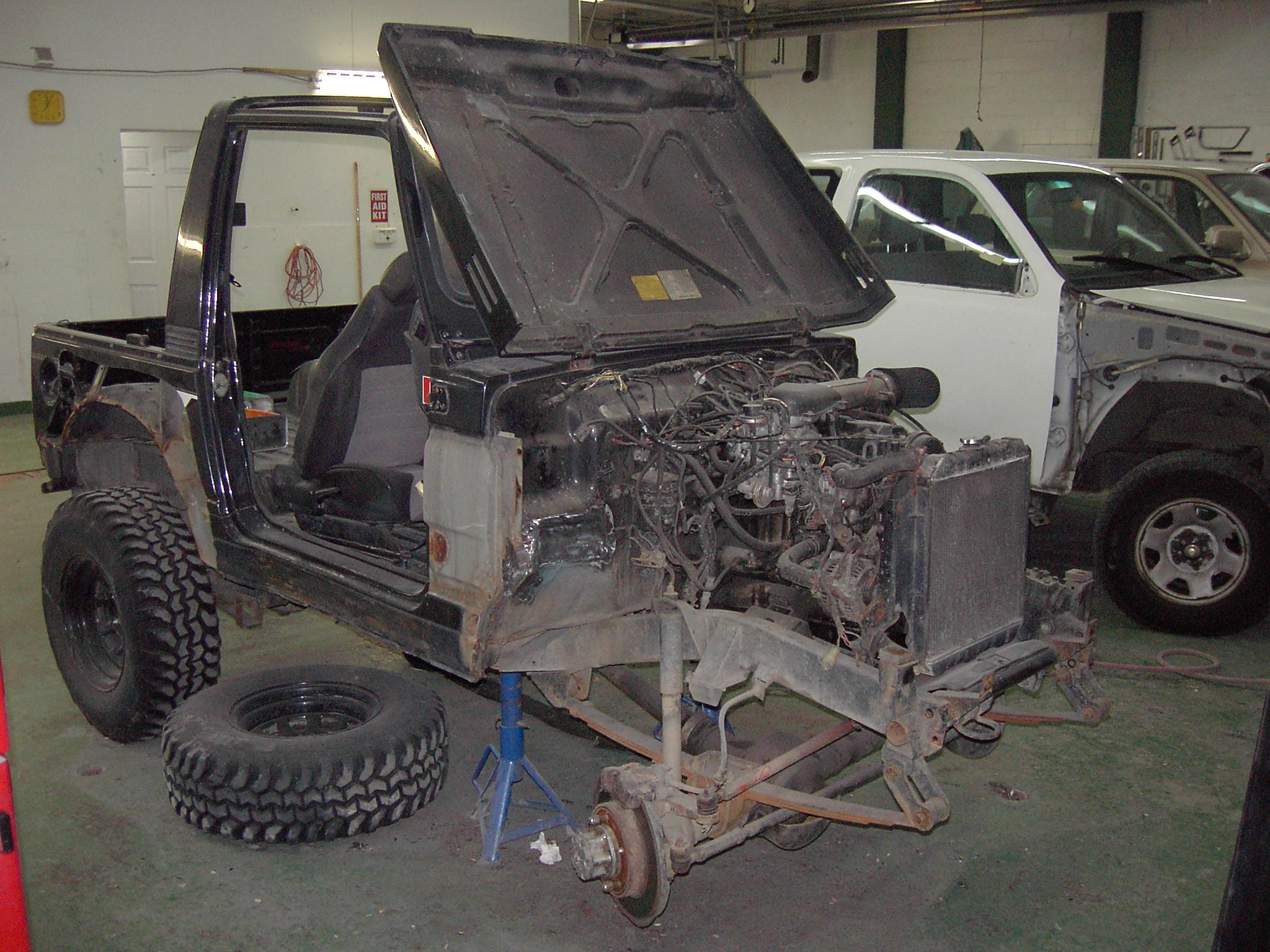

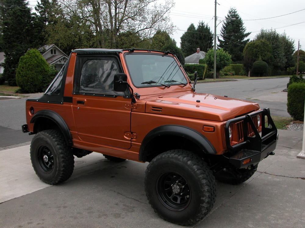

My first order of business is to sell my last project, a 1988 Suzuki Samurai. This will give me more space in the garage and help a little with the budget.  I might put it up on BAT.
Before,
During,
And after,
