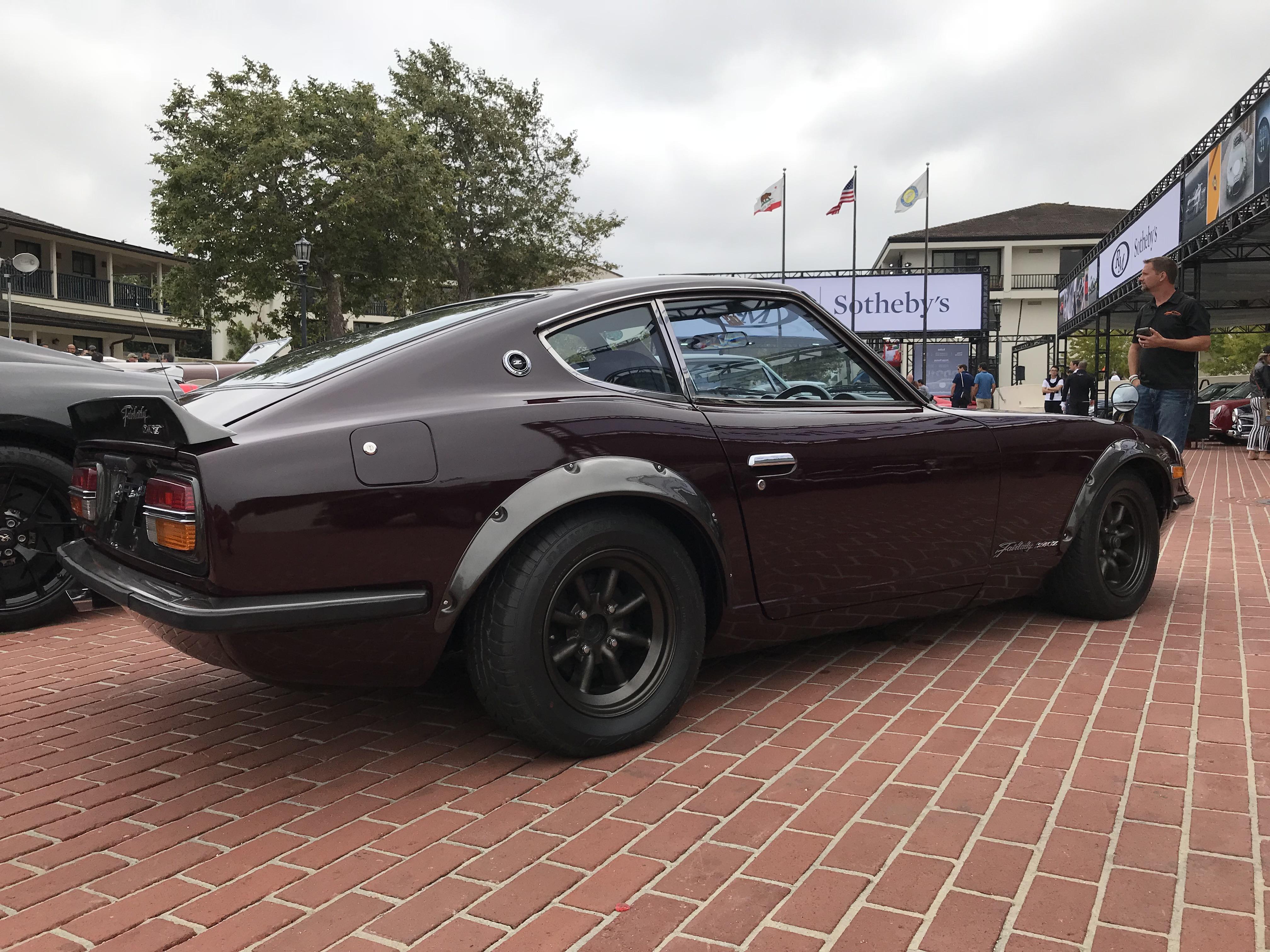

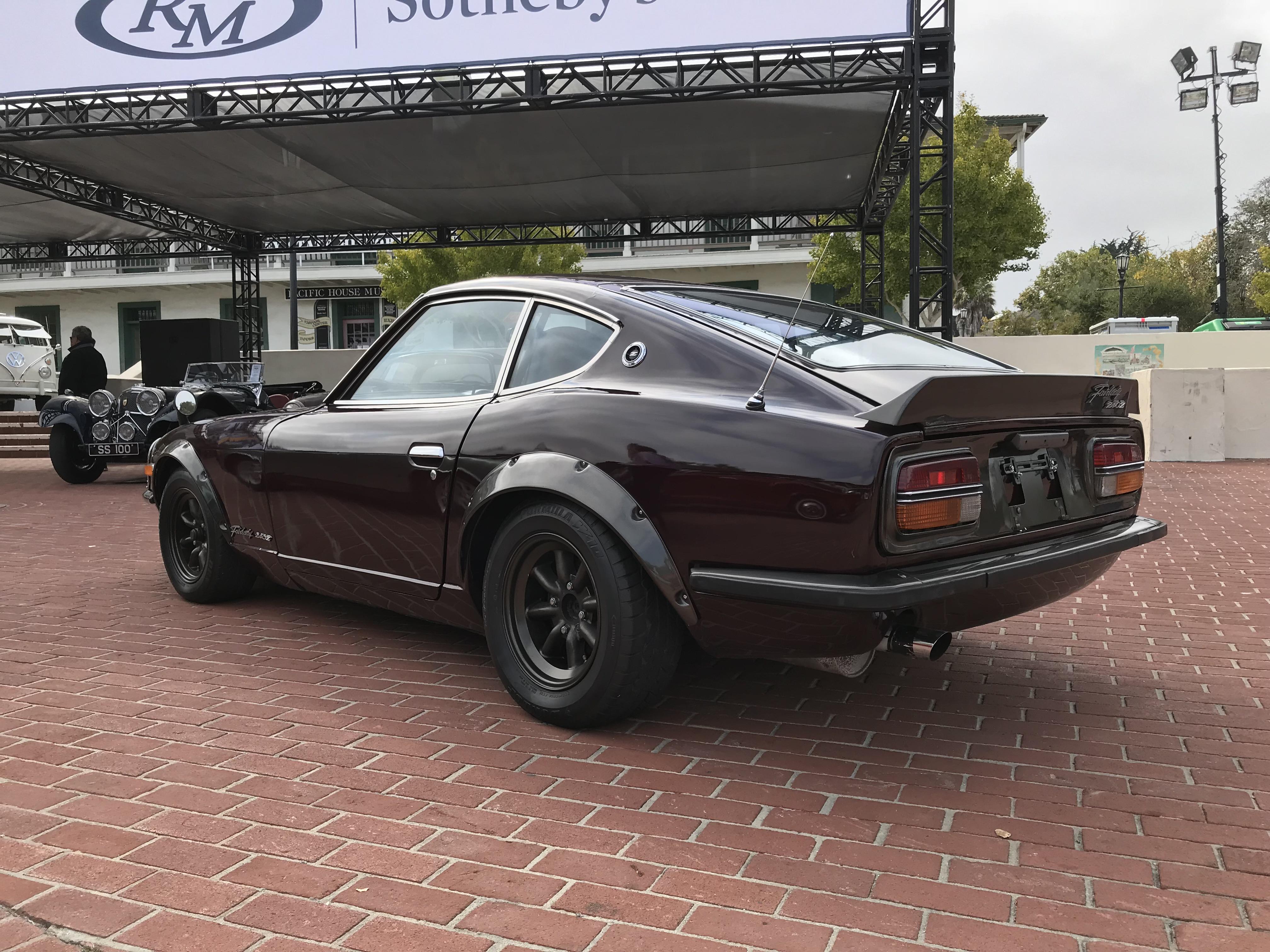

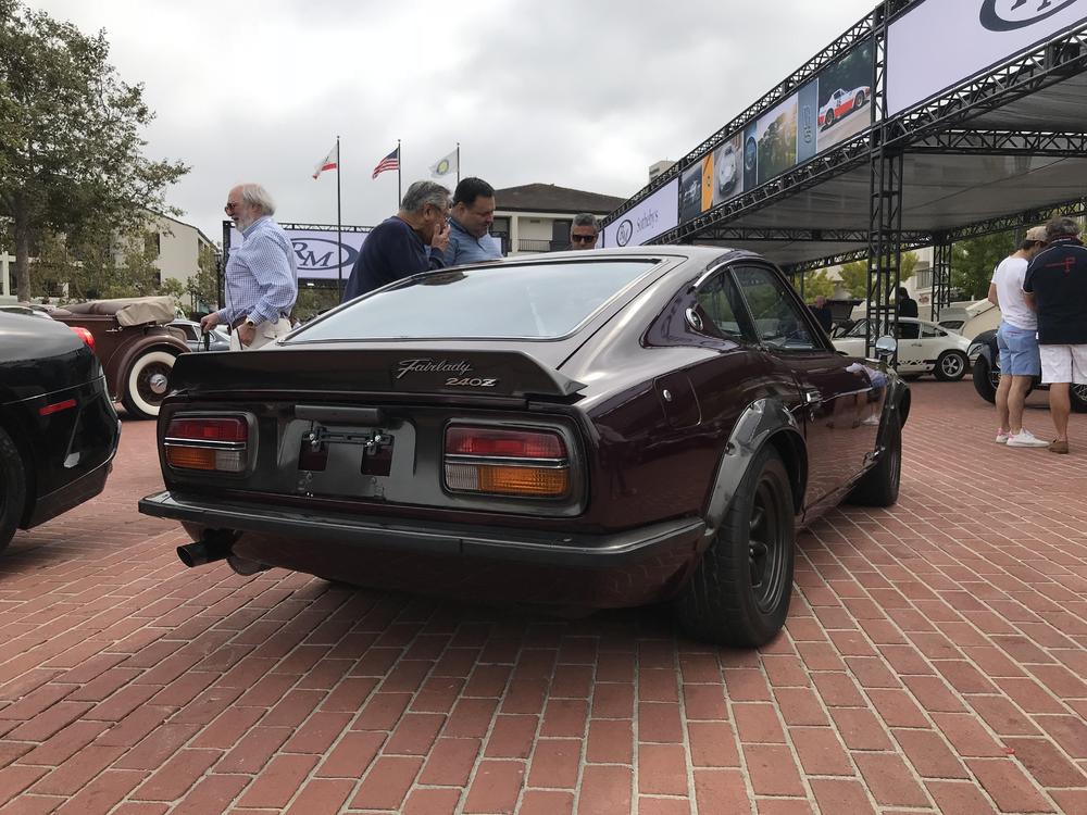

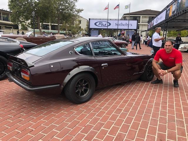

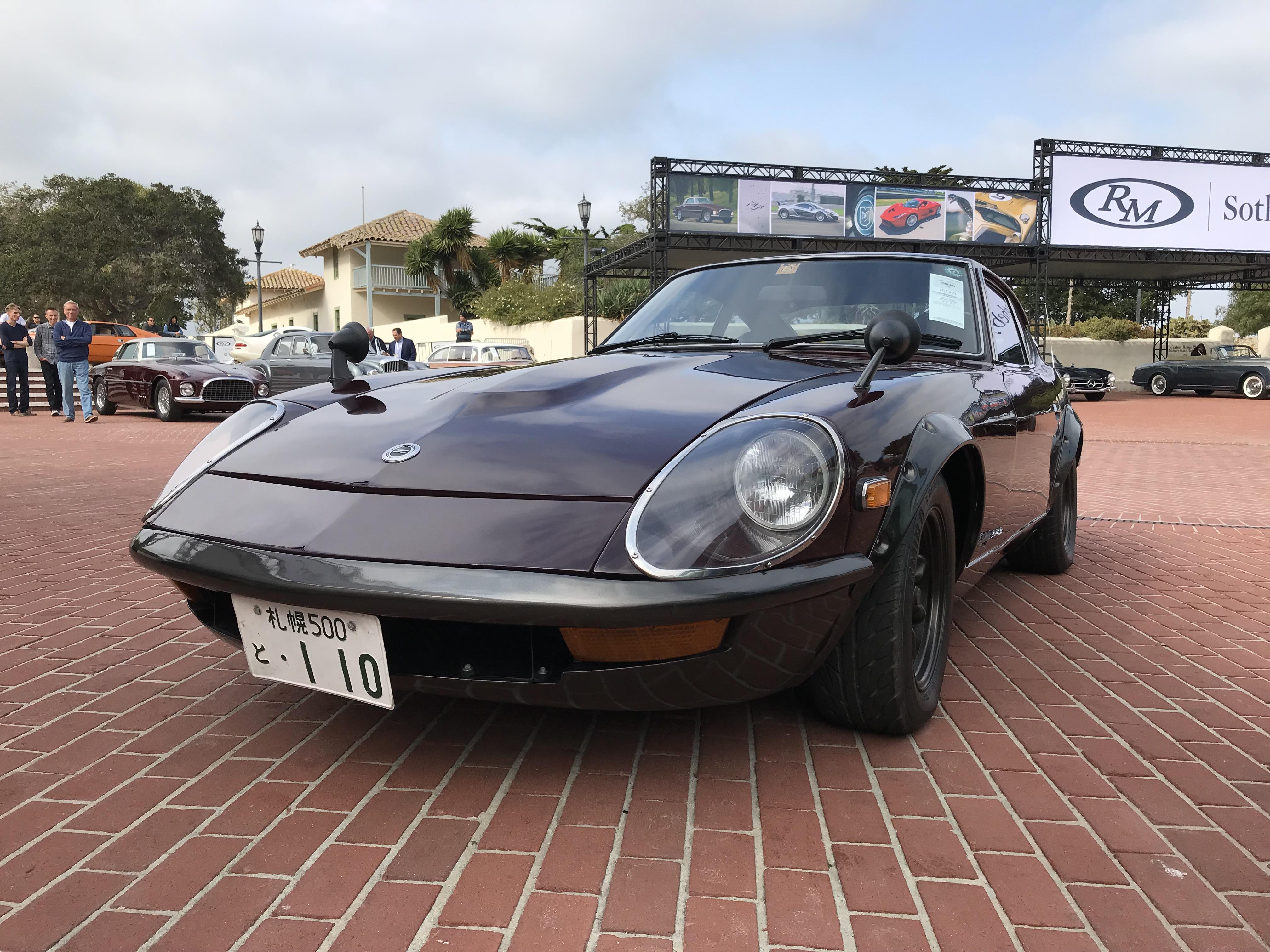

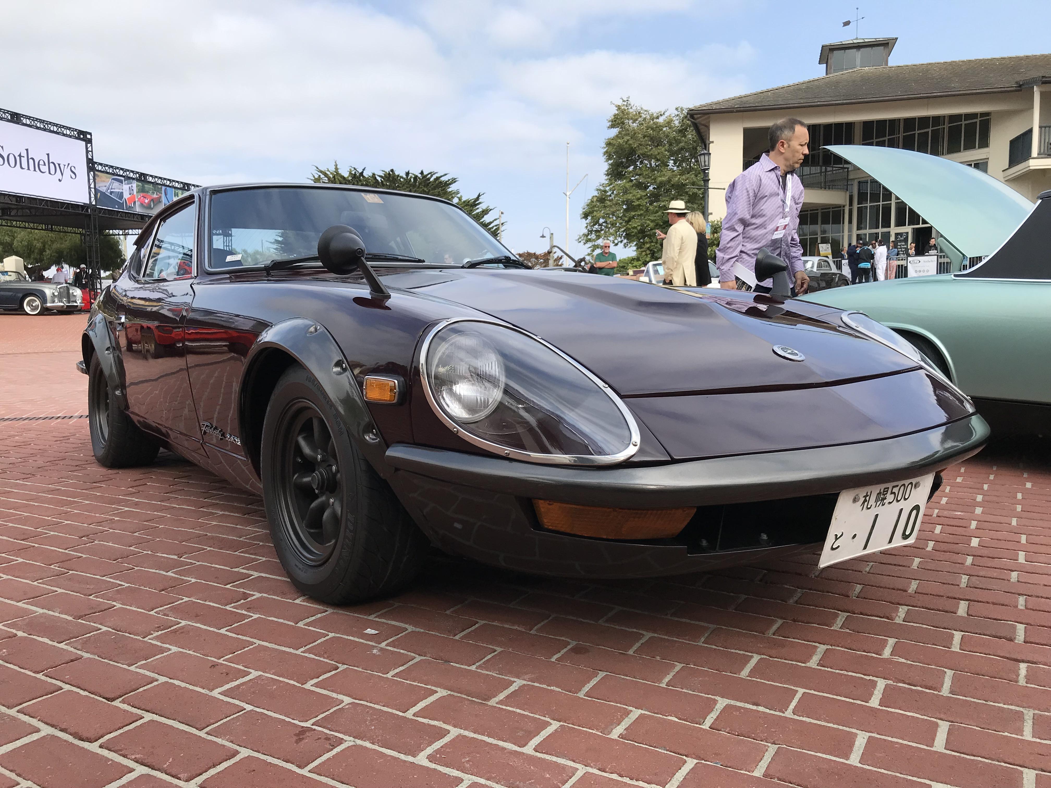

I don't know where to begin.  I was in Monterey for two whole days.  I was on the track at Laguna, I was in the room the GTO sold in, and I saw countless gorgeous cars, but this ZG was 'the' car.  I cannot explain the emotions that flowed through me when I saw it for the first time.  I had never seen a real 240ZG in the flesh and I was amazed.  There are certain cars that photograph well and the ZG always does.  But with the aperture of the eye this car is so much more stunning in person.  The proportions are divine and the color is perfect.  This car is a Fairlady 240ZG (HS30-H) and it was a homologation car for the g-nose and the fender flares.  It only came in white, red, and this maroon.  There may be a few roaming around the states, but it is rare here.  The wheels could have been wider, but I wasn't focused on that.  I was taking in the whole package.  I couldn't help myself when I saw that the door was unlocked.  I have ridden in a number of Fairlady Z's and a Bluebird 1800SSS, but I had never been in the driver's seat.  I have tried to outfit the interior of my personal car to be as 'Japanese' as possible, but when I opened the door and slipped into the drivers seat of this HS30-H it was whole other world.  The door clasped shut.  I looked around from a different view and it was all so similar and yet so different.  I stared down that long hood with the mirrors peaking on each side as I gripped the competition handle.  It felt different than mine.  It was rougher and newer whereas mine is smooth and burnished to a shine. The steering wheel could have been a Nismo reissue from 1998.  Those details raced through my mind and all I knew was that I was in my automotive home.
I feel so selfish and carnal, but when the time is right I will own this car.  It may take 20 years, but I am going to get it.  So many times I reveal myself on this forum, but I try to be me not hiding anything and to be real.  The 240ZG is really something special.  We don't think about it today, but in 1972 a 2.4L engine in Japan was a big deal. There were government regulations keeping most cars at 2L so the 2.4L cars were a luxury.  Someone please correct me if I'm wrong.
As for the auction result I was there to watch the hammer come down.  It was the wrong crowd for this car and it was late at night when the car sold.  The room was less than half full and it was a no reserve auction.  It sold quickly for 47.5K and with fees it was 10% more.  I wanted bid so badly, but I don't have that kind of cash.  What I do have is patience.
Ben?

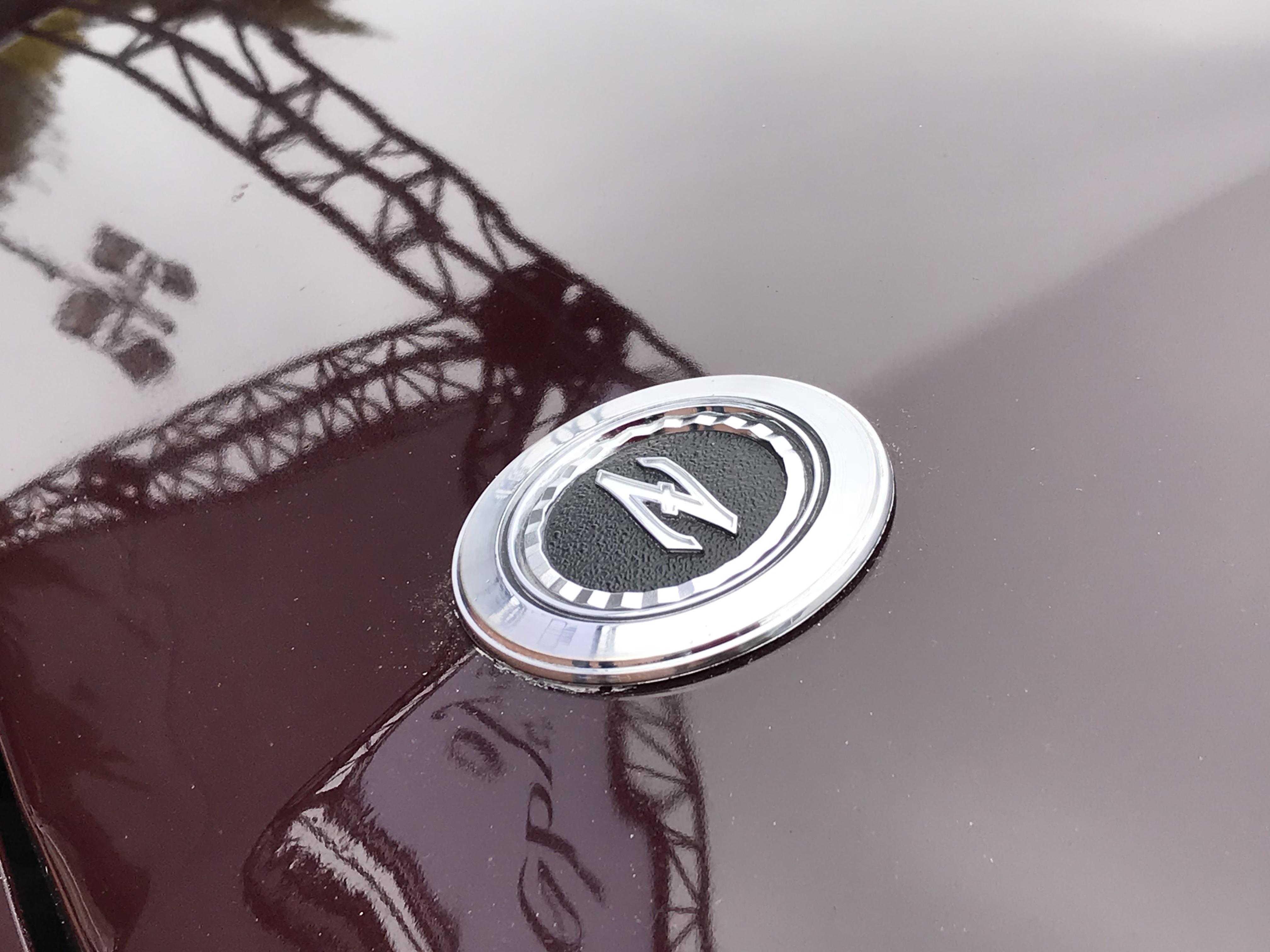

p.s.  Yes that is me with the car.  There were other cars around and I did look at them after I opened every door of this car and felt under its bonnet?.   I thought there were going to be five ribs beneath the piece of the nose with the emblem.  Speaking of the emblem I believe it was off an S130.  There was however the air ducting on the lower valence.  It was not a perfect car by any means.  It had all the signs of sitting and not being in use as of late.  I do believe this was the exact ZG that sold a few years back at auction in the states with a similar result.  I hope this car got to an enthusiast that is going to drive it and show it, but I am not so sure.  The crowd at RM/Sotheby's seemed much like the investment type.  I hope I am wrong.

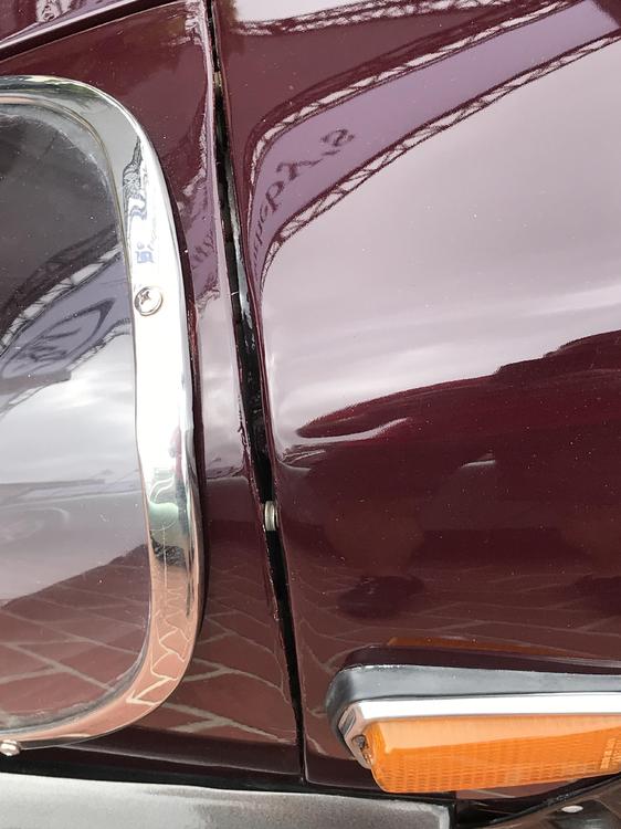

Alan, that is exactly where I put my hand.  Beneath the bonnet extension panel.  It was just the weave of the fiberglass and none of those ribs.  Now that I look at the photo, the gap does look inconsistent.  Thanks for the insight.

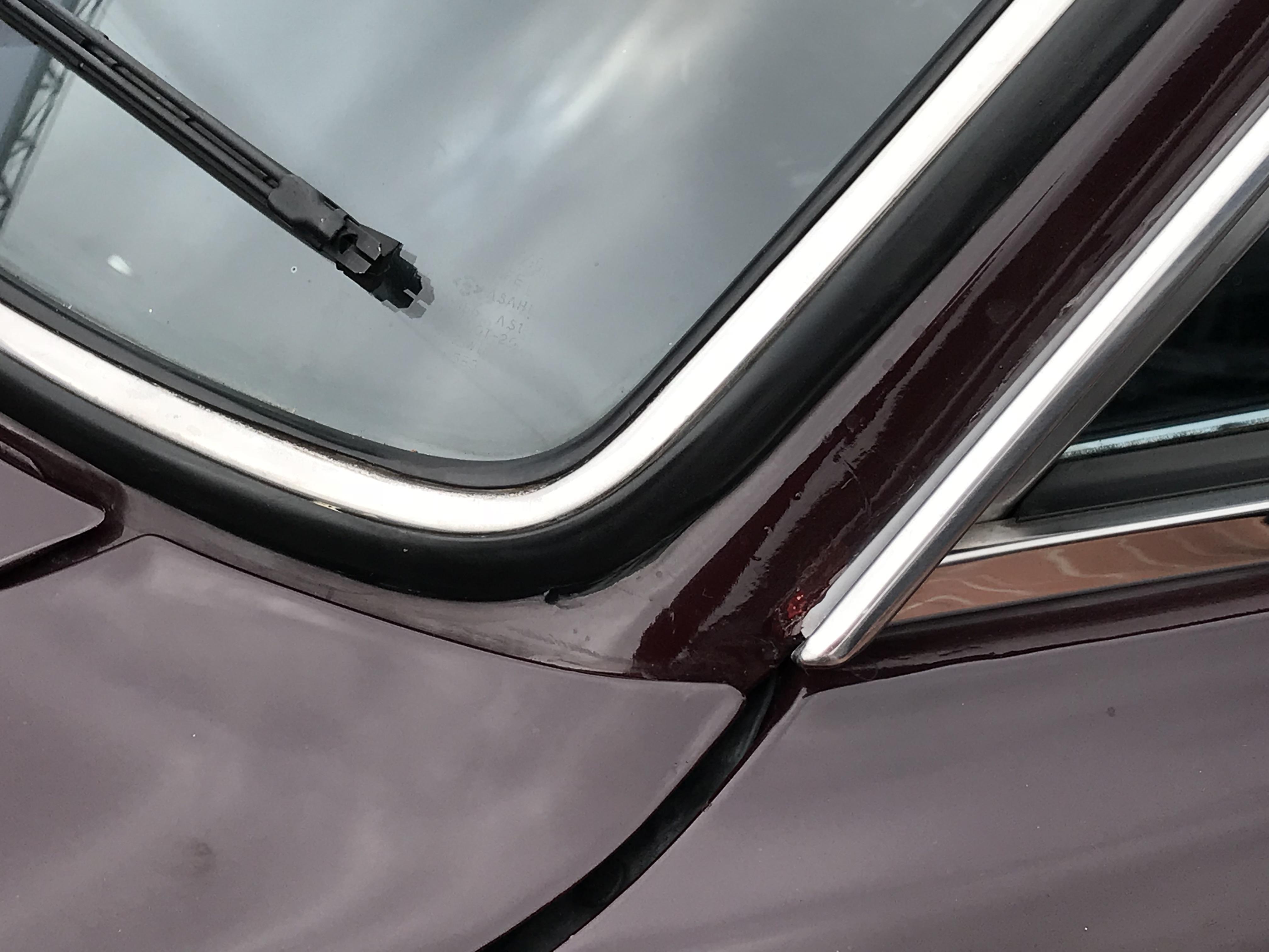

Respray had some issues.

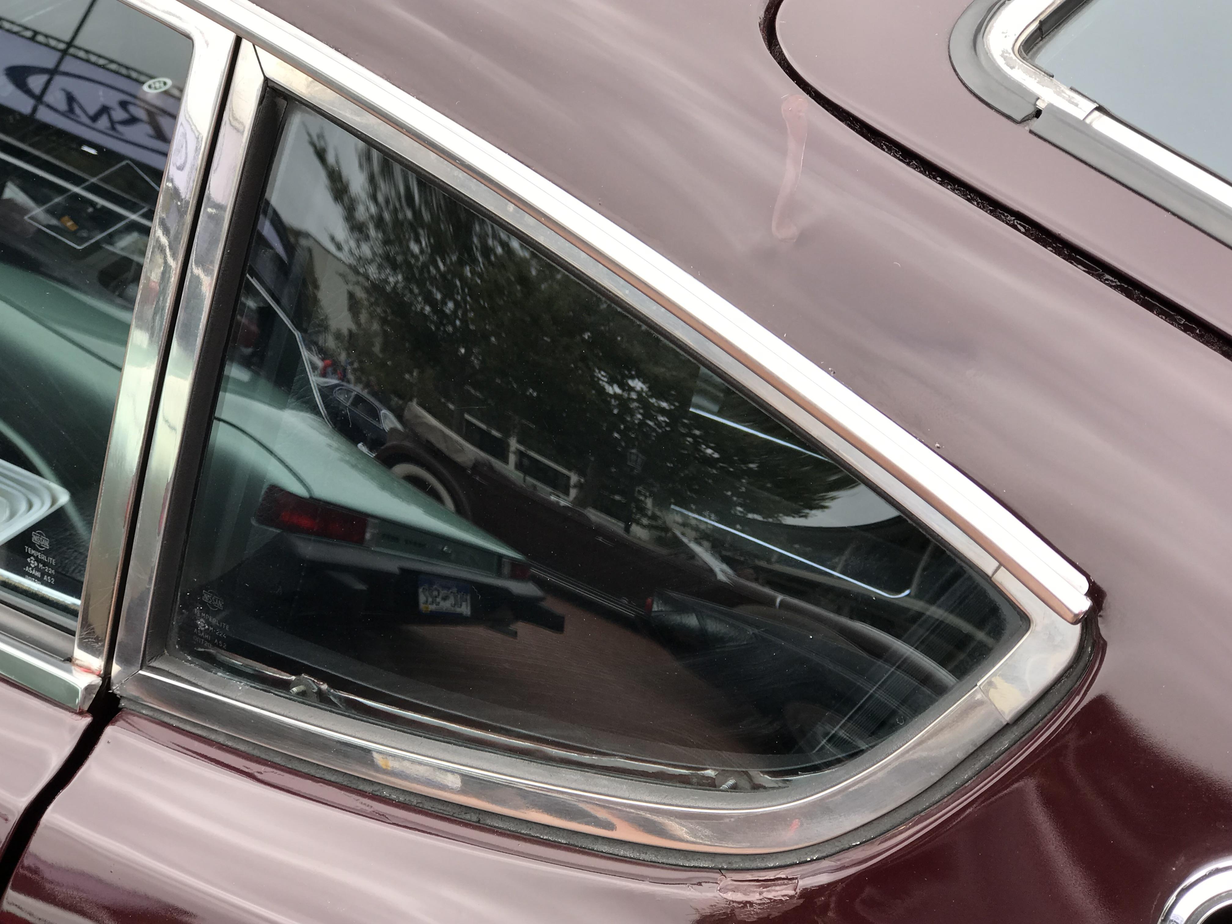

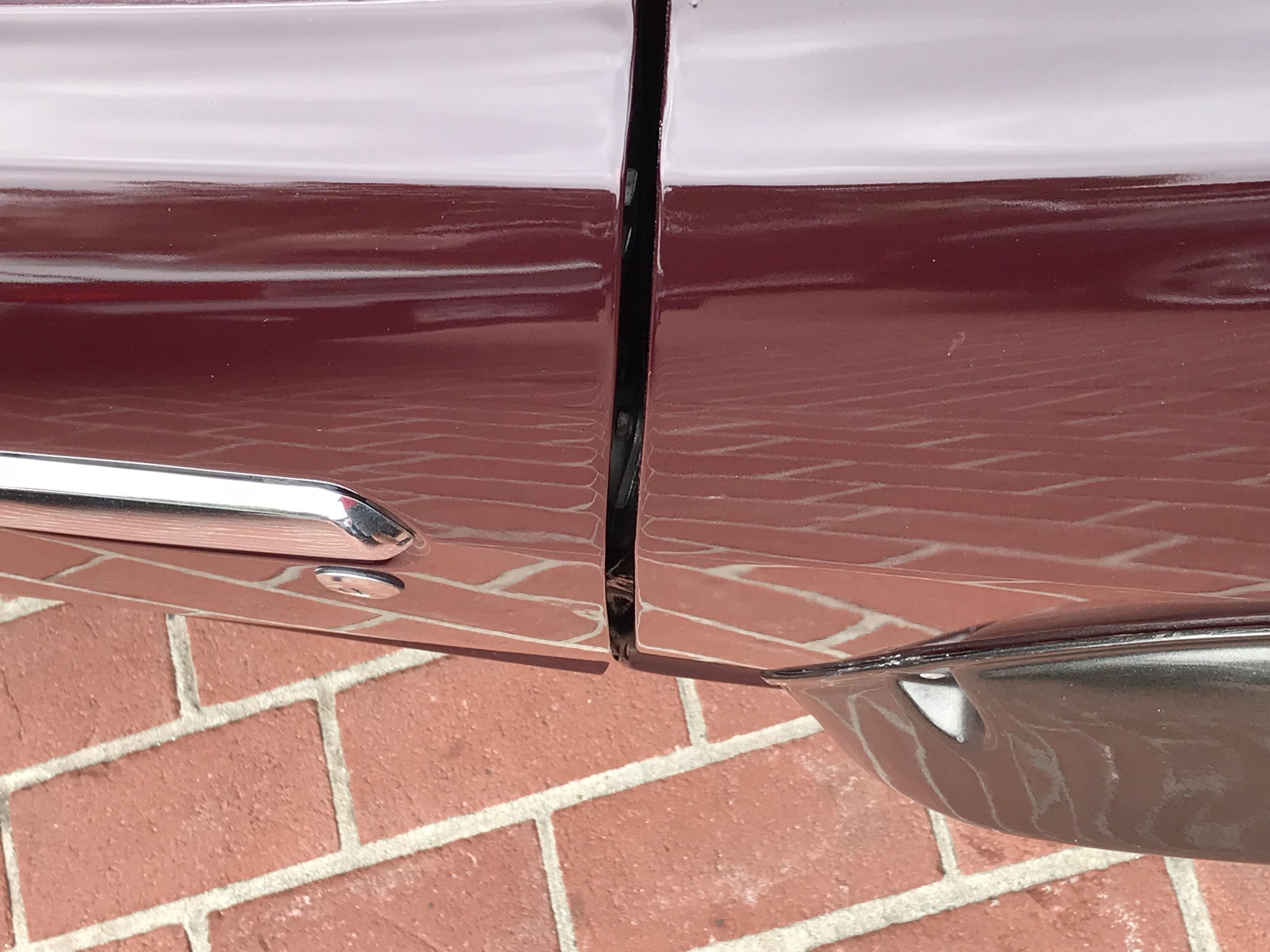

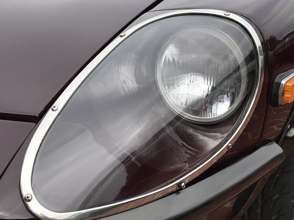

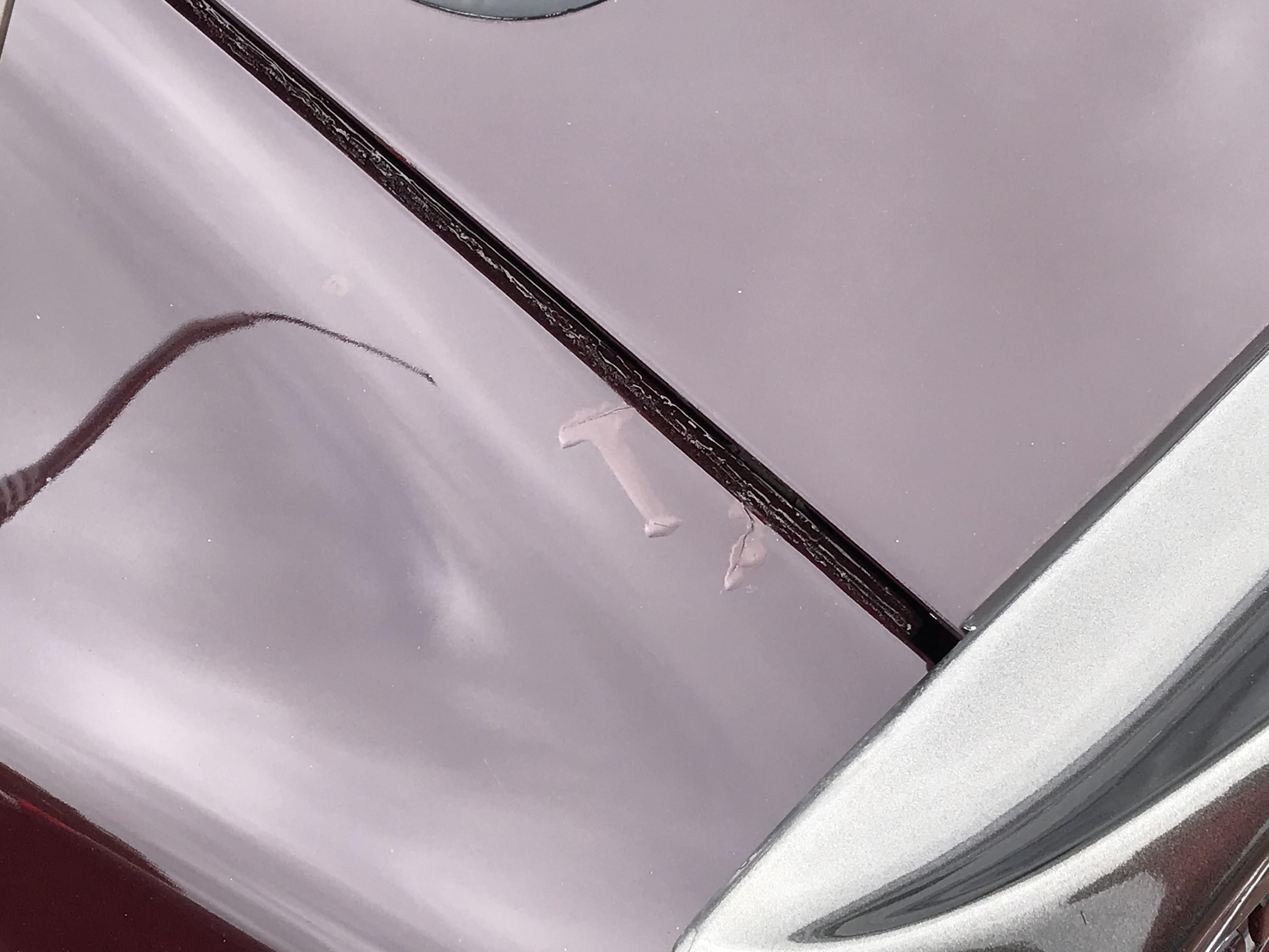

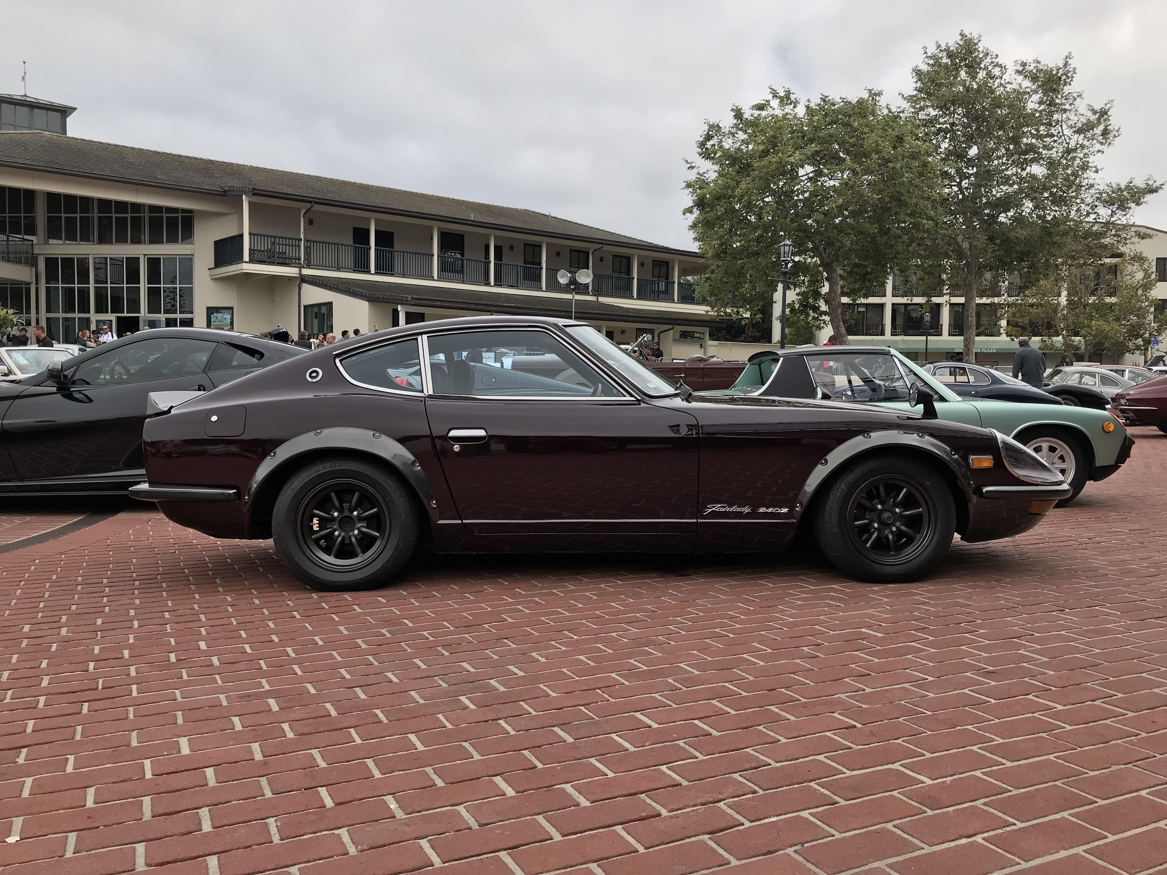

Nice write up on the ZG. I was there on Saturday saw the car in person as well. Besides the valid points you made on why the ZG sold for not as high as anticipated, I think the main reasons for it not selling higher was due to its condition and previous repairs done to the car.
When looking through the opening of the g-nose it was apparent that the radiator support was silver. At first I thought maybe the car was originally silver and just made into a ZG clone. But after opening the hood it was obvious from the poor welds and messy application of seam sealer that the front support had been replaced. The sub-par repair also caused fitment issues between the front headlight buckets and the fenders. Both floors had been replaced with just plain sheetmetal instead of stamped repros or floorboords from a donor car. The driver-side door jamb looked to have been previously repaired, possibly due to rust. When I opened the hatch there were loose rust flakes found all over under the carpet. An electrical fuel pump that was fitted underneath by the factory mounting points was jerry-rigged to a thin sheetmetal strip one would find at Home Depot. The body had numerous dings and wavy body panels, and the paint, while it still had a shine, had many spots where it was blemished or cracked. The hood emblem was the S130 version. These issues along with others I didn't note I think caused any potential buyers present to be turned off from buying the car.
I did try to ascertain if it was an authentic ZG or a clone. With the exception of the radiator support that was replaced by a silver one, everywhere I could inspect without ripping out interior panels led me to believe the car is an original GP Maroon car. I even looked under the liners in the tool bins and it looked to be the factory paint.
What shocked me the most was how well this car looked in the RM Auction photos vs seeing it in person. I was expecting the car to sell higher due to online bidders registered in the auction. RM Auction worked their magic in those photos.
