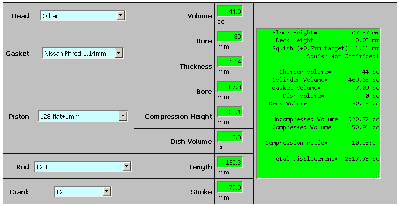

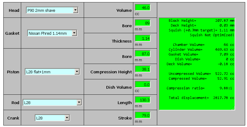

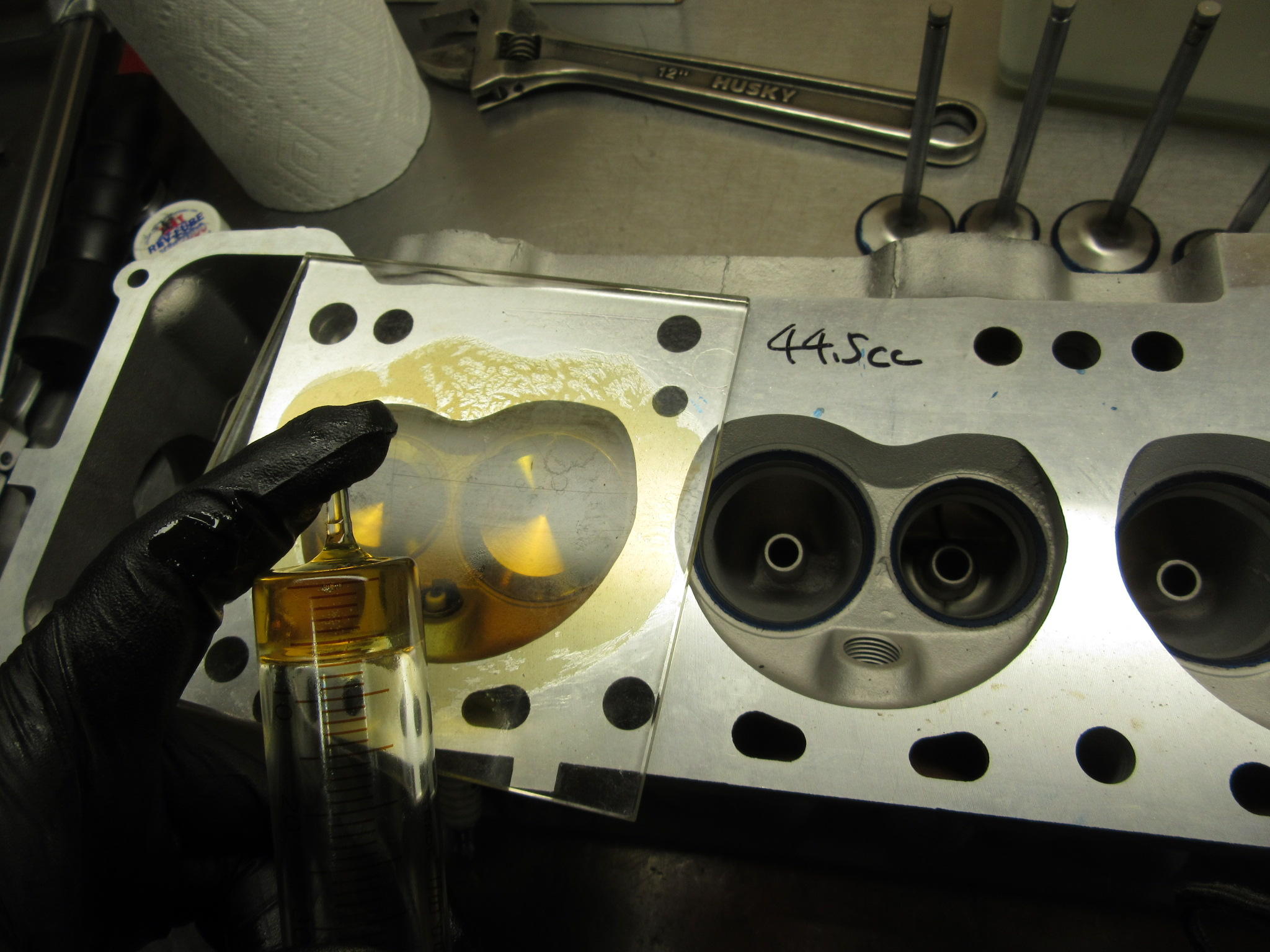

November 25, 20186 yr comment_562335 On 8/14/2018 at 9:47 PM, 240260280 said: Shave of 2mm off a P90 will put you ~9.9CR Here is with E88 @44cc (~10.2CR): You are showing the P90/P79 head cut 2mm with a 46cc chamber. Actually those combustion chambers are 44cc on those two heads after the cut. We (Eiji and me) cc’d The Head......they were 44cc’s. The head in the picture was cut again to give us a chamber cc of 44cc’s. Link to comment https://www.classiczcars.com/forums/topic/60581-input-on-power-gains-by-swapping-head/?&page=4#findComment-562335 Share on other sites More sharing options...
November 25, 20186 yr comment_562359 15 hours ago, Diseazd said: You are showing the P90/P79 head cut 2mm with a 46cc chamber. Actually those combustion chambers are 44cc on those two heads after the cut. We (Eiji and me) cc’d The Head......they were 44cc’s. The head in the picture was cut again to give us a chamber cc of 44cc’s. Thanks Guy! Hmmm I trust both you and Brian Little but he gives 46cc here: http://datsunzgarage.us/p79/ and you have verified with two heads so I will default to you and update the tool... however can you please confirm both of your heads were not shaved before you received them? Here is the revised tool: Z Engine Planner S30 Engine Modeller V4.zip Edited November 25, 20186 yr by 240260280 Link to comment https://www.classiczcars.com/forums/topic/60581-input-on-power-gains-by-swapping-head/?&page=4#findComment-562359 Share on other sites More sharing options...
November 25, 20186 yr comment_562364 Blue....I’m not an expert, but the Datsun heads are 108mm from upper to lower surfaces. The measurement that are taken are from the top to give you 106mm result (2mm or .080 inches removed). If the head was previously cut .015 inches, the machinist would only cut the head .065 inches. I went back and checked the stats on Eiji’s Stroker that he built for me. The chambers were 44.5 cc’s not 44. I was there when he cc’d the engine, so I watched him cc the number one, number six and the number three chambers. All cc’d at 44.5 cc. Anyone else want to chime in? Guy Link to comment https://www.classiczcars.com/forums/topic/60581-input-on-power-gains-by-swapping-head/?&page=4#findComment-562364 Share on other sites More sharing options...
November 25, 20186 yr Author comment_562368 107.9 mm i think is the messurment to be exact. Link to comment https://www.classiczcars.com/forums/topic/60581-input-on-power-gains-by-swapping-head/?&page=4#findComment-562368 Share on other sites More sharing options...
November 25, 20186 yr comment_562374 OK 44.5cc Thanks! Link to comment https://www.classiczcars.com/forums/topic/60581-input-on-power-gains-by-swapping-head/?&page=4#findComment-562374 Share on other sites More sharing options...
