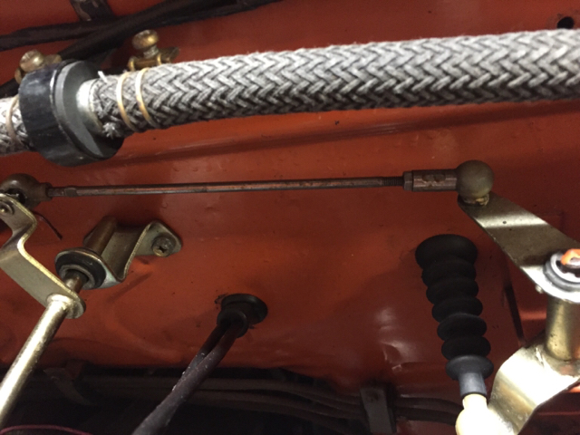

 I took off the link from the torsion rod to the throttle, and I noticed it doesn't have threads!  Is that correct?  it is just a fixed-length rod that pushes down on the throttle arm, which has its own return spring, so I'd say it doesn't need to be threaded, but I wanted to make it longer to help with the throttle sticking partly open.

I have some misc ones. What length are you looking for?
