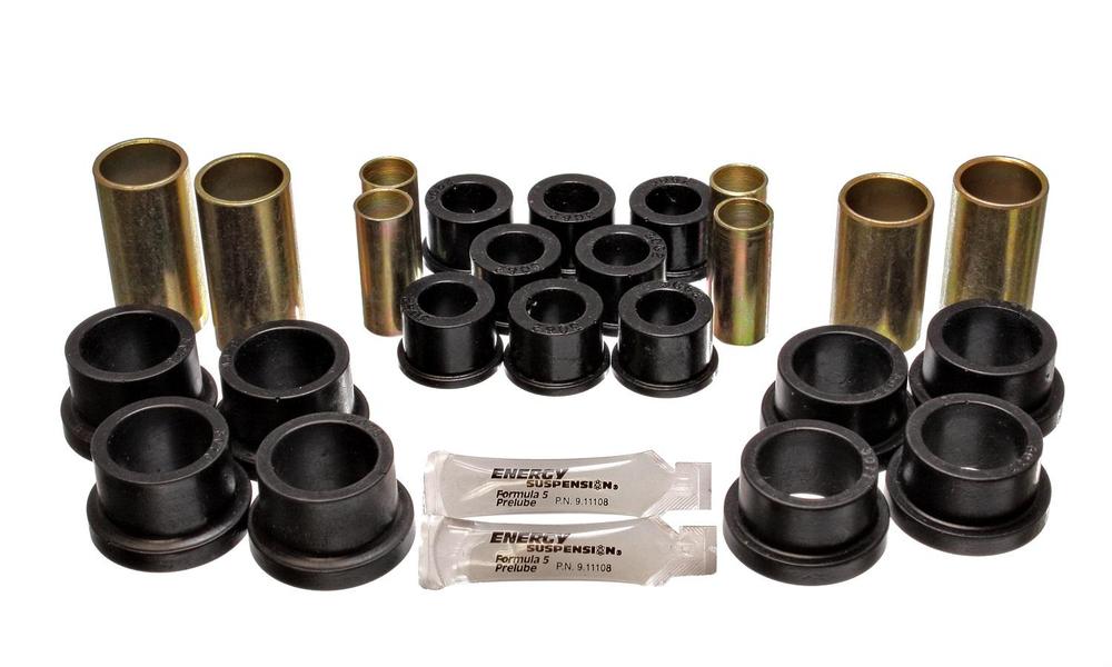

Then they stiffed you on those bushings...  The Energy master kit comes with bushings and metal sleeves to replace both sides of the rear lower control arm bushings (inner and outer (inboard and outboard)).  I was going to make a comment on your pictures of the LCA, rear hub, and pristine (if dirty) lock pin nut.  It's obvious that no one has pulled your spindle pin.  And it's very obvious that a new set of poly bushings has NOT been installed on the outboard side.
(In the picture above, the bushings for the rear outboard LCA are just above the steering rack bushings (8 black "tophats" and 4 metal tubes) - just above them is half of the inboard bushings for the rear LCA (4 large "tophats" and 2 large tubes))

Perhaps I have an insite. Fact. He had a set of poly bushings installed. If you have done this job, you will remember that the inner and outer half of each of the pairs of outer rear control arm bushings have a thin lip on them.
Here is a picture of rear control bushings from energy suspension. The outer set is in the center of the picture.
IMG_3459.JPGWhen installed that thin lip would visible/present in that gap, unlike stock where the inner bushing is completely different and has no lips. That's what is damaged in his picture, part of the lip is gone. Does it matter? No. If the pin bolt is properly torqued, the inner metal tube in the control arm is locked to the face of the strut where the pin goes through. Since the control rotates with respect to the strut at this point, that lip can get damaged. Does not matter.
As long as that horrible sticky grease the bushings come with is generously used on the spindle pin, it will last for ever.
