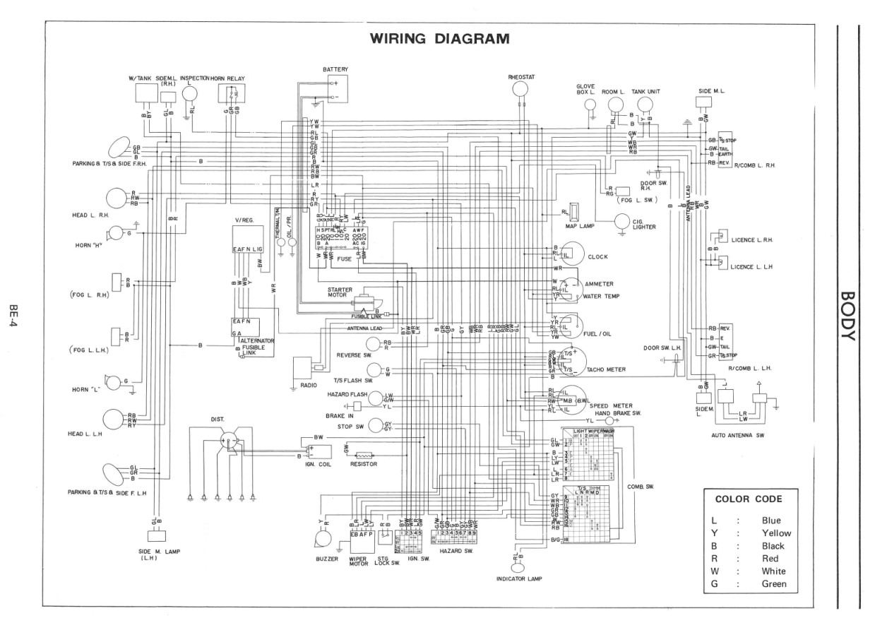

Your headlight problem might be at the dimmer switch in the turn signal stalk.  Pretty common.  Squirt some contact cleaner in to the base and work it or take it apart.  Make sure the ground wire is grounding.
The dash light problem could be the rheostat.
There's a nice diagram on page BE-4.  Download it from here. https://www.classiczcars.com/files/category/11-240z/  I think that CanTechZ's is the "good" one, with individual files.
