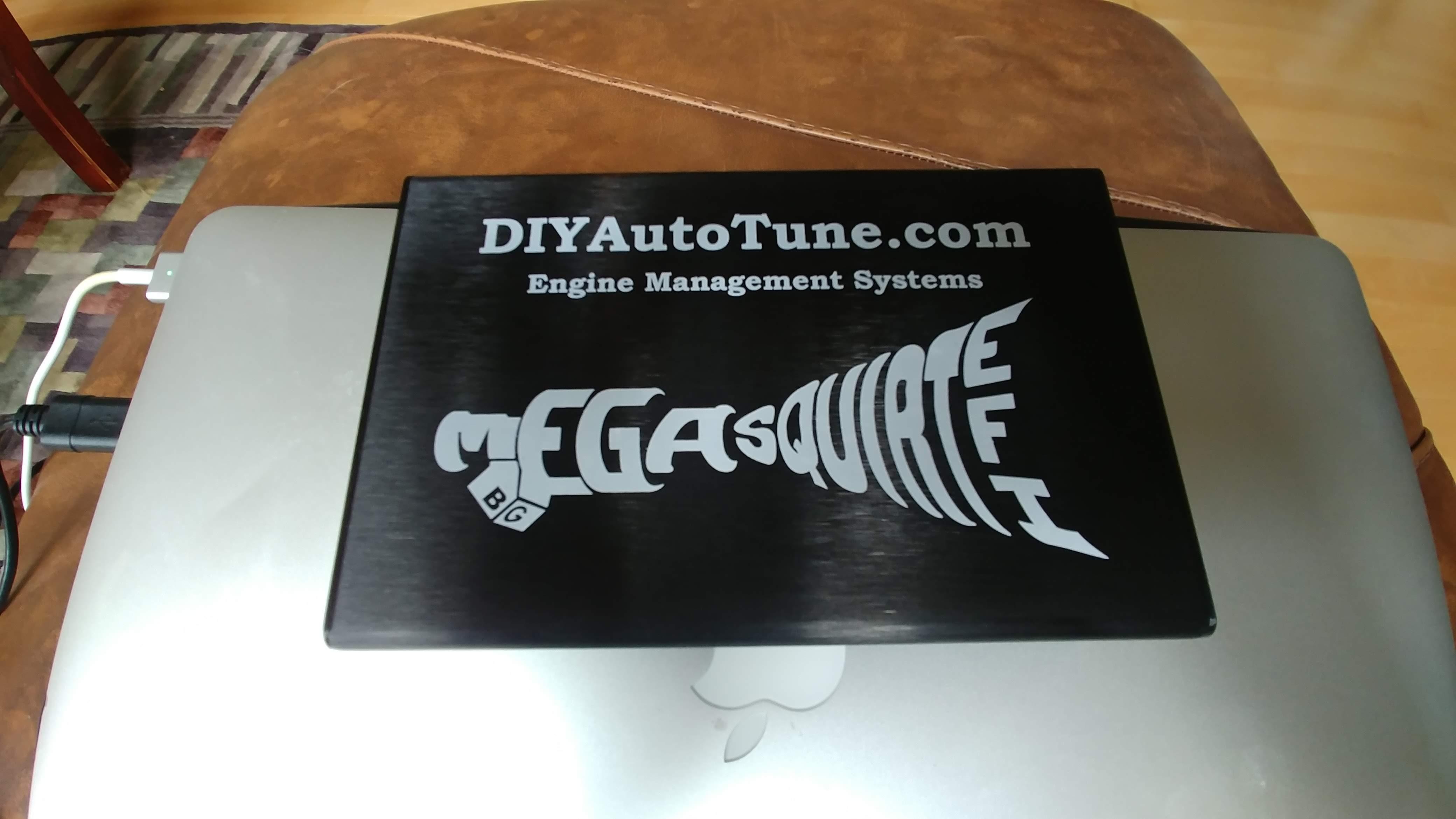

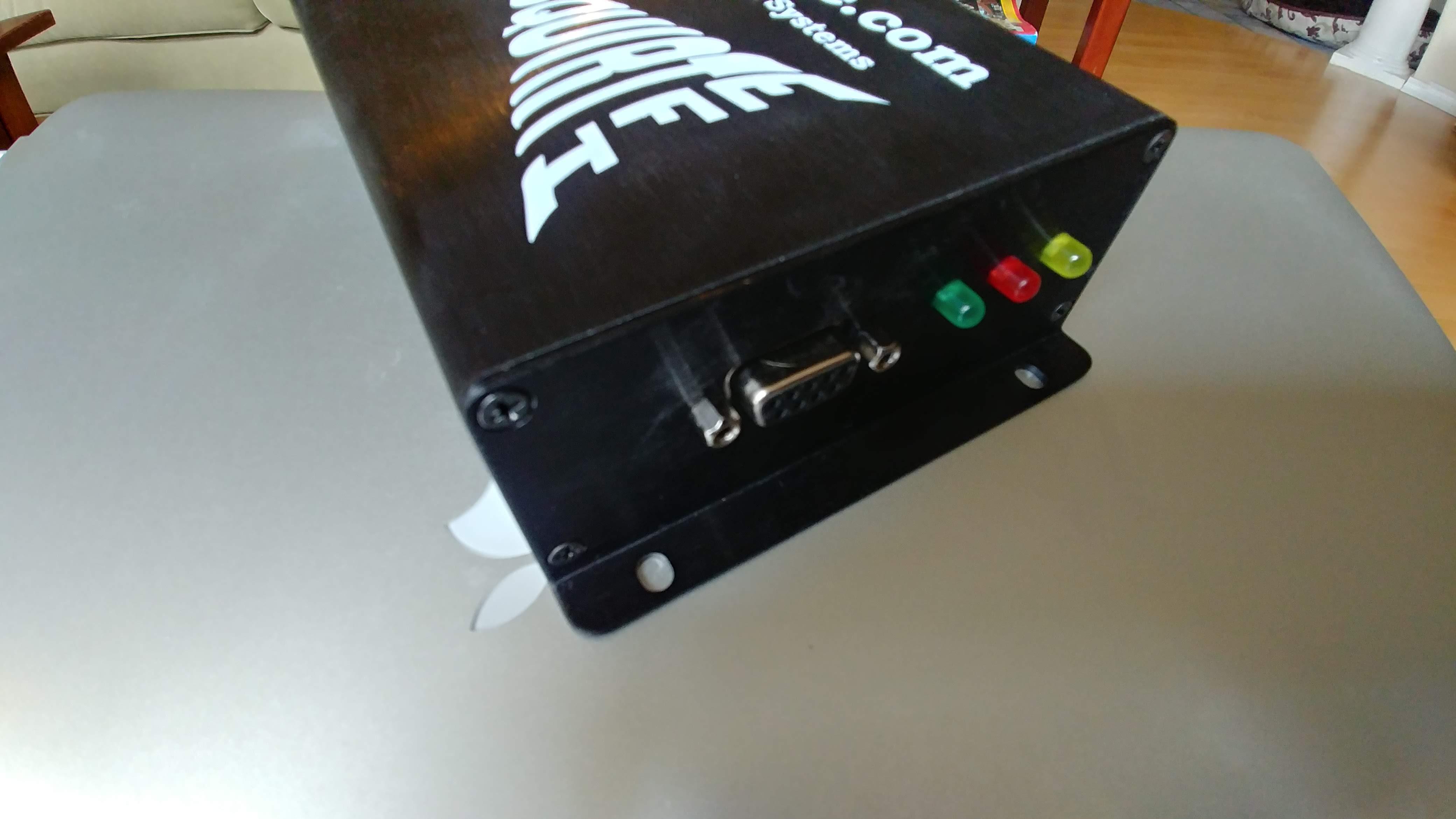

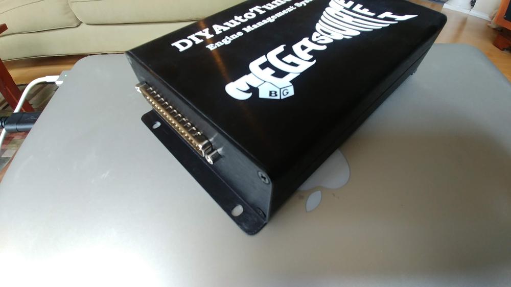

Well I went through the Megasquirt, resoldered every joint, added led and trimmed some long legs on board but it looks and tests good. Cross fingers.

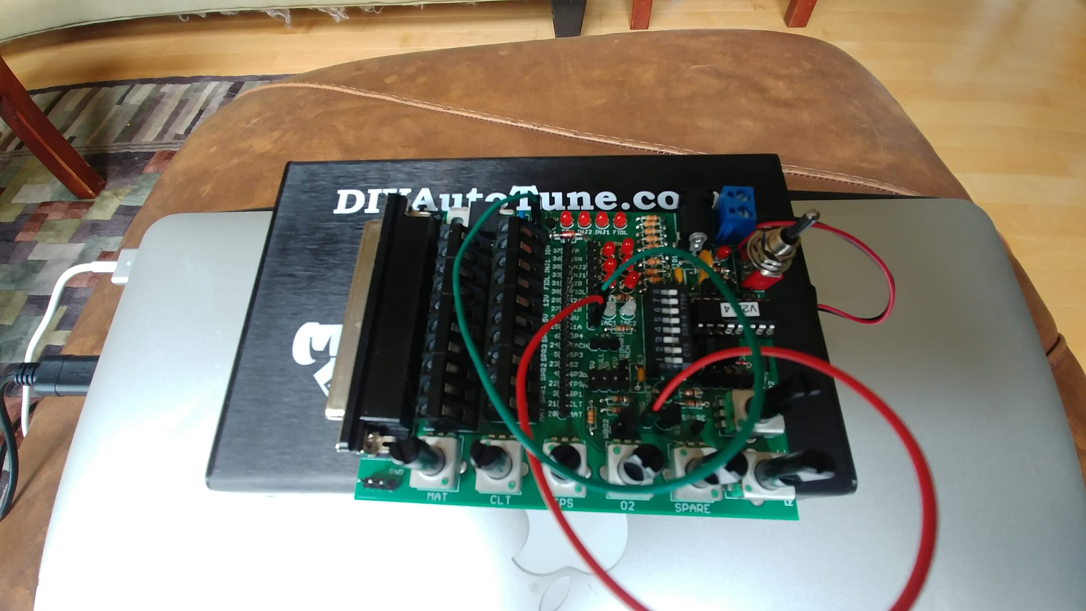

Jimstim built and tested as well.

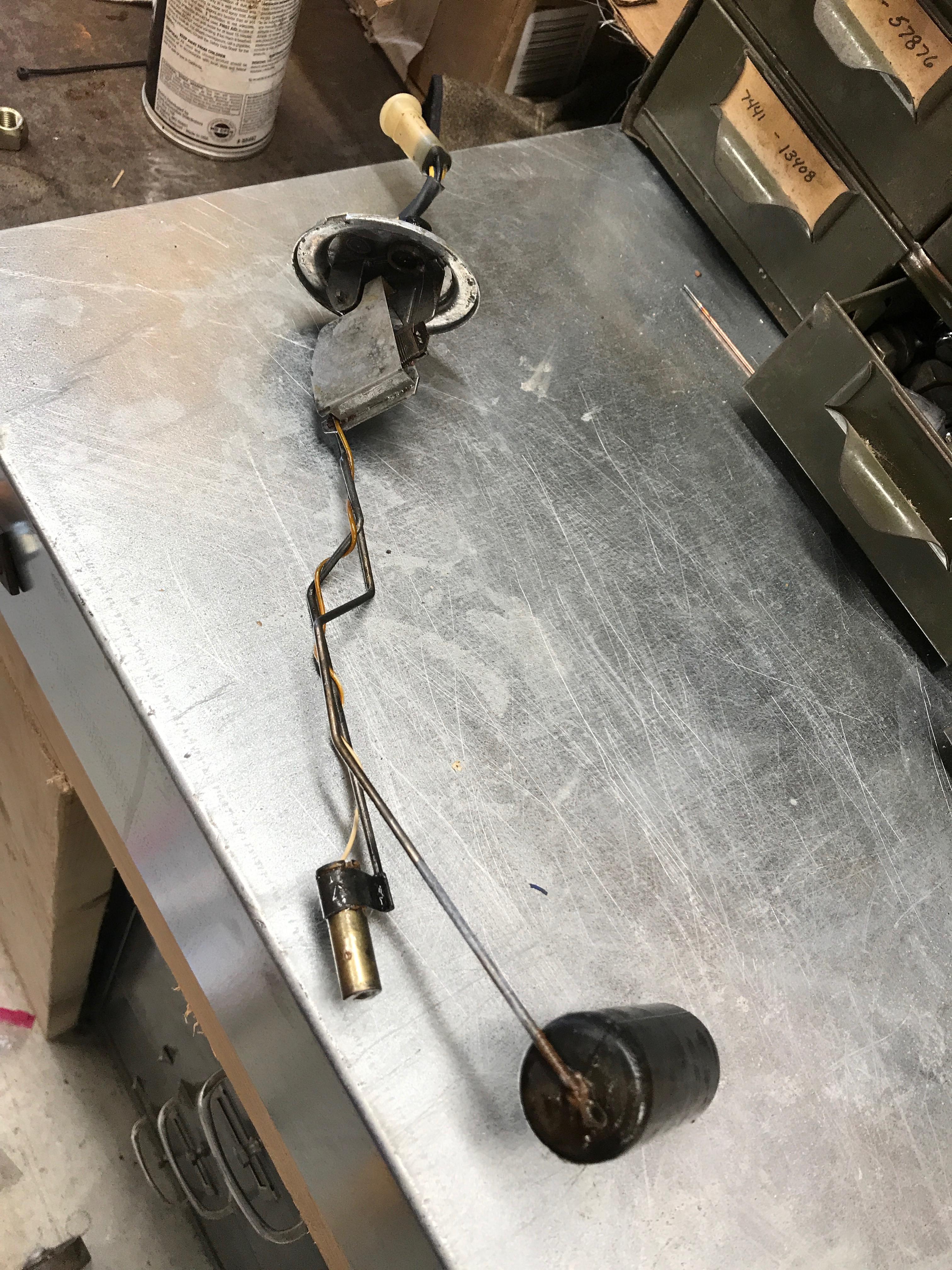

I removed my tank today to fully drain, inspect and clean tank and pulled the unit. Fuel as pretty nasty. I see some corrosion in tank but I'll take it to a pro to inspect.
Pretty rusty and corroded so I need to do something. I didn't think they would be expensive replacement but was shocked when I checked.
I'm in the same boat, I did an ohms test and the float is working so I don't want to screw it up. I'm planning on taking a dental pick to it and scrape the worst off of the crud, just be very careful of that thin wire.
Get a bucket of white vinegar and drop it in, you’ll be amazed! Don’t forget to do a baking soda and water mix after it’s clean to neutralize the acid.
white vinegar can be had for 2.50 a gallon . 5 or 6 gallons in the tank rotating a few hours or more and you’ll have a clean tank. Might need to use a high pressure hose to knock loose some stuff, but the vinegar is great and a great weed killer

1 hour ago, Patcon said:
Some people have used CLR in the past. I am confidant that it is a weak acid too which is what makes it effective
So it seems like you two are suggesting that instead of me spending money on getting tank professionally done that I can do some of this on my own? I'm down for saving money for sure.
How about sealing it?
Some people use Redcoat . POR15 makes a tank liner. Eastwood does. I just recently used a Caswell epoxy product. If you follow the directions closely sealing a tank is a DIY project
I followed up with Por-15 tank sealer kit. I used the white vinegar first and then followed up using the por15 instructions. The marine clean is an excellent product for cleaning, but they only supply you with a quart in the kit, so why I go with vinegar to remove rust
