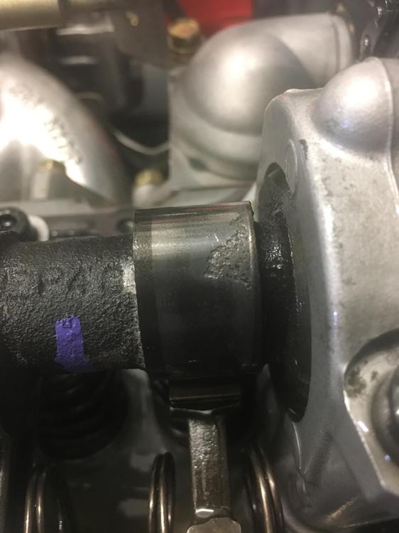

I couldn’t agree more Cliff. I only used a Schneider cam once (same specs as yours).It lost metal off of the number one lobe in the first 300 miles (and I did all the zinc and break in procedures) and I have never had a problem with an Isky regrind from the original Datsun billets. It’s not Schneider’s fault, they can only grind the new billets available, and they just aren’t up to snuff with the Japanese stuff. Many have been successful with Schneider’s on the new billets, but if I’m going to build an expensive performance engine, I don’t want to take any chances. IMO
