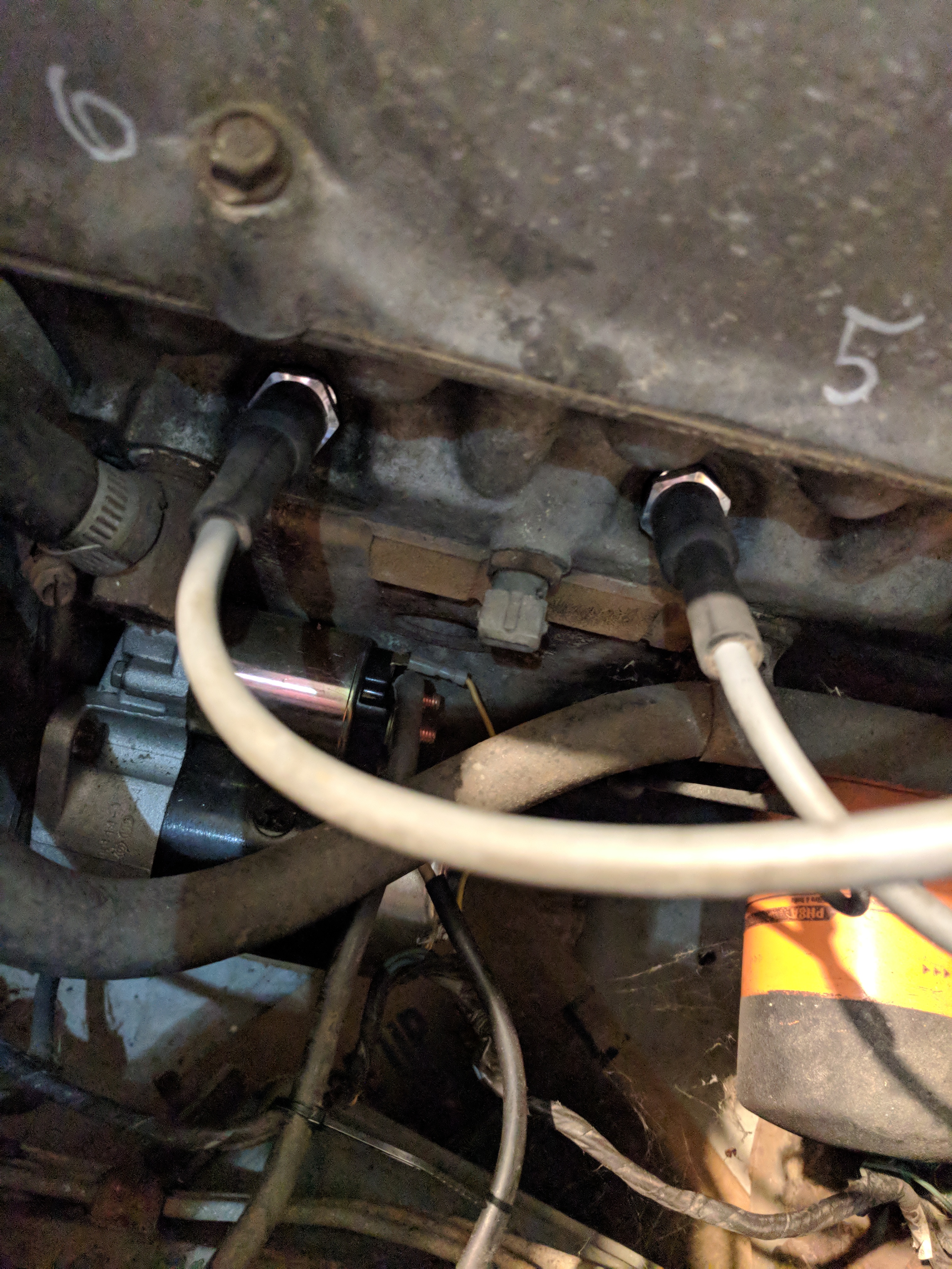

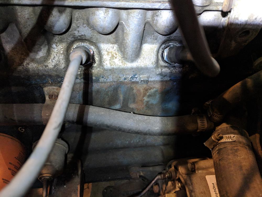

Quick (hopefully) electrical question:
My temp sensor (the one on the block below the #5 spark plug, picture below) is disconnect and I can't seem to locate the plug for it.  I will continue searching, but in the meantime, does anyone know if this sensor is an input to the EFI system, or does it go to the dash gauge, or what?  I ran my EFI bible checks and the temp sensor check came back ok, so I'm assuming that one is the one up in the thermostat area..
Thanks,
Ben
It is part of the ZX EFI. What engine do you have, F54? Or just a different head? Your temp sensor is located in the thermostat housing. Thats why you can't find a plug to the one in question.
I wouldn't worry about it, just leave it in there.

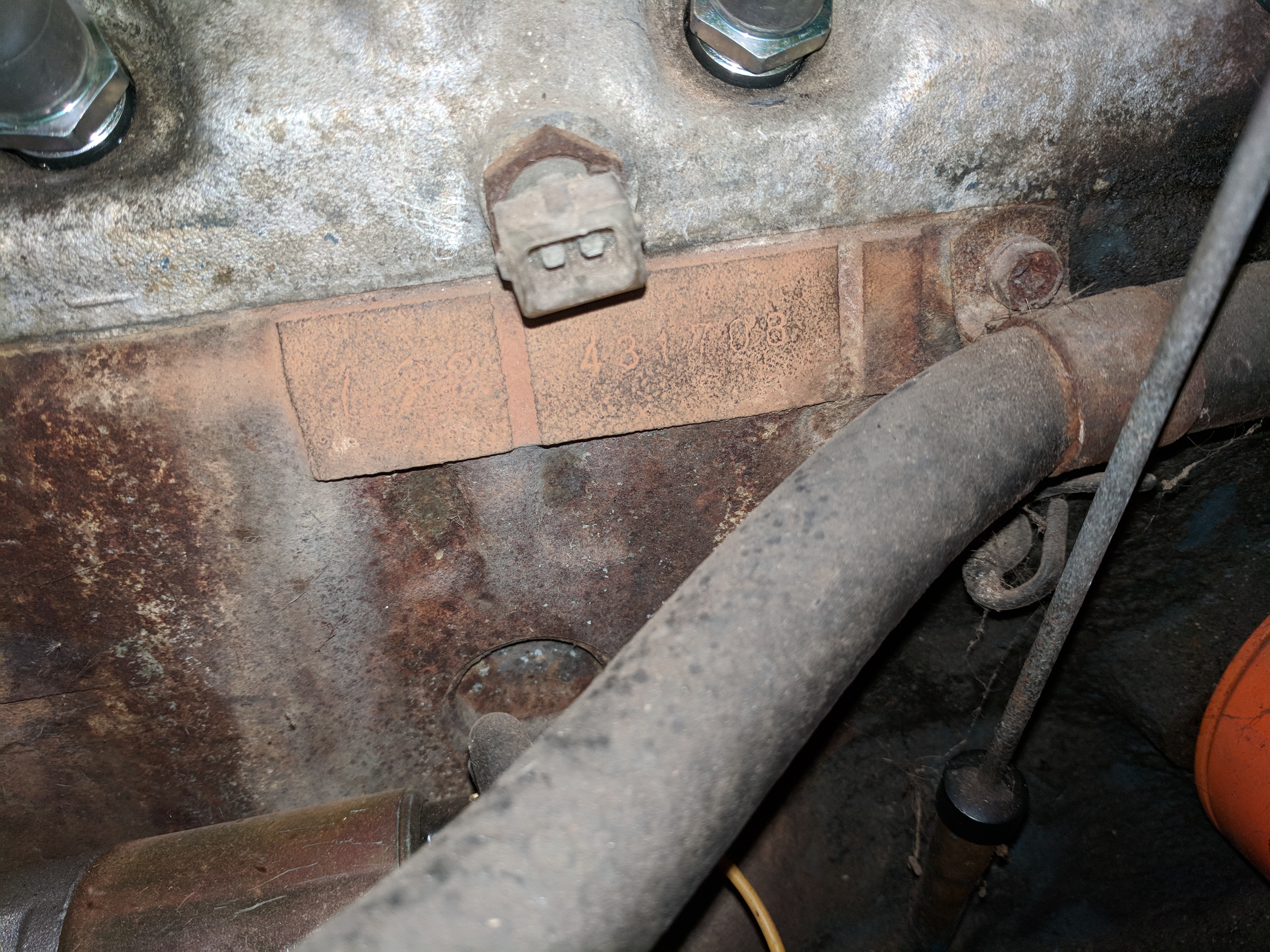

Took a couple pictures of the head and block.  Head says N47, block is L28 431708.  I think I grabbed the wrong number off the block though.. its supposed to be by the motor mount you say?
Yes, the block type number is by the driver's side motor mount.  It will be either F54 or N42.
But, it's looking like you have the MN47 head, as people like to call it.  A smaller combustion chamber, giving higher compression ratio.  But also smaller valves.  More endless discussion about pros and cons...

I'm going to guess N42 for the block....oil pressure sensor looks to have a single wire running to it.
