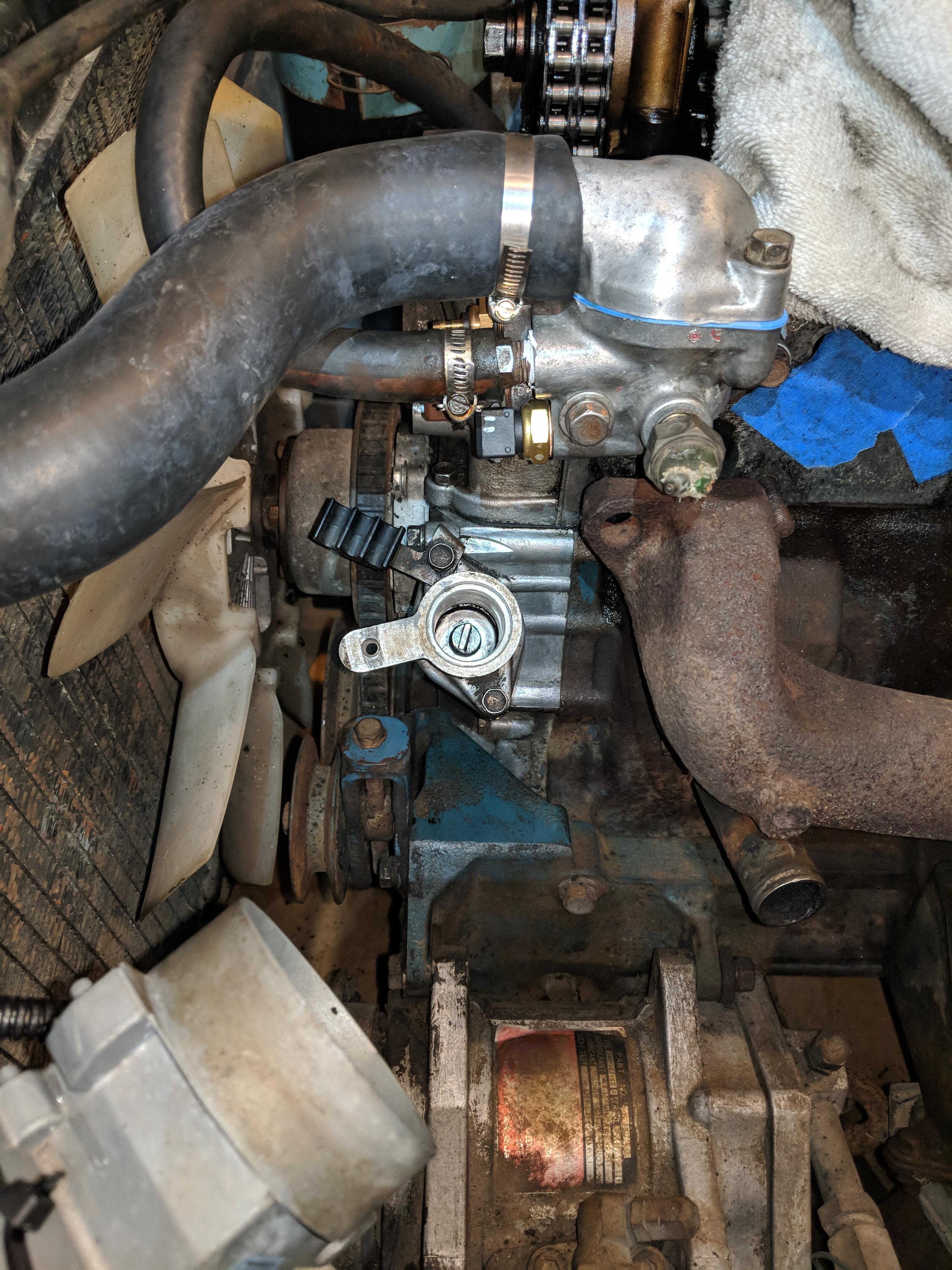

Thread resurrection!  Thanks again for all the help.. but I've run into another issue with this whole timing problem and would really appreciate a sanity check here.. ?

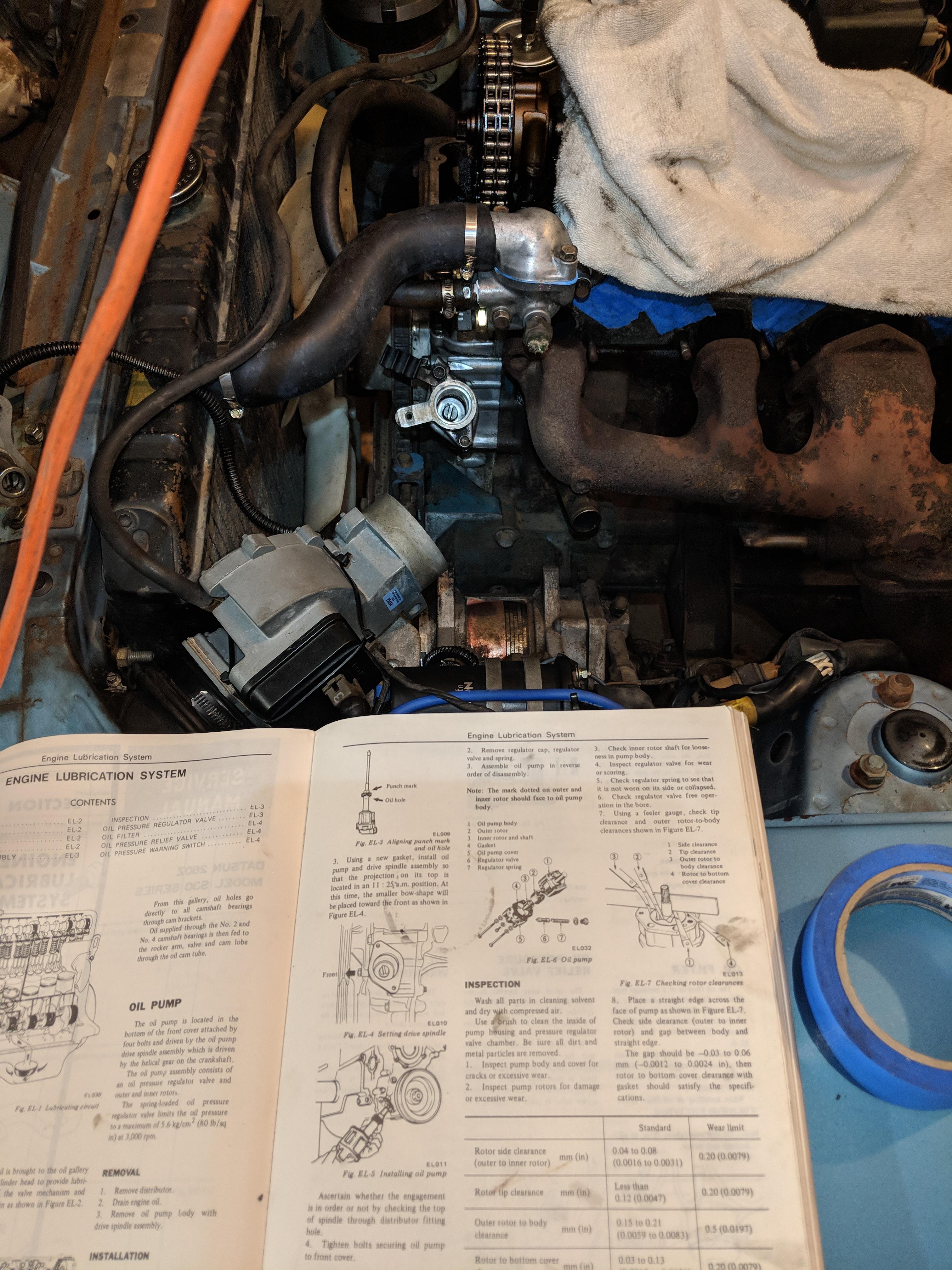

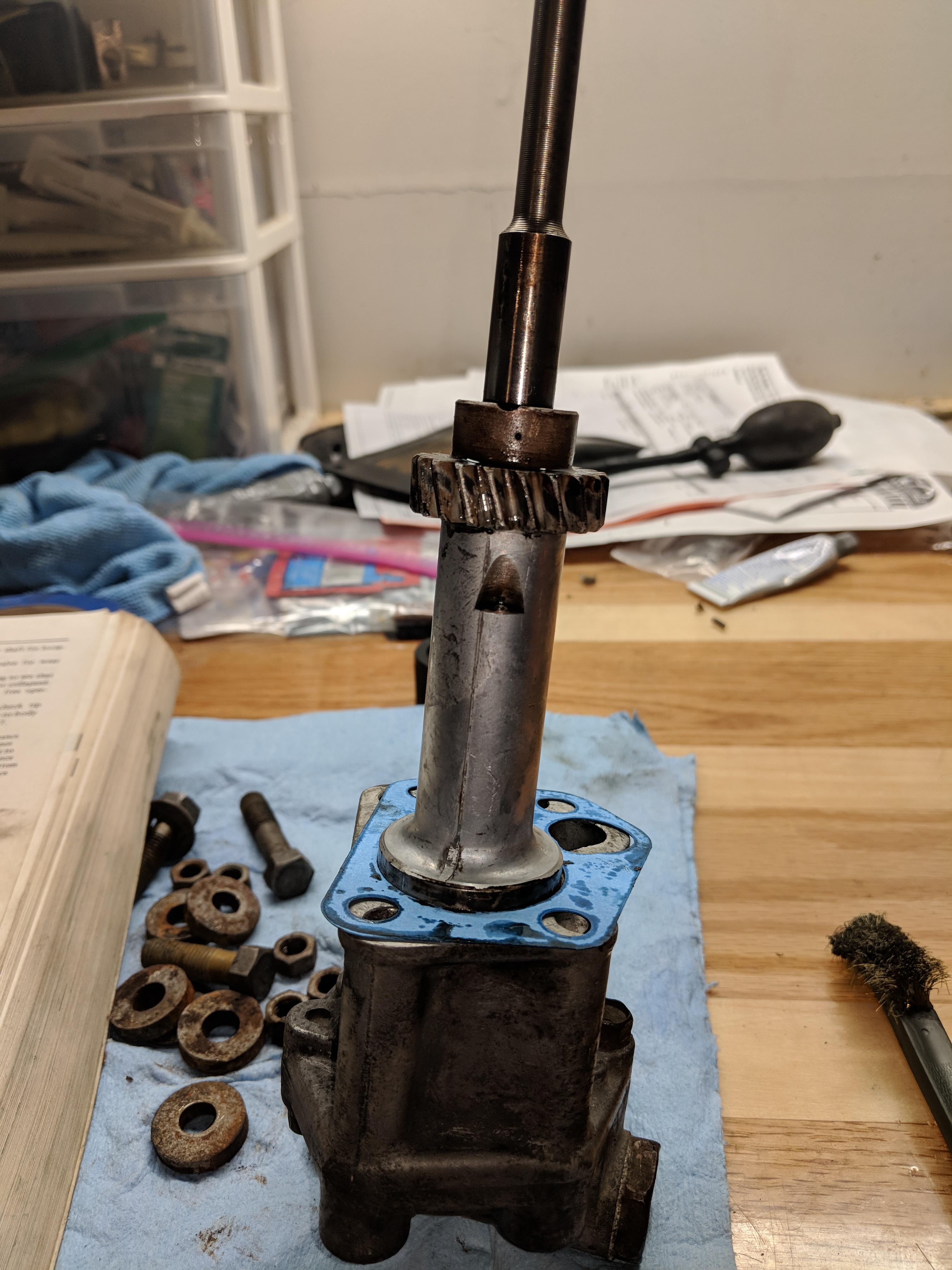

I finally got around to removing the oil pump, but ran into a problem when I went to re-install it. I've aligned the spindle and the pump as per the FSM (punch mark above the oil hole), and then reinstalled the assembly, but it still looks wrong.  I'm at about 1 o'clock, while the FMS is at about 1130.. what am I missing here??  I was very careful not to turn the spindle during install (actually put it in twice; ended up the same orientation each time).  Cylinder 1 is TDC.  Timing mark is right at 0deg.  My brain officially hurts.. I'm about to just skip the 'align the oil hole with the punch mark' and orient it so the top of the spindle matches the FSM so I can clear up this timing issue.  Would that cause any issues?  What could lead to this condition?  Improper rebuild of the oil pump by PO?
Any feedback would be appreciated ?
That's what I might  do.  I re-read my own comments above and couldn't figure out they'd guarantee distributor orientation.  Sorry about that.

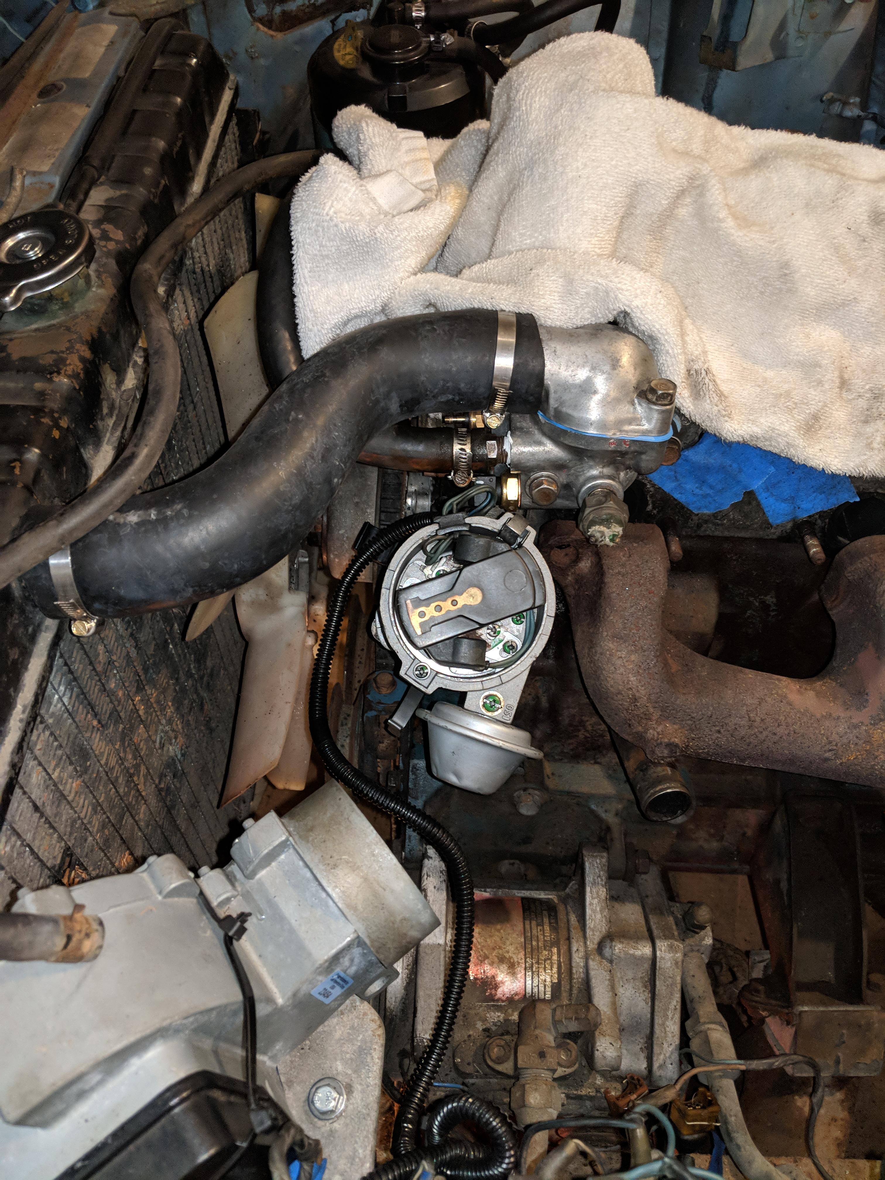

Alright, I got under there again last night and took another stab (or rather a dozen) at aligning this thing.  The procedure mentioned in the book siteunseen posted worked; if I rotated the oil pump CW while I inserted it until flush, and then rotated it so the bolt holes lined back up after it was flush, it would produce the CCW rotation up top.  I ended up with 3 'options' (I'm assuming these are based on the gear teeth spacing) and went with the one that pointed the distributor rotor at the #1 plug (which was the most CCW one).  I think the vice grip method could work, but I didn't have vice grips long enough to hold the top of the spindle.
Hopefully this resolves the timing issues.
Y'all are awesome; once again appreciate the help!  I'll probably post again once I finish rebuilding the intake manifold and get it all back together and see where the timing is at..
this is the final orientation of the rotor:
This was the final config:
This one looked better, but the distributor still wasn't quite pointing to the no. 1 plug:
