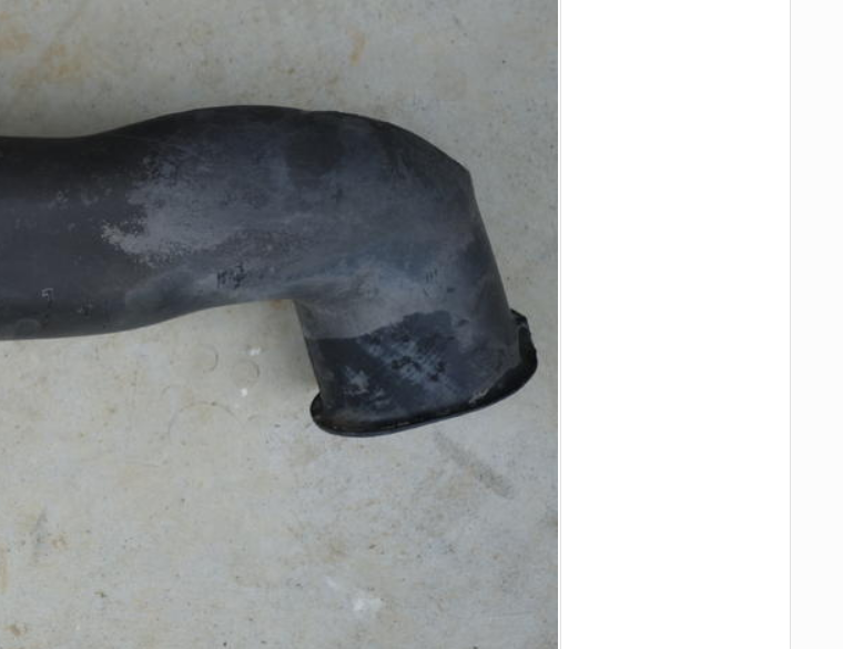

June 25, 20187 yr Author comment_551740 29 minutes ago, Zed Head said: My 76 Federal has a snorkel. 1/76 build date. does yours also have a plastic plenum that connects from the rad support (where the snorkel terminates) and then back to the inside of the fender? (looks like a fresh air supply for the inside vent but not sure about that). If I were to hook up my snorkel it looks like it would pull air from inside the front passenger side fender. I scoped inside there once and it just opens up do dead air, not a supply all the way back to the vent. Link to comment https://www.classiczcars.com/forums/topic/59772-280z-air-filter-housing-snorkle/?&page=2#findComment-551740 Share on other sites More sharing options...
June 25, 20187 yr comment_551743 No I don't have that, but I don't have the manual vents inside either. For some reason cars with AC run all the fresh air through the blower system. Very disappointing, it would be nice to have a simple manual fresh air source, besides the windows. I've tried to figure out how I could transplant one over but haven't found a car to pull from. My snorkel just pulls from the right front corner of the engine bay. But I've disconnected it at the other end, like site did, just to get some intake honk. That entrance hole seems so small, and the flow path tortuous. I can feel that extra 1/10 HP... Link to comment https://www.classiczcars.com/forums/topic/59772-280z-air-filter-housing-snorkle/?&page=2#findComment-551743 Share on other sites More sharing options...

June 25, 20187 yr comment_551749 21 minutes ago, Zed Head said: But I've disconnected it at the other end, like site did, just to get some intake honk. That entrance hole seems so small, and the flow path tortuous. I can feel that extra 1/10 HP... Yes! That 1/10 HP. Way cheaper than something like this... Link to comment https://www.classiczcars.com/forums/topic/59772-280z-air-filter-housing-snorkle/?&page=2#findComment-551749 Share on other sites More sharing options...
