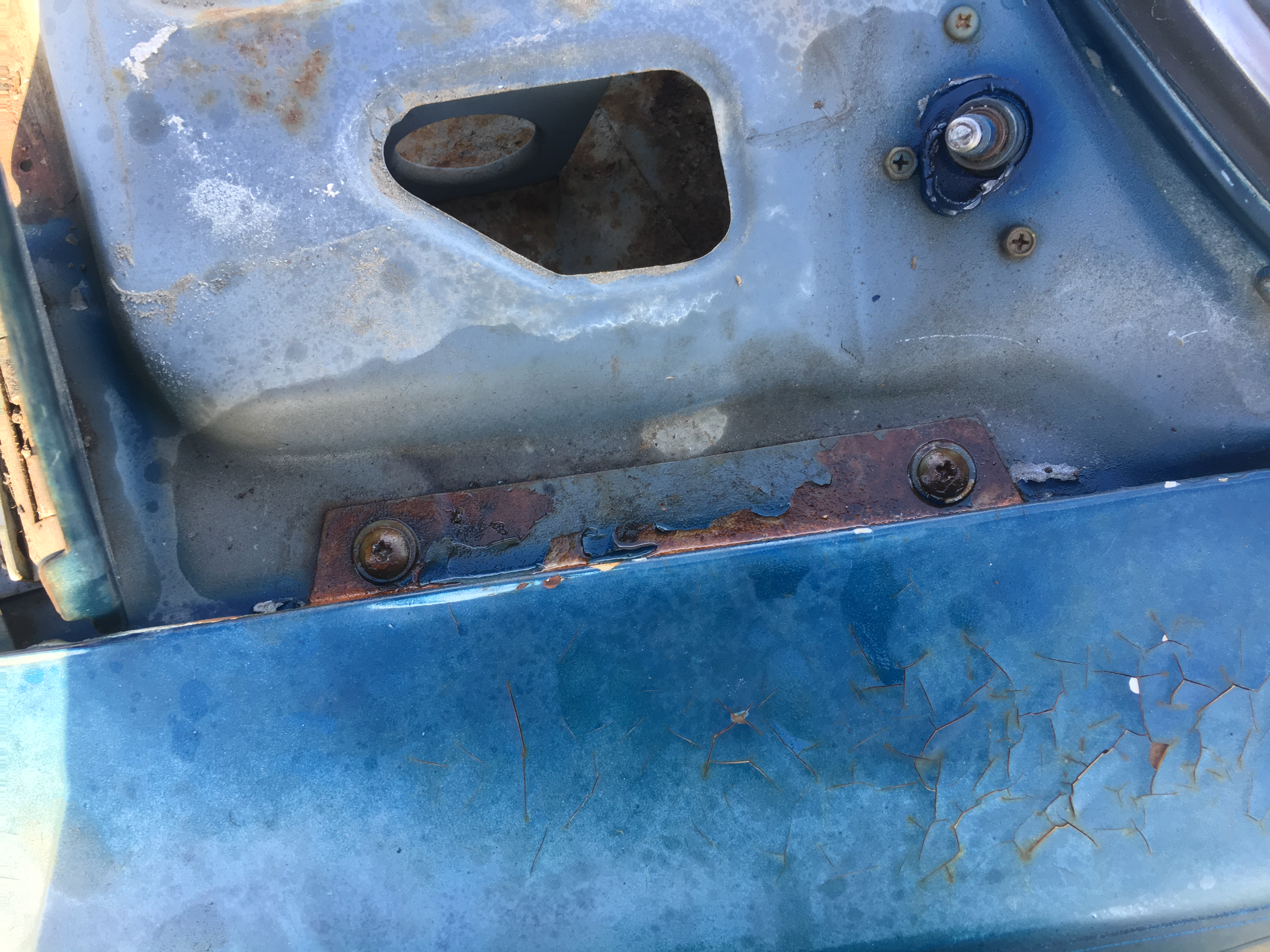

Now, I spent most of Saturday trying to remove the fenders. As you can see from the photos, it looks like some nice person previously jacked the car up right where the fender bolts to the sill. Short of cutting the bolts off, any suggestions on getting these 2 bolts out? Similar story on the opposite side! I did try to bend the pinch weld back but couldn't get much leverage on it. Also, as I'm sure is pretty common, the 2 screws underneath the cowl are stripped on both sides. Any advice for getting these out. Finally, do the headlight buckets have to come out before the fenders can come off?

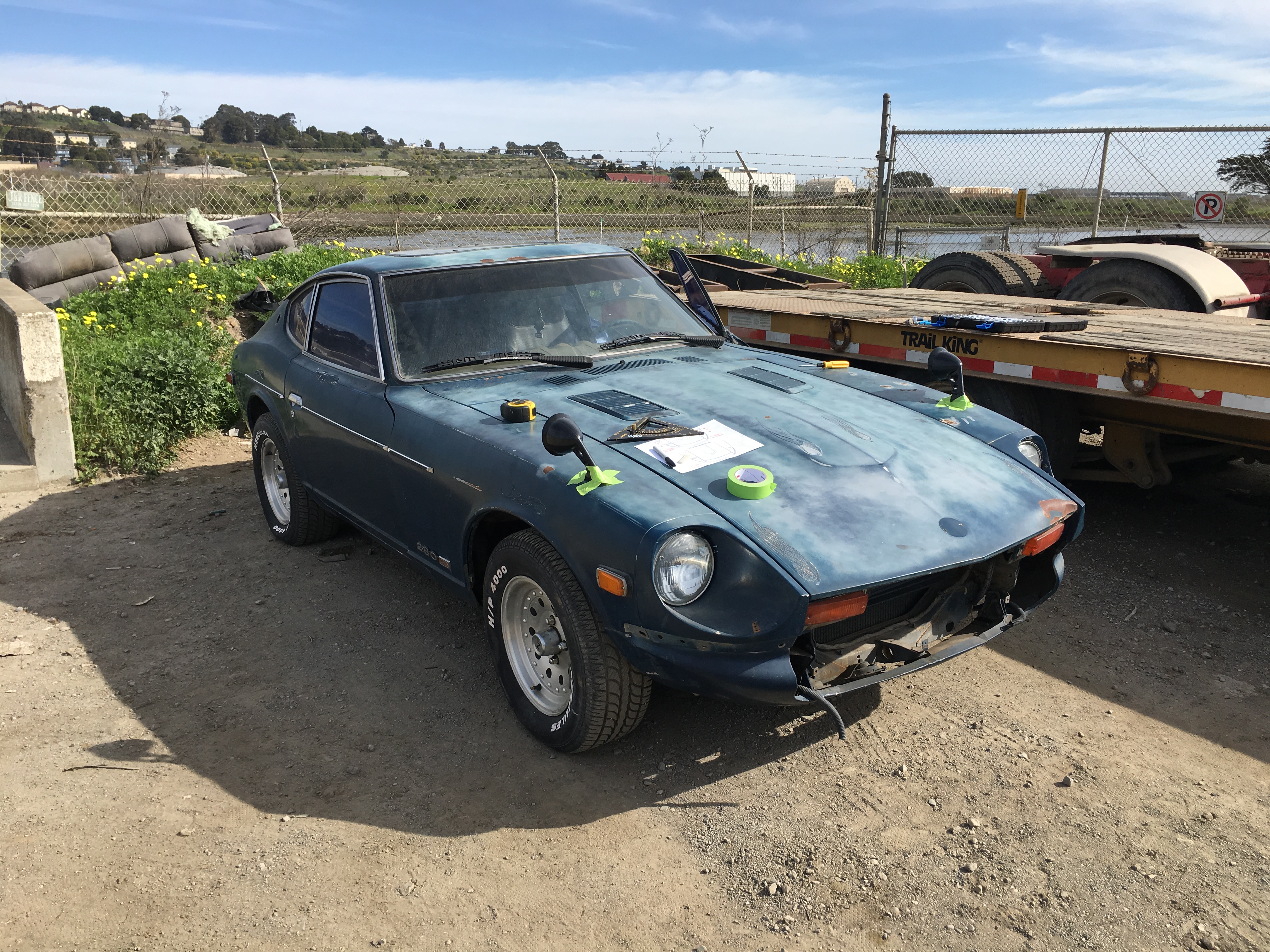

I also cut that horrid rear bumper off. Planning to fill any holes next weekend but I need to remove the chrome trim that runs the length of the body along the doors first. I thought this would be pretty easy to remove but it doesn't want to budge. What's the easiest way to remove this?

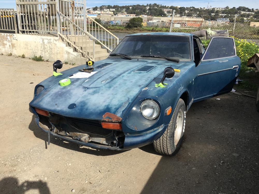

I also marked out the locations and roughly fitted the fender mirrors (I figured I better do this before the fenders come off).
 Lower fender bolts, I had to bend the bent flange down to get to mine. Used a Crescent wrench, (adjustable spanner) to get the leverage to bend it down.
 Cowl screws, copious amounts of penetrating oil, heat, cut a straight slot in the head with a Dremel Tool.
 Headlight buckets can be removed with the fender.
 Side trim, heat. I'd try a hair dryer first. If you use a heat gun, take care, the sheet metal is very thin.
Ok for the bolts underneath the winshield cowl, take a screwdriver that really fits, then take a hammer and try to shock them with not too heavy of an impact in order to avoid bending the panel. If this doesn't work go to O'reillys, they sell a can of propellant that freezes bolts and nuts temoprarily and they shrink to allow them to break free. Next for the place on the lower valance the was used to raise the car take a 2X4 and a heavy blow hammer (4lbs or greater) and just try to slowly move it away. The bolt that was driven through the lip should not be there. Remove those on both sides and more than likely the fender will pop away from the chassis. When you do this you may find that the lower valance that runs the entire length of the door may need to be replaced. The vertical bolt that holds the fender on probably either was broken off before or cancer took care of it. This is the worst case scenario so be prepared when you do remove the fender to assess the rest of the repairs that may be needed to put everything back the proper way. The lower valance for both sides can be ordered from several vendors but they have to be welded on. This car appears to have sat in the elements for far too many years so every piece of fabric, rubber, and plastic needs to be removed for a true asessment of the task in front of you. Also this will not be a quick restoration, you can do it right the first time or you can do it again in a few years! Now is the time to decide your level of commitment. Good luck I will watch this space with much interest over the next few momths (years) GOOD LUCK!
If the side trim door guards are dealer installed, they are probably riveted in with aluminum backing.  You'll need to pull out the black rubber strips and you will see the rivets. Then drill them out.  If you want to keep the original door guards you should be able to buy replacement rubber.  If they are not dealer installed they are probably a stick on type and the heat gun will be the best way.
