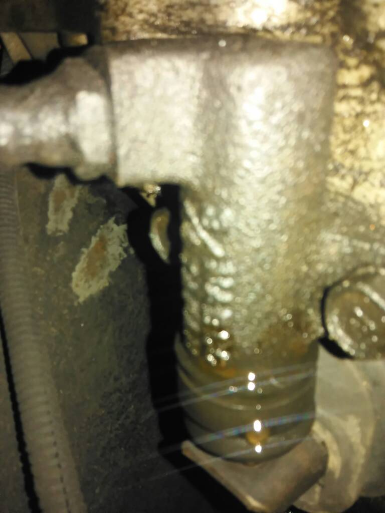

You guys were right. There most certainly is a leak at the slave cylinder.
The Volvo should be back on the road tomorrow, so in the meantime I will remove the one from the parts car and check its worth, and if its questionable I'll order one from rock auto. Hopefully its availability is still reasonable.
I'll check the FSM when I get inside to see if there are any additional seals that need replacing along with the slave cylinder.
