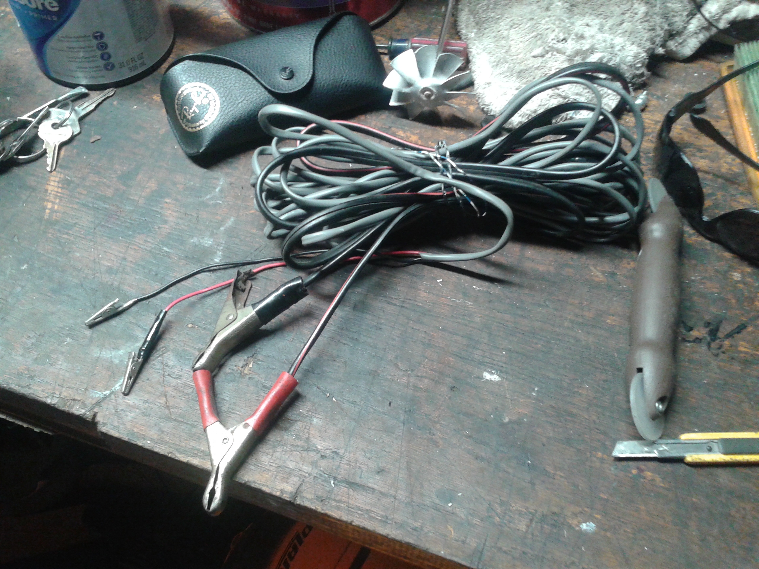

Alligator clips for the pump and the battery I suppose. Fortunately I had a bad charger I robbed the clamps off of.  I use it more than I thought testing things.
20ft of speaker wire.  Hell an old 25ft extension cord would work too.

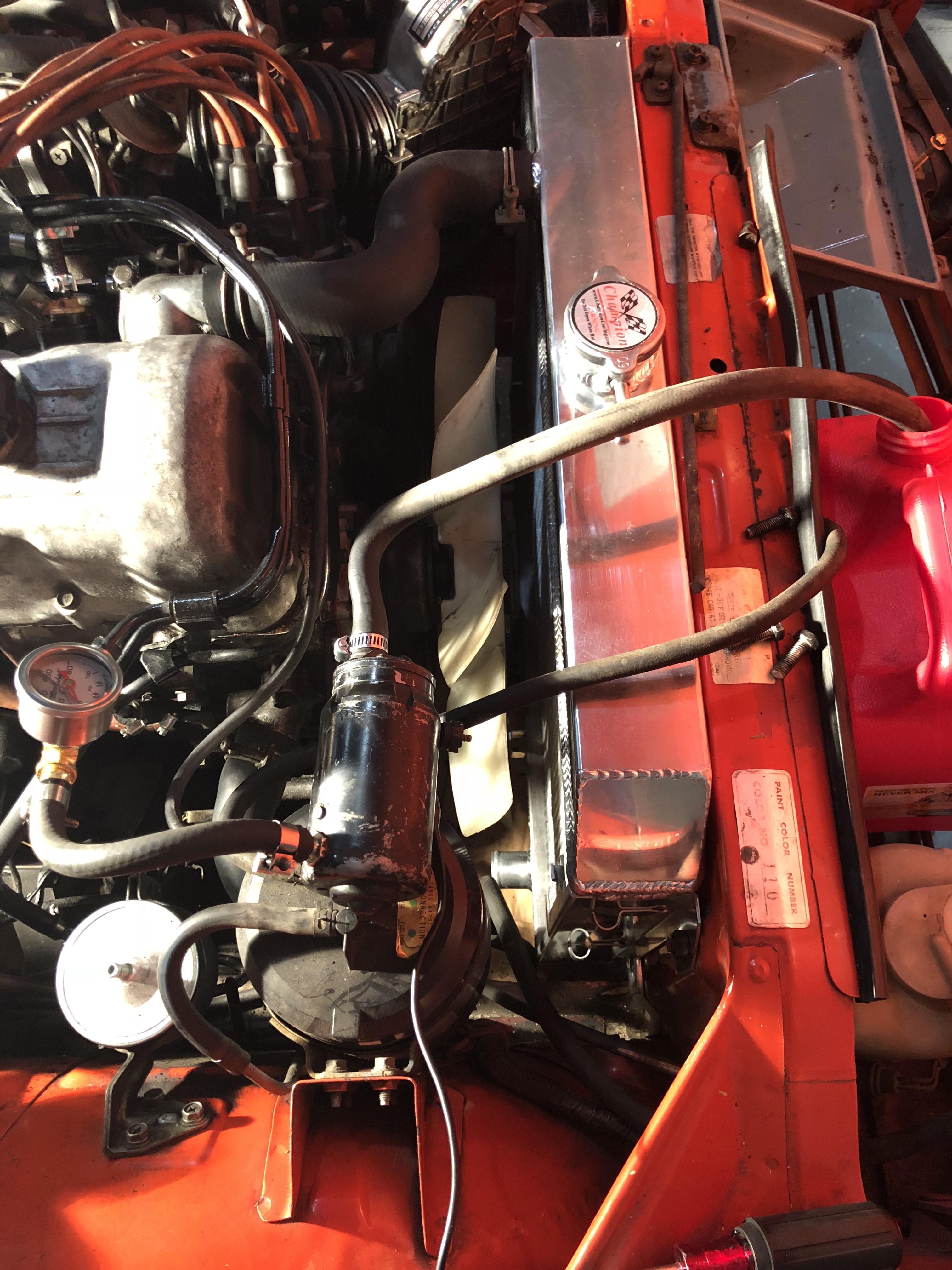

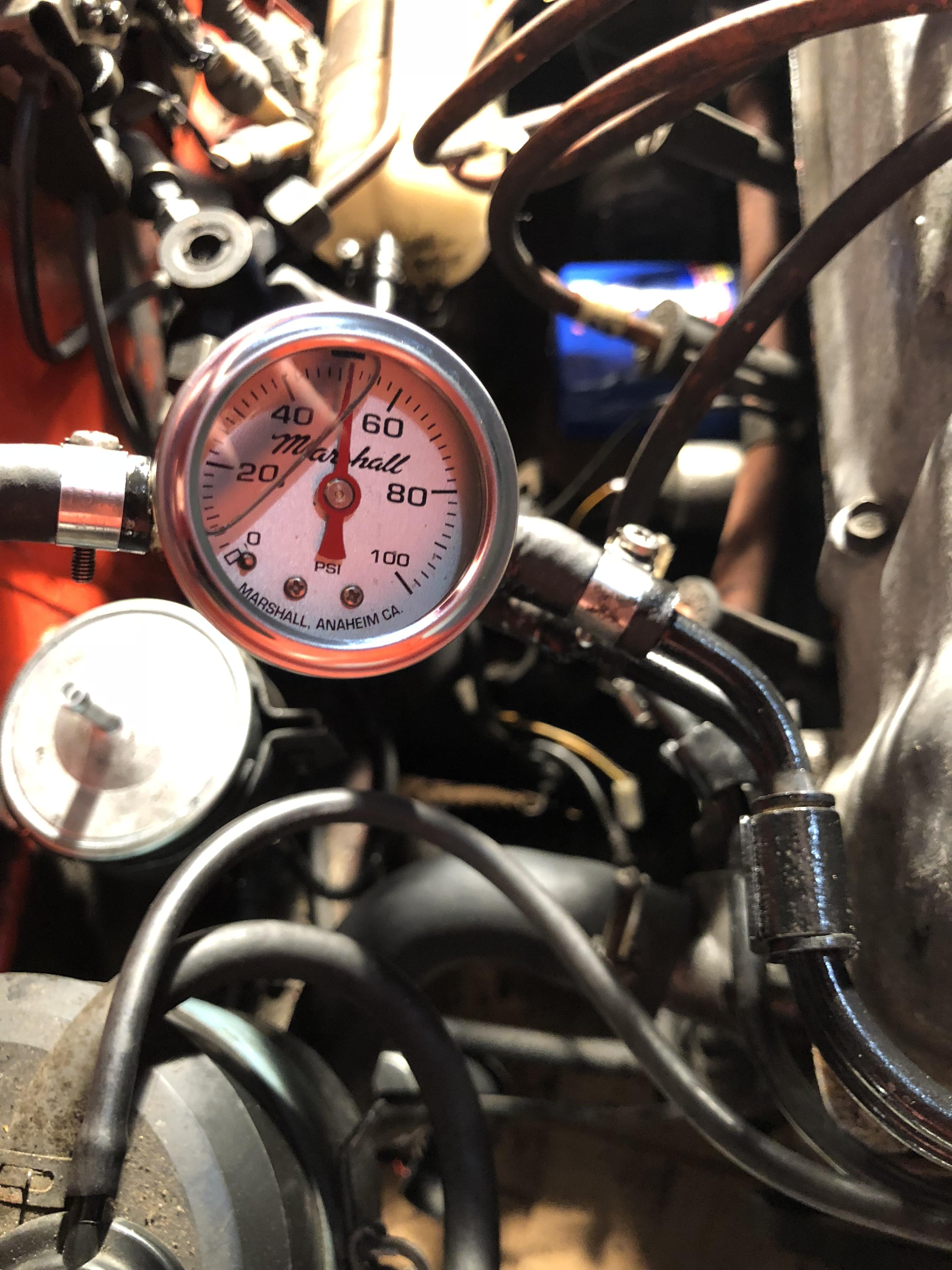

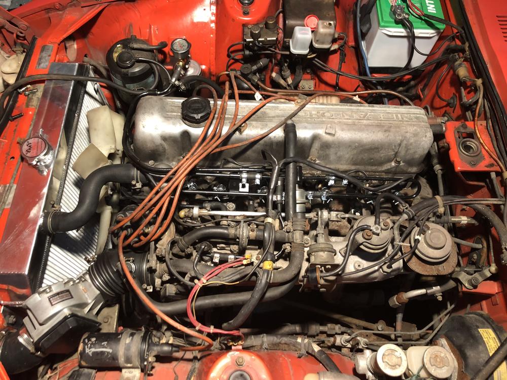

Well, pulled the pump out wired to the battery and ran a hose into a gas can.  When I pressurized the system I had fuel spray out one of the new hoses I installed...oops.  I tighened all the clamps up and did it again.  The fuel press gauge went to 60 psi.  I went to turn the car over and........nothing.   While turning over I hear a fairly loud “psssst” about every 2 seconds while it’s turning over, seems to be coming near intake.  Now I’m wondering if it’s getting a spark....or are the injectors get voltage?  If the pump wasn’t getting power maybe the injectors aren’t either.  Back to the drawing board.  This is getting frustrating.  Check out this ghetto setup.
Just checked the coil is fired by pulling the wire and cranking.  I’m getting a good arc on the shock tower I set the output wire from the coil to.

Are you sure that's what you're hearing?  Your fuel pressure is way too high.  Kind of looks like you have your inlet and outlet lines to the fuel rail backward, and the inlet is pumping in to the return end of the FPR.  Your stock pump has an internal relief valve that lets go at 43 to ~60 psi.  If you pump in to the wrong end of the FPR you'll max out your fuel pump pressure.
The line from the pump should feed directly in to the rail.  The FPR is like a pressure relief valve.  It lets fuel by to return to the tank after set pressure is reached.
Can't remember if the top line or bottom line is the inlet.  Looks like you're using the top as the inlet.  To the FSM....
Just went and checked a rail in the garage.  The top line looks right as the inlet.  Your pressure is too high for some reason.  Looks like you have two problems - no injection and high fuel pressure.  Very close.
