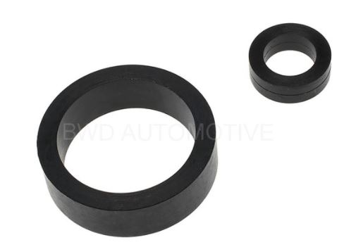

Also ordered new injectors seals from O’Reilly’s.  They were $2.99
https://www.oreillyauto.com/detail/bwd-3123/fuel---emissions-16775/fuel-injection-16471/diesel-fuel-injector-17271/fuel-injector-seal-o-ring-kit-12312/bwd-fuel-injector-seal-kit/274776/2583514/1977/nissan/280z?q=Injector+seal
Looks like the small ones to me... Aspect ratio.  Compare to your full kit picture.  Don't know...
The big ones almost never really need replacing.  They're the part that the clamp presses on to seal the small ones.
Edit - but it won't hurt to replace them.  Unless you stab your finger with the pick you're using to try to peel them off of the injector body.
