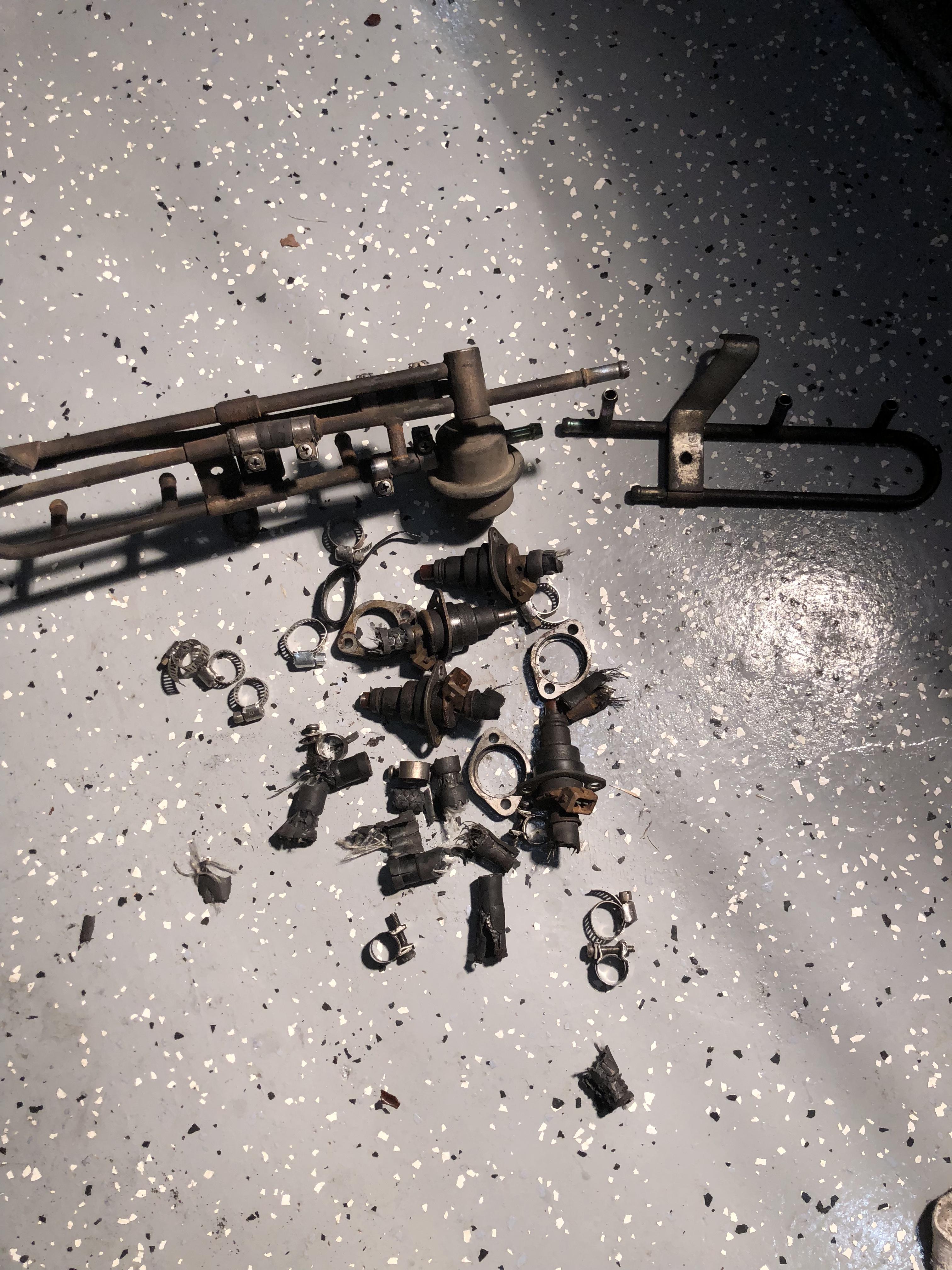

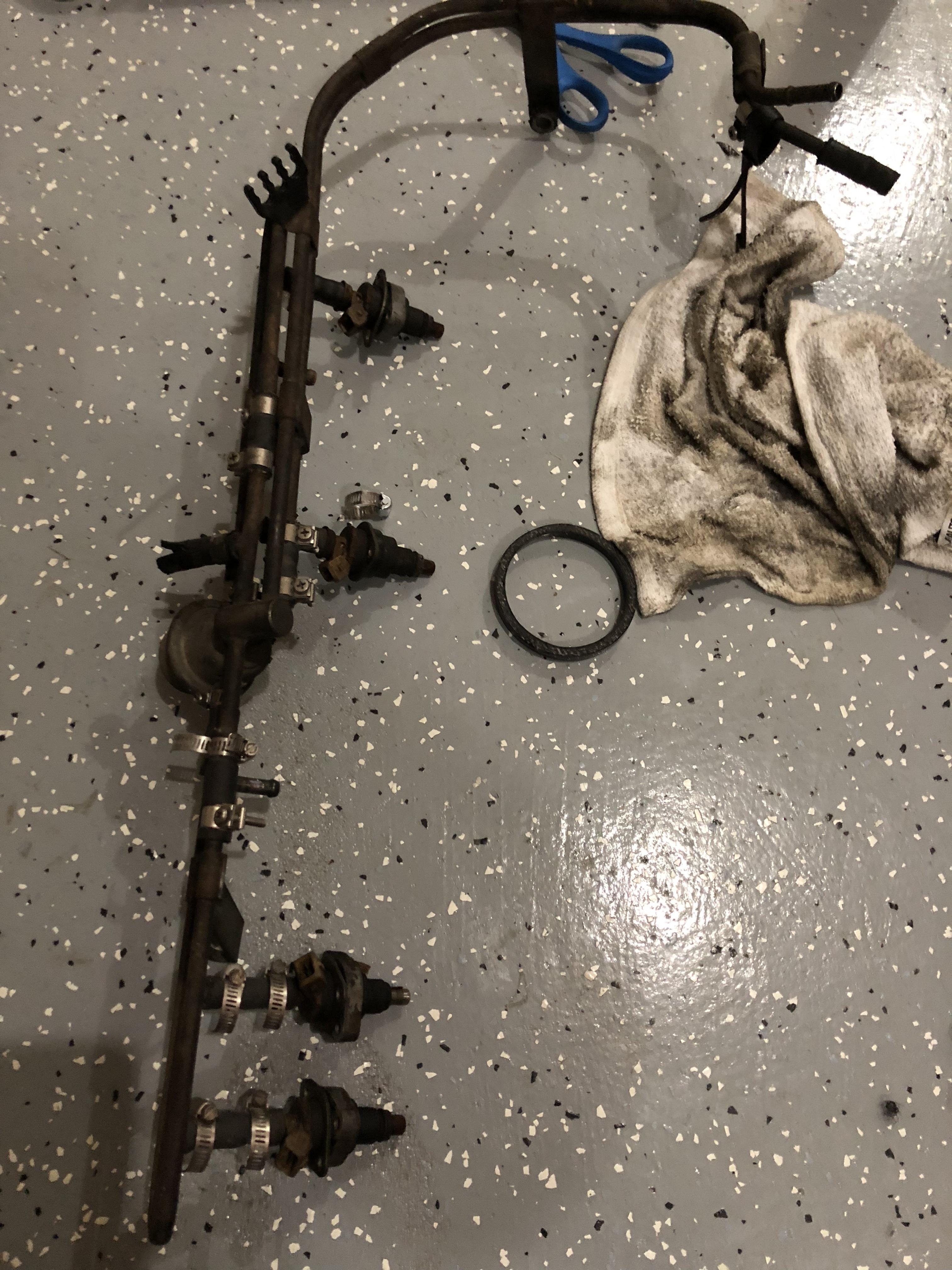

Okay the hoses on this rail are dry and brittle. I’m pulling them all off and replacing them all. I hope I can get this thing back together. I’m also going to lightly sand off the rust and respray it with some black rust resistant paint I think. I’ll also make sure the lines are clear. This is slowing me down but better to do it while it’s off. Going to buy some needle nose vise grips for that stubborn screw. Then buy a Dremel to go the other route if no luck. Look at this mess.  Previous person didn’t use Fuel Injectors clamps, I’ll fix that.  These hoses were bound to leak at some point.

Great progress!  I'm sure you know but in the spirit of site member Captain Obvious,  be sure to replace with fuel injection rated lines.   Also inspect the fuel lines in from the filter & the return for age/cracking.
The injectors are designed to work with no clamps.  The barb locks the hose on.  There's a full procedure shown near the end of the Engine Fuel chapter.  They just press on, it's easy.  5/16" hose.

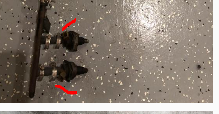

Edit - they actually used too many clamps, marked in red.  They are the bad kind though, so better clamps for the rail connection is a good idea.
