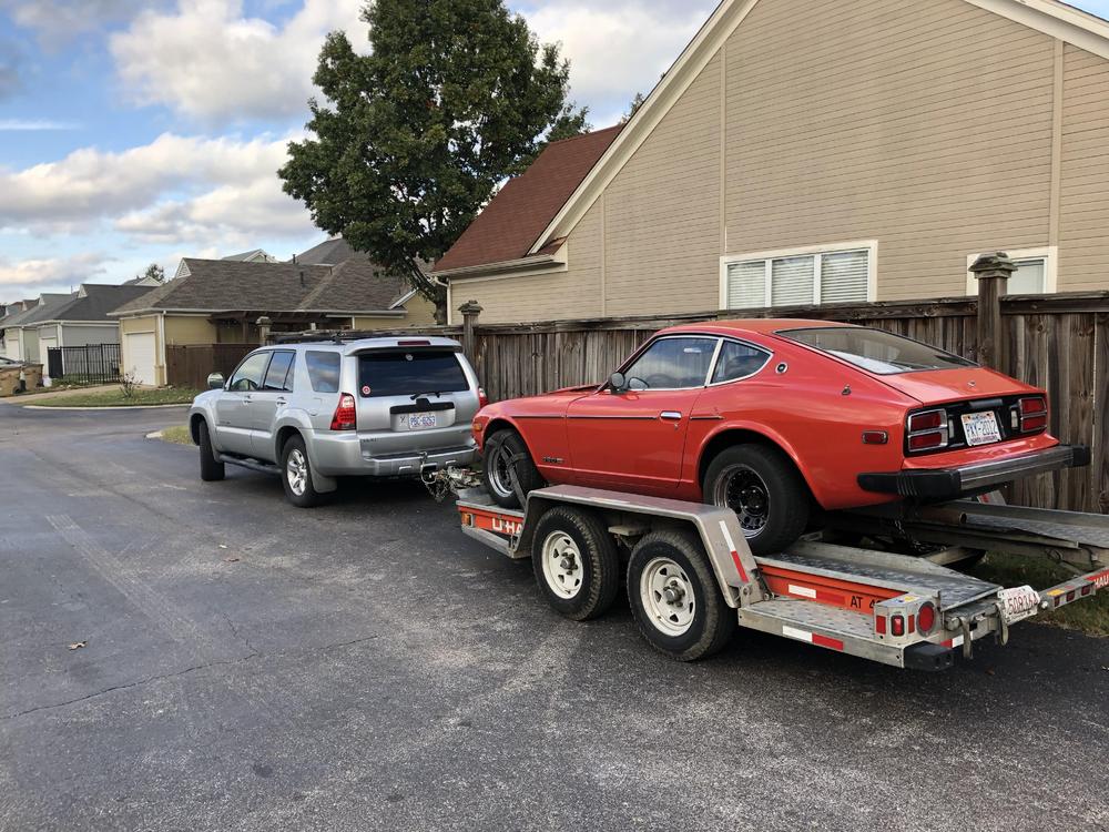

Well gents it’s finally time to move the Z from Memphis to North Carolina.  I’ll now have more access to it so I can really start getting this restoration going. Again I appreciate all the help up to this point it was great to be able to drive it up onto the car transport. I’ll be on the road all day today headed through Birmingham, Atlanta, Florence and then North Carolina
4-Runner looks nice and level, should be a good trip.  Sucks you have to come all the way down to Birmingham but the fall leaves are looking good. ?
