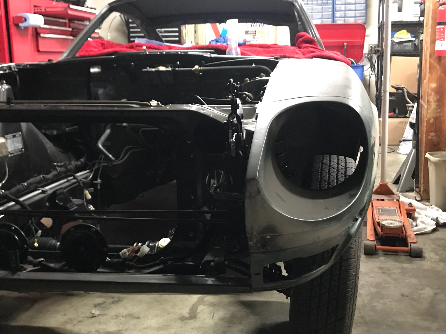

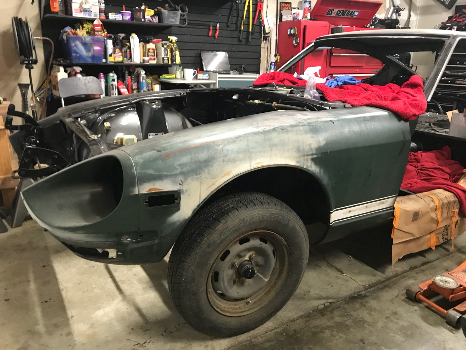

I just lowered my car off the jack stands to install the motor.
I have installed new polyurethane bushing throughout, new struts along with eibach lowering springs for a overall 1 inch lower. My front end does not want to relax and be a natural state. Is this due to not having the engine in? Is the front typically that stiff? Not sure of what the norm is..IMG_4714.JPGIMG_4715.JPG
You have to roll it back and forth.  The wheels and tires move inward as the suspension drops.  They hit the ground inward to the position they should be in, and will move out as they roll.
And yes... The front end will be significantly higher than desired without the weight of the engine. Putting the engine in will drop the height quite a bit.
Got the engine in and it went down abit. Rolled back a forth several feet and is still sitting abit high. It doesn’t feel like much give on the front end. I thought I followed all torque numbers. Could there be anything else?
I completely overlooked the fact that the engine was not in.  400 lbs would make a difference, of course.

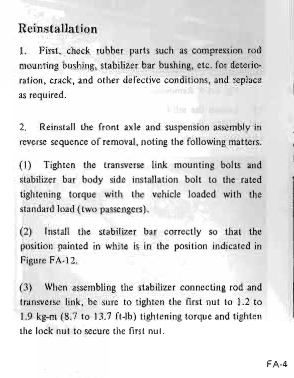

CO has posted on this often - the bushing bolts need to be torqued when the suspension is loaded.  Leave them loose until then.  The factory bushing rubber is bonded to the metal sleeves and actually adds a small amount of elastic resistance to wheel or body movement, once the metal sleeves are locked in to place with final torque settings.  It's described in the Service Manual.
Is this the case with Poly bushings? He said he went Poly in the first post...
I can't criticize writing if I can't do reading.  But, "throughout" doesn't really tell the whole story.  You're right though, if the front link bushings are polyurethane now, then that FSM passage doesn't matter.
