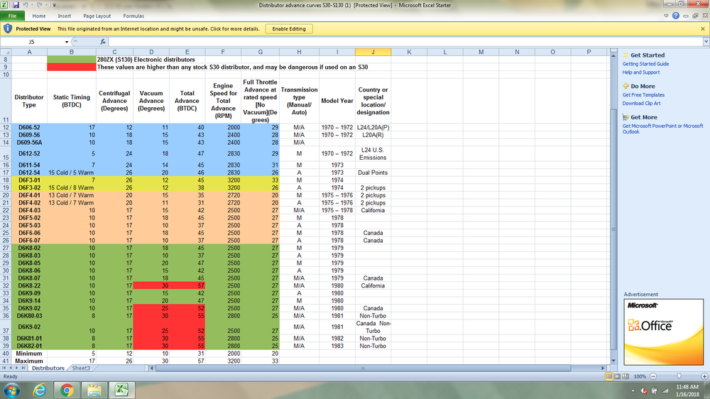

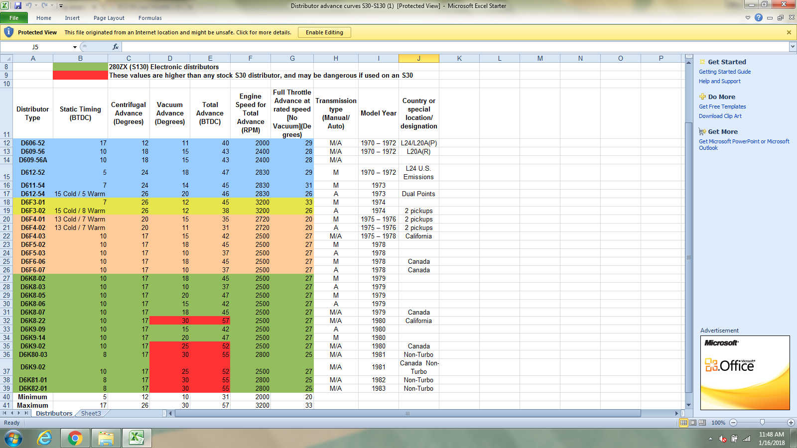

The early ones have the one connection on the module, the later has two connection.  E12-80, early.  E12-92 later.  According to the spread sheet he needs the D6K81-01, which would be the two E12-92 I believe.
E12-92
Image result for E12-92
E12-80
Image result for E12-80
The spread sheet,
1 hour ago, DC871F said:
Comes with new module, but I'm waiting on the third one to arrive from O,Riellys. First one they sent to the store for me to pick up was a core, no joke, even said core on the box, complete with used dirt and oil. Second one they sent me, the module was broken, cracked, and fixed with RTV, so the checks in the mail.....
Do you need just the module?  I know I have an extra E12-80.  Not sure if I tossed the later E12-92.  You can borrow them if I can find the later E12-92.
