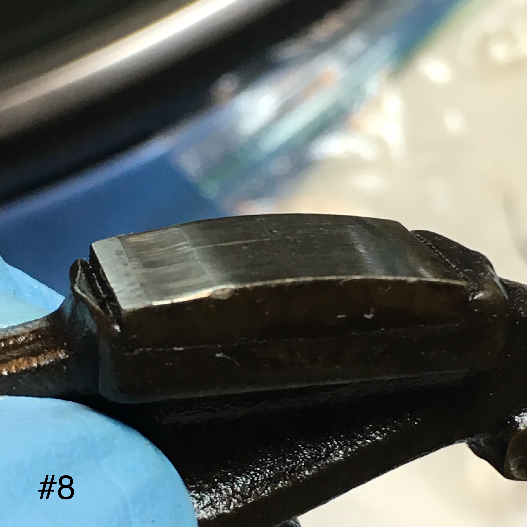

This is what I found:

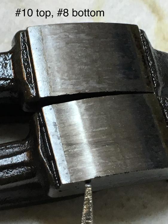

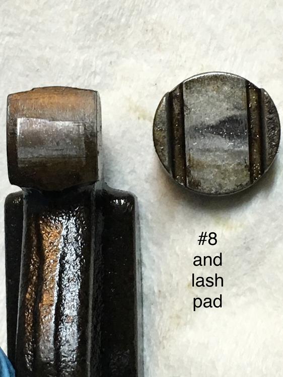

Rocker #8 has a groove that is huge. Also the lash pad for #8 has lopsided wear.
I posted a thread a few days ago about finding all my passenger side camshaft bearing bolts totally loose. I guess this is the result of unsecured cam shaft bearings.

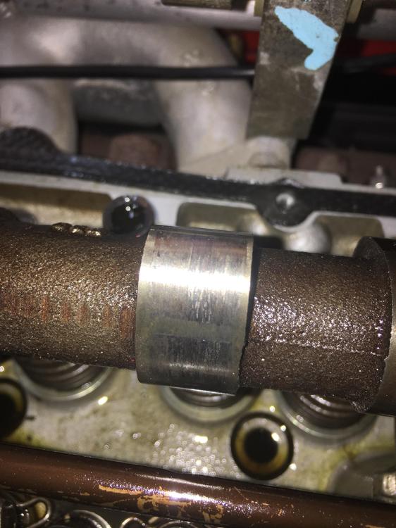

I carefully inspected my cam lobes and they look and feel perfect. I am going to order a replacement rocker and lash pad on Monday. Will I have issues since I am not replacing my cam?

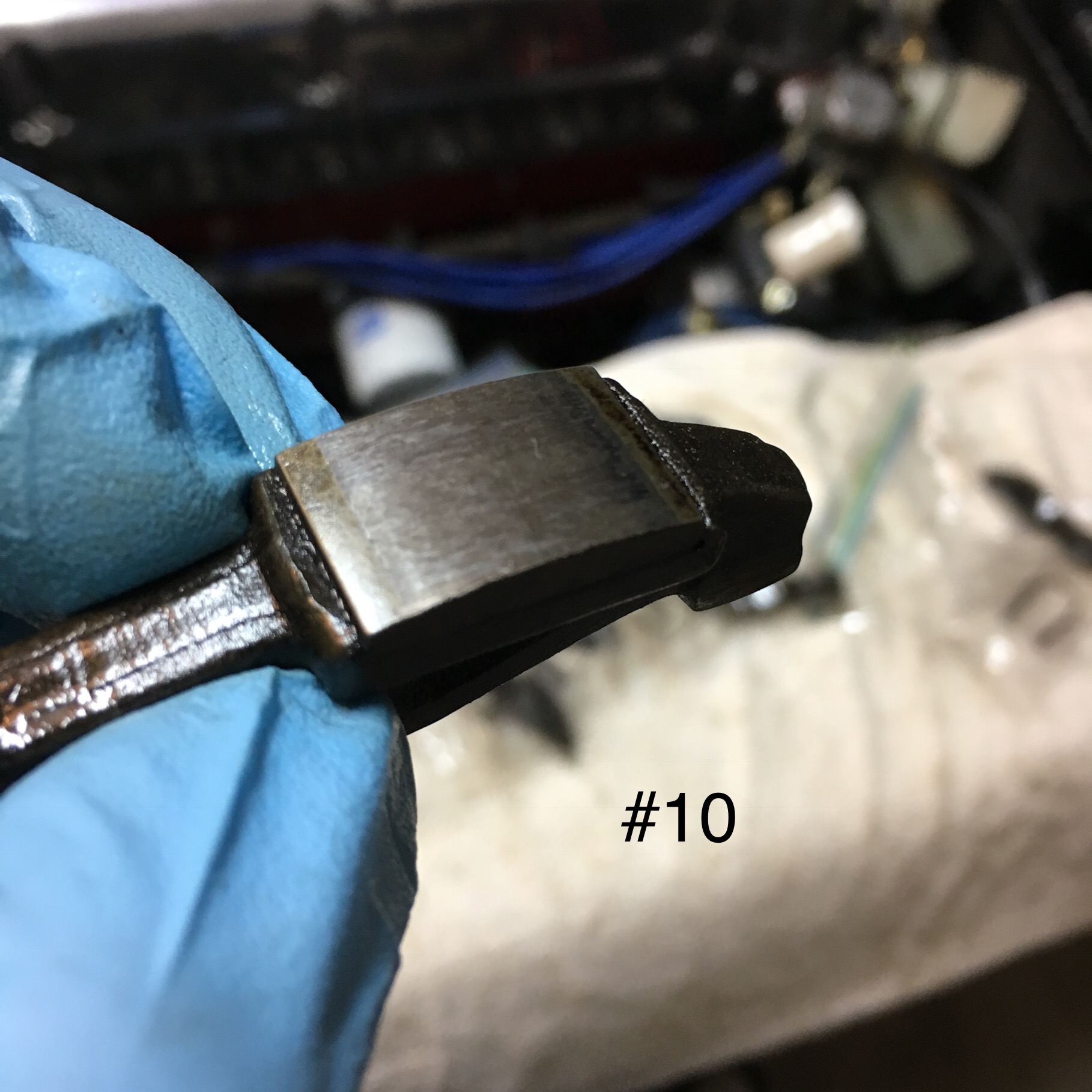

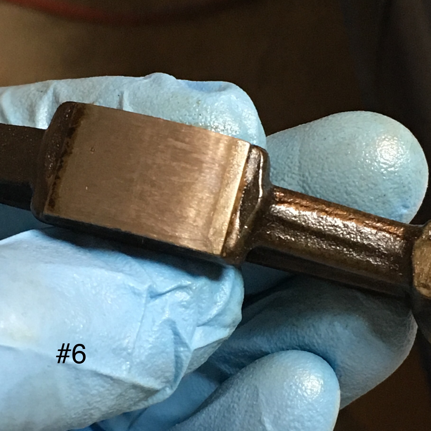

I also carefully inspected all the rocker arms and they are perfect except for #6 and #10. They have almost indistinguishable lines that are hard to capture on camera. They are perfectly smooth to the touch and their lash pads have perfect wear.

A plausible story might be that the PO installed a set of rebuilt rocker arms, didn't inspect them closely, and missed #8.   Or got in a bind and decided to use it anyway.  And didn't properly tighten the bolts.  I can't see how you get a groove like that on #8 except during regrinding of the pad surface.  If the cam lobe had worn out there might be a groove closer to the end, but not where that one is.
If the others are all good you'd probably be okay just replacing the bad parts.
I'm not an expert n the area, just regurgitating knowledge I've consumed, and adding some basics to it.  The cam lobe is the area that almost always has wear problems, not the lash pads.
Wait a while and you'll probably get some more experienced views.  Doesn't seem like you have a major problem though, just minor details to correct.

I want to provide an update on the replacement rockers. I installed four new rockers and adjusted the valves cold then I let the car idle for a hot valve adjustment. Great news the tapping is gone and it's just regular valve train noise now!
