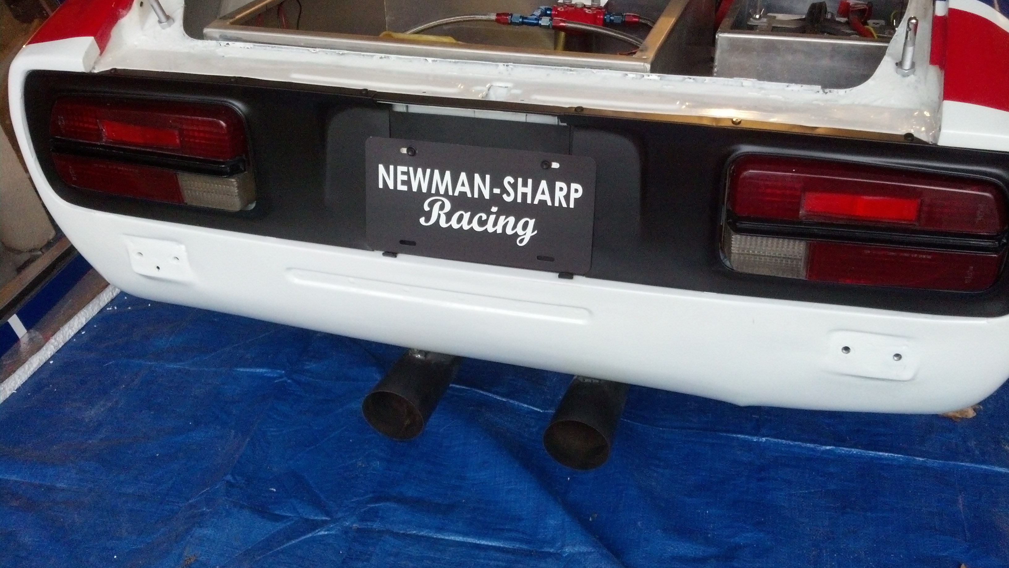

WHATEVER you do - don't waste your time running duals all the way back - its loud and exotic sounding and a waste of weight and money
So not twice pipes but you have dual exhaust. Anyway sounds great. Just about to pull the trigger on twice pipes.
12/71 2.6 block E88 heads triple weber 3/2 Abarth Tokico 1-3/4 sways
Not sure what you call my system - split pipe might be right Cliff.
Mine does sound a bit different than a lot of 'twice pipes' I've heard . I doubt if anyone has the exact combo of mufflers too. I do think the pipes being separated on my car attribute to the difference in sound .
