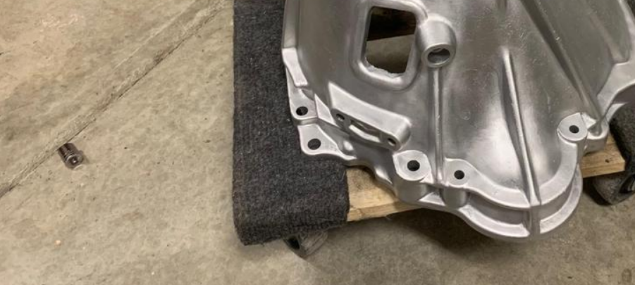

Finally got the ka trans. This is a low mileage (500) miles trans. Been sitting on the shelf since 1989.  I found it on some parts website. Vapor and some zinc and it’s looking amazing.
Bell housing mods are being done Emerish racing.
