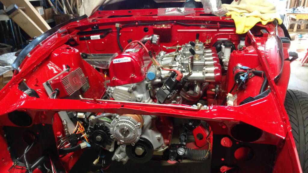

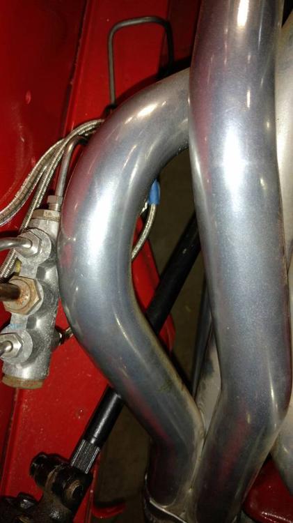

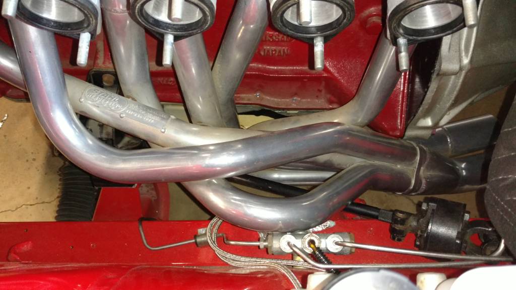

Wondering if anyone has installed a Stahl header? If so, have you had issues with the steering column clearing the header?IMG_20170909_161845914.jpgIMG_20170909_161902154.jpg
Sent from my XT1585 using Classic Zcar Club mobile
Yikes - looks like an Octupus is trying to swallow your steering column. Don't like the proximity to the brake valve
Yes I as well not liking that....
Is that header intended for RHD vehicles?
Good question. I do not know as I bought it (and the motor) used (but never fired) . I am doubting it....and am wondering if that would even matter ( wouldn't be 180 degrees on the other side....)?
Sent from my iPad using Classic Zcar Club mobile
 RHD cars had the steering shaft on the other side of the engine but the header would be in the stock position, that header could have been made for a 280z where the brake switch assembly is up on the firewall and you may have to do that. Is the steering shaft actually touching the header?
You might get away with a shim under the D/S engine mount and/or you could also cut and weld a notch into the header pipe.

I asked because the two things that the header hits, the steering shaft and brake valve would not be there on a RHD car.
