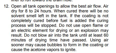

Glad that's working for you.  Like Patcon said, let it dry as long as possible.  I say this because I remember you mentioning about coating the tank and then putting it to use after 2 1/2 - 3 days.  That was premature according to the directions of Red Kote.
While it is off, take a peek inside just to make sure everything has adhered.  Take a pic with the cell phone if you can.  I used a handheld LED light in one opening with a phone cam peeking in the other.  I'm curious.
Maybe people are confusing Red-Kote with one of the other tank sealers.  Red-Kote is just a fuel resistant polymer dissolved in a prayerful "polar" solvent.  MEK evaporates very quickly.  8 - 24 hours is the dry time, for a whole quart of Red-Kote.
http://damonq.com/techsheets/red-kote.pdf
Edit - meant "powerful" but "prayerful" actually seems more appropriate.  Spell-correct.
Edit 2 - took a bunch or words out.
