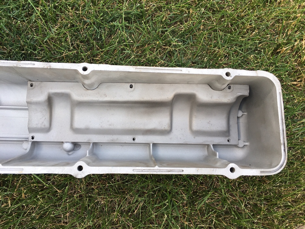

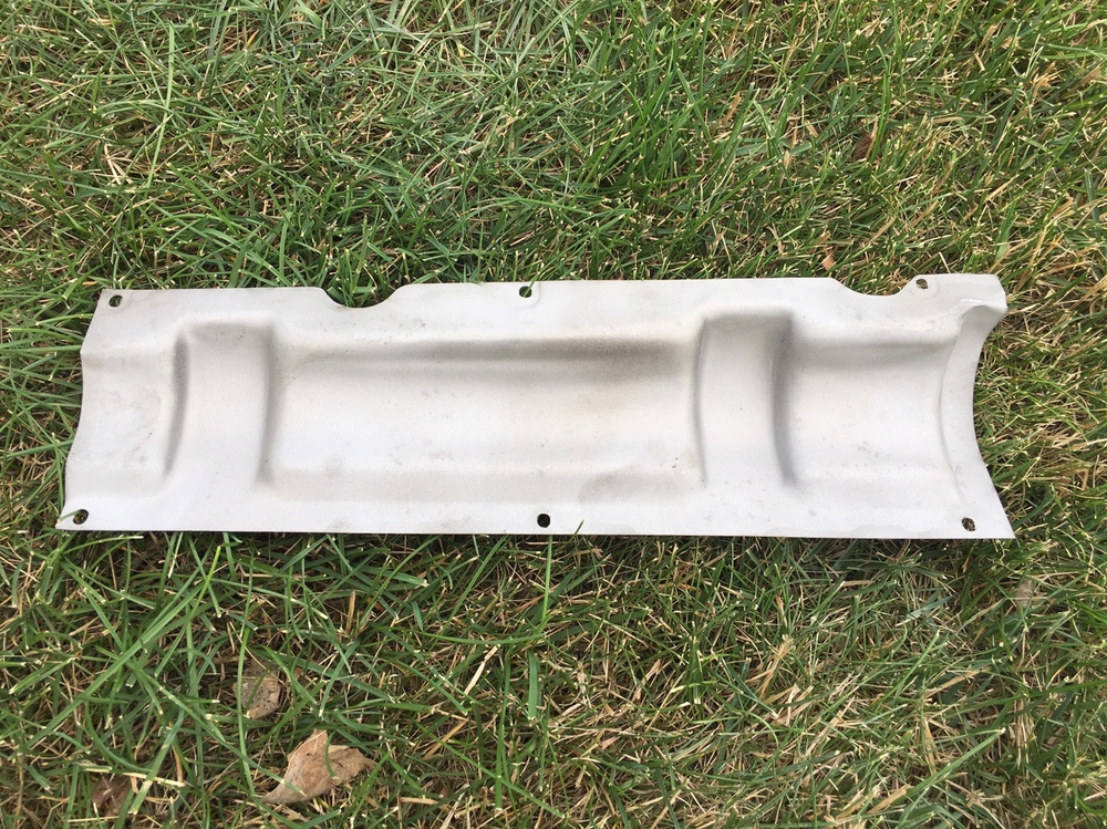

July 11, 20178 yr comment_525485 Wheee!, Do you have any pics of the baffle plate loose from the inside of the valve cover? I saw your shot of the inside of the valve cover sans baffle, but do you have pics of the baffle itself? And Mike W, Do you have any pics of your new replacement baffle you made up? Link to comment https://www.classiczcars.com/forums/topic/58095-valve-cover-breather-thread/?&page=2#findComment-525485 Share on other sites More sharing options...
July 11, 20178 yr comment_525513 5 hours ago, Captain Obvious said: Wheee!, Do you have any pics of the baffle plate loose from the inside of the valve cover? I saw your shot of the inside of the valve cover sans baffle, but do you have pics of the baffle itself? No, I will get you one and post it up! Link to comment https://www.classiczcars.com/forums/topic/58095-valve-cover-breather-thread/?&page=2#findComment-525513 Share on other sites More sharing options...

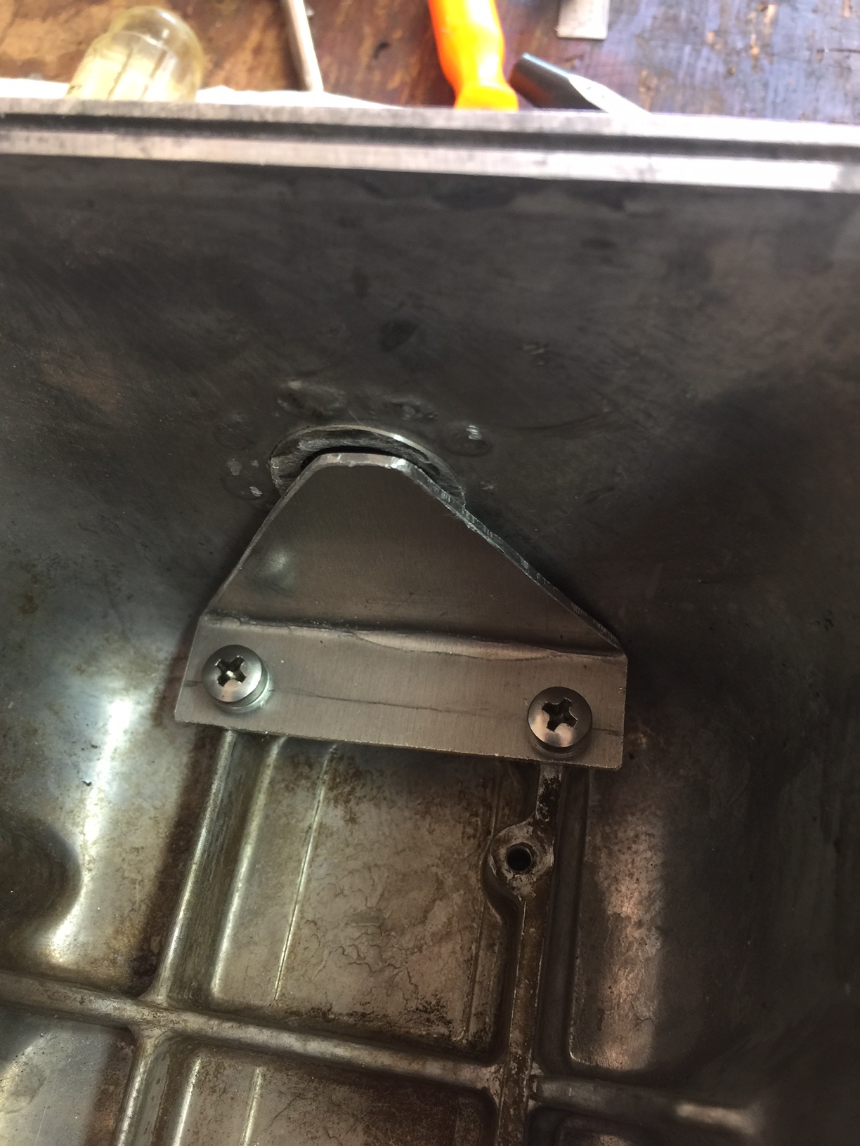

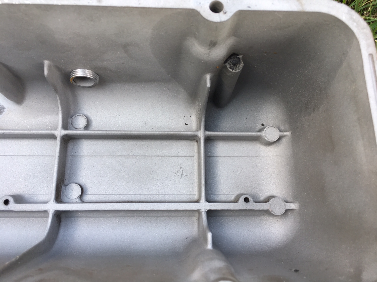

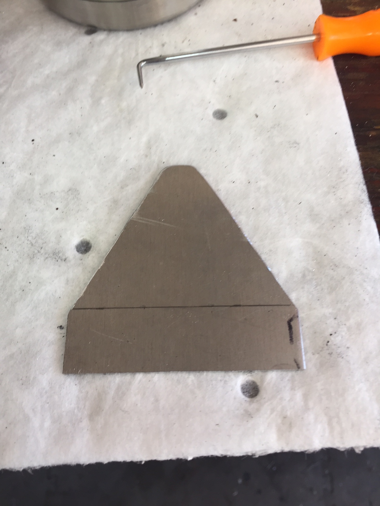

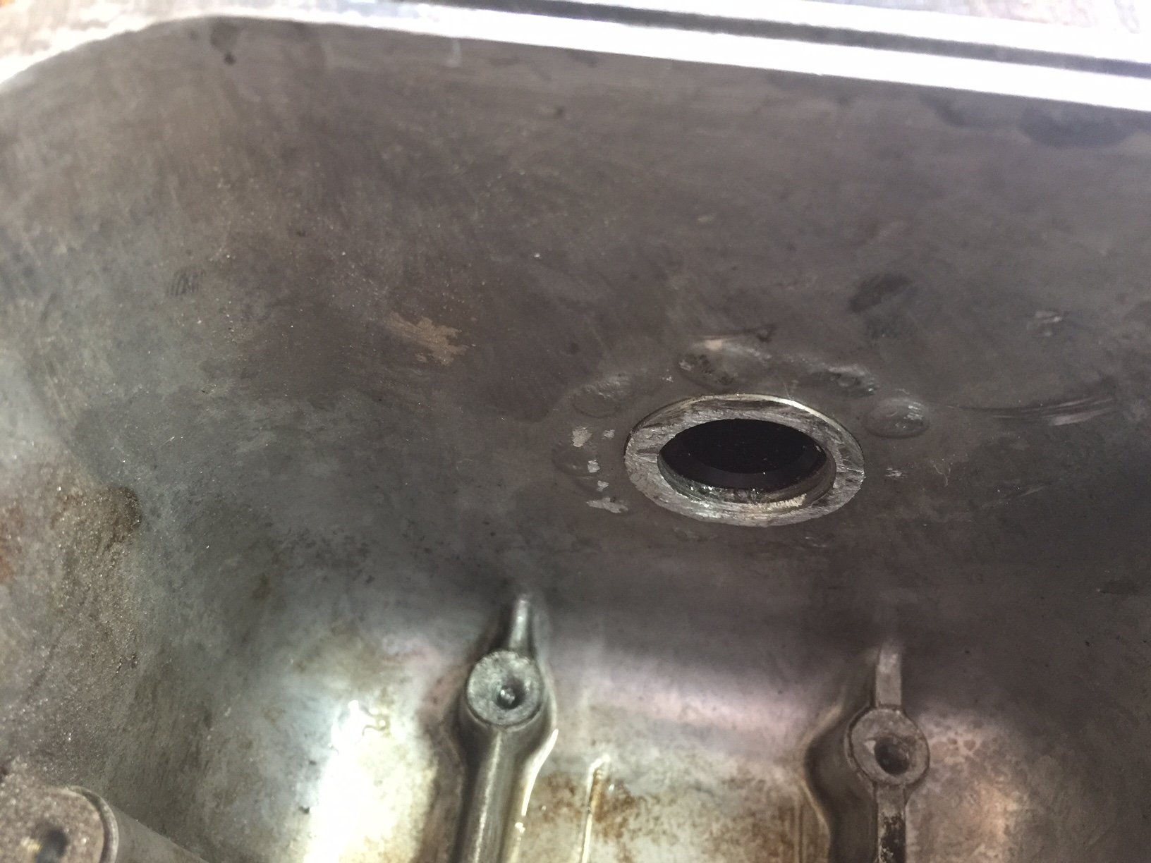

July 12, 20178 yr comment_525577 So there is very little room in the back of the valve cover as it relates to the last cam tower. As a result I have to dremel off the part of the bung that was protruding into the cover itself in order to make some additional room. You will see that in one of the pictures below. Also you will see the "bosses" that are cast into the top of tyhe cover and these I drilled and tapped so I could secure the new baffle to the cover. The only thing not shown in the pictures are the small holes that we drilled around the bung opening in the new baffle. Pretty straight forward and seems to work fine. Let me know if you have any other questions about this. Mike. Link to comment https://www.classiczcars.com/forums/topic/58095-valve-cover-breather-thread/?&page=2#findComment-525577 Share on other sites More sharing options...
July 12, 20178 yr comment_525583 Loctite those screws.... you don't want them vibrating loose into the engine! Link to comment https://www.classiczcars.com/forums/topic/58095-valve-cover-breather-thread/?&page=2#findComment-525583 Share on other sites More sharing options...
July 12, 20178 yr comment_525588 I used red loctite as well as lock washers so they should be pretty secure in there. Mike. Link to comment https://www.classiczcars.com/forums/topic/58095-valve-cover-breather-thread/?&page=2#findComment-525588 Share on other sites More sharing options...

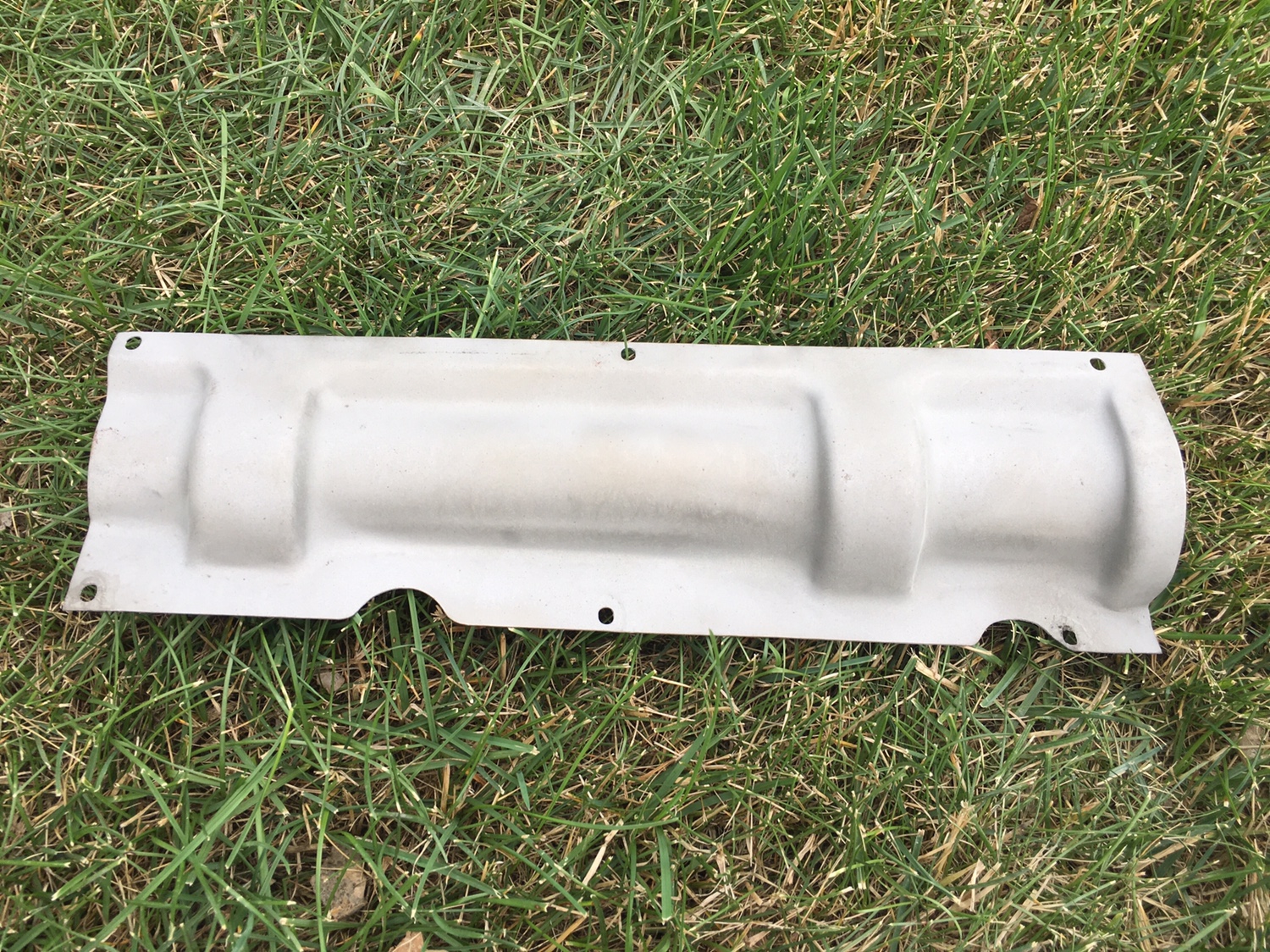

July 12, 20178 yr comment_525601 Wheee!, Do you have any pics of the baffle plate loose from the inside of the valve cover? I saw your shot of the inside of the valve cover sans baffle, but do you have pics of the baffle itself? Here you go! Link to comment https://www.classiczcars.com/forums/topic/58095-valve-cover-breather-thread/?&page=2#findComment-525601 Share on other sites More sharing options...
July 13, 20178 yr comment_525643 Thanks for the pics! Good photography work! Link to comment https://www.classiczcars.com/forums/topic/58095-valve-cover-breather-thread/?&page=2#findComment-525643 Share on other sites More sharing options...
