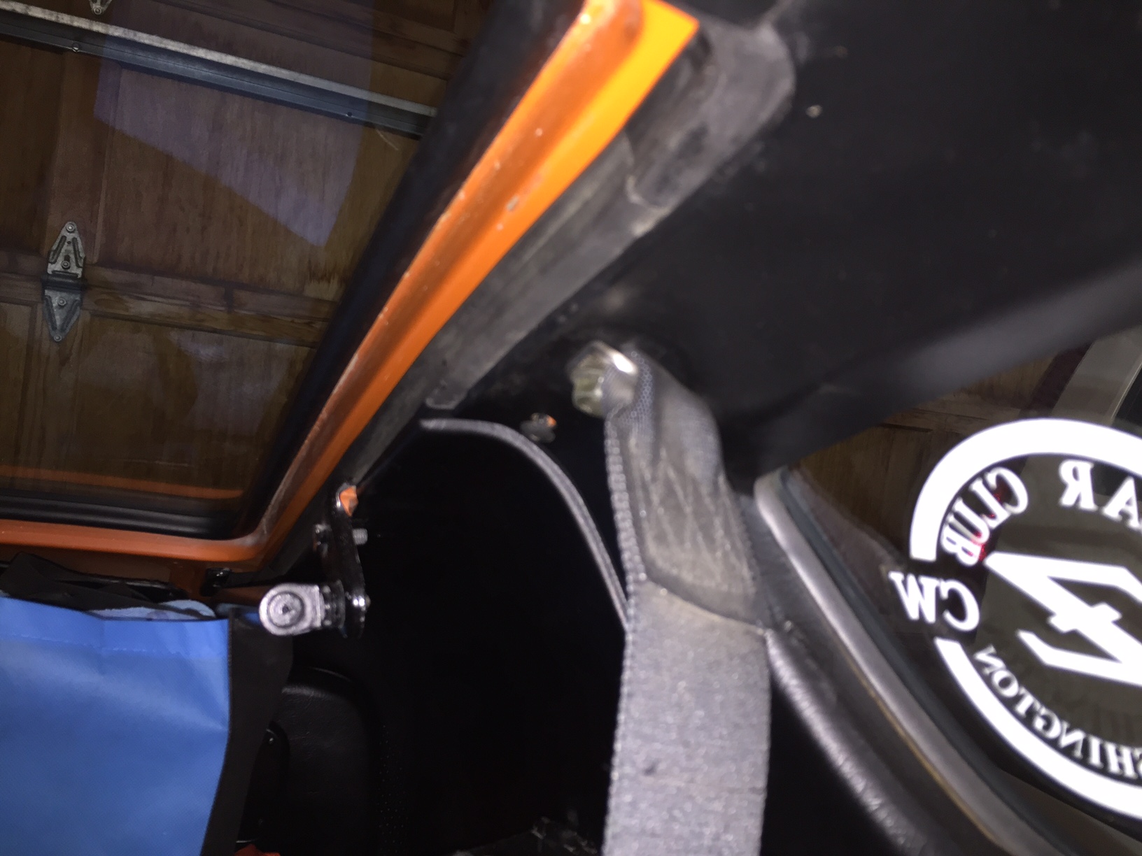

A 70 had a three belt system. Each lap belt connects to a bolt on the floor on each side of the seat. The third belt attached the a bolt above the quarter widow and the the other end attaches to the buckle on lap belt. I can send photos if you need.

For some reason i thought the three point belt wasn't introduced until 1971. But that's great news for me: that should mean I can just hook up to it and trust it. We thought someone had put that mount point in and then some other PO had abandoned it for the lapbelt that is currently in the car. It's not original, and neither is the mounting hardware it's using, but it is using the standard mount points. This cars interior has a lot of slightly different to it.
If you don't mind I would love a shot of that window mount just to make sure that's what I'm working with.

Hope this helps
