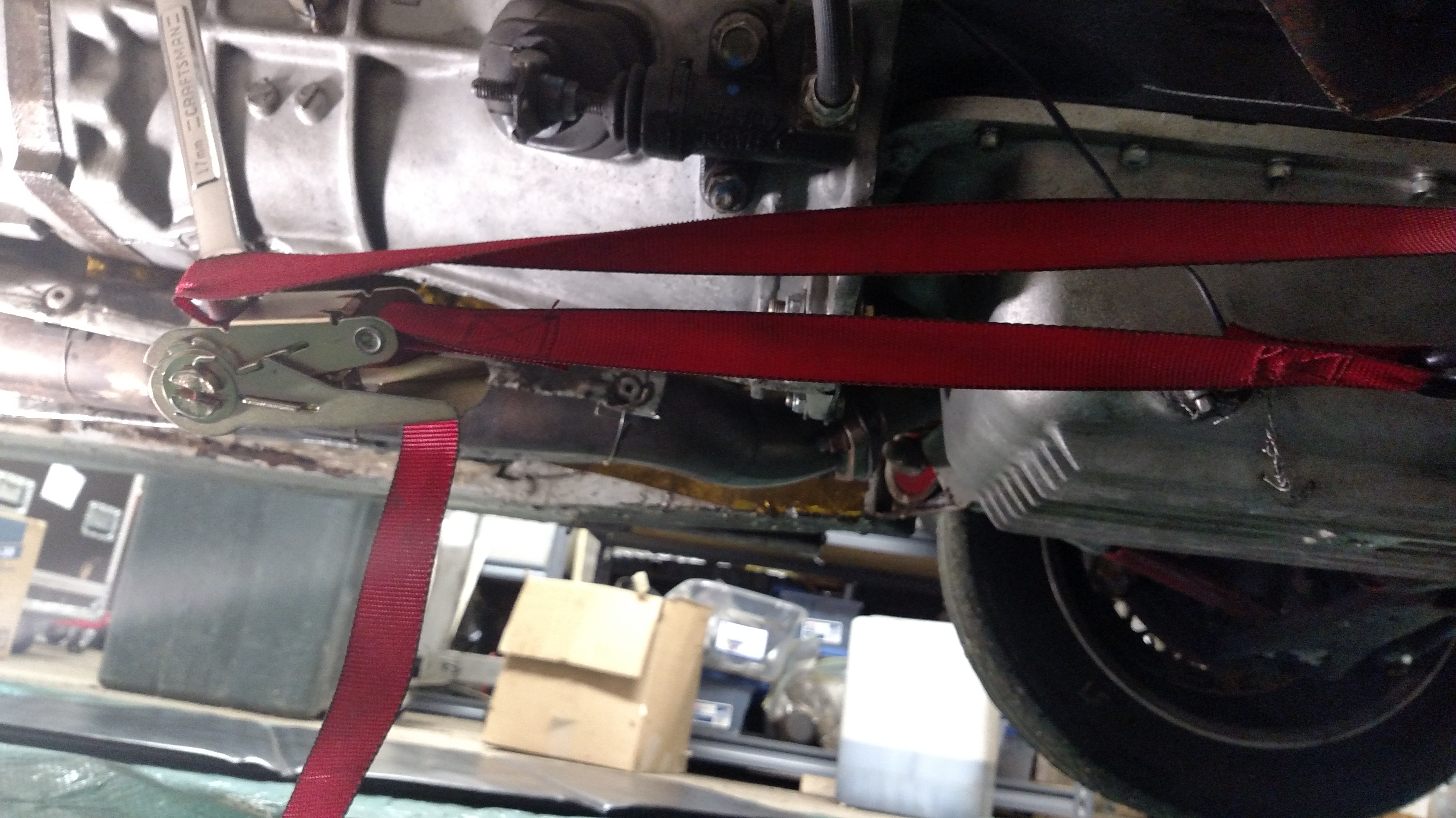

Posted June 7, 20178 yr comment_522552 I've done and read a good dozen different ways to get the fill plug loose including heat, a 10 pound hammer, a cheater bar and my favorite, using a jack with a small cup (Sears sells them for $100) and putting the other end of the wrench in the cup and jacking it up while you have the car on stands. Today I didn't have the small jack but I did have a ratchet strap that I wrapped around the engine crossmember and the wrench. A literal piece of cake. Link to comment https://www.classiczcars.com/forums/topic/57884-tranny-fill-plug-removal/ Share on other sites More sharing options...
June 7, 20178 yr comment_522557 Great idea! I'm about to do my differential and will try that if it's as tight as my 280s was. Seems like those are female type plugs and I used a half inch pull handle or ratchet. That's one helluva oil pan you got on there! Edited June 7, 20178 yr by siteunseen Link to comment https://www.classiczcars.com/forums/topic/57884-tranny-fill-plug-removal/#findComment-522557 Share on other sites More sharing options...

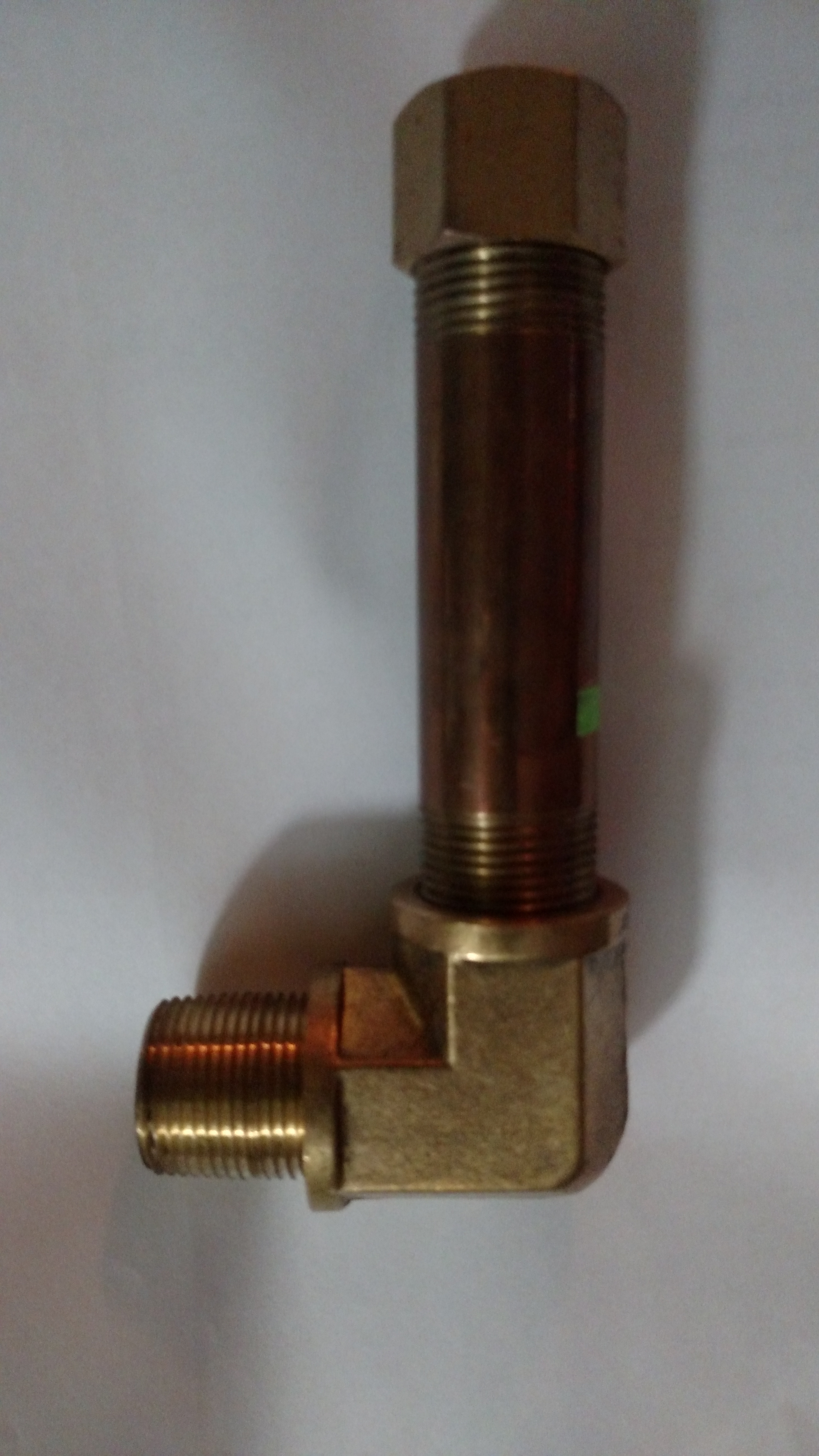

June 9, 20178 yr Author comment_522682 Yes, I race a 240 and that is the small oil pan (6 qt) as opposed to the large (8+) pan. Add in filter, lines. Accumsump, cooler and you have 12 to 16 qts. invested. As to the idea, here's the prototype that I used to verify that it works. The version going in the race car will be longer, have a connection point to the body and be lighter in weight. Think auto tranny dip stick with a threaded cap that can be removed via a socket. Link to comment https://www.classiczcars.com/forums/topic/57884-tranny-fill-plug-removal/#findComment-522682 Share on other sites More sharing options...
