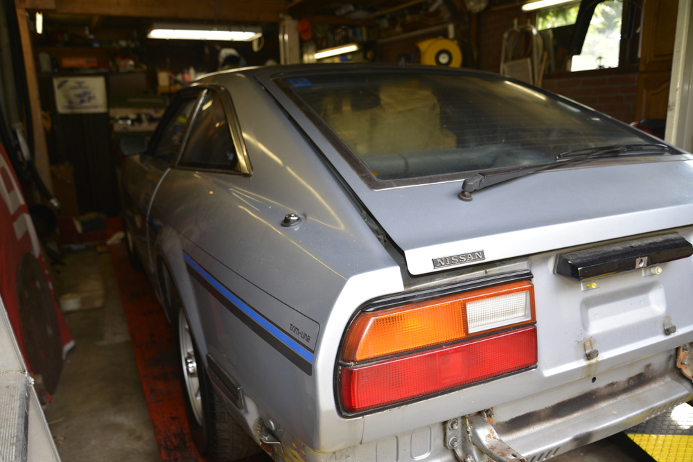

It was a blue car put away in 1993-94, in a storage in the back of the garage!  In 2013 the owner stil recognized me and confirmed me that it was stil the same car!  It has 119000 Km on the clock and was not driven since 1994, The engine was started every year and that saved it..
After i saw in how good condition it was, (compared to a lot of terribly rusty rustbuckets) i bought the car!  I went to pick up the car in January 2014  and did all the mechanical work in 2014 and 2015. Now the car is stil at my Painter who did/does al the welding also for me.  At first he told me the car wil be ready in may but now he says June... Don't matter to me, only thing i care for that it is done the right way!

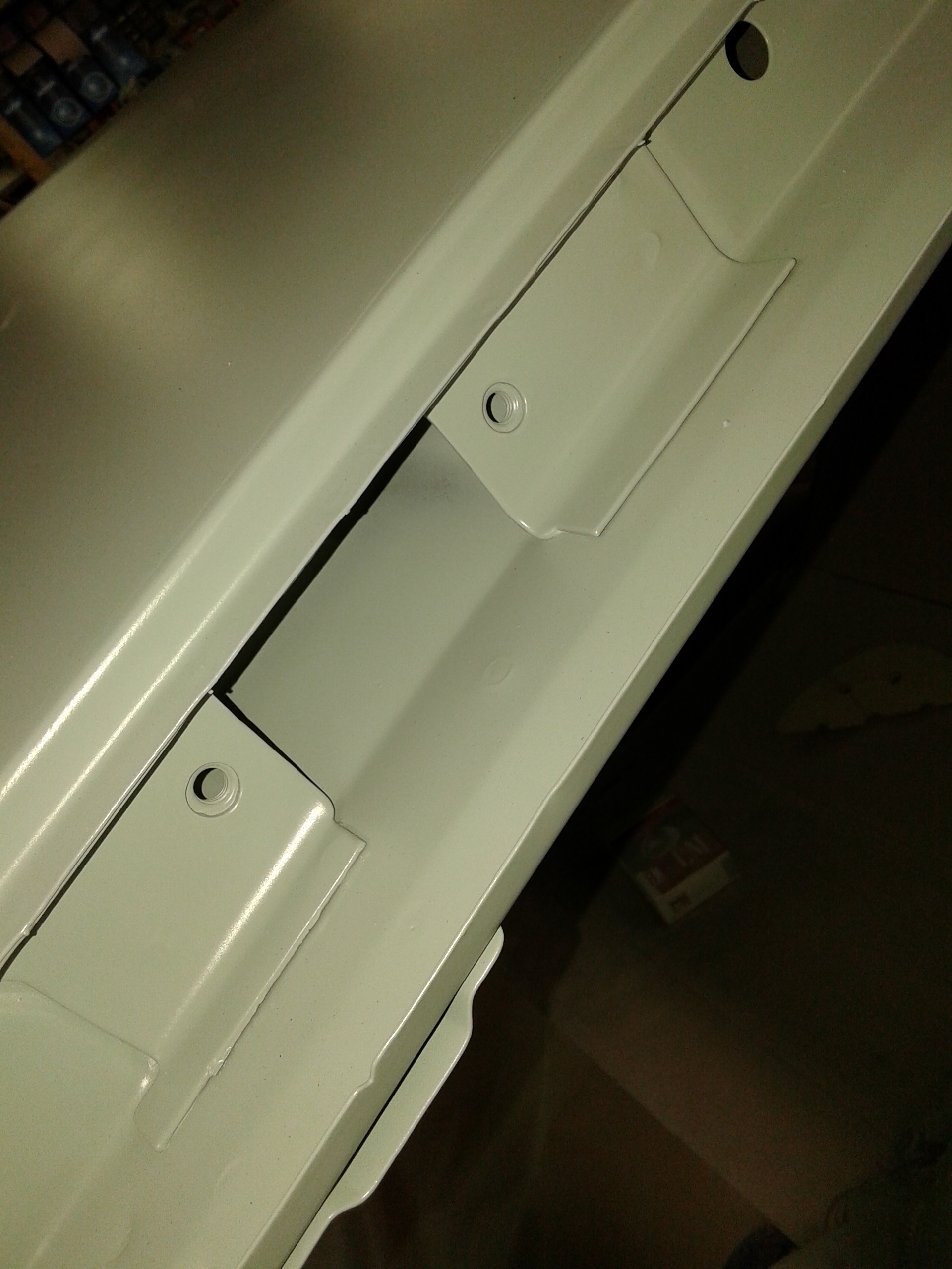

A Datsun 240z has a rubber part around his tailgate hinge, i found no rubber near those of the 280zx?  Is there no rubber cover seal ?  When the hinge is taken out there is a big hole in the roof edge, when cleaning i can imagine that there can get a lot of water into the roof causing a lot of trouble?
If there is no rubber for the hinge, i think a peace of inner tubing of a bike can close it, putting it in between..
Like to here your solution!

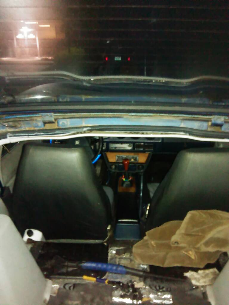

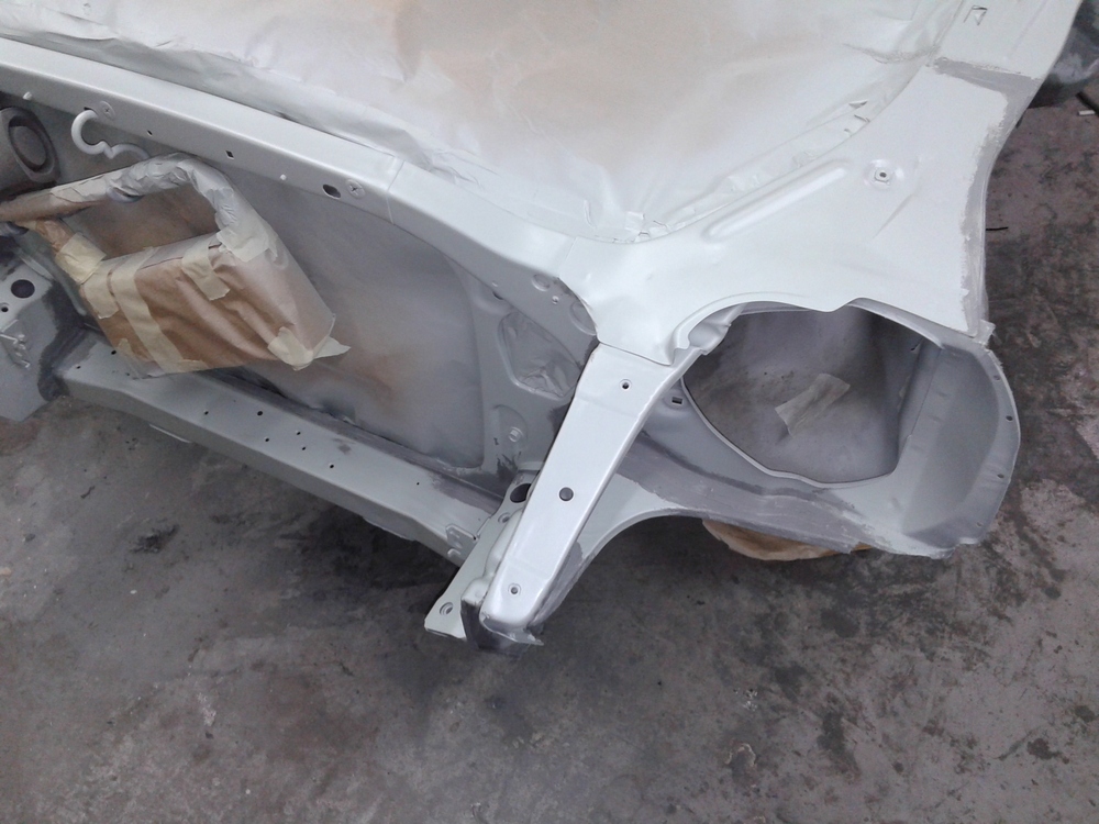

Pic.1 before restoring  Pic.  Pic.2  ready for paint.  NOTICE: the stil perfect "welds" under the rear lights.. in europe these are always rusted away, here...stil perfect..  also the bottom of the car NO welding needed! Awesome!!
Pic.3 front ready for paint.  PICTURE 4: the holes in roof for the hinges tailgate..

About the hinge seal, that's a good one, need to do some information digging on the internet here.., I wouldn't have a clue either. You have alot of books and manuals, doesn't one of them say anything about a seal there ?
IMG_20170519_044153.jpeg there's a piece of rubber above and below the hinge. Sorry about the picture quality. Its still dark here at work.
That is an interesting part to me.  I don't think I've seen them in any of the Zs I've had.  Mine are missing but it doesn't cause any problems that I know of.  I don't park them outside though?
Vintage Rubber has them for $130.  I won't be buying anytime soon. :D
https://www.google.com/search?q=280z+hatch+hinge+rubber&rlz=1C1BOFA_enUS494US494&source=lnms&tbm=isch&sa=X&ved=0ahUKEwir19uPpPzTAhXBOCYKHbLHAXAQ_AUICygC&biw=1280&bih=616#imgrc=_
Image result for 280z hatch hinge rubber
Edited by siteunseen
Thanks Bart,  we will see.. Painter says june... I say September HAHAHA... Ready next year... i don't mind.
In the serv.man. of the 280zx there is no rubber round the hinge like the 240z has!  I would like a rubber that leaves moisture outside the roofline.
Rep, thanks for the picture!
Site,  those are for a 240z not a 280zx.. don't think they will fit.. but anyway, thanks for your contribution.

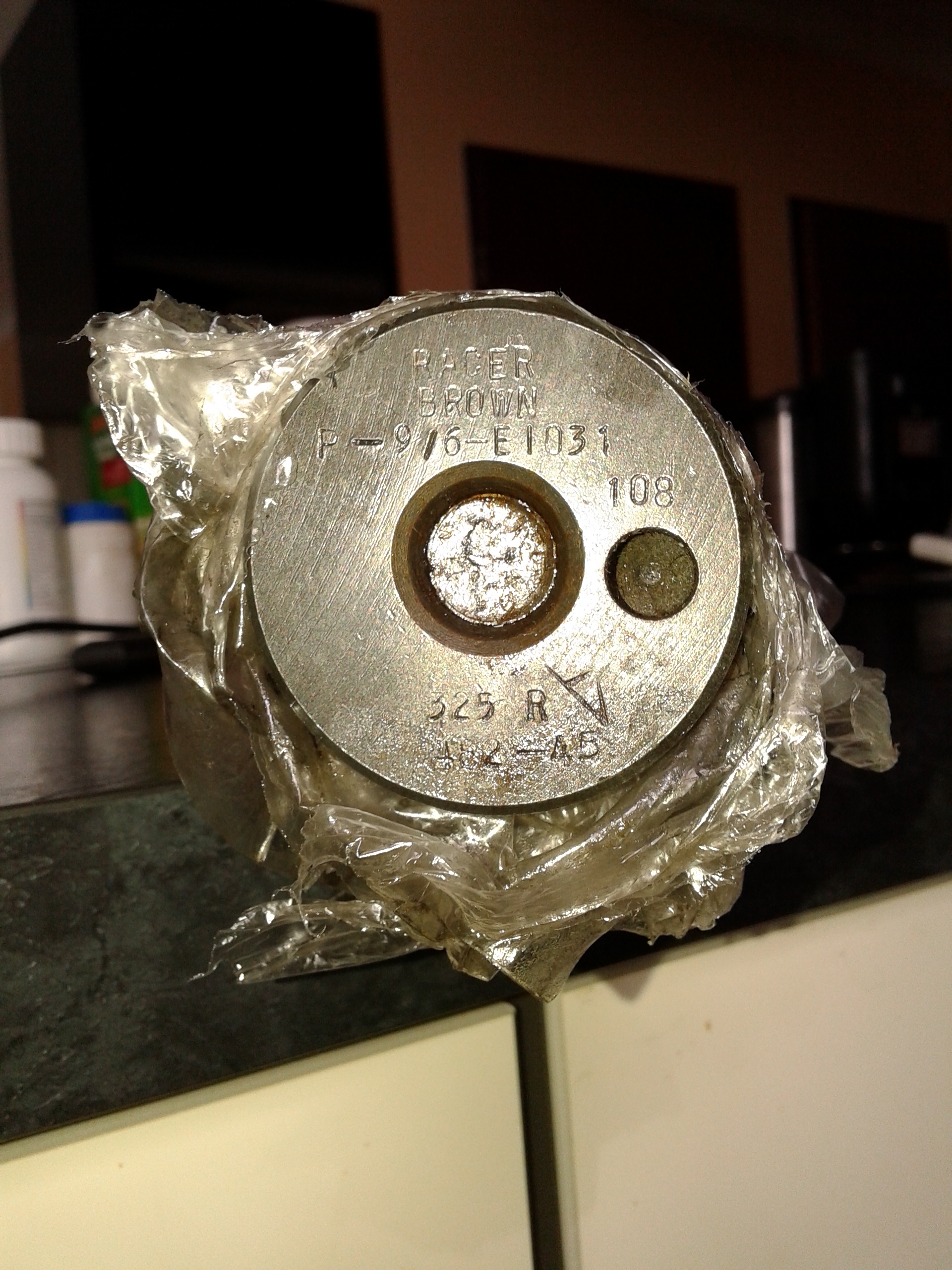

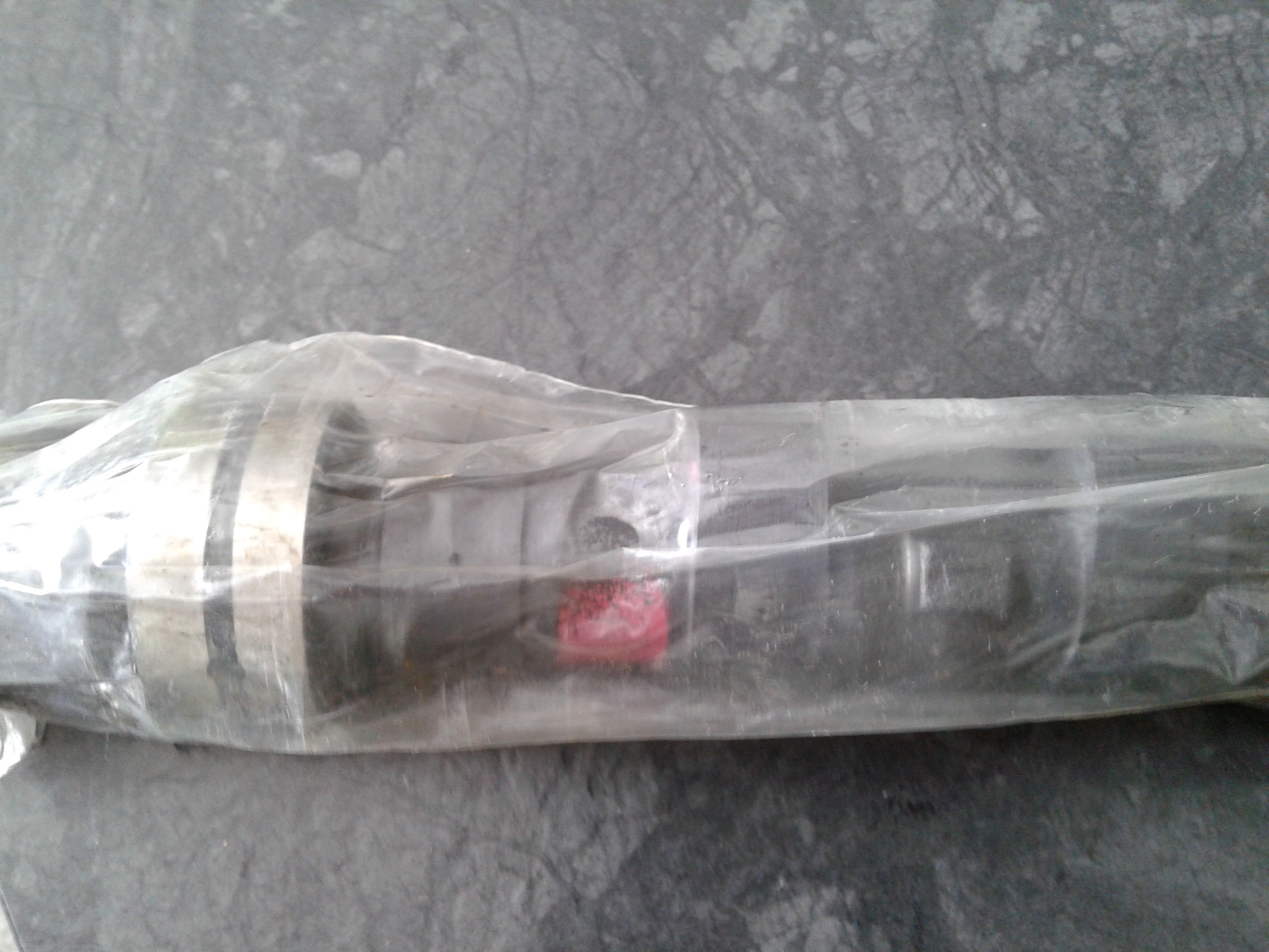

Valve clearance was after 119000km stil less than 0,05mm off on 10 of 12 valves! 2 i could not set them better!  This engine is just driven in!
CAN ENYONE TELL ME WHAT THAT RED LINE ON THE CAM MEANS ???

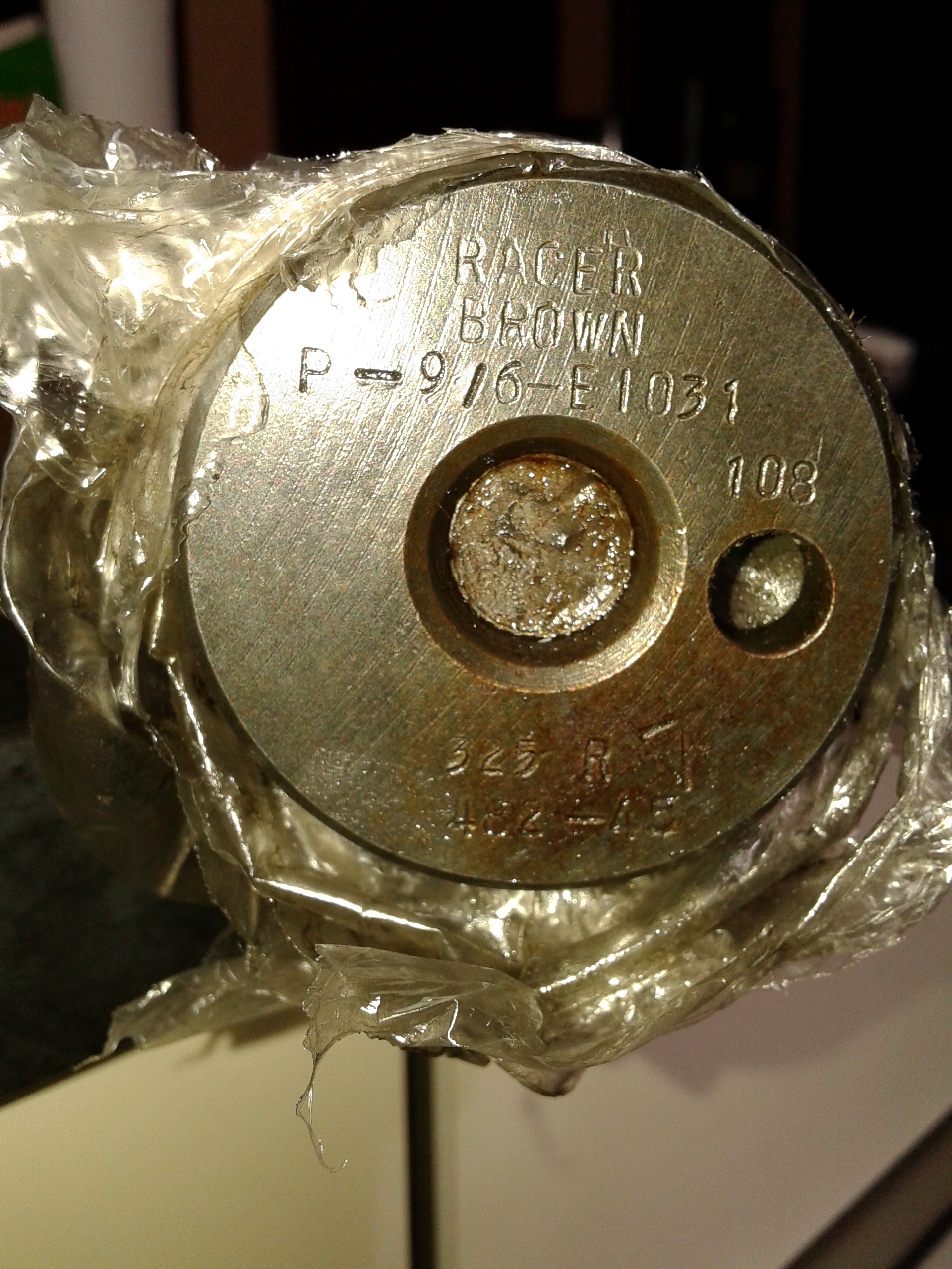

The dark spots on those pistons are original lube and a bit of storage dirt after more than 25 years!!  Also have a brand new slalom camshaft.. in orig.box, (What's left of it..)  it has .475"lift and 275* Duration.  On the end it say's : "Datsun"
The lobes had a sort of beige cover on them but after i lubed the shaft for storage it became shiny steel... odd..
Number on the box say's: 99996-E1031.  Offers are welcome but.. If Mike (from Wheeler dealers) pay's $600 for a referb.. you may guess the price of this original Datsun Racer part...

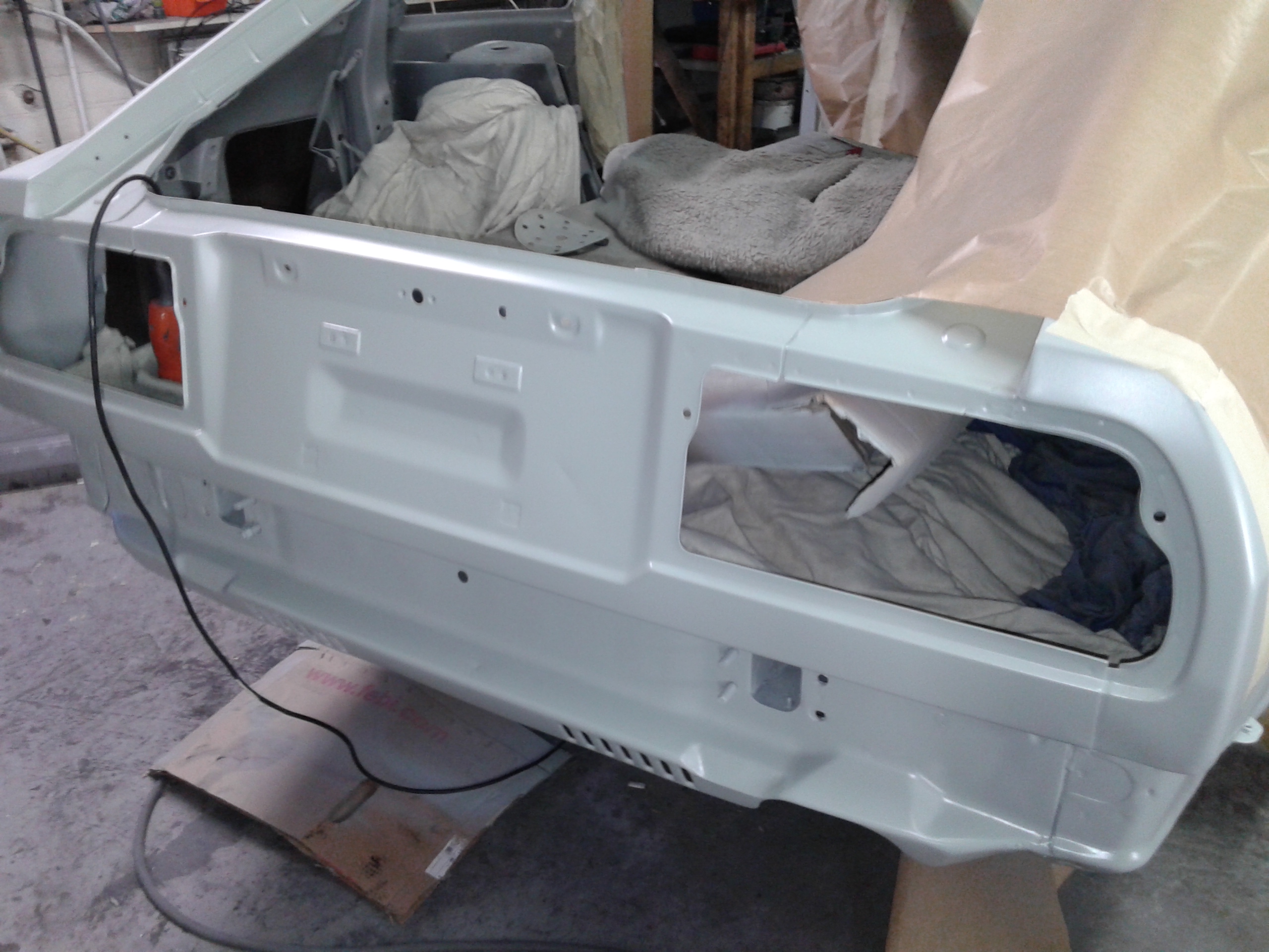

Today i got almost 400 pictures (!!) of the 280zx body, doors, hood, front wings, hatch... and so on .. sanded to the metall, and already the lower parts in bodyshoot.. (anti stonechip..)  !   These were made in the past 1-2 year.. by my painter. (and welder.. because he liked to do it himself not that i can't weld..)  There were just a few spots that needed some welding on this car. Most work was around the front window, some *&%$#^%... had put in a new front window glass without preparing it in a good way!..  Those edges were very rusty!!  But it's all taken care of.. (sorry pic's are on an other laptop.. you see some later..)
