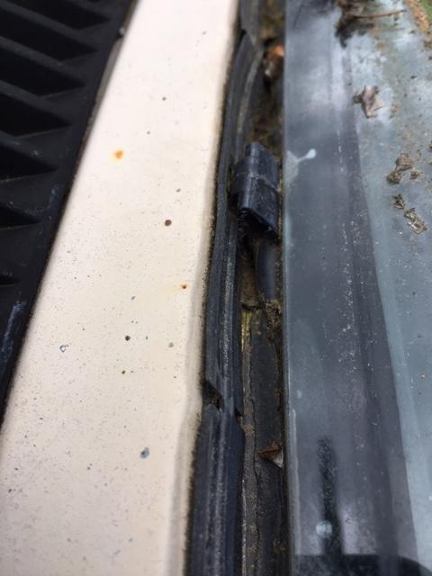

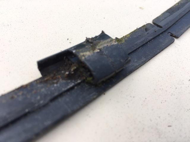

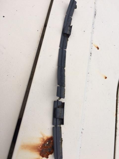

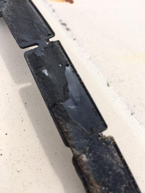

June 14, 20205 yr comment_601173 Here are some pics of the bottom under the stainless trim. It looks like there was a plastic piece that had sticky tape to hold it in place. It looks like it went on first then the windscreen gets glued in after. there are some bulges that look to hold the stainless on every few centimeters. The piece is notched so it can make the arc of the windscreen and breaks very easy,  It is also weather checked. I did get a small piece of it out for the pics. The ends have a locating pin that sits under the side trim. It looks like there was something like it on the top as well. It is also sealed in with silicone or some other adhesive. No bumps on the top but it had the butterfly clips as noted above. Link to comment https://www.classiczcars.com/forums/topic/57761-280zx-1979-22-slick-roof-restauration/?&page=9#findComment-601173 Share on other sites More sharing options...

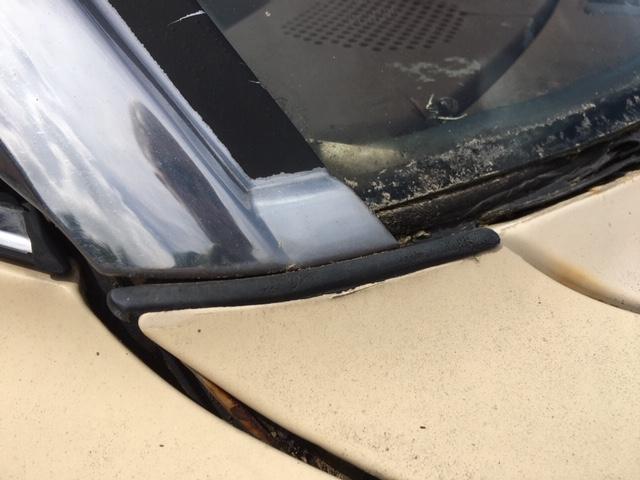

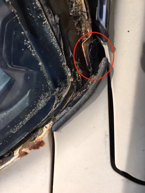

June 15, 20205 yr comment_601278 I don't remember any of the rubber seal being exposed, at least on my 82. The only thing I see that would be what you are describing is at the fender edge. Here are pics of the passenger side with the side trim still on, and a pic of the drivers side with the trim off. You can see where the plastic pin lock the strip down. (circled) Link to comment https://www.classiczcars.com/forums/topic/57761-280zx-1979-22-slick-roof-restauration/?&page=9#findComment-601278 Share on other sites More sharing options...
