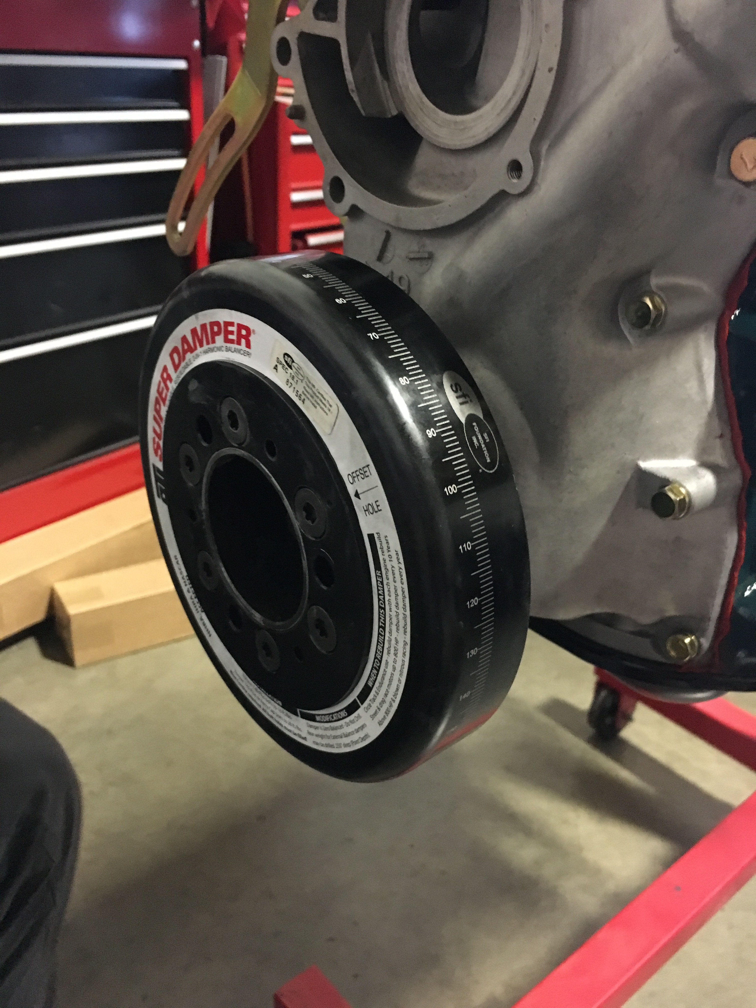

BTW......The damper Eiji suggested will make it impossible to run a mechanical fan. I know nothing about electrical fans. Can someone lead me in the right direction regarding fans for the Z? Do I need a single or a double, a pusher or a puller....what is the best quality fan to buy? Any help would be much appreciated.
