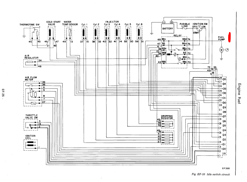

The fuel pump control for the 75 - 77 N/A.
When the engine is not running the flap in the AFM is closed and the fuel pump control switch in the AFM is OPEN. When the key is turned from "OFF" to "RUN" there is no continuity through the fuel pump switch in the AFM and the fuel pump should not run. When the key is turned to "START" the engine turns over AND the fuel pump relay closes which starts the fuel pump. As air is sucked past the flap in the AFM it opens and the FUEL PUMP contacts in the AFM close. When the engine starts the air flow through the AFM keeps the fuel pump running because the switch is closed. If the engine stops / stalls the flap in the AFM closes and the fuel pump control switch in the AFM opens thereby shutting off the fuel pump.

The voltage for the coil on the fuel pump relay comes from the Black/White wire. The negative goes from the relay to pin 5 on the ECU. You should read the EF section of the FSM. I suggest using the 76 version since it's a better quality scan than the 75.
If the relay coil isn't energizing, the fuel pump circuit isn't complete. I suggest that you not bypass it. Get everything working right.
Okay this is great stuff. So I should use a voltage meter with one side on the black/white wire from the relay and the other end on pin 5 of the ecu to see if they correlate? Also, I have a 76 fuel pump relay and fuel injection harness. Does that make a difference? It's all the same connections I believe.
How do you know the pump is not getting power?  It doesn't kick-in, it just gets power when the key is turned to Start.  The simple test is to disconnect the starter solenoid wire and turn the key to Start. You can hear the pump because the engine doesn't turn.  The other one is to turn the key to on and open the AFM vane.  This will use two different parts of the same system.
How far down did you tear things during the restoration?  And is it a restoration or a resto-mod?  Is the EFI/pump relay still there?
Actually check voltage to ground off of pin 72 on the relay (It goes to pin 5 on the ECU). While starting, if it is 12VDC, you don't have a ground. If it is 0VDC, check resistance from pin 72 to ground. It should be low, less than 1 Ohm.
None taken. I love the cutting, welding and engine rebuilding part of a restoration but I can admit that wiring is not my forte. I had my dad at the back end listening to and feeling the fuel pump for activity when turning the key and there was none until we connected another wire to the positive end of the fuel pump and the other side of that to the starter ignition switch wire. It was pretty weak but was pumping gas. Definitely not something that could be heard from inside the car. There's probably a better place that I could connect it that would give it more power but I'm not sure where that would be.
