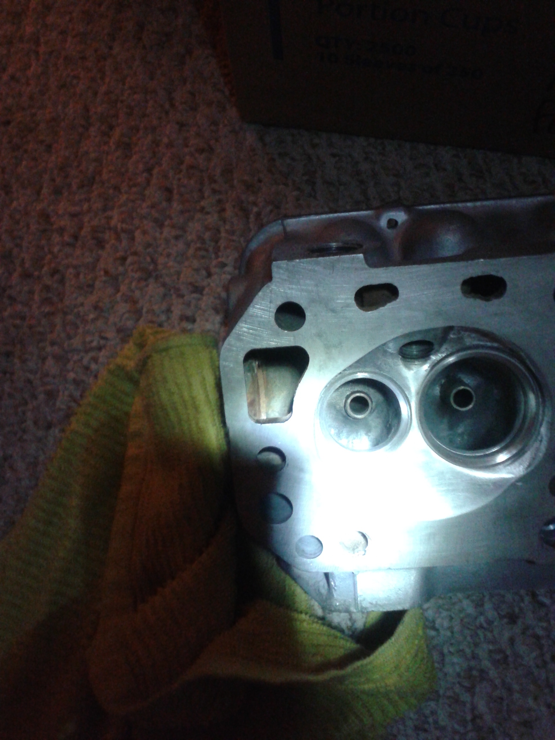

February 20, 20178 yr comment_513484 1 hour ago, Mark Maras said: My guess is coolant. Coolant in a(?) cylinder could account for the strange sound when trying to start it. Especially after it's been sitting. After it has set overnight, I'd pull all the spark plugs and turn it over with the starter. I'm betting that at least one cylinder will spit coolant out of the spark plug hole. You may find coolant running out as soon as the plug is removed. Absolutely Mark.......good advise.....Not only that, I'll bet if you start with number 6, chances are it's the problem. The large water jacket outlet there seems to tunnel over to the cylinder in a number of cases. Regardless, I'd like to hear back from toneatron83-280z to see if he's tried any of our suggestions. Hard to give further advise if we don't hear back Link to comment https://www.classiczcars.com/forums/topic/57106-my-82-280zx-just-started-blowing-huge-clouds-of-smoke/#findComment-513484 Share on other sites More sharing options...
February 21, 20178 yr comment_513492 Diseazed, is that the water elbow off the head that feeds the heater core? I've got mine plugged now but when I put the new hoses and water kock on the core if I have the heat off (water kock closed) does that stop coolant flow from that you are talking about? I think it will after playing with the functionality of that kock. Hate to hijack but if it's his DD I think he found another form of transportation. Link to comment https://www.classiczcars.com/forums/topic/57106-my-82-280zx-just-started-blowing-huge-clouds-of-smoke/#findComment-513492 Share on other sites More sharing options...
February 21, 20178 yr comment_513497 No Cliff, not that.......If you pull the head and look right behind number 6 cylinder you see the big water jacket (1 1/2 inches or so square)........sometimes I've seen a tiny trench eaten by electrolysis that seeps into number 6. That's why you want to use distilled water and anti freeze to prevent iron, lime and calcium from creating electrolysis, and eating up your aluminum heads. Link to comment https://www.classiczcars.com/forums/topic/57106-my-82-280zx-just-started-blowing-huge-clouds-of-smoke/#findComment-513497 Share on other sites More sharing options...
February 21, 20178 yr comment_513498 Oh! I understand, thank you sir. I used to use water from my dehumidifier for the radiator but then I found gallons for a dollar at the dollar store. Link to comment https://www.classiczcars.com/forums/topic/57106-my-82-280zx-just-started-blowing-huge-clouds-of-smoke/#findComment-513498 Share on other sites More sharing options...
February 21, 20178 yr comment_513500 This is what you're speaking of? Link to comment https://www.classiczcars.com/forums/topic/57106-my-82-280zx-just-started-blowing-huge-clouds-of-smoke/#findComment-513500 Share on other sites More sharing options...
