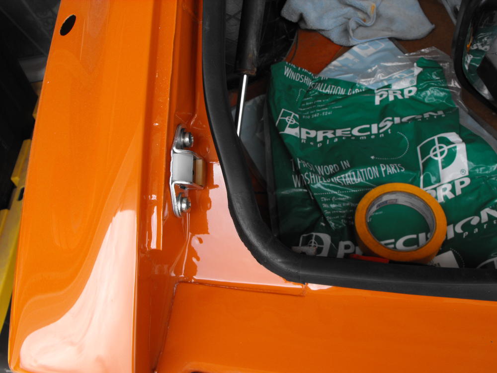

I thought that strip between the black and orange just in front of the door hinge was weatherstripping but I believe it is just a different color of paint.
Yes, that is the primer that is under the paint.  I will touch that up with orange paint before I put the fenders on.

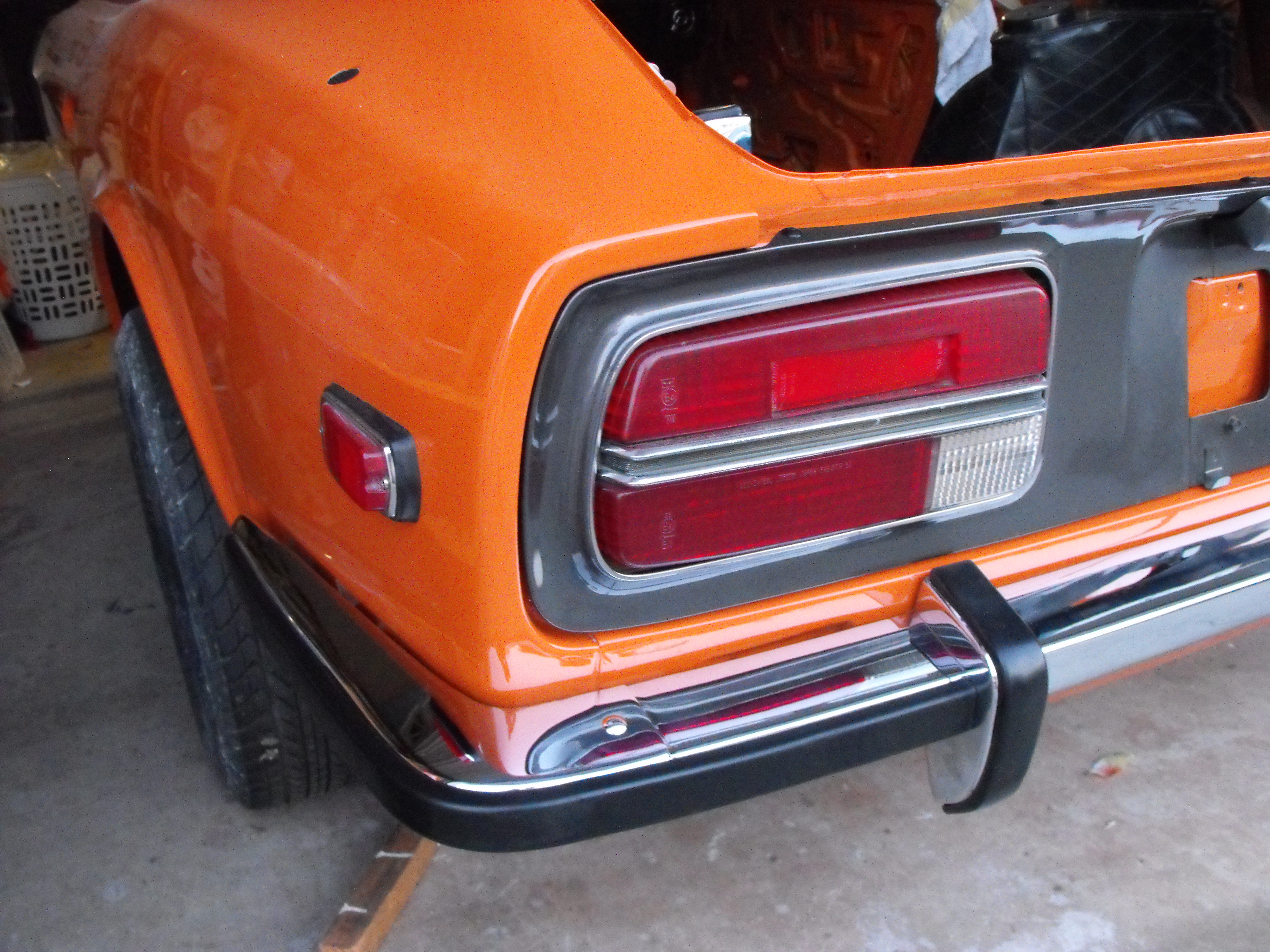

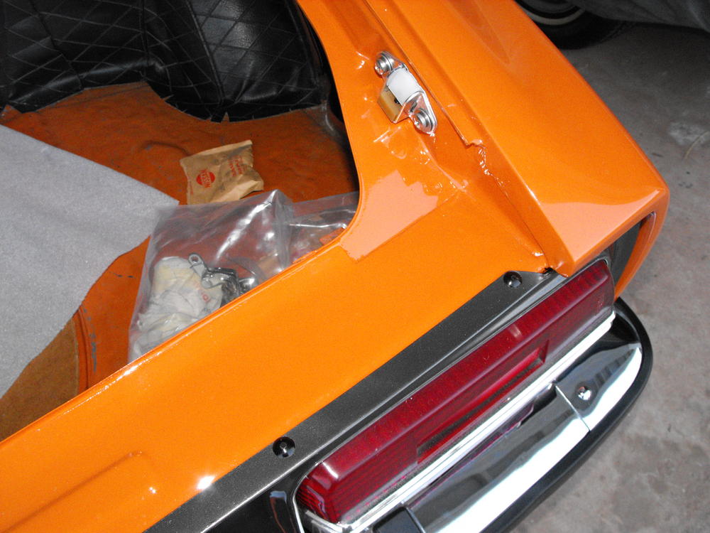

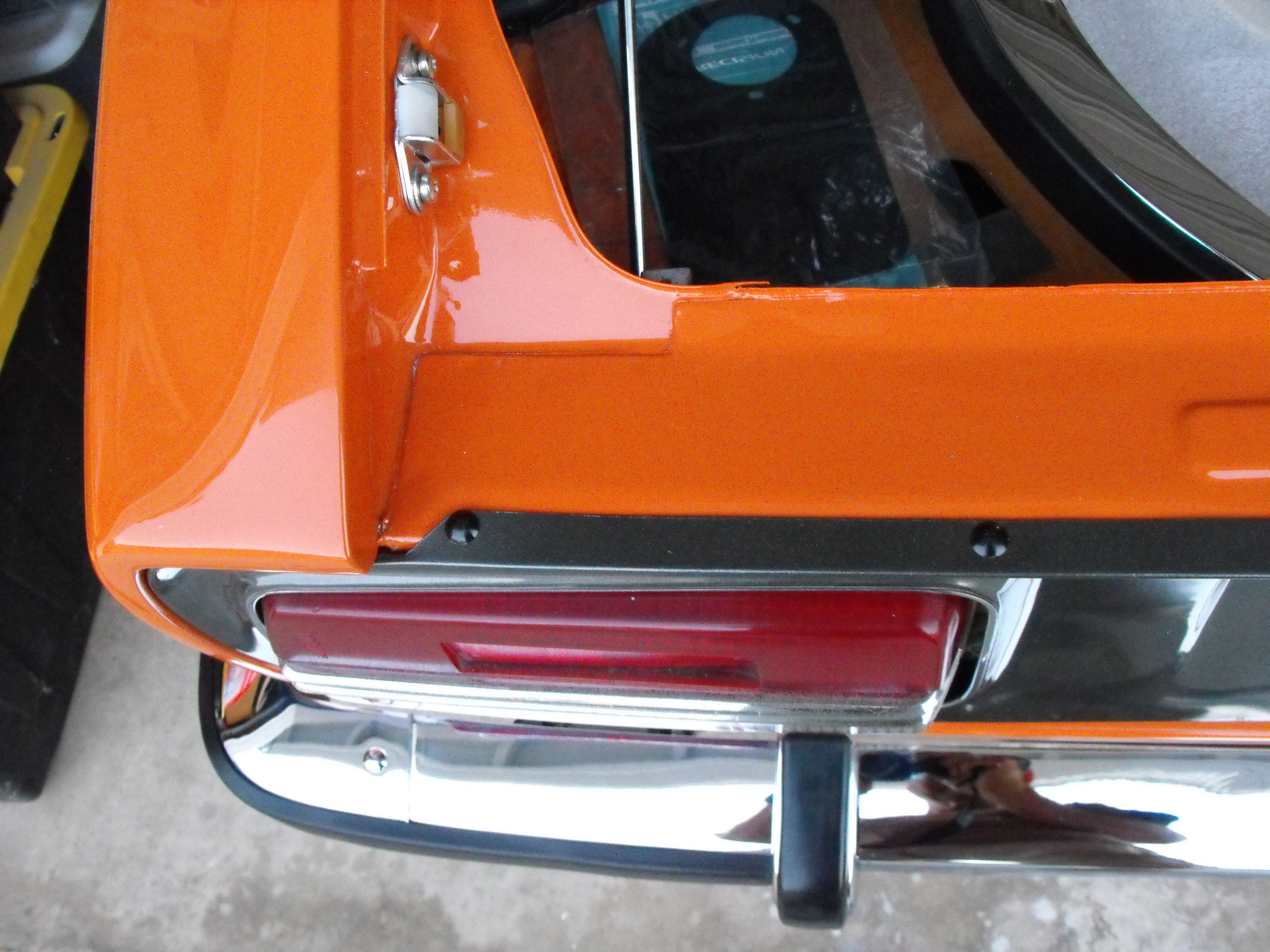

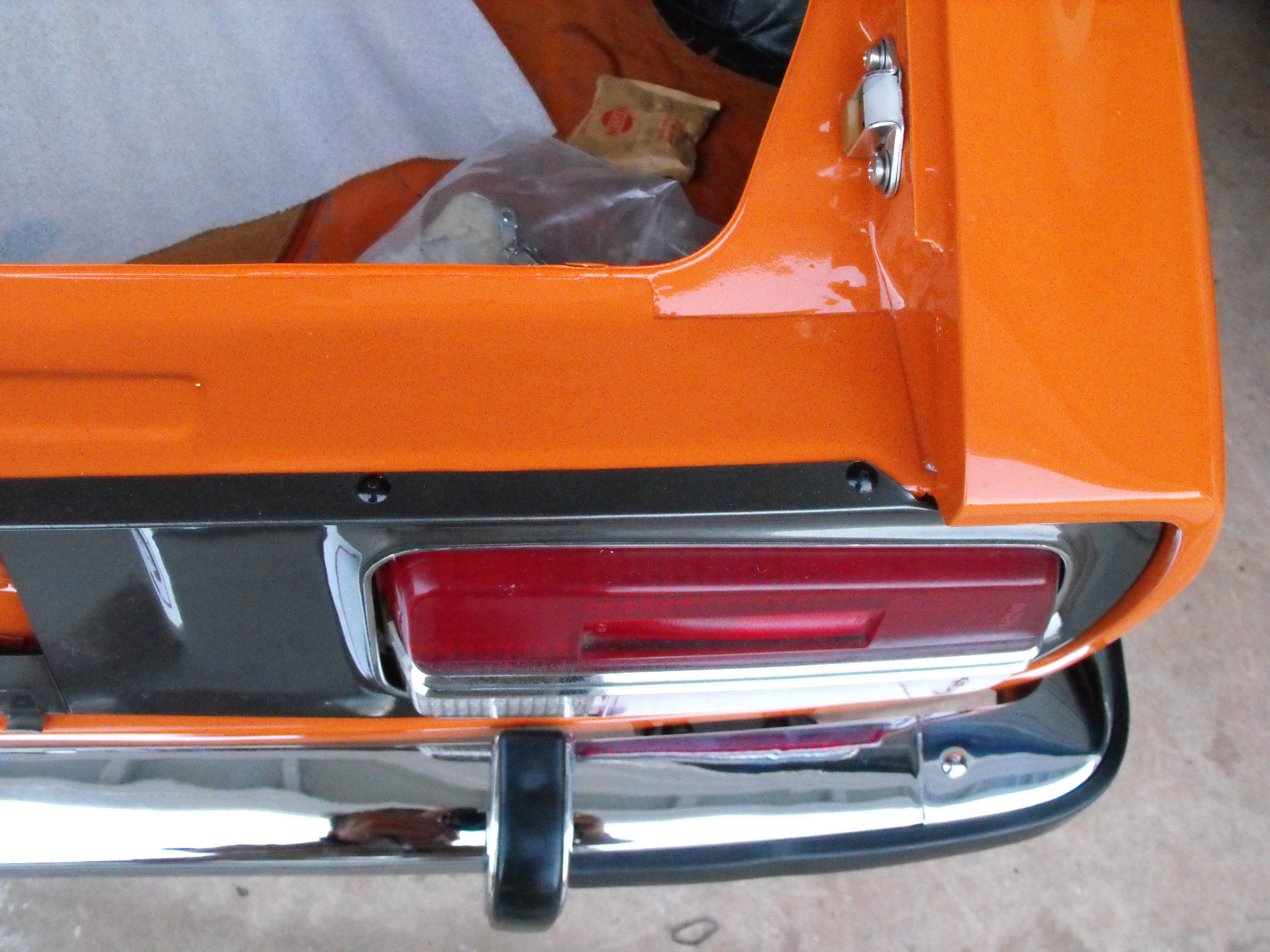

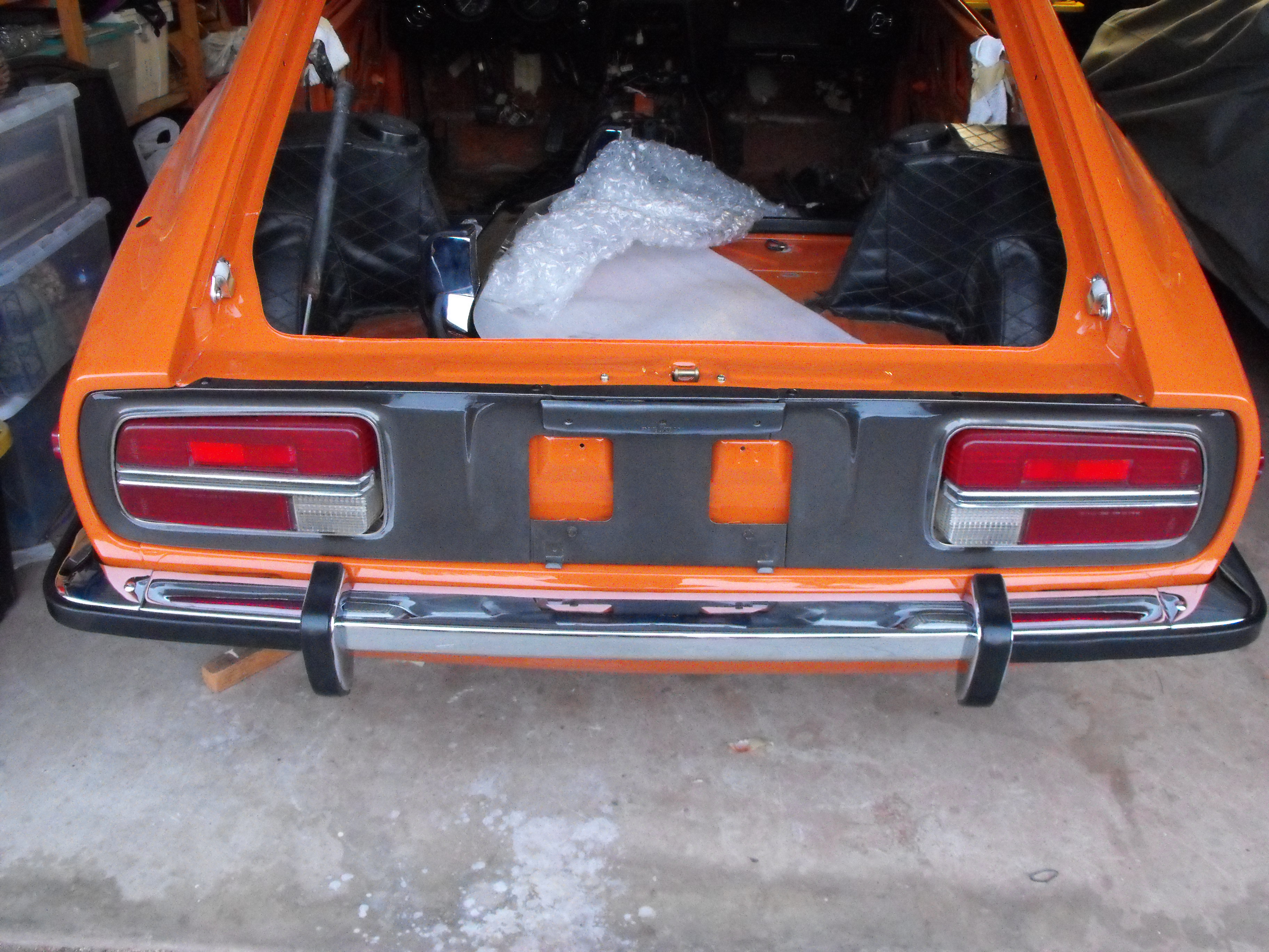

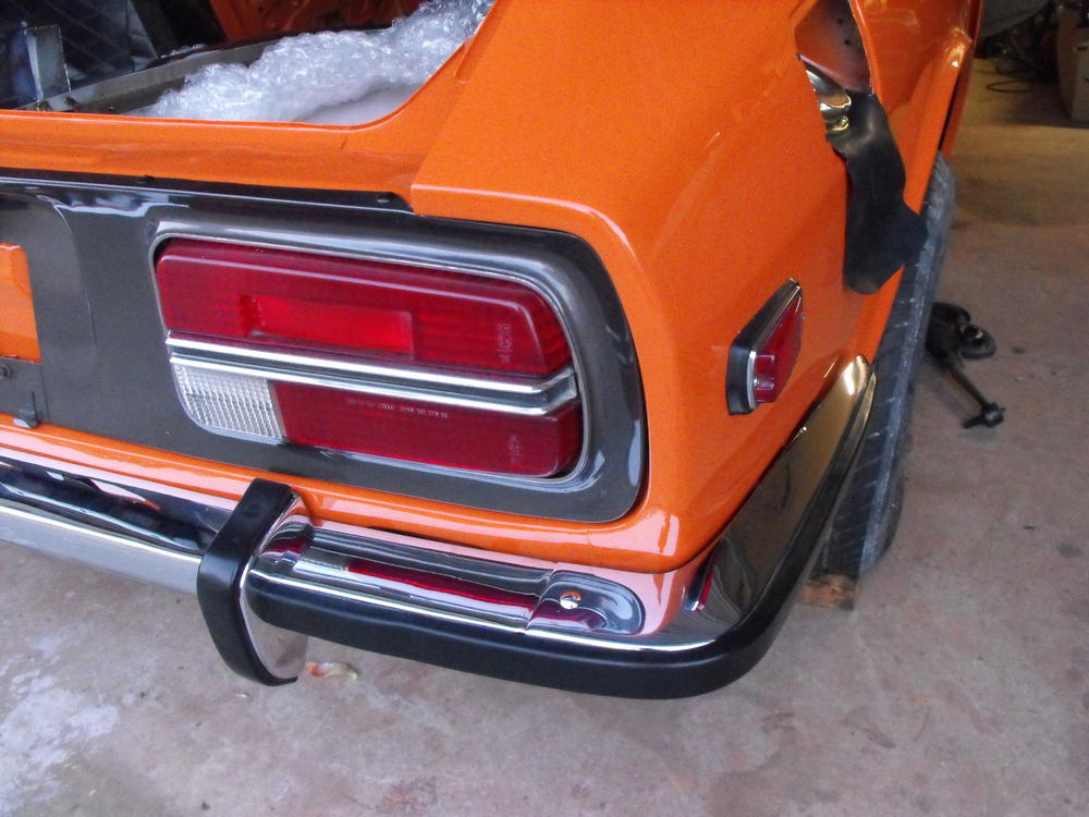

I had just a little time so I put the rear bumper on the car.   Pics are below.
14 hours ago, psdenno said:
Looks better than new........and I remember what new looked like when I bought mine in 1971.
Dennis
          You are right.  My '70 still has the original single stage paint and it never looked this good.   The '70 even has a few paint runs in the engine compartment and the overall paint has a slight ripple or 'smooth orange peelish' texture to it.  (Not sure what you really call that finish)
      I was at the San Marino Motor Classic Car show a couple month ago with my orange '71 240Z and one of the judges commented that he was very impressed that I was able to produce the 'smooth orange peelish' texture of the original Z paint on my car.  Unfortunately, I had to tell him that the texture was actually the result of my mediocre painting skills and not what I was shooting for.   Smooth as glass is what I was trying to achieve.

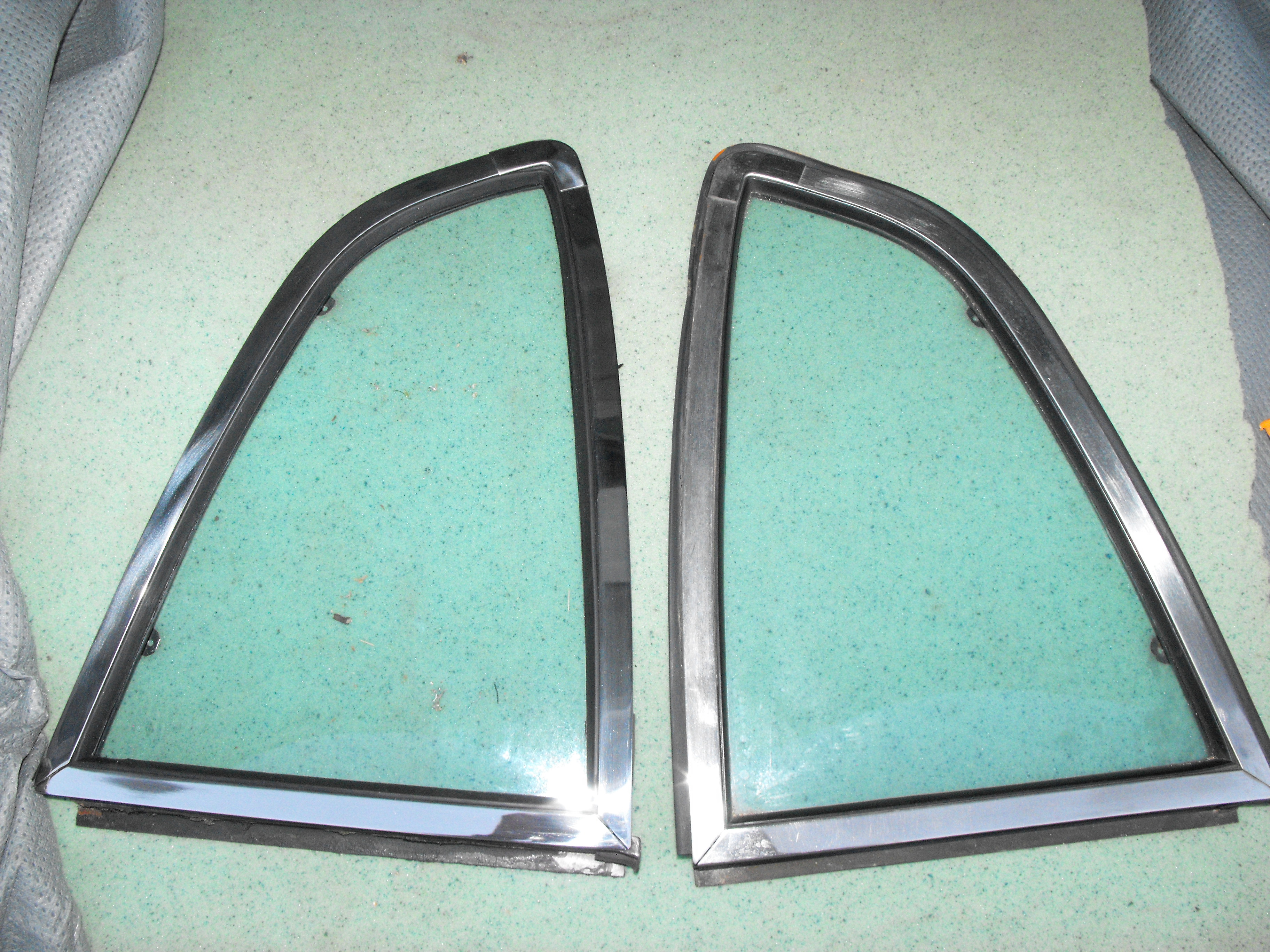

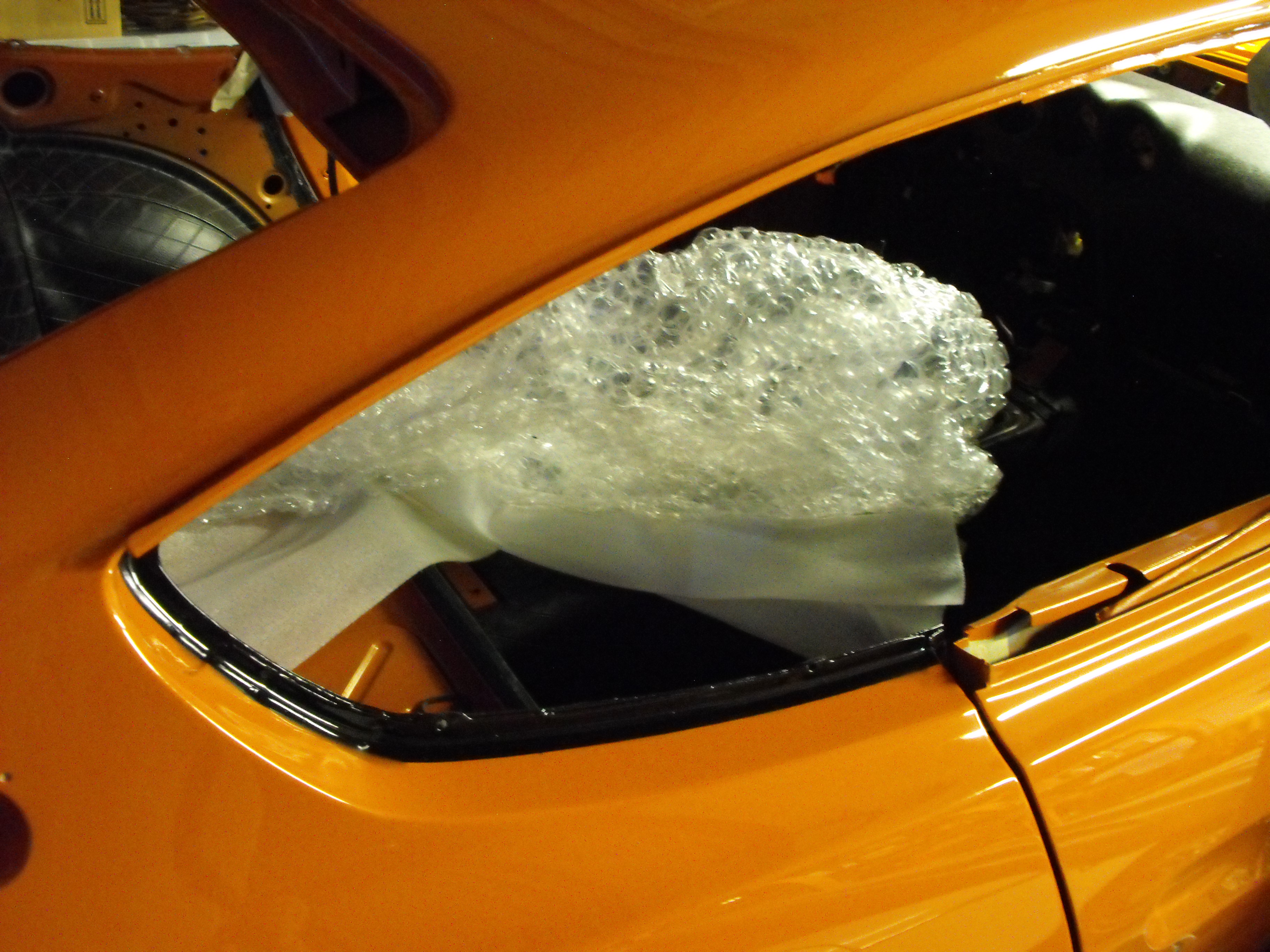

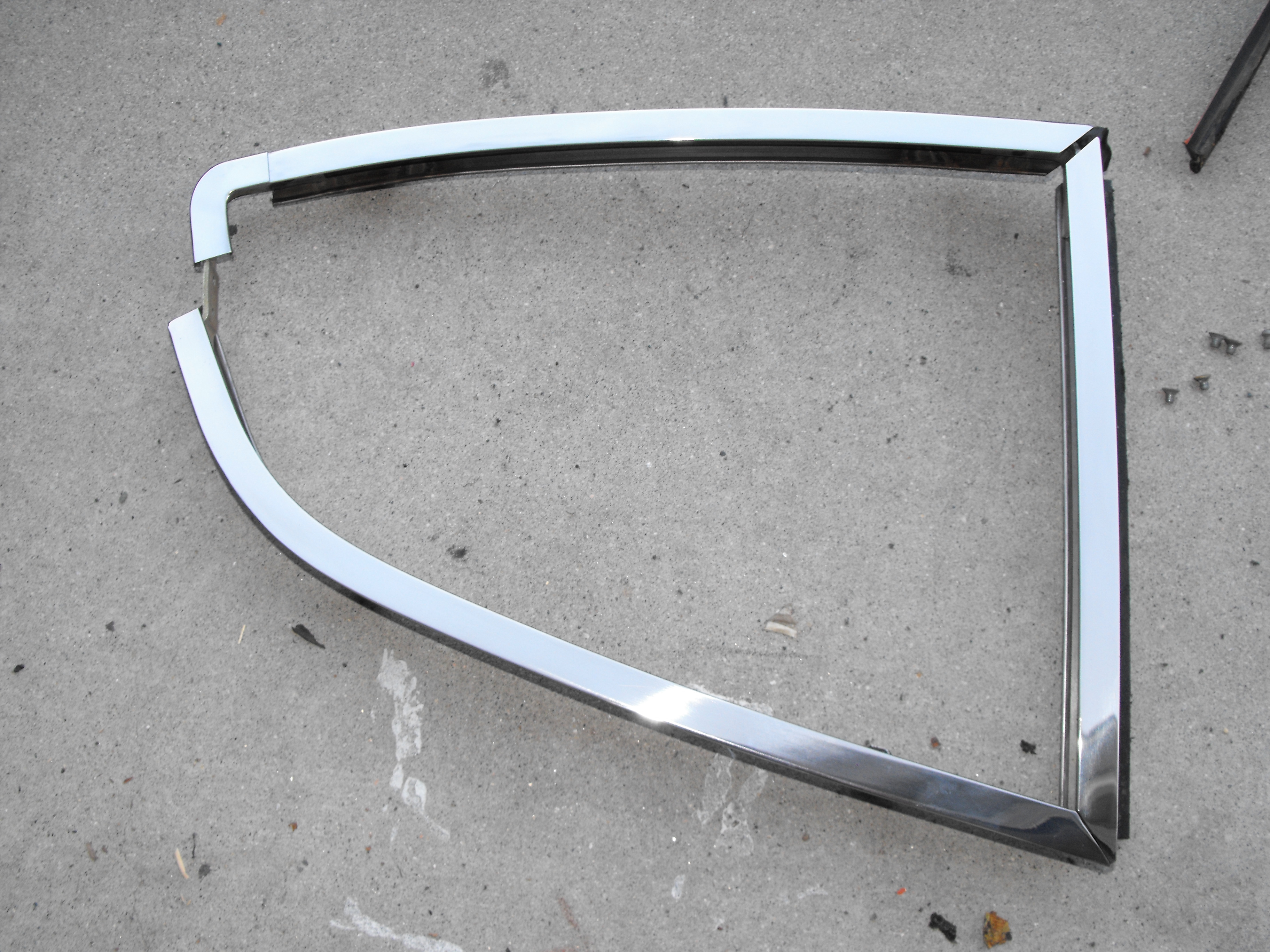

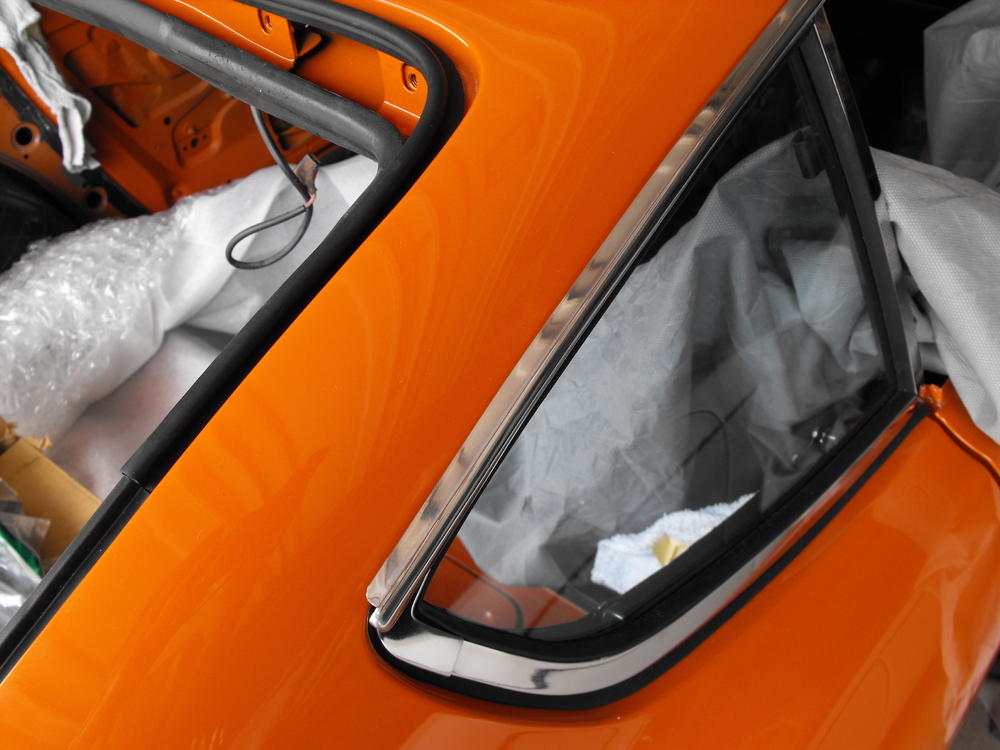

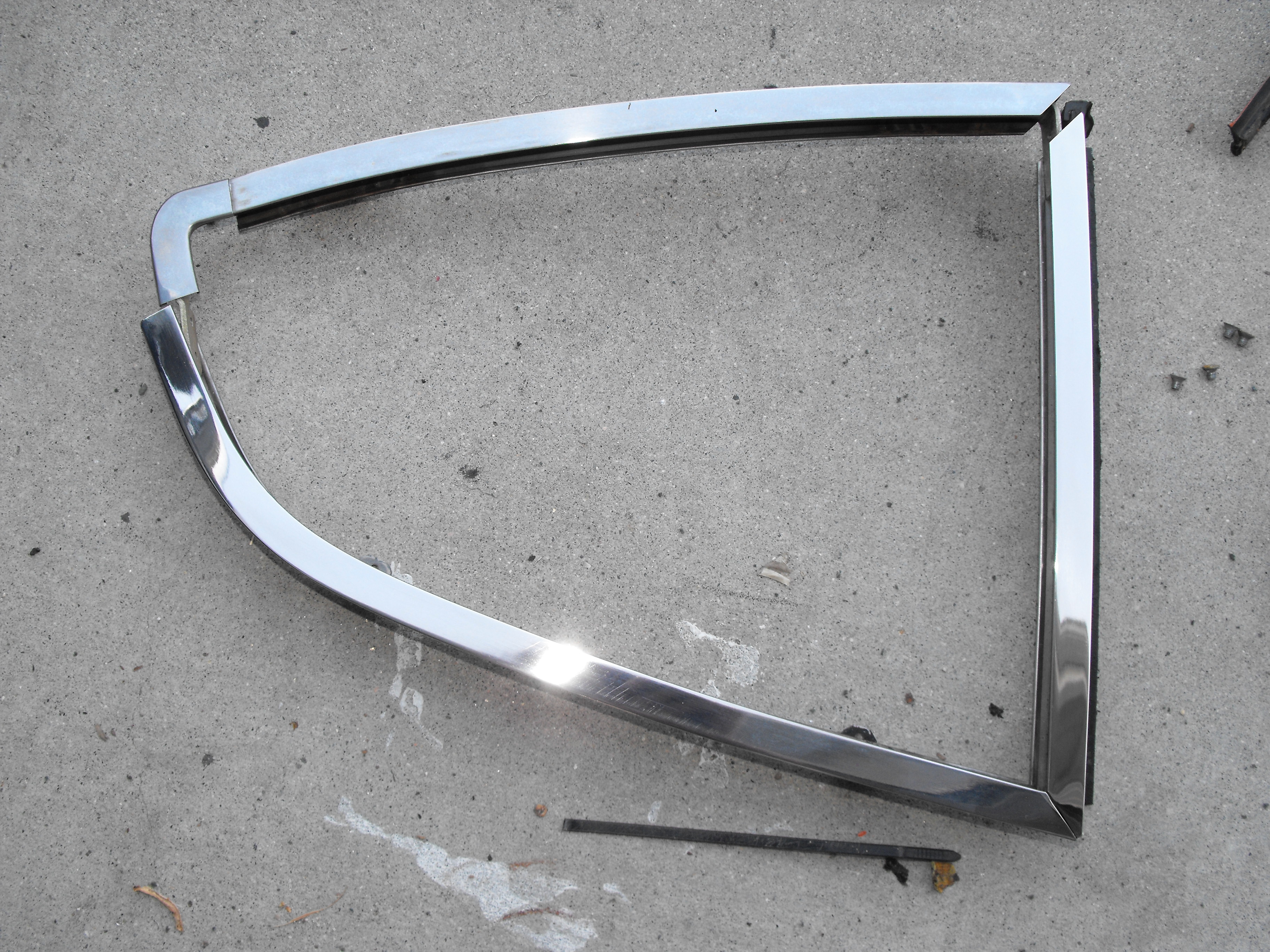

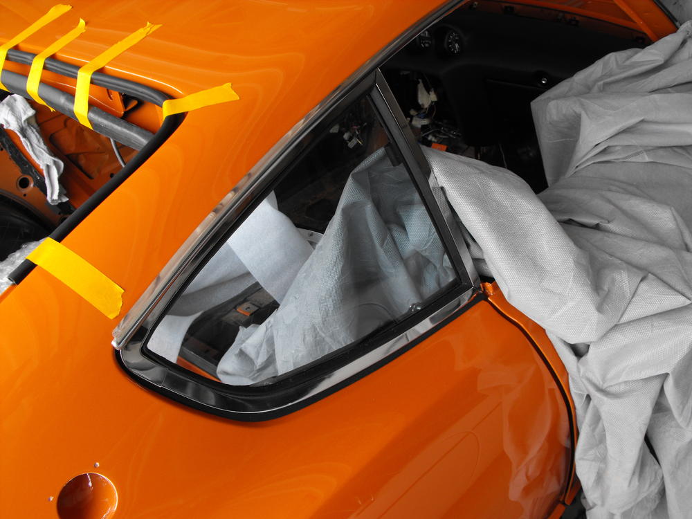

Installed the passenger side quarter window.  I buffed out the frame on the polishing wheel to give it a nice shine.  You can see the difference in the first and third pics.  The polish takes out some of the very small scratches.  I remembered to paint the  inside frame area satin black before installing the window (I forgot to do this on my '71 and it looks goofy, one of those things I need to go back and fix).  I installed all new weather stripping and new 4mm screws.  It's actually a fairly easy install.
I installed the drivers side rear window same as the passenger side.  Also polished and installed the rain gutter molding on both sides.

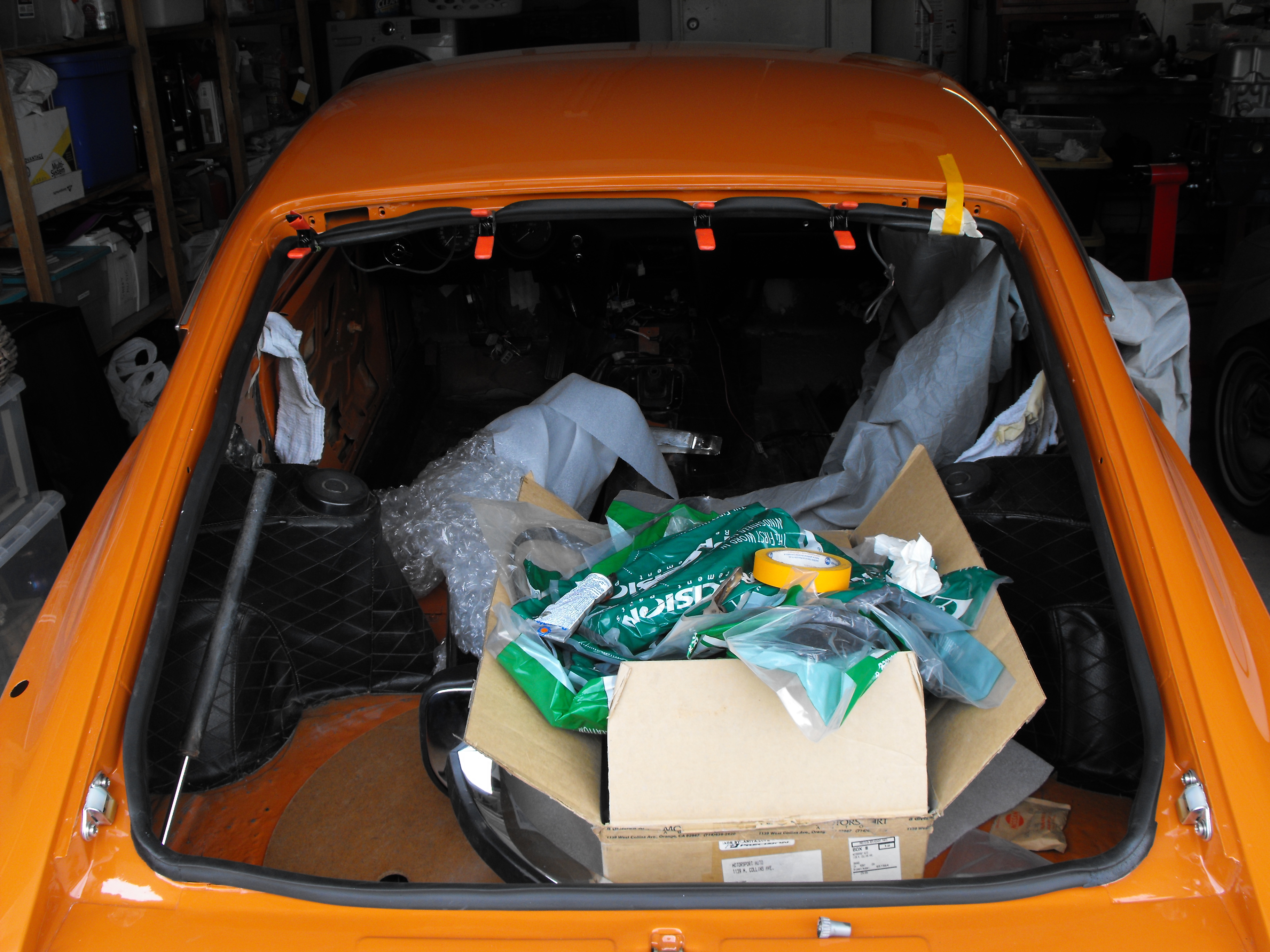

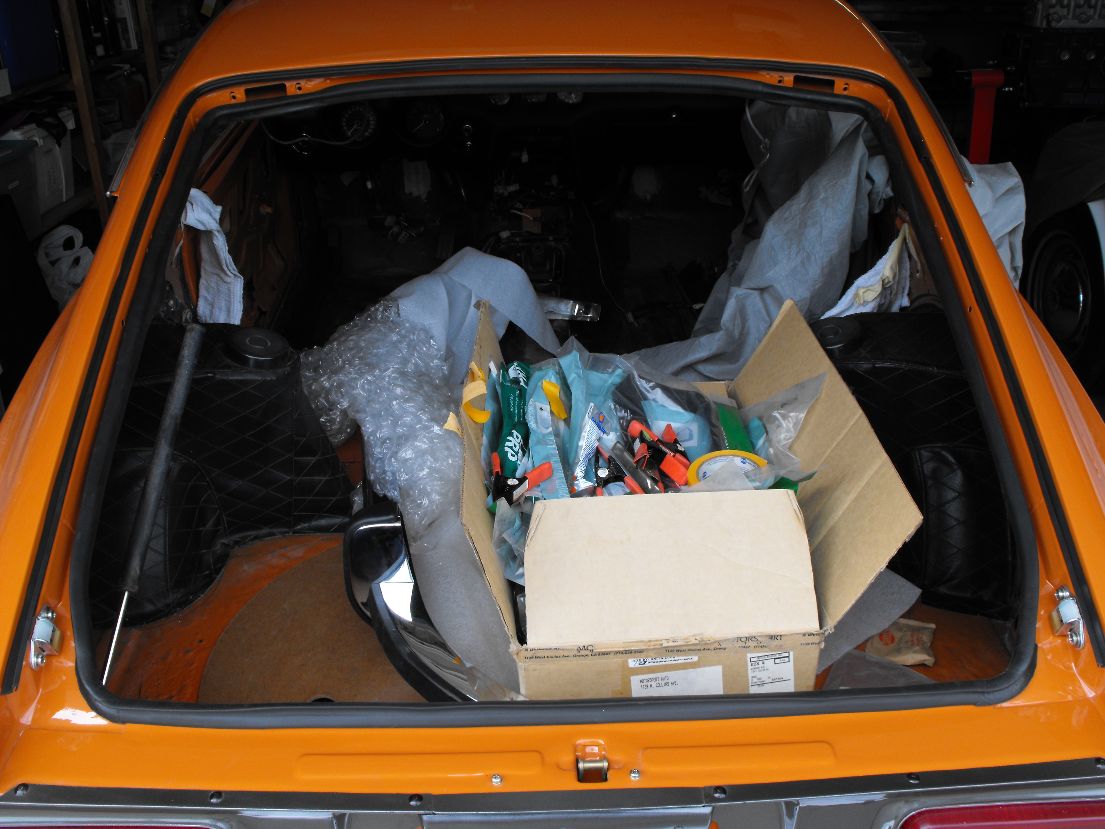

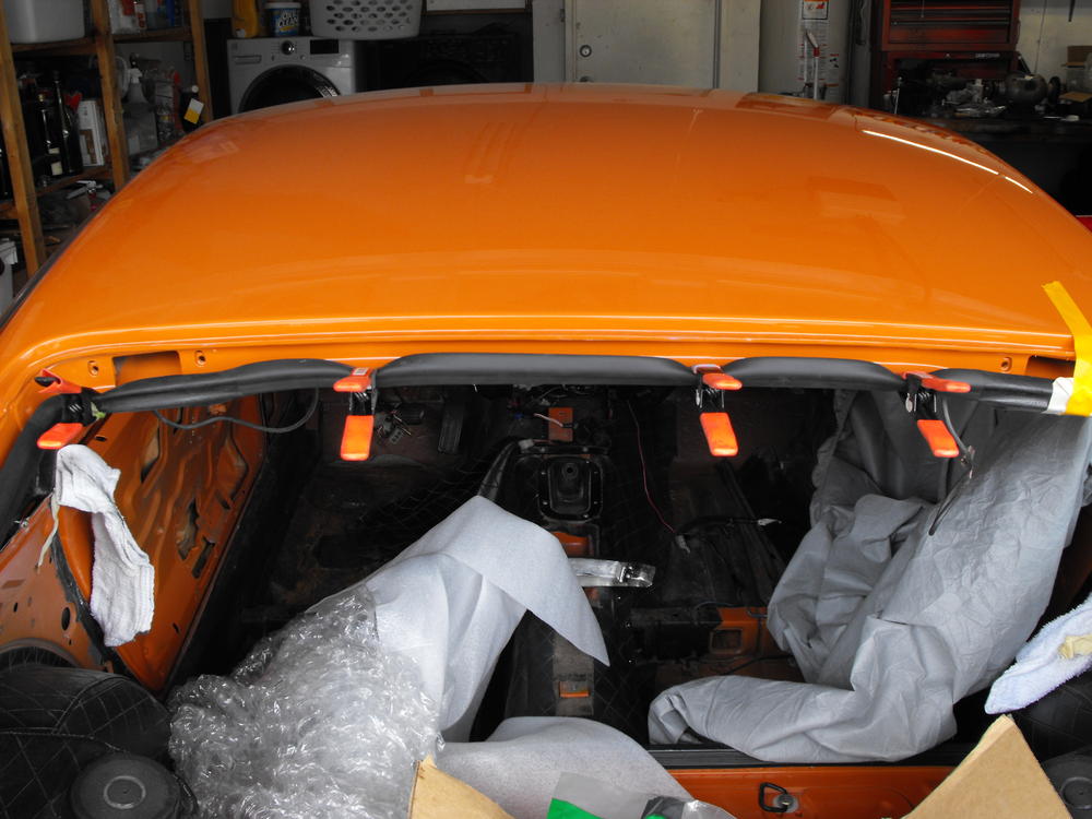

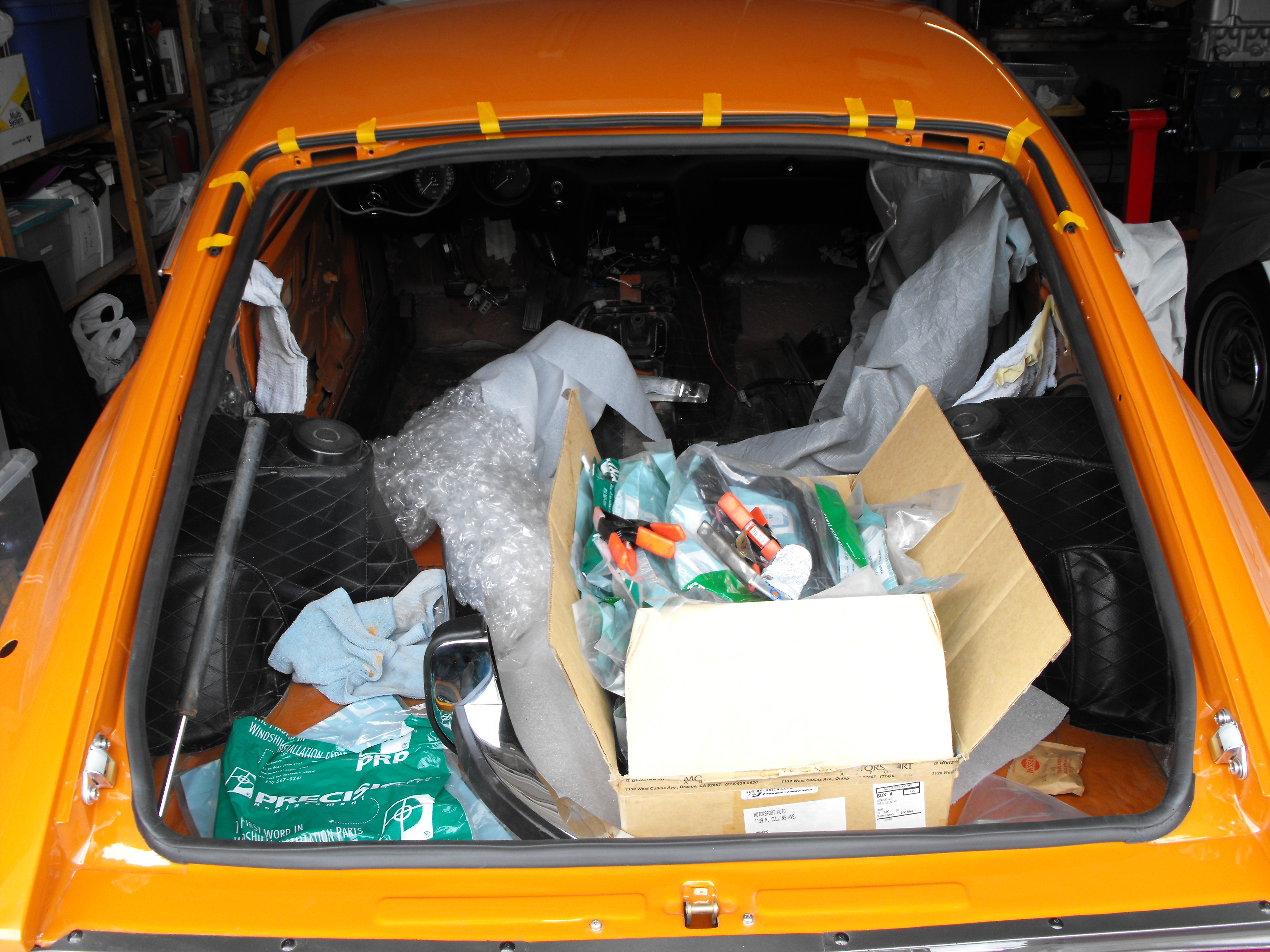

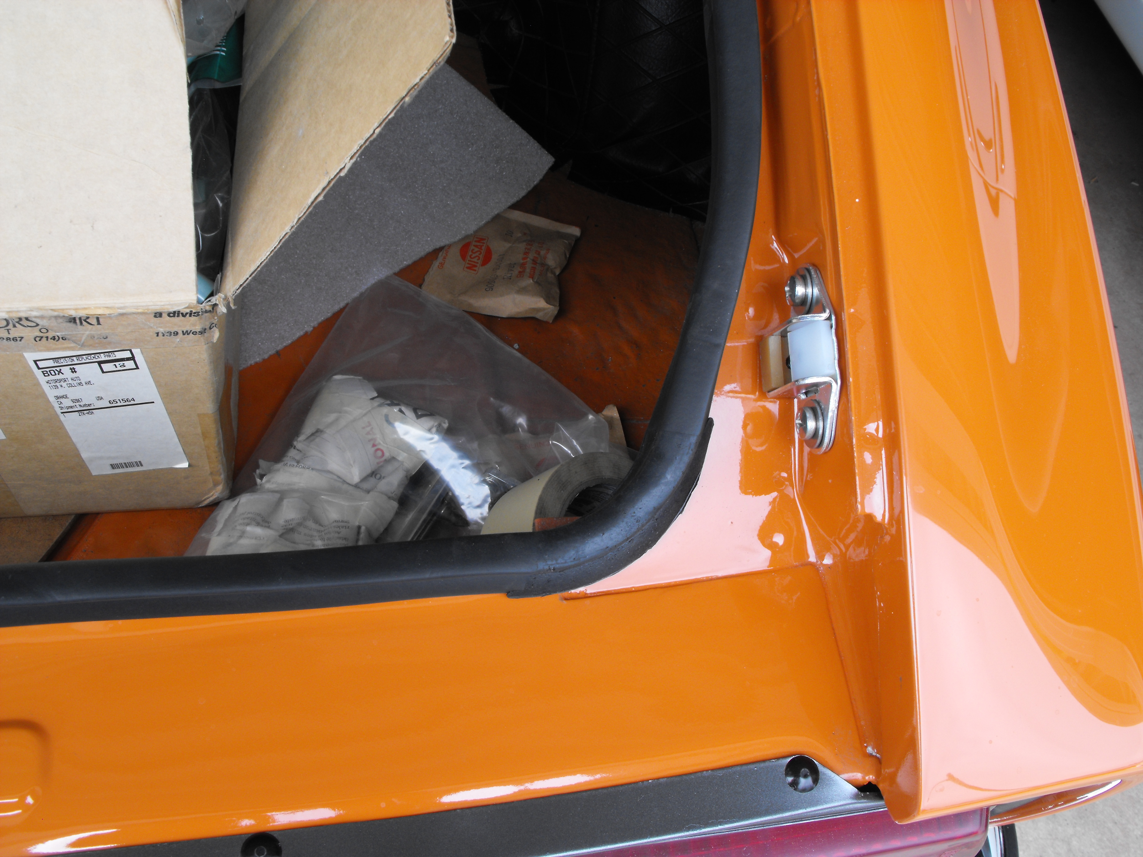

 I  installed the hatch weather stripping.  As always, I hate putting in weatherstripping but this was one of the easier installs since the hatch was removed.  I think I will do this on all future hatch weatherstripping, it made the job so much easier.  The other thing I did differently was install the weatherstripping without glue first.  Then I went along foot by foot applying the glue to the installed weatherstripping.  Using the clamps and tape to keep things in place was also a big help.  These work well to keep everything secure and nicely aligned.

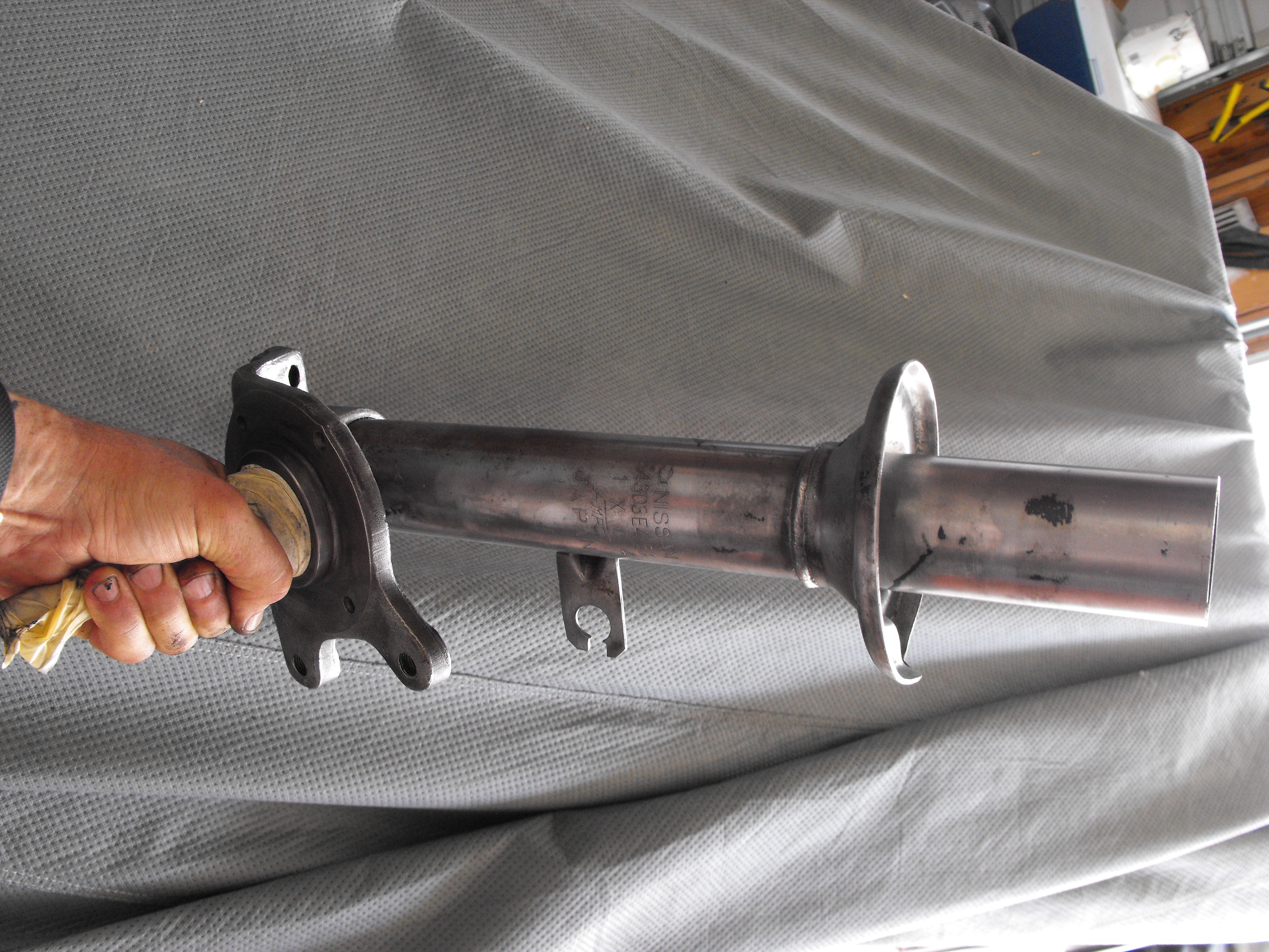

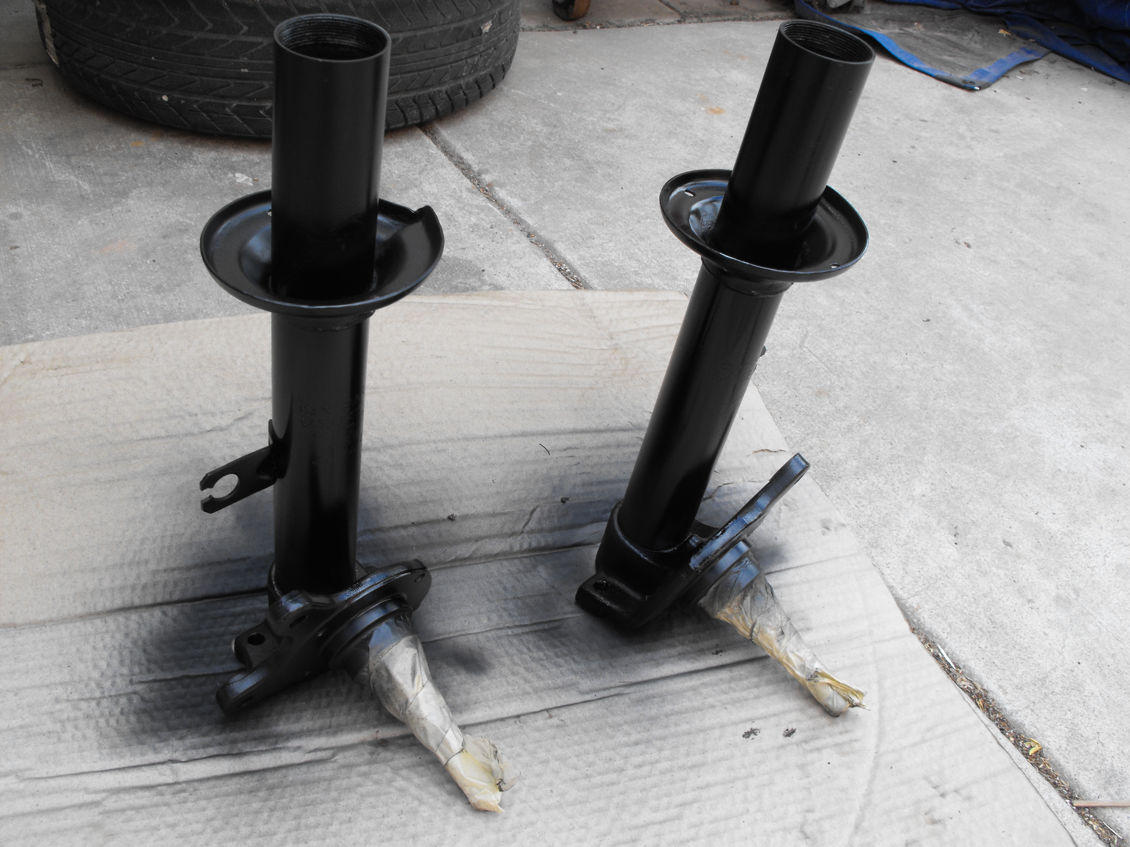

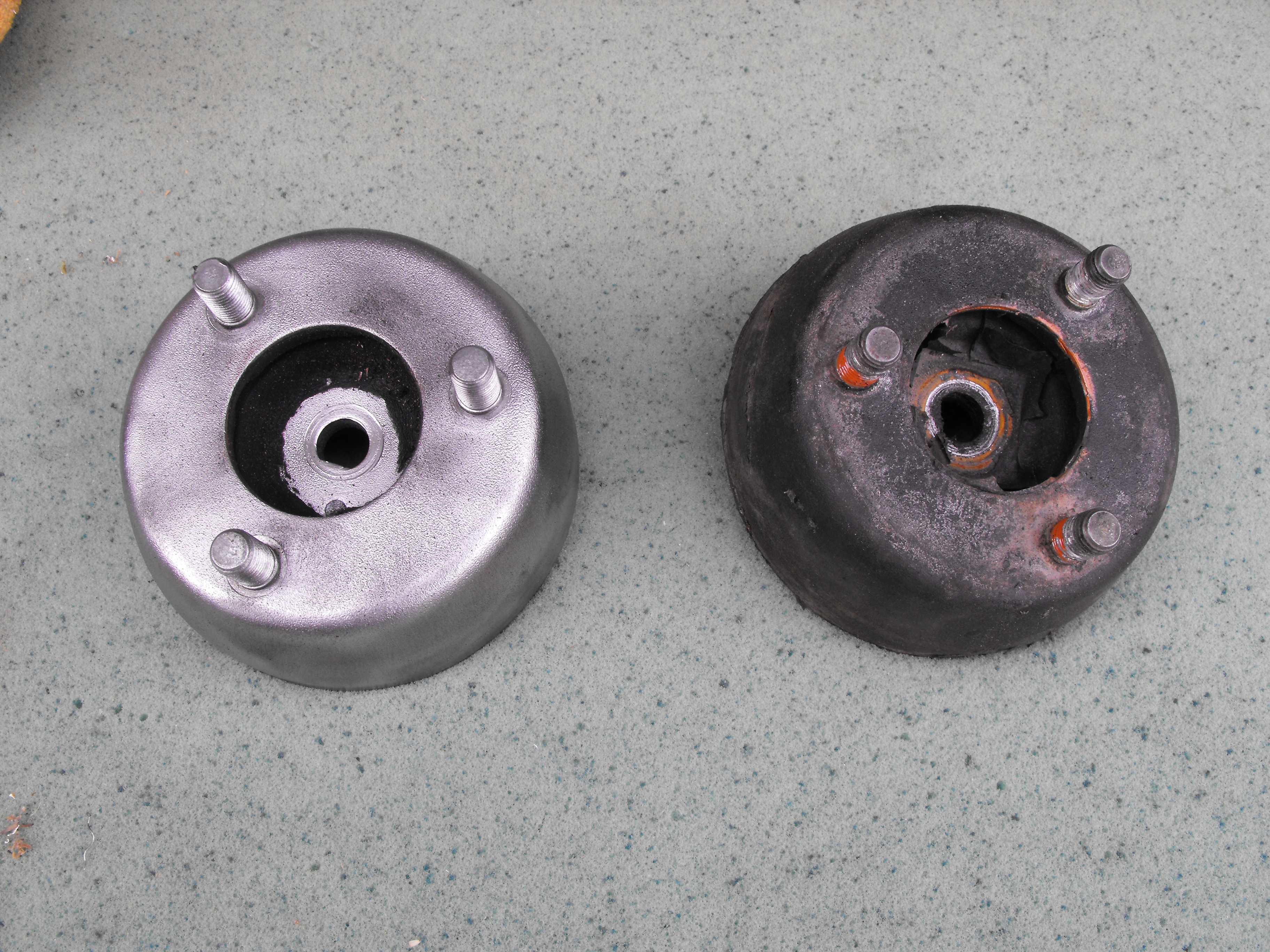

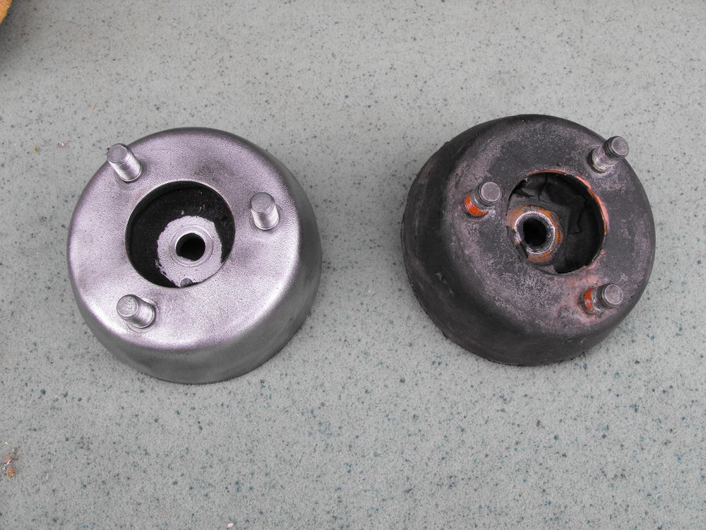

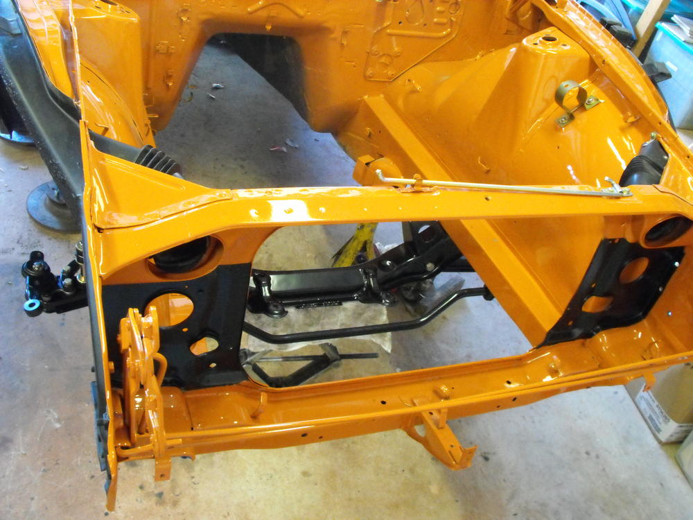

Started clean-up and paint on the shock tower components.  I should be able to get those installed today once I  finish a few home items.
