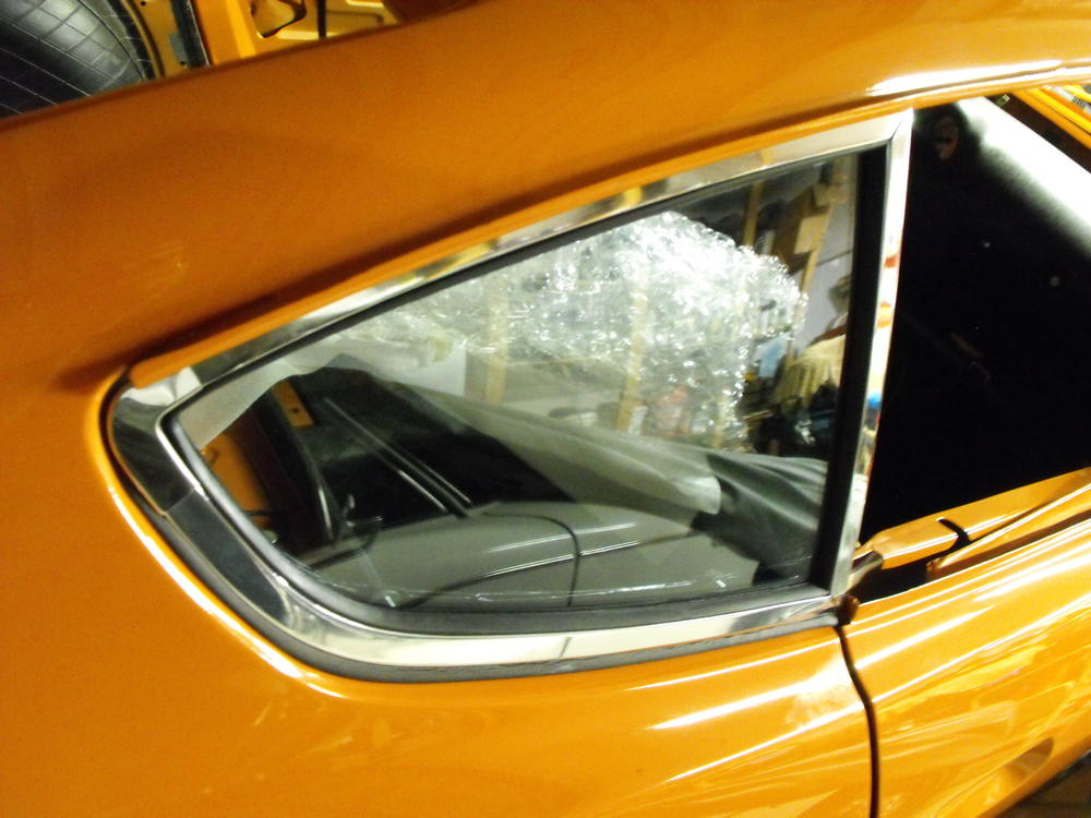

So this is an interesting item.  I checked the area on my '70 and there is really no need for black paint in this area as the interior plastic panels are all the way up against the window frame.  There is no gap, so I cannot see the area that I painted at all.  On my '71, there is a significant gap, maybe half an inch, and you can clearly see this area.  Now I am wondering why the gap at the window.  I will check my '72 when I get home, but that one may have been painted so I am not sure if it is a good reference.  My bigger concern now is the gap.  Why does the '71 have a gap at the window frame?  Did I install the wrong panel? (I do have several sets at home).  I was under the impression that the gap was normal as Jay Ataka was the one that brought it to my attention at one of the car shows.  Anyway, will have to look into this further.
In your photos of your quarter windows- the top-rear "corner" of the installed passenger side looks like the seal is folded in behind the corner piece.
Looking at the '71 I have here, I don't even see the screw tabs, and there is no gap whatsoever- and the seal is even all the way around.
Did you put the little rubber shims in that area to puff it up and get a good seal there? Perhaps your seal bunched up in the corner and now the window won't fully seat.
Doesn't the interior panel kind of sneak over the tabs anyways, and but up close to the window to cover them?
I haven't taken the '71 interior panel off yet, so I won't know for sure if it's painted until I do (maybe tonight).
Edited by Careless

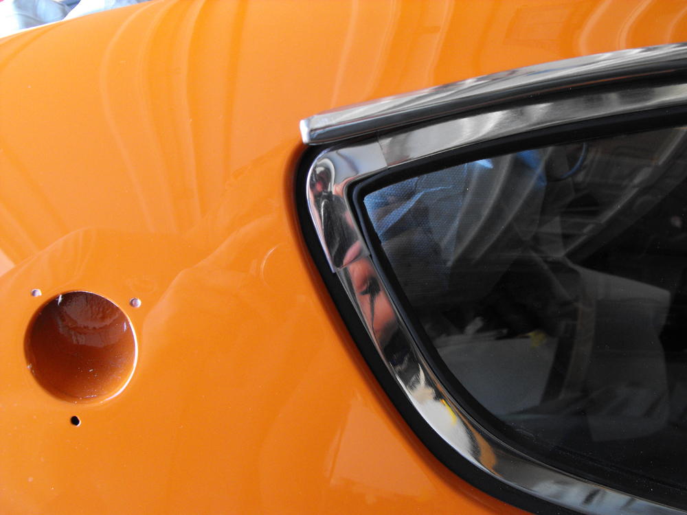

          I looked at that corner piece again as the outside gasket did look a bit 'thin' in that area.  It looked like the corner piece needed to be inserted a bit more into the frame so I tapped it in and re-assembled and it looks better. I took a pic and added it below.
          I checked the gap between the window frame and inside panel on my '72 and there looks to be about an 1/8 inch gap between the panel and the frame.  As I mentioned before, there is zero gap on my '70.  I am wondering if heat and sun exposure causes the panel to either shrink or deform and cause the gap.  That might explain why my '70 has no gap and the '72 has a gap as that car has obviously been in the sun.

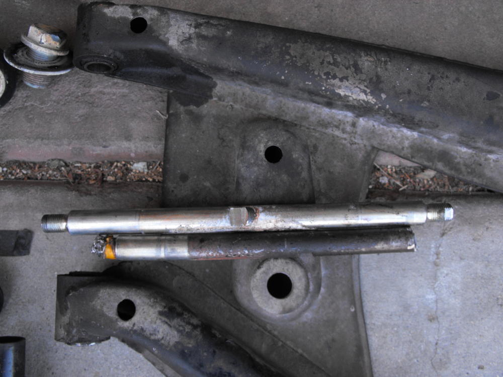

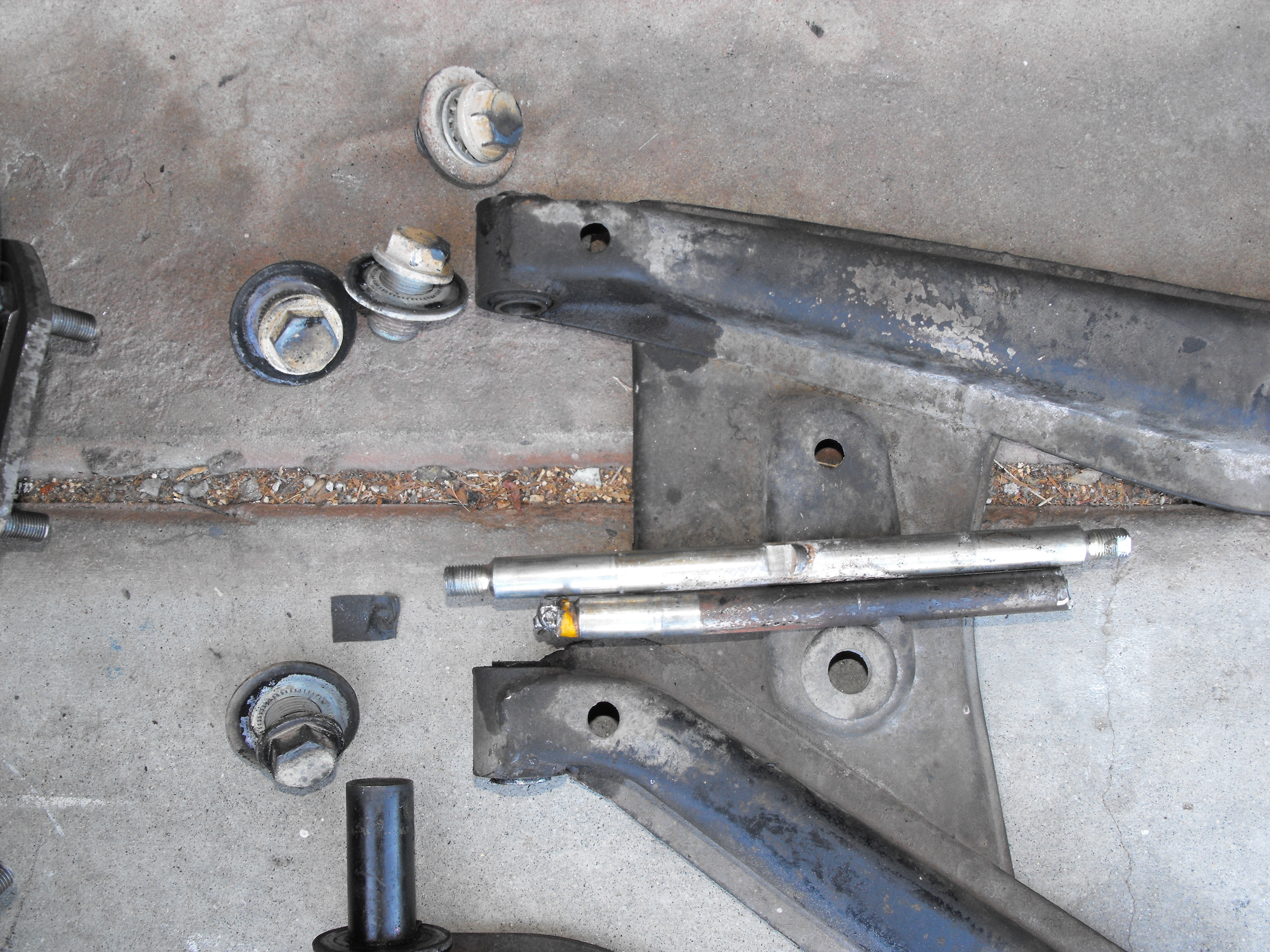

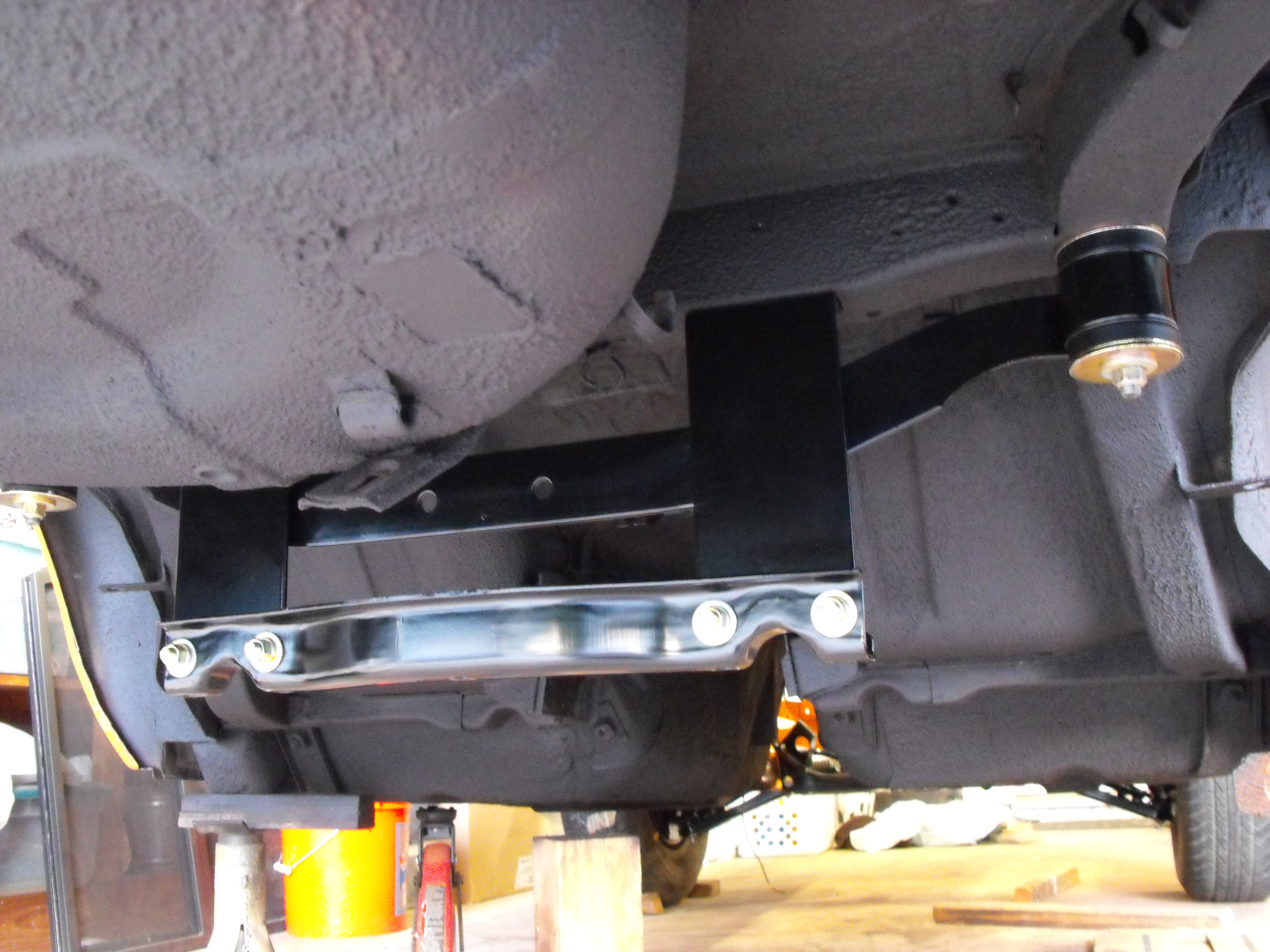

        Also, I chickened out on doing the spindle pins myself and took it to the machine shop.  I also had them undo the 4 large bolts on the lower A arms.  (Those are the ones I broke my torque wrench on so I am guessing I hit them with over 200 foot-lbs without success).  They were able to get everything off, but said it was really a pain in the arse and it took some time.  Bill, the machine shop lead said they had the metal red hot and put it in a 50 ton press to help with the removal.  I asked him what the charge was and he said "you couldn't pay me enough to do that again".  He charged just $60 for the work so I went back later and brought him a 6 pack of beer for the extra effort.  Just glad I didn't have to do it.   I don't have the tools.   Anyway, the nice thing is I can get the parts all off to the powder coater and plater this Monday and should have it all installed by next weekend.  If I can get that done, it will be time to drop in the motor.  I am looking forward to that
You can see how torched the large bolts are in the picture below.  I will get those cleaned up and replated.  Will also order new spindle pins from zcarparts.com

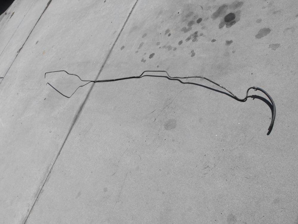

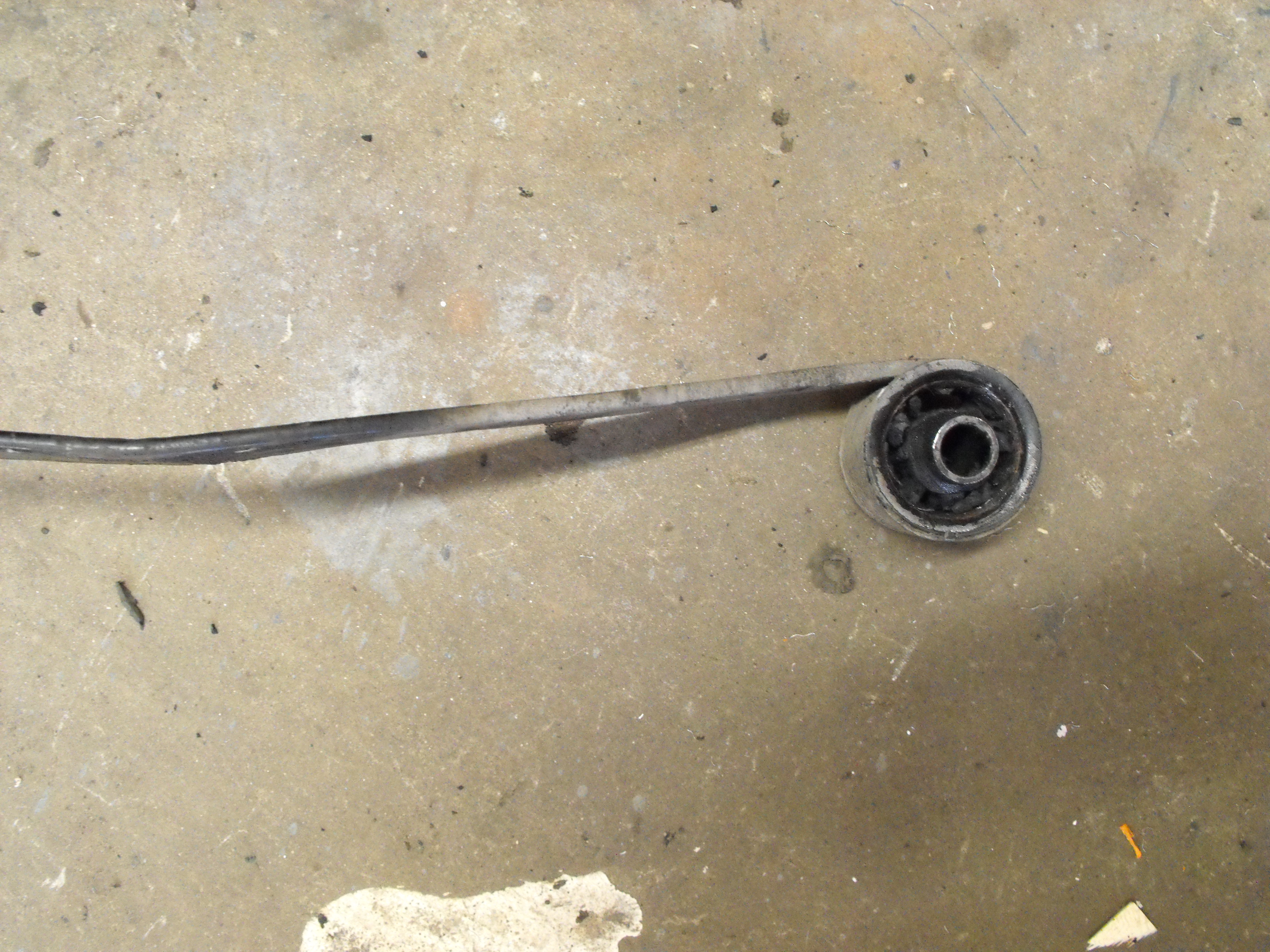

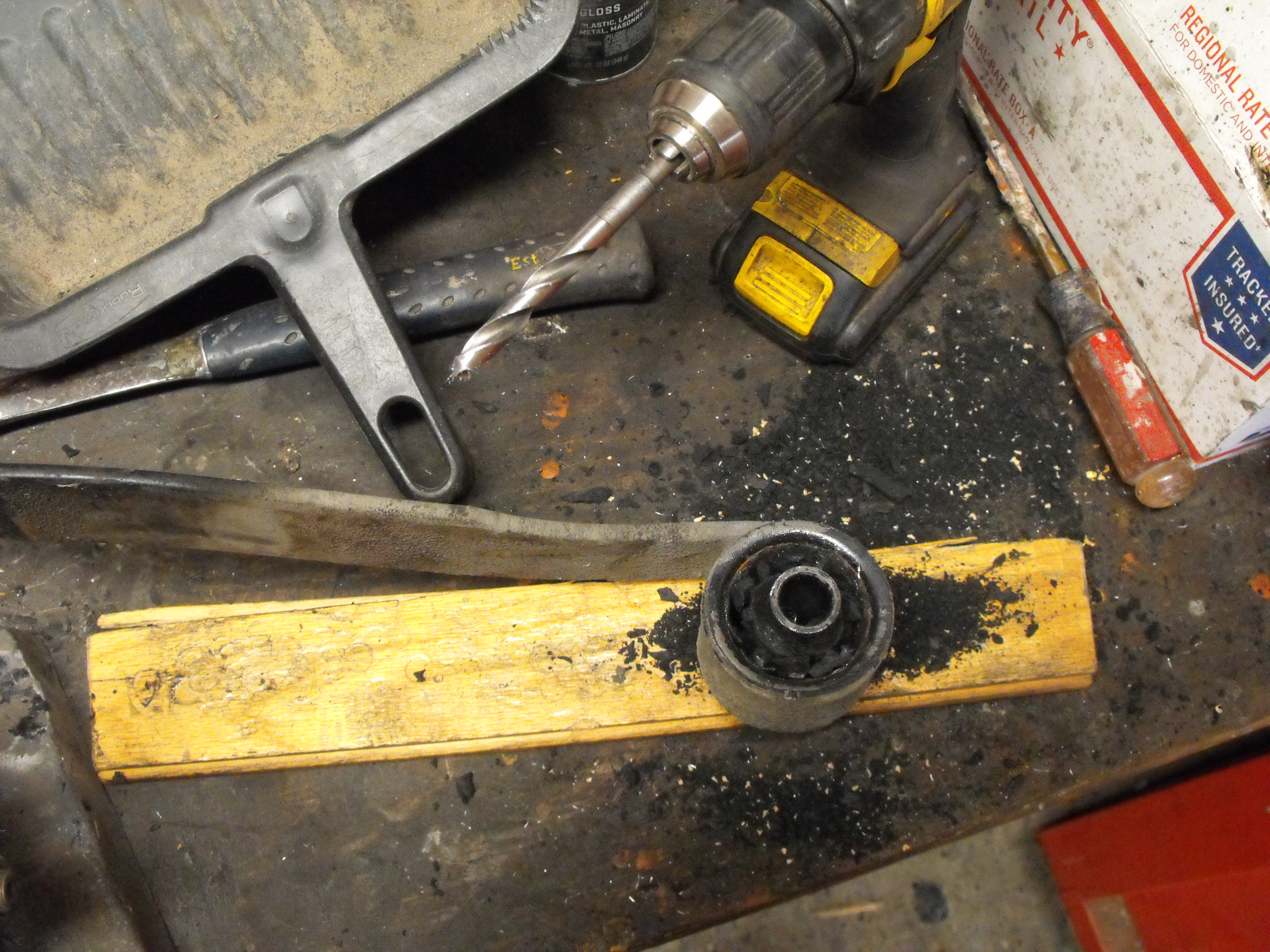

I drilled out the old bushings on the mustache bar and lower control arms.  I used a small wire wheel to clean up the inside.  Also scraped off the old undercoating from the suspension parts.  I will drop these all off at the powder-coater tomorrow AM.  I cleaned the outside of the fuel and brake lines in prep for plating.  I cleaned the tubes by sanding with 220 sand paper and finishing up with steel wool.  That makes for a pretty nice plating surface.  Then I add several large radius bends so that the lines will fit in the 40" long plating tanks.   Took pics of all the tubes before bending so I can get them back to the correct shape.  the long runs needed just 2 bends to fit within the 40" constraint.  These should look very nice once they are plated.
I did the same thing with the lines/
you'll probably want to cap the lines off with rubber vacuum caps.

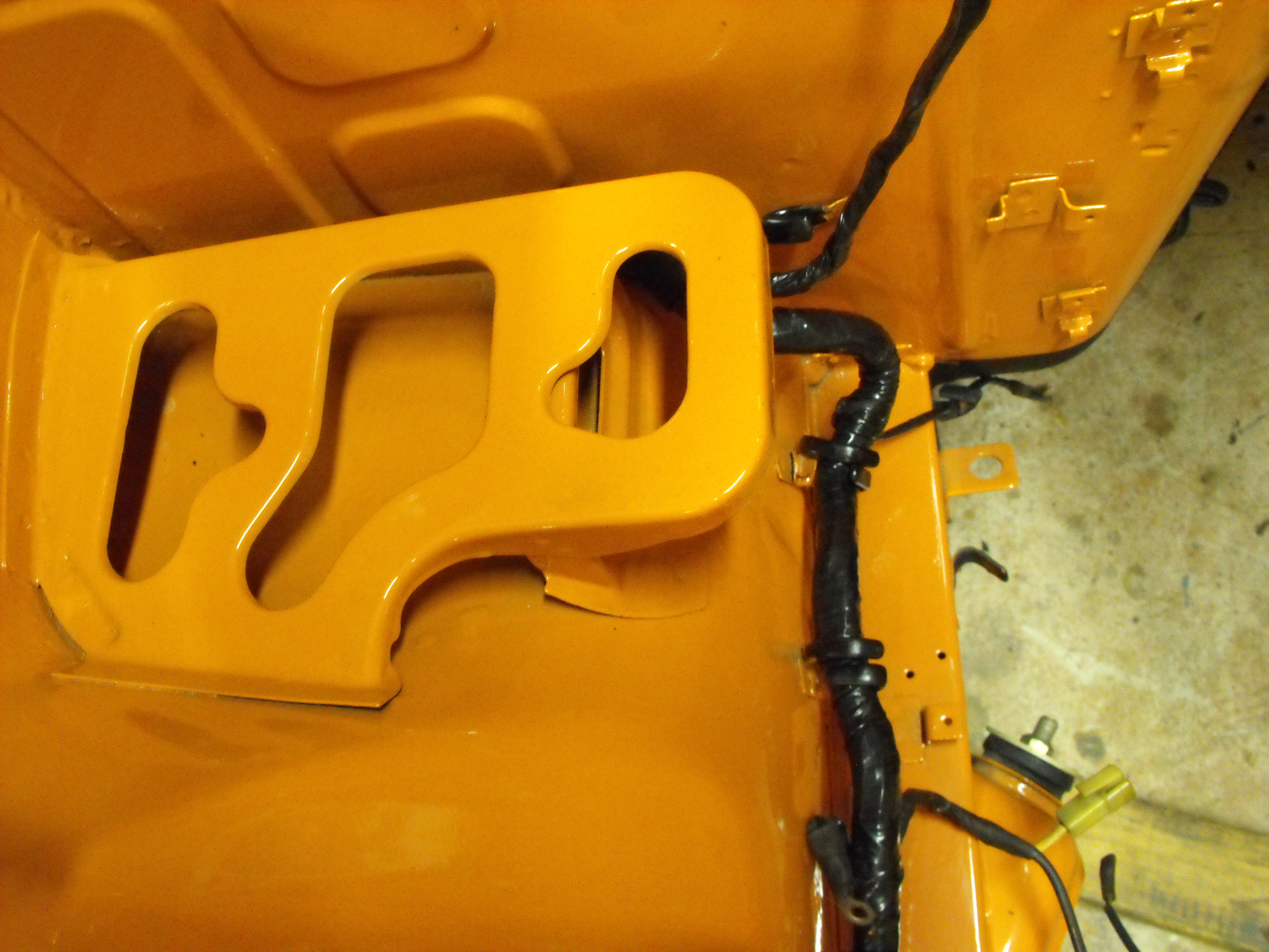

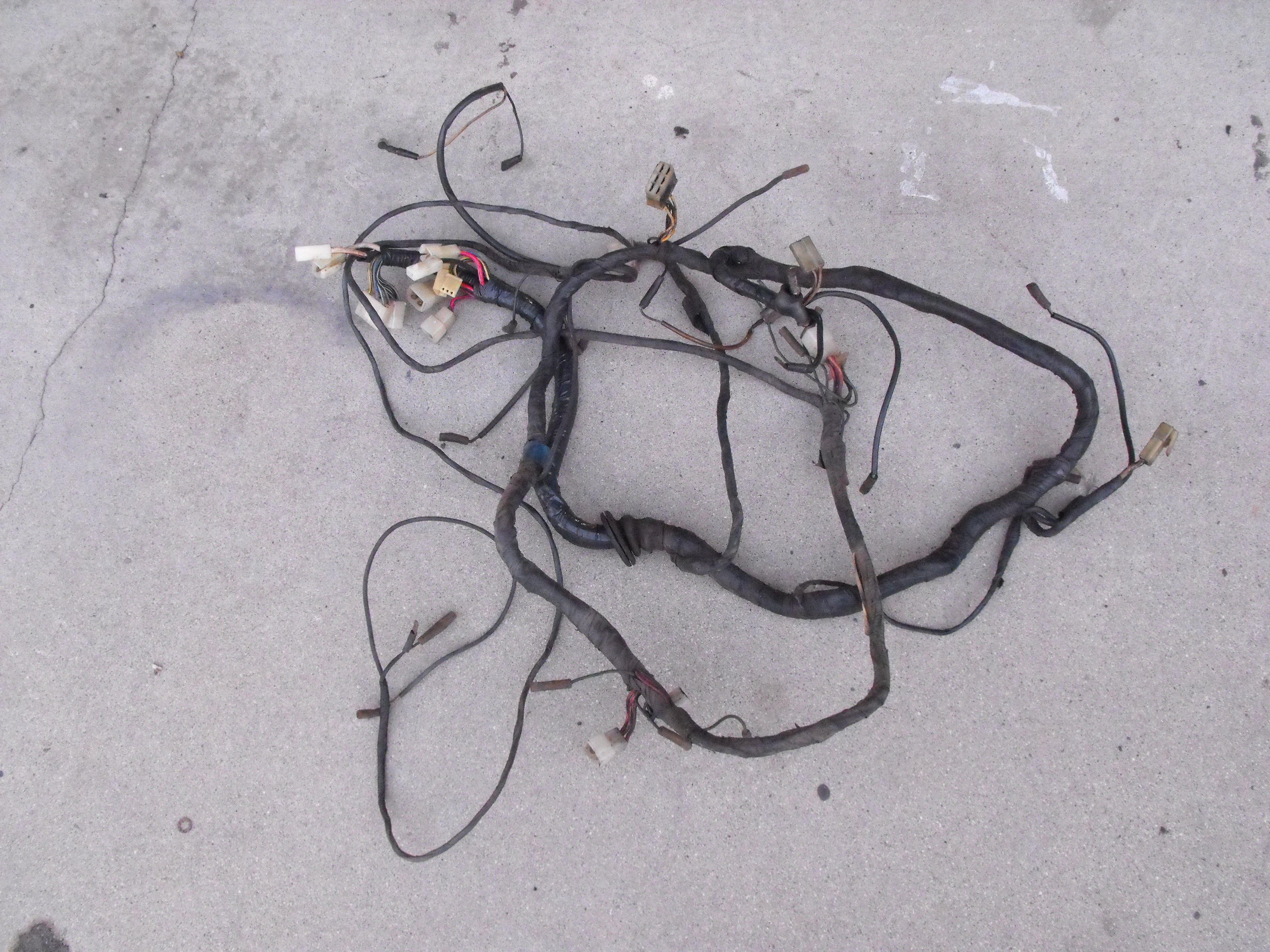

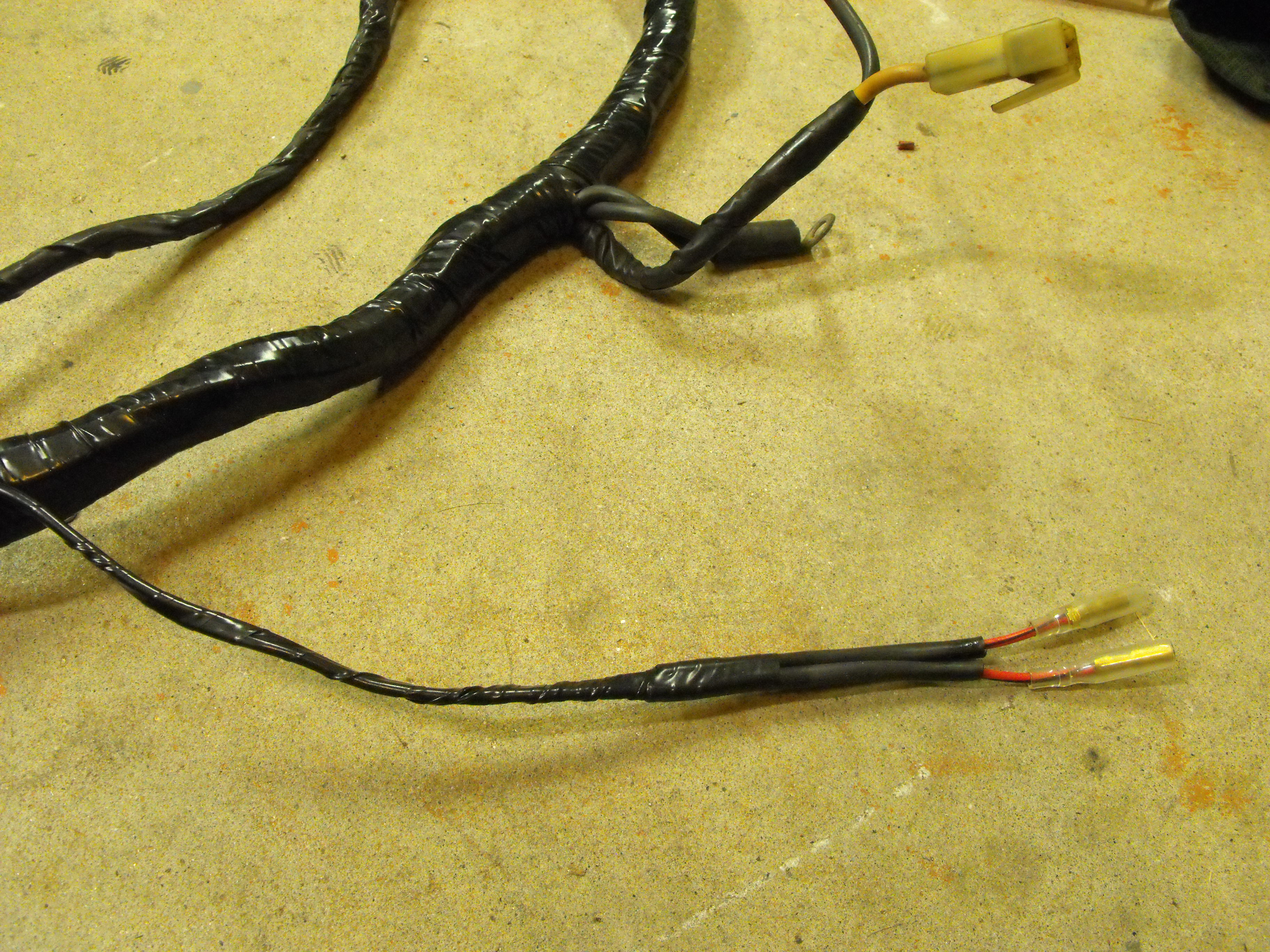

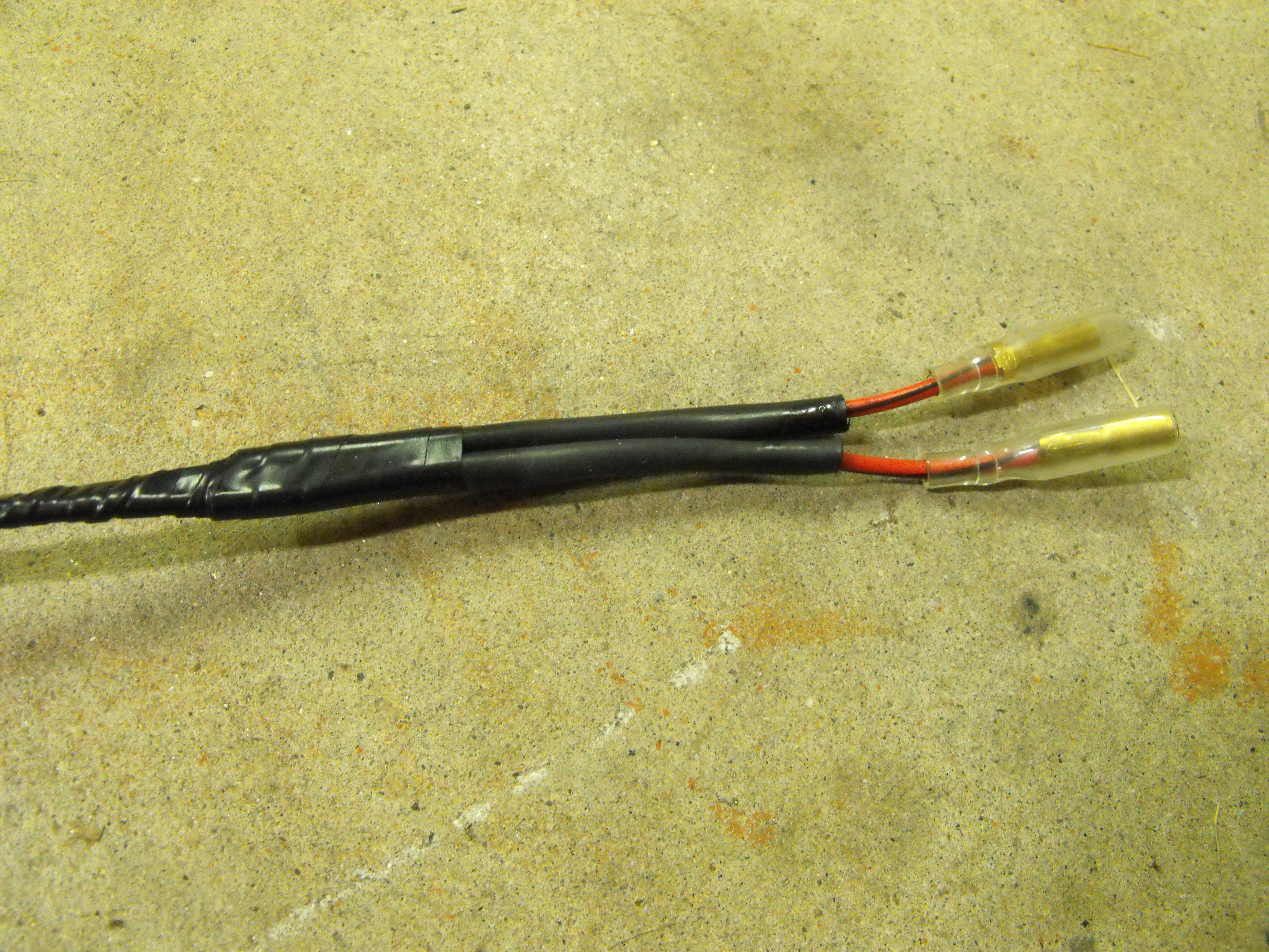

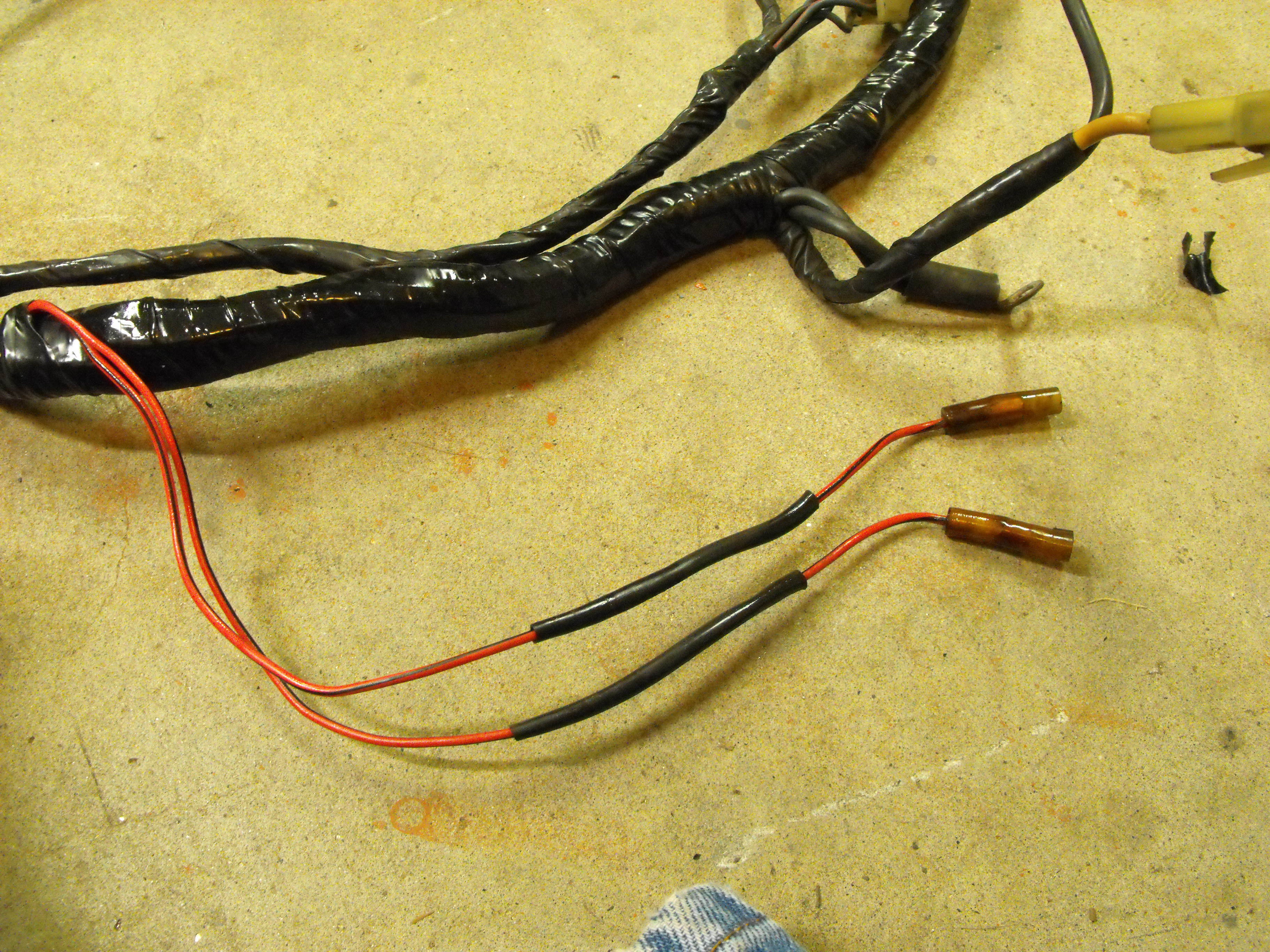

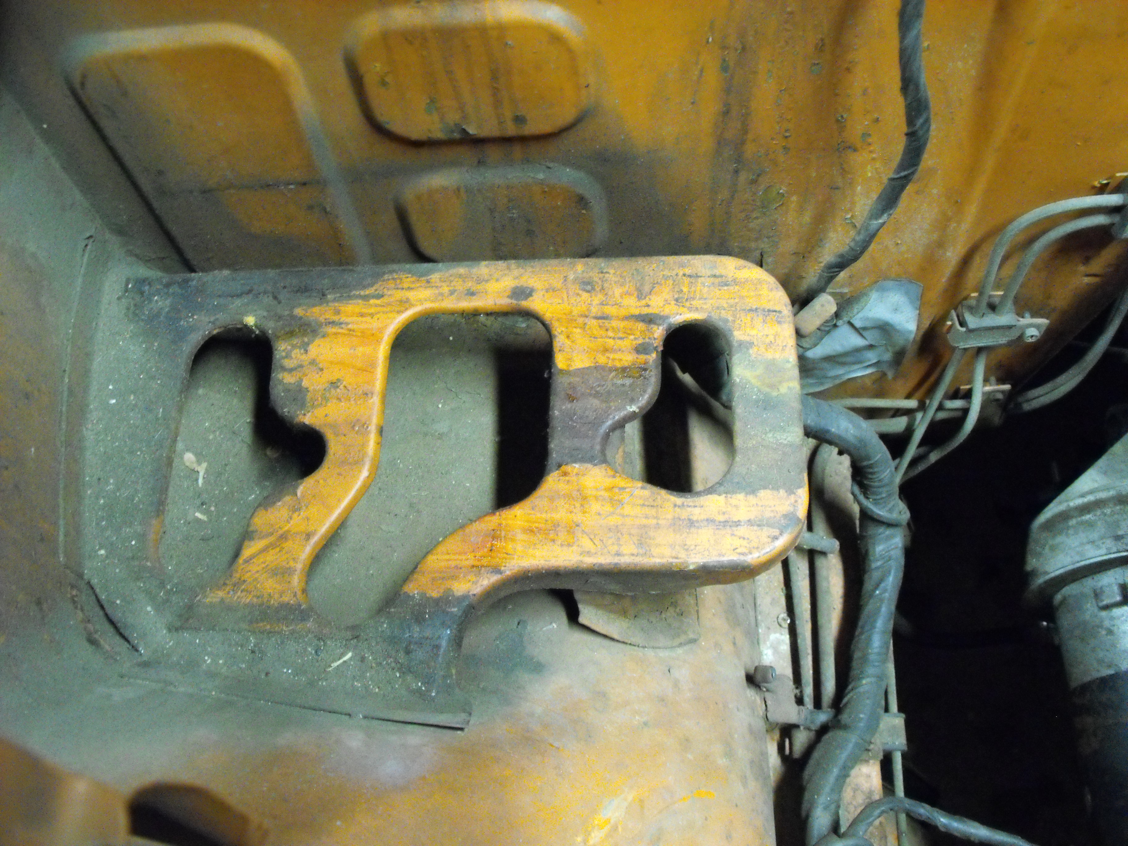

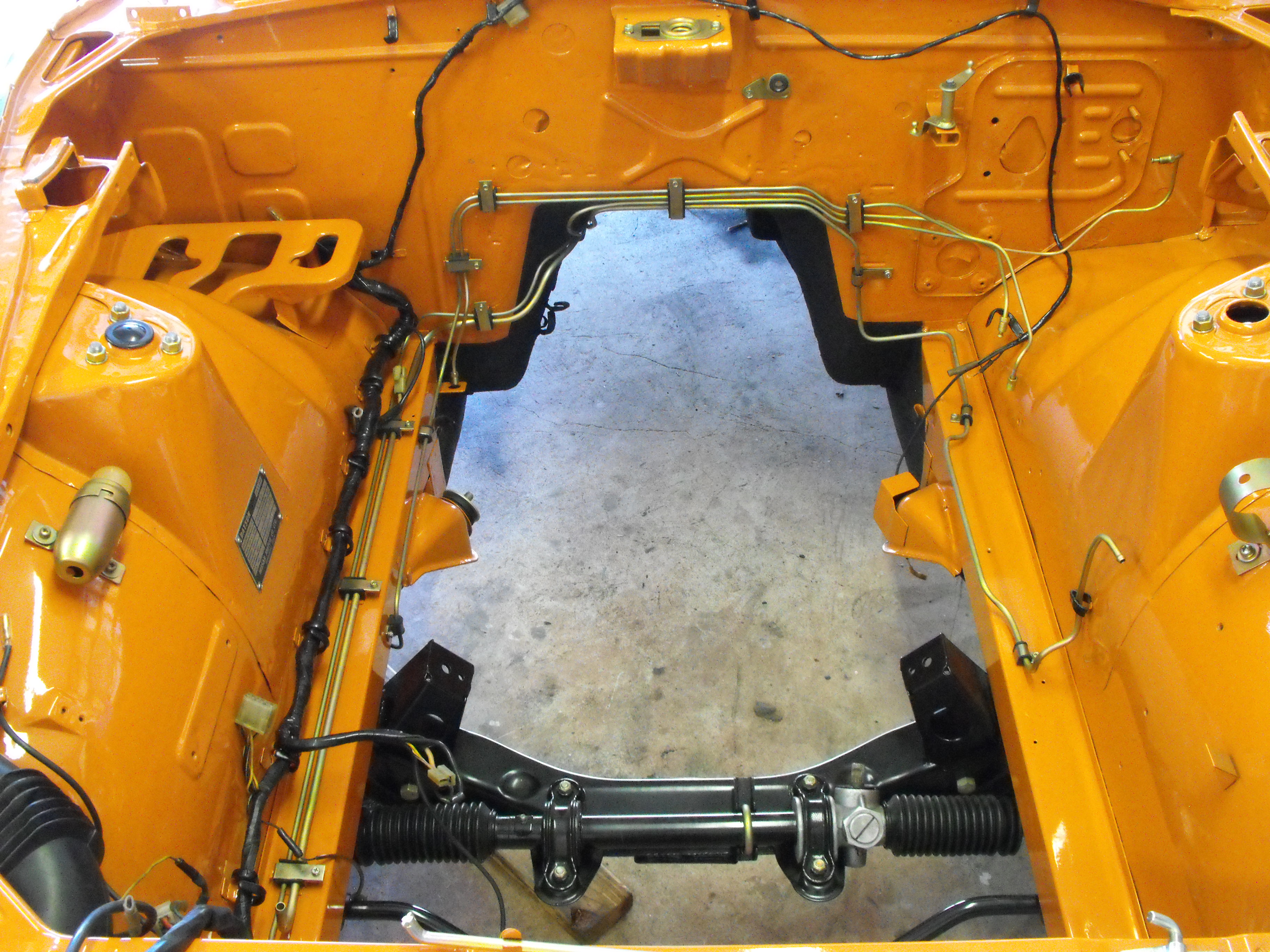

I re-wrapped the engine harness and am starting to change out the visible connectors.  I have the bullet connectors, so I have changed those out but need to get the blade connectors and connector housings.   I will get the housings from http://vintageconnections.com/.  I ordered 4.8mm blades from Amazon.   I also started installing the harness in the engine bay.  It is easy enough to change out the connectors with the harness installed so I figured I would put it in.  Pics below.  Also, one before and after pic.

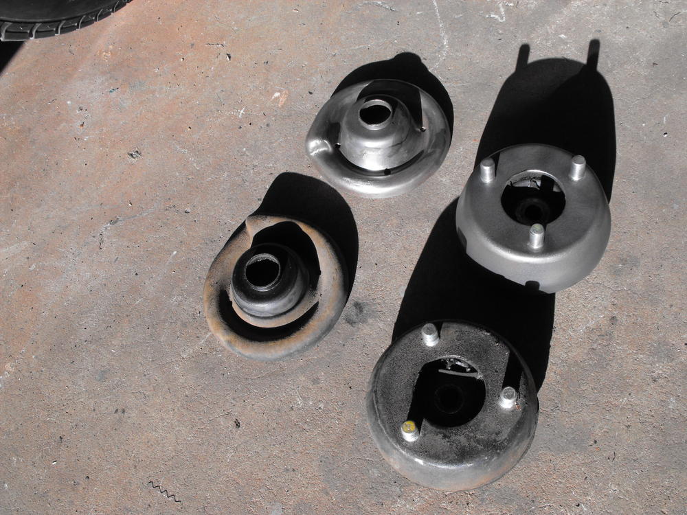

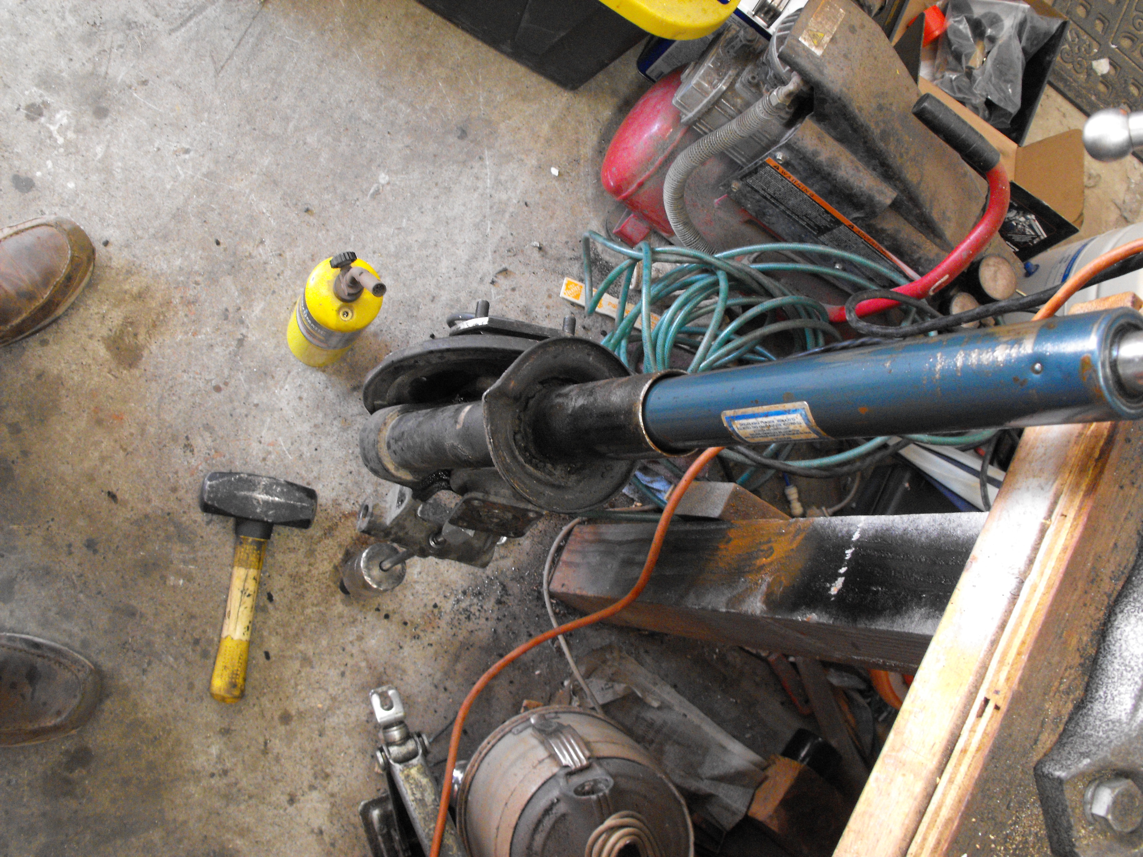

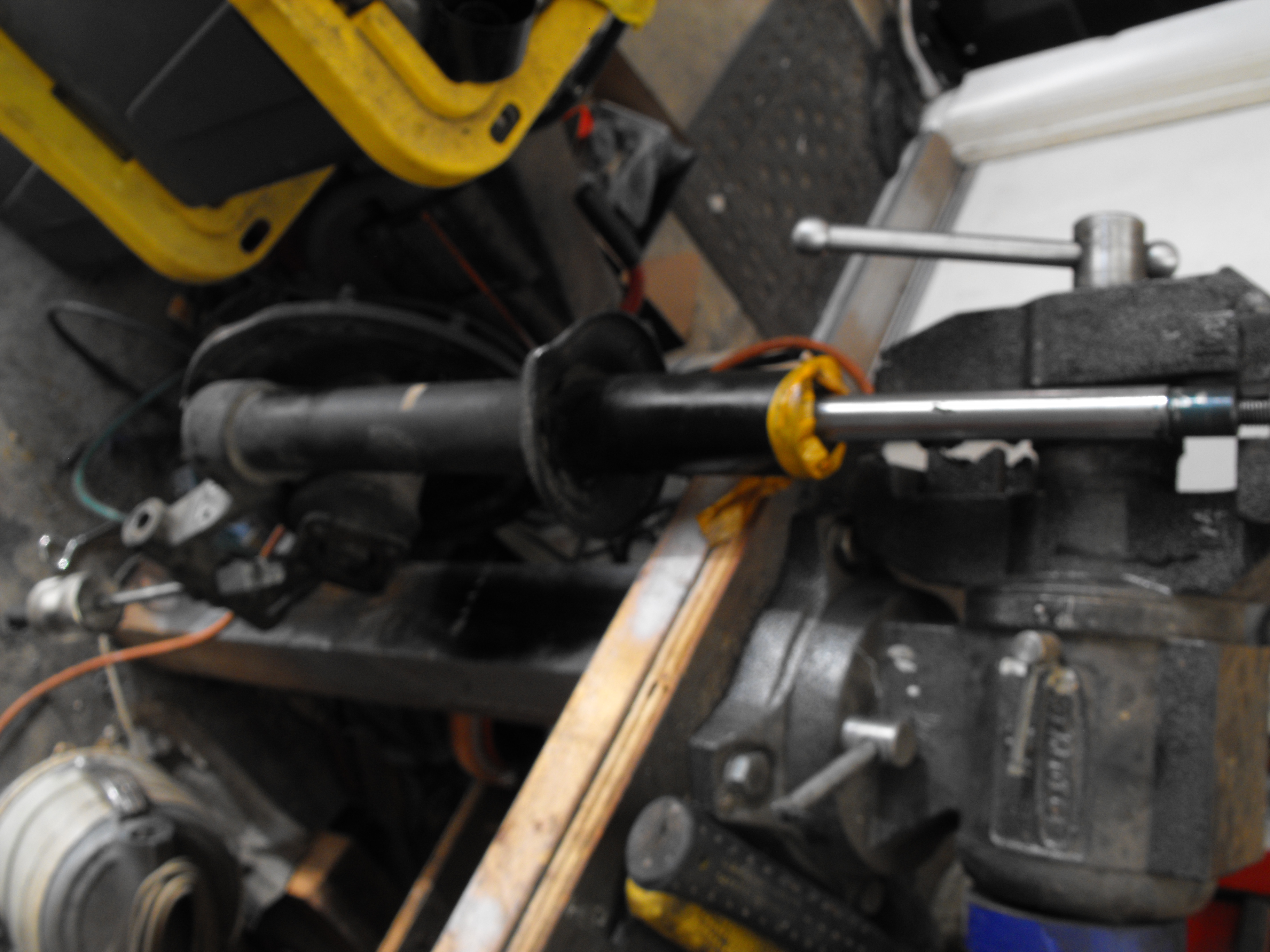

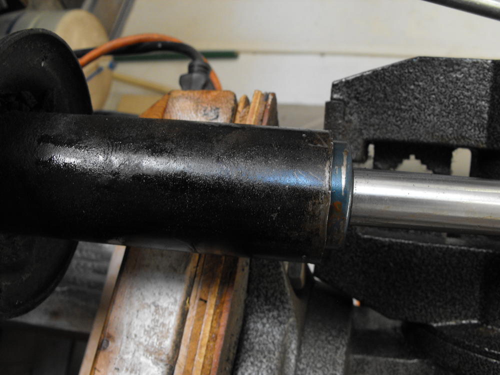

               So I cleaned up the rear shock towers and got one completely assembled.  Will finish the second tomorrow.  The old shock was stuck in the strut and was a challenge to get out.  The picture is a bit blurry, but I held the shock is my vise and put my slide hammer on the other end.  I ended up pounding on the slide hammer with a 4 lb hammer.  I soaked the strut in PB Blaster and Kroll for a couple hours.  Eventually I heated up the strut and pounded the strut off.  There was a lot of rust on the shock.

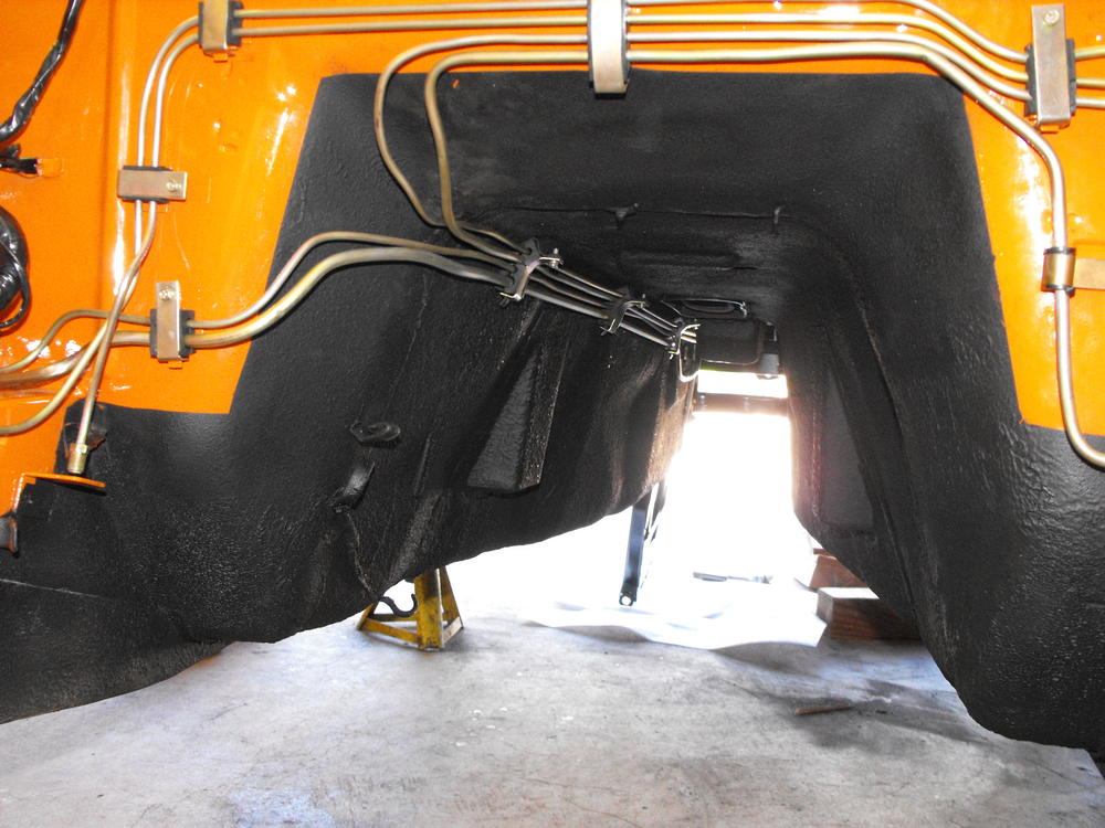

     I got the brake and fuel lines back from the plater and got those installed.  Will tackle the rear suspension tomorrow.   Pics are below
