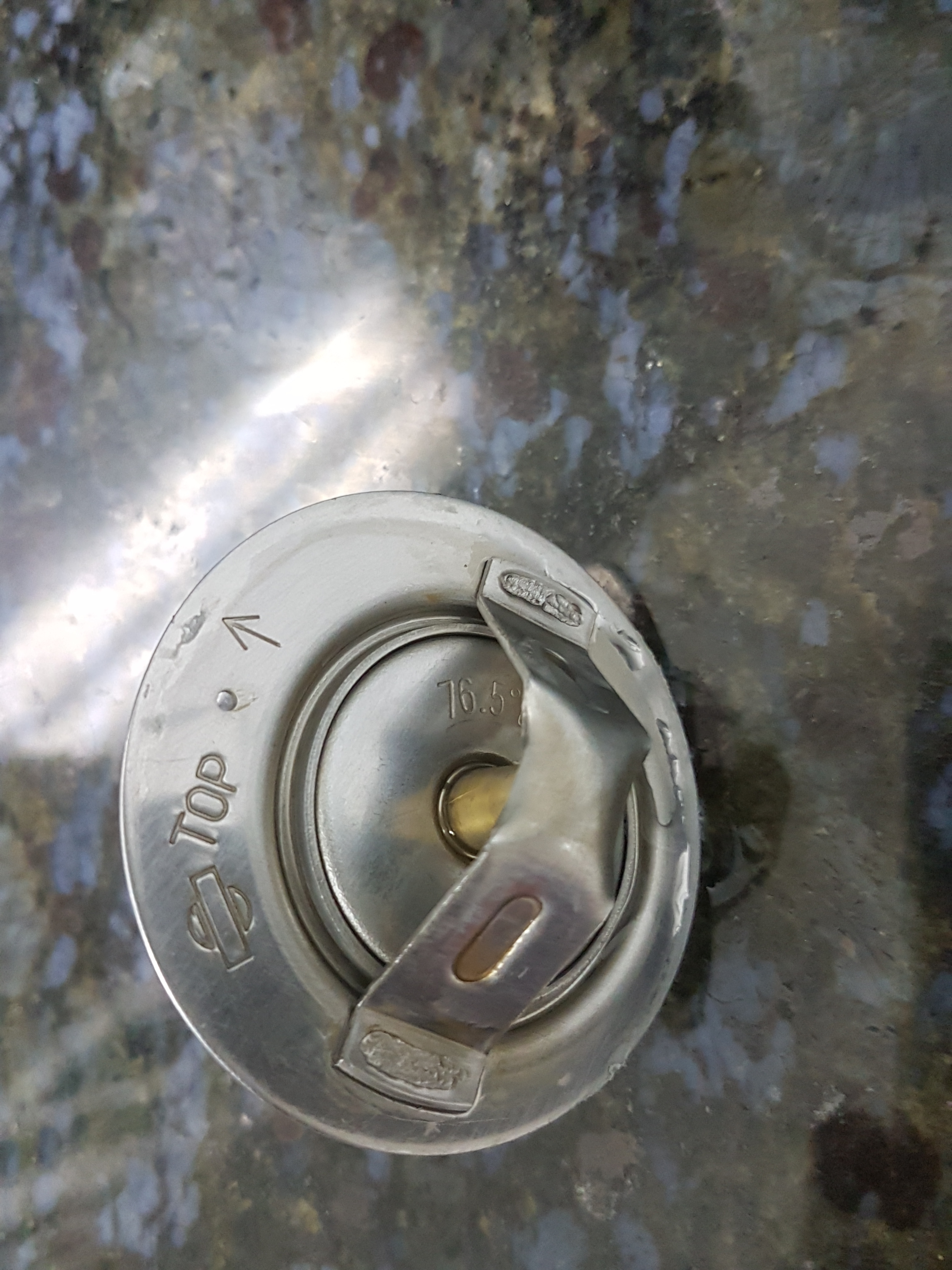

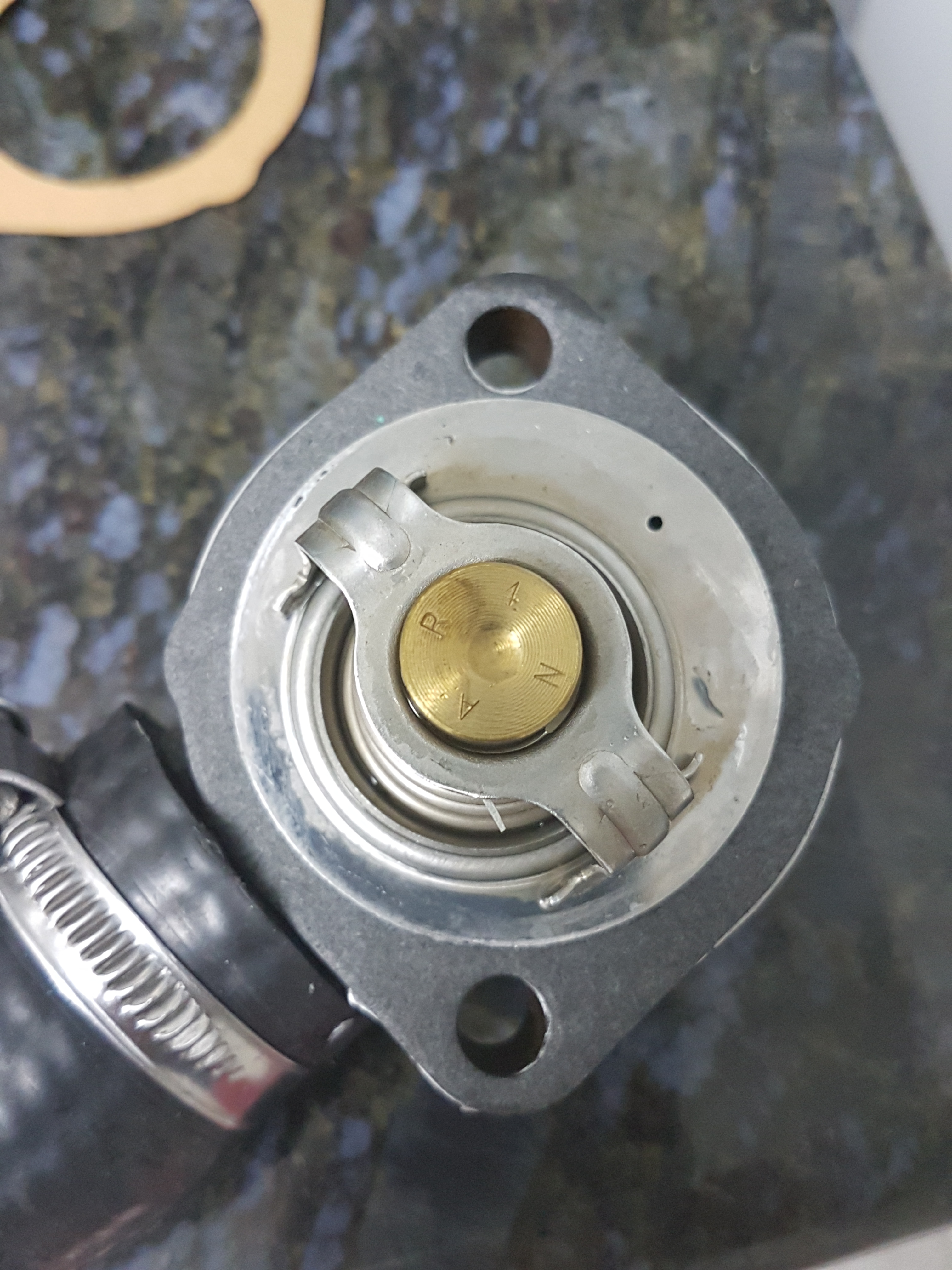

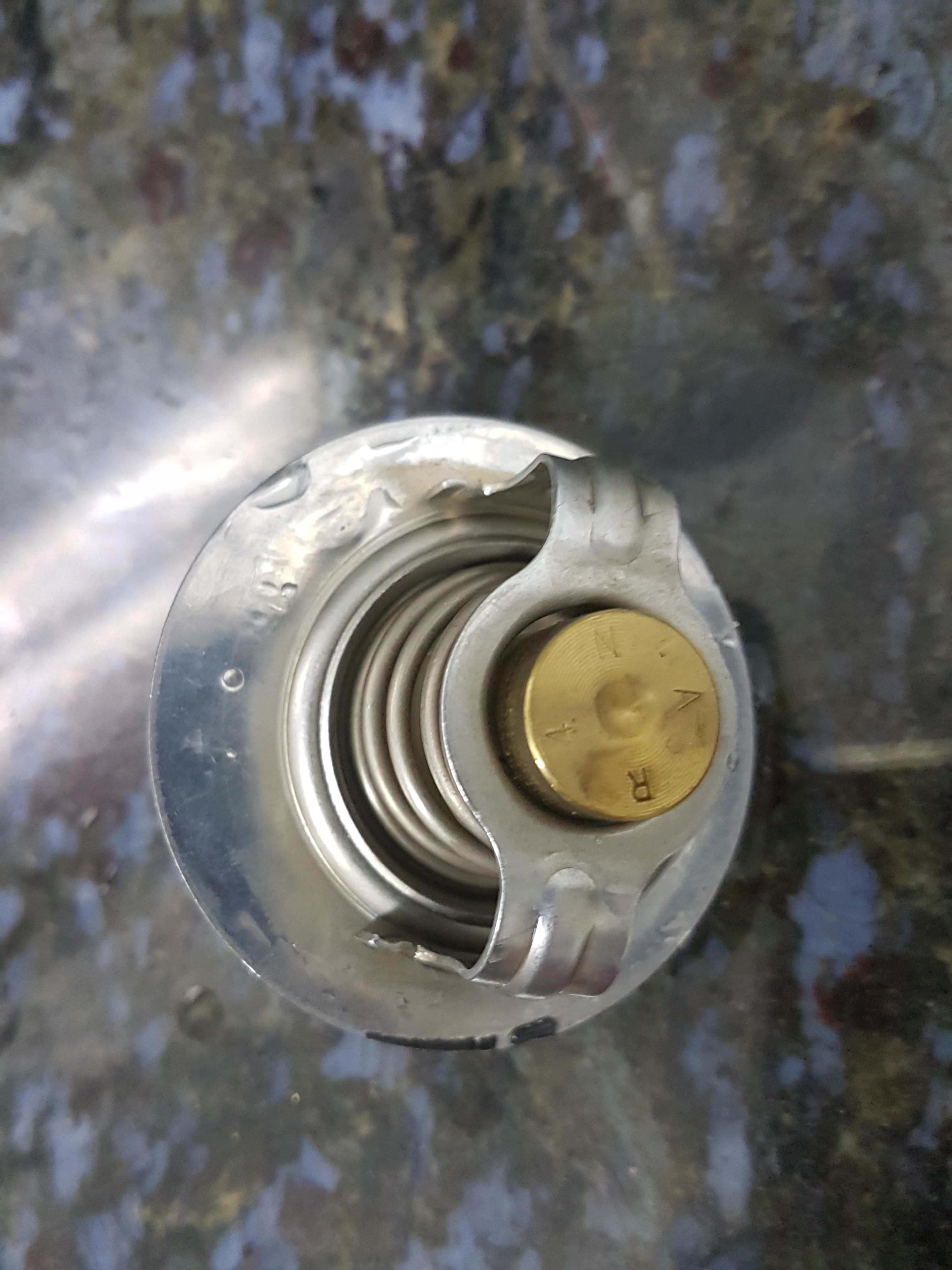

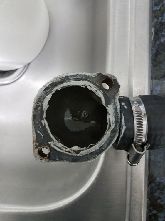

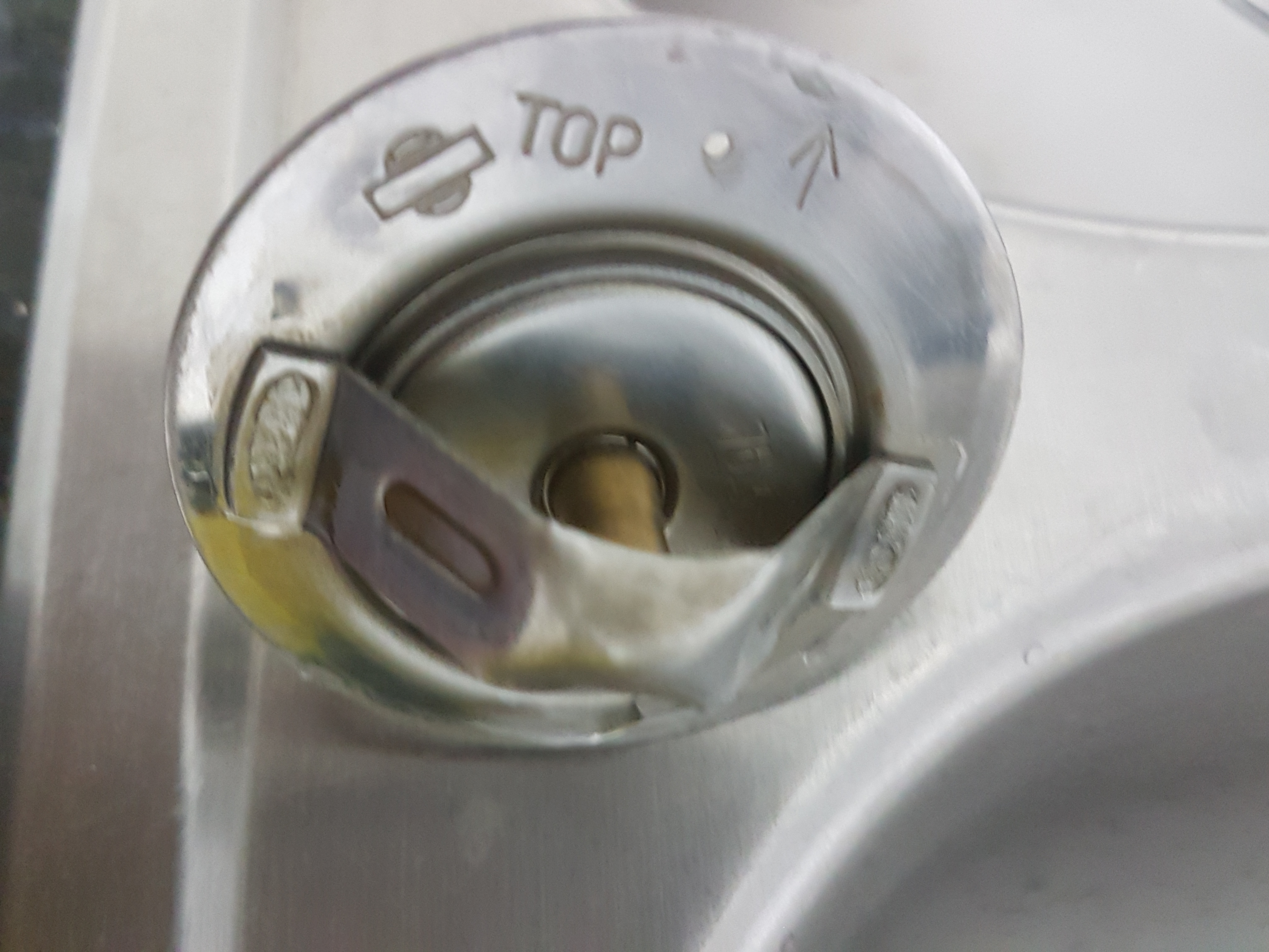

I opened the thermostat housing and discovered i had the 76.5° thermostat installed the gasket was worn and melted and had silicon rtv spreaded around the housing. Is this common?? Should i just remove the all melted gasket with a knife, sand it and place a new gasket as i did before installing the thermostat back in the housing or should i also add high temperature rtv silicone around? I guess i should purchase a 160°C instead of the one i have. At idle the temp gauge reaches until 3/4 when it should keep below 1/2.

have you ever tested the water temp to verify the actual temp (rather than trusting the gauge)?
1st thing is to determine if you have a problem. I presume that is 76.5c which is about 170f, should be fine.
Now check the actual water temp in the rad with a thermometer (like the kind used to check meat temps while cooking would be fine).
1) does the temp match what reads on the gauge? if not fix that part (sending unit, or gauge)
2) check the existing stat to see if it works (see video)
3) if it works and still running hot, maybe the rad is plugged.
Yes if the car is overheating and everything else is ok (stat opens, water pump working, correct amount of coolant, no head gasket leaks, fan working properly, hoses not collasping, then the only thing left is the heat exchange from the water in the radiator to the air flowing thru it. Radiator can become plugged up with rust and other debris ,esp if the coolant is not properly maintained. I suppose its possible the water pump could be so corroded that the impeller is not moving water, but I would guess the bearing would go bad before that.
dumb question: Do you guys replace the gasket that is sold together with the thermostat and seal the housing and cap with High Temperature RTV silicone or you just install the thermostat with the gasket and bolt it? If a permatex high temp silicone is recommended in addition to the OEM gasket, which one is recommended?
Use the gasket that came with it, no need for silicone on the gasket. Just make sure you have clean mating surfaces. I put a little anti seize compound on any nut that is screwed into aluminum. Don't overtighten.
Edited by Dave WM
The RTV may have been used if the metal surfaces of the thermostat housing were corroded and the paper gasket didn't make a good seal.  Check for smooth clean surfaces when you put it all back together.
