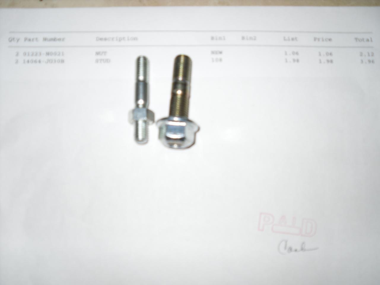

If you find a machine shop they could remove that rear stud for you, likely for not much money.  I had the same problem with mine, I kept drilling with step up sized bits until it broke into pieces.  The heat expands the stud then when it cools down it shrinks a little so if you heat it with mapp gas let it cool down before the Easy out.
I buggered the hole pretty good but fortunately my local Nissan dealership had the next size bigger stud that went in perfect.  After reading I decided to use the bigger stud in the front hole too, under the thermostat.  The header I bought from MSA has those two holes bigger than the rest but I'm not sure about the OE exhaust manifold? but you could always drill it out bigger.  Here's the bigger stud from Nissan next to the original size.
