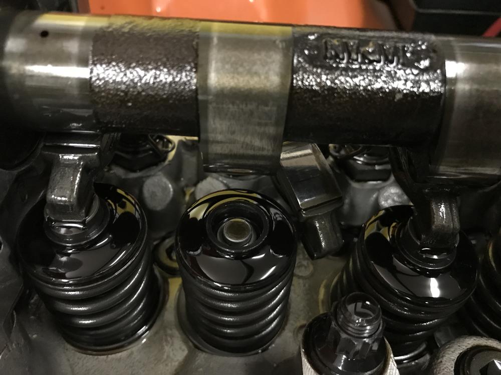

went from bad to worse...tapping turned to #4 cylinder not firing at all.  Got spark and fuel....compression test showed 90 psi on that cylinder.  So, I'm suspecting a stuck or bent valve....going to pull valve cover to inspect when I have a chance here. :(
7 minutes ago, Mark Maras said:
 Any change in the engine performance when it was tapping?
Not at all...still ran/started great.  Plenty of power.
“That theres ur problem”.

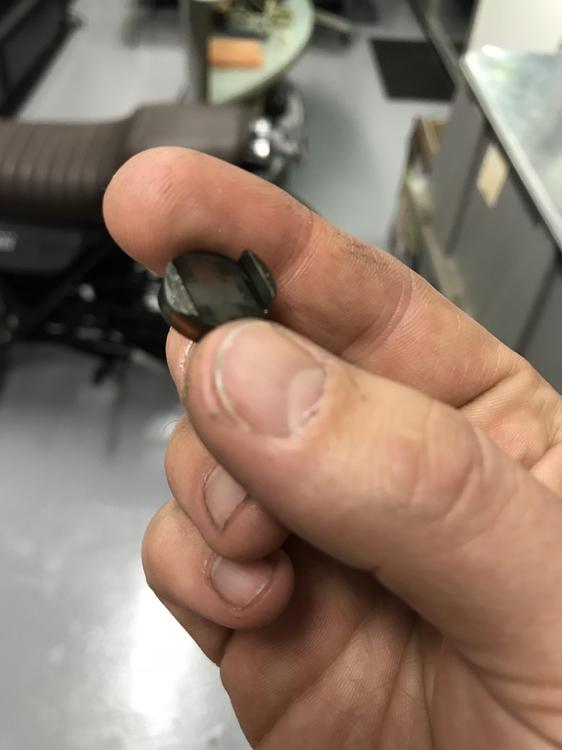

Broken lash pad.  The other small part that broke off it I cannot find so it probably dropped to the pan.  I’ll check the thickness tomorrow and order one. Do I have to remove the camshaft to install a new one?
Good find!  Glad it is not lower end.
Sweep the head with a magnet (including springs) to try and find the broken pieces.
Also put a super magnet on the outside of the oil pan near the drain to try and localize any debris.   Remove the magnet when you drain the oil and hopefully it will be close enough to the drain to get carried out with the flow.
For installing the rocker, you just need to wind down the adjuster all the way.  Fit the rocker end between the cam and lash pad then pop the other end over the adjuster ball. Sometimes a long flat screwdriver helps as a lever to push down valve spring a wee bit.
Be sure to inspect the cam lobe and two rocker faces for wear or damage.

I did run a magnet around the head last night, but no luck finding the small part.
Ordered new lash pad (.170") and got a couple rare earth magnets here at work.  Should be back up and running soon!
