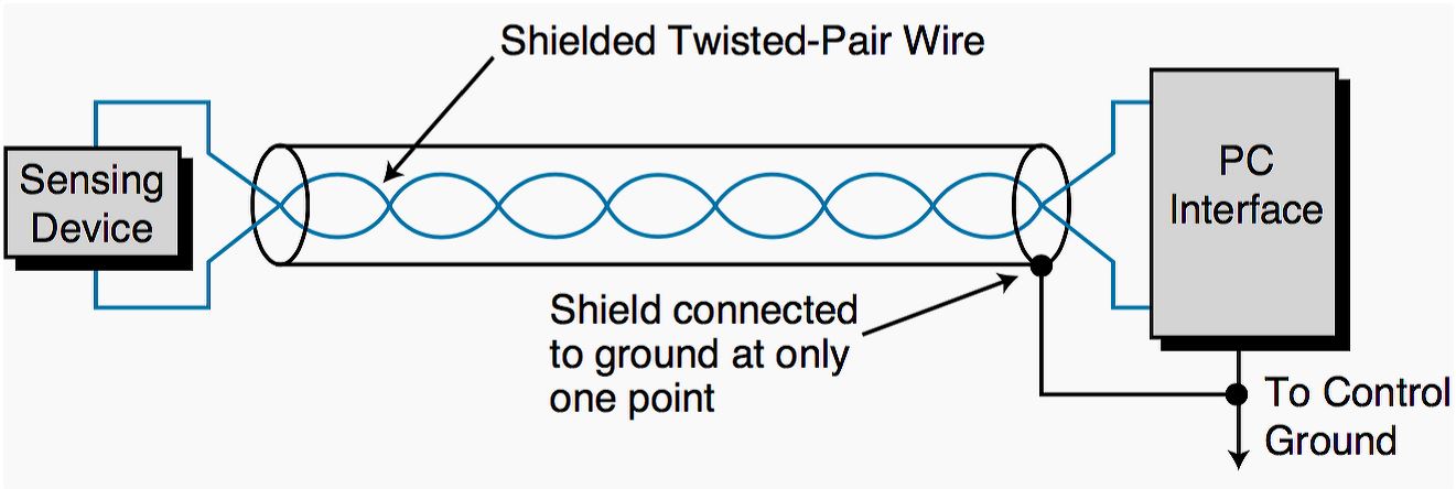

If I recall right, the crank sensor is very sensitive to interference. I believe it needs shielding and needs to be routed away from other EM sources...

Here is a nice diagram of how to shield the wires to a sensor (as per PATCONS recommendation above..  Note there is only one ground point at the PC/Megaquirt/ECU.
I found that wrapping aluminum foil around the wire then covering with tape is a quick and dirty way to shield.
