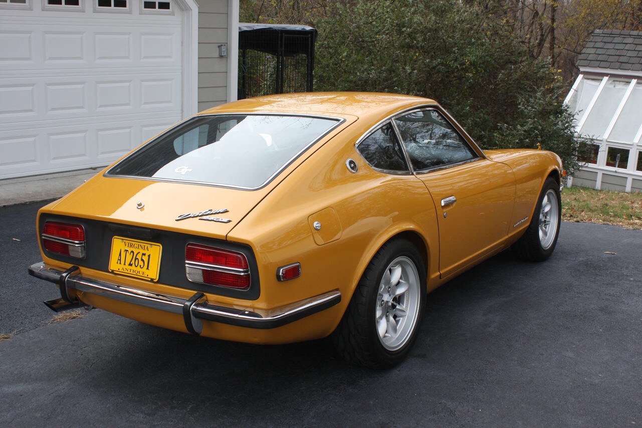

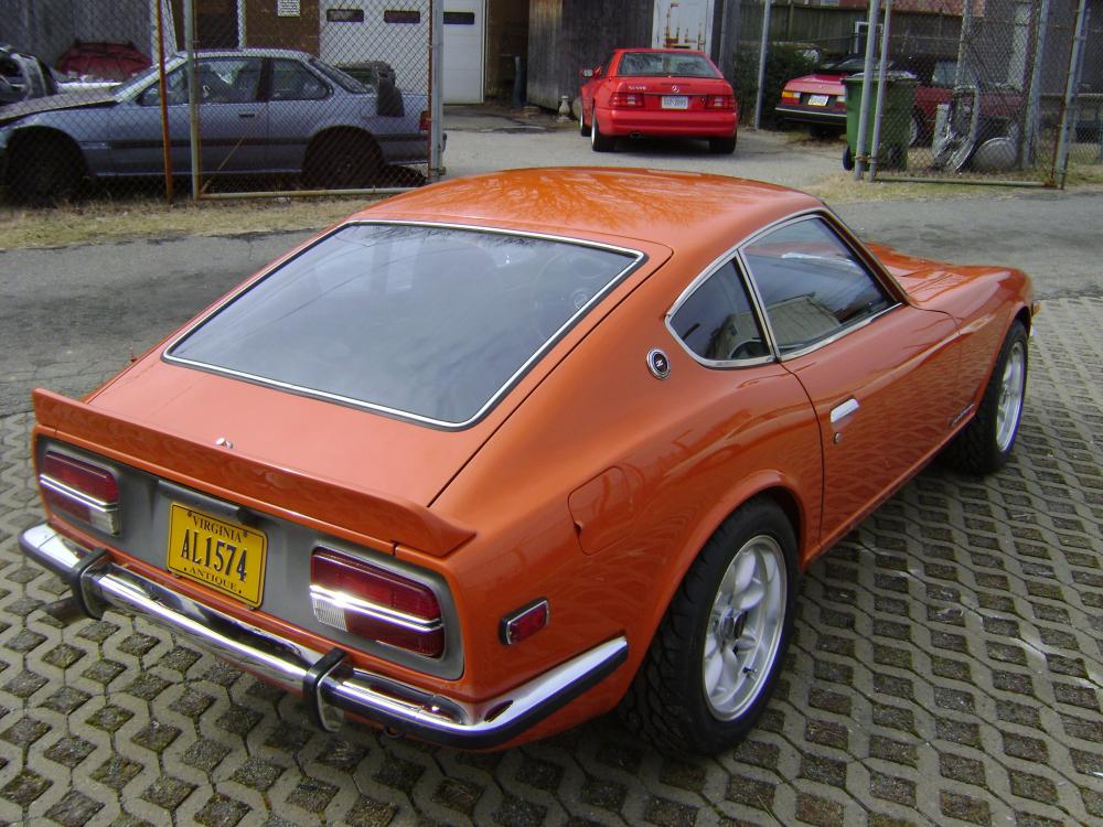

I agree with LeonV.......the 205-55-16's are the perfect size for 16 inch rims if you don't want rub issues. The gold and orange car run 205-55-16 inch tires.....no issues. The green car runs 225-50-16 inch rims.....some adjustment required, but they will fit with some minor mods. IMO, the 16 inch rims are the way to go if you want a decent choice of rubber.
