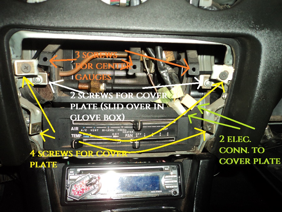

3.  Remove 4 screws on the sides of the HVAC cover plate, disconnect the wire connectors.  I had 2 connectors.

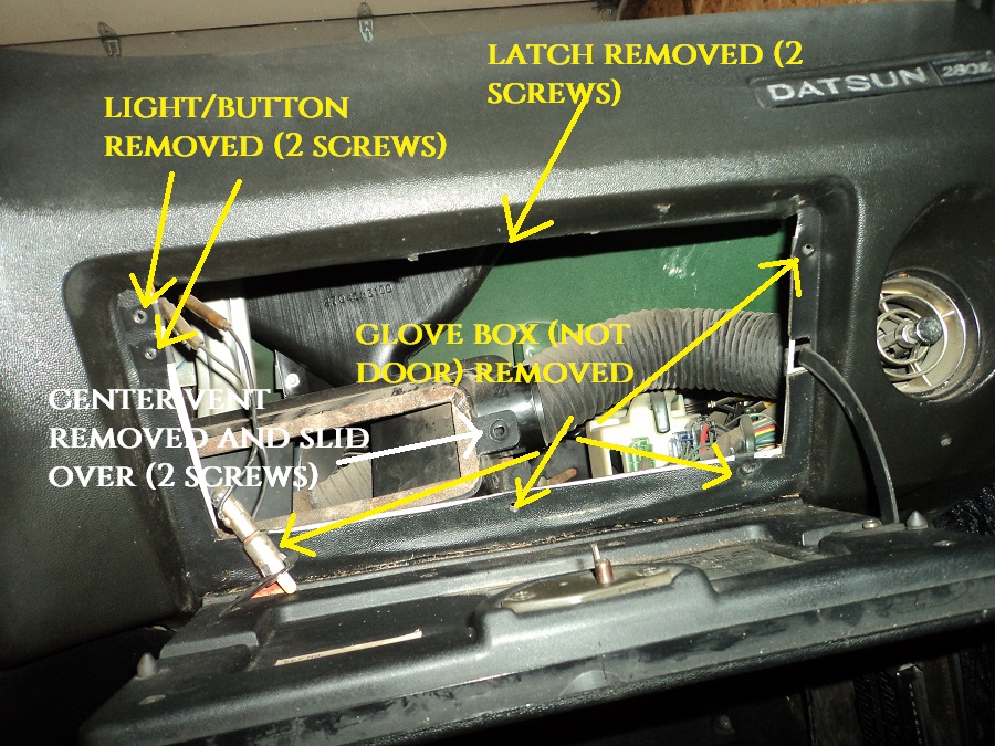

4.  Remove the 2 screws holding the center vent in place, they are also located on the sides.  Remove the ducts from the center vent (If still connected...)  I had 2, one on each side.  (I try to put the screws back where they go for easy recall).
5.  I had to remove the glove box to get the center vent out of the way.  I could not get the center vent out through the middle opening.  I removed the screws for the latch, the the light, and the glove box "holster".  I didn't remove the actual glove box door.  I supported it so it didn't hang down low freely.  i slid the center vent to the side.

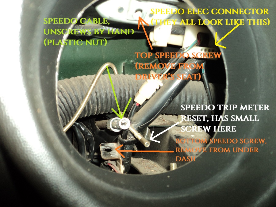

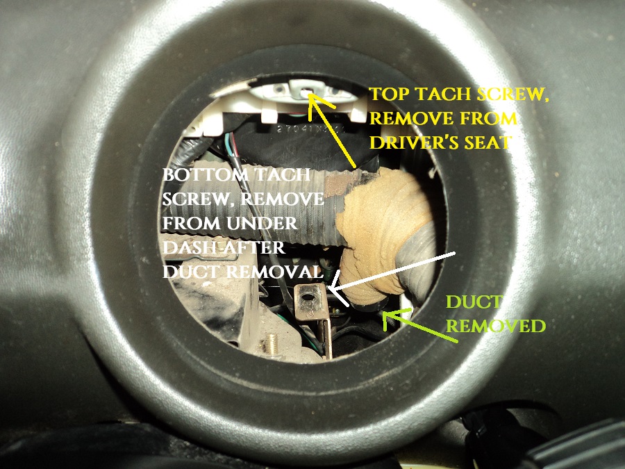

9.  Remove the screw at the top of the speedo and tach, respectively.  You can get these 2 out easily from the driver's seat.

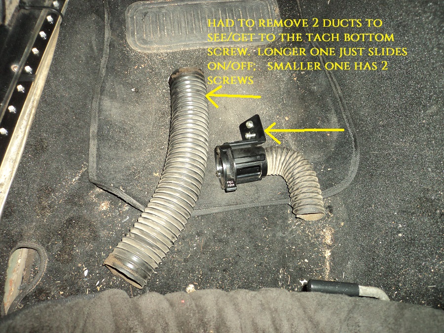

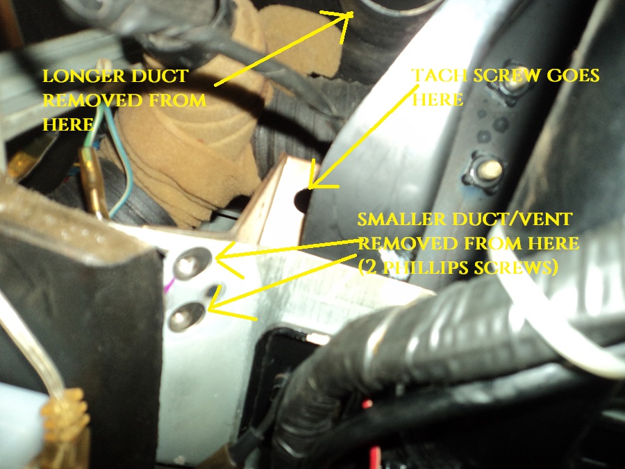

11.  On your back, under the dash, there is one screw holding the speedo on, and one screw holding the tach on.  I had to remove a duct vent to see the tach one. (The one that can be opened/closed and is screwed to a bracket under the dash, didn't know it was there before...)  They bolt to a bracket and are not too hard to get once you see them.

13. Now the speedo.  Without the tach, you can see the tripmeter cable.  It has a very small screw holding it near the back of the gauge.  Try not the strip it, it's on there pretty tightly.  Now unscrew the speedo cable by hand.  Now remove the electrical connector, same as all the other ones.  Push out from the back towards the driver.  (See the photos above)

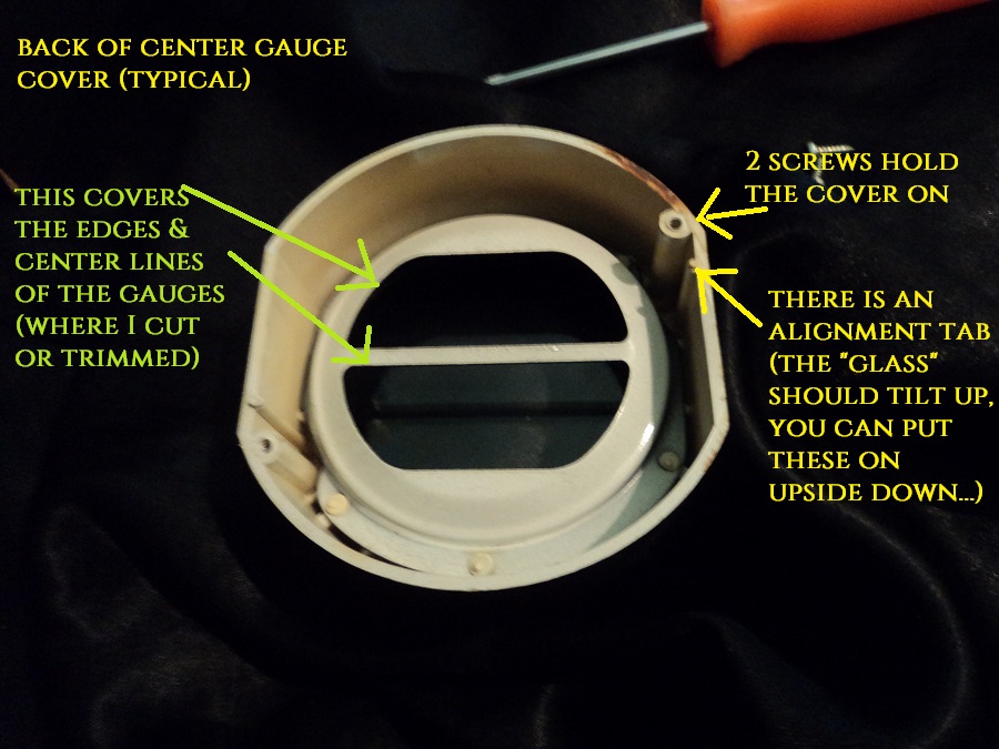

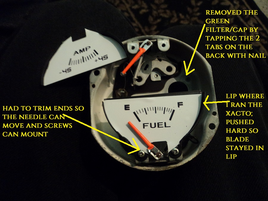

FOR GAUGE FACE INSTALLATION:  There are other write ups for this around that are good.  Basically you have to remove the screws holding the clear cover on.  And the screws holding the faces on (unless you want to try removing the needles, no thanks...)  You have press down hard on these as to not strip them.  Don't ask me how I know....
I highly recommend practicing first.  I had a spare gauge from the junkyard.  And the kit I bought had spare overlays, depending on if you wanted volts or amps.  A new Xacto blade is also a must...The overlays are close, but I ran the blade along the edges/lip of each face to prevent lifting.
I had to cut the overlays in half for the 3 center gauges.  They come as one overlay, but can't be installed as one, due to the needles.  Do your best to get a straight and centered cut.  Remember the gauge face had a divider that will cover the cut.  I used the stock metal gauge face as a template, and a cutting edge.  NEW Xacto blade!!!
NOTE:  I USED A "PRACTICE" SPARE JUNKYARD GAUGE.  THE SPARE WAS AN OIL/TEMP ONE, BUT MY SPARE OVERLAYS WERE FUEL/CHARGE.  THAT IS WHY THERE IS NO RED CHARGE LIGHT.  I JUST WANTED TO PRACTICE.  I MARKED THE GAUGE SO I WOULDN"T USE IT
zz practice gauge back.jpgzz practice gauge front.jpgzz practice gauge front 2.jpg
These overlays are vinyl and good quality.  But you can only re position them once, maybe twice before they aren't that sticky.  I started on the middle, since I had a straight edge cut.  Then pressed down and out, towards the edges.  Then cut the edges by pressing the knife into the "corner" of the stock face.  It has a lip.  These lips are covered when installed, so don't worry about perfection.  Again, a NEW Xacto blade is paramount to get good cuts.  A bad cut will tear the overlay.  Even if they are not EXACTLY positioned perfectly, as long as they work it should be fine.  I don't think the difference between a gas level of 10 vs 10.1 gallons will matter much.  You get the idea...
Don't forget to cut the hold for the charge indicator light also.  I did an "X" from the back, then put the Xacto in there and turned it round and round.  Got a nice round hole.

Remove the green "cap filters" if you want.  They just pop out when you tap the tabs, with a nail or something.  Don't tap out the ones for things like turn signals, brake, etc...These will come out easier if you do this while the faces are out.  I didn't decide to change the bulb color until later, so I will have to remove the speedo and tach faces again to get the green filter cap out.  Unless I can figure something else out.  I REALLY don't want to press my luck and remove the needles again....

Great write up! One detail regarding the center vent. You can remove it from the front avoiding removal of the glove box to push the vent to the side as you did. All you need to do is remove the 4 Phillips head screws that hold the two metal arms (one on each side) onto which the faceplate and center vent screws attach. Once these 2 arms are removed, the center vent comes out by carefully maneuvering it toward you.
That's good info.  I know what you are referring to, those metal arms are what was stopping it from coming out.  On a good note, with the glove box removed, I was able to see that most of my vent ducts had fallen off, or not been connected.  So I can get those hooked up again.
