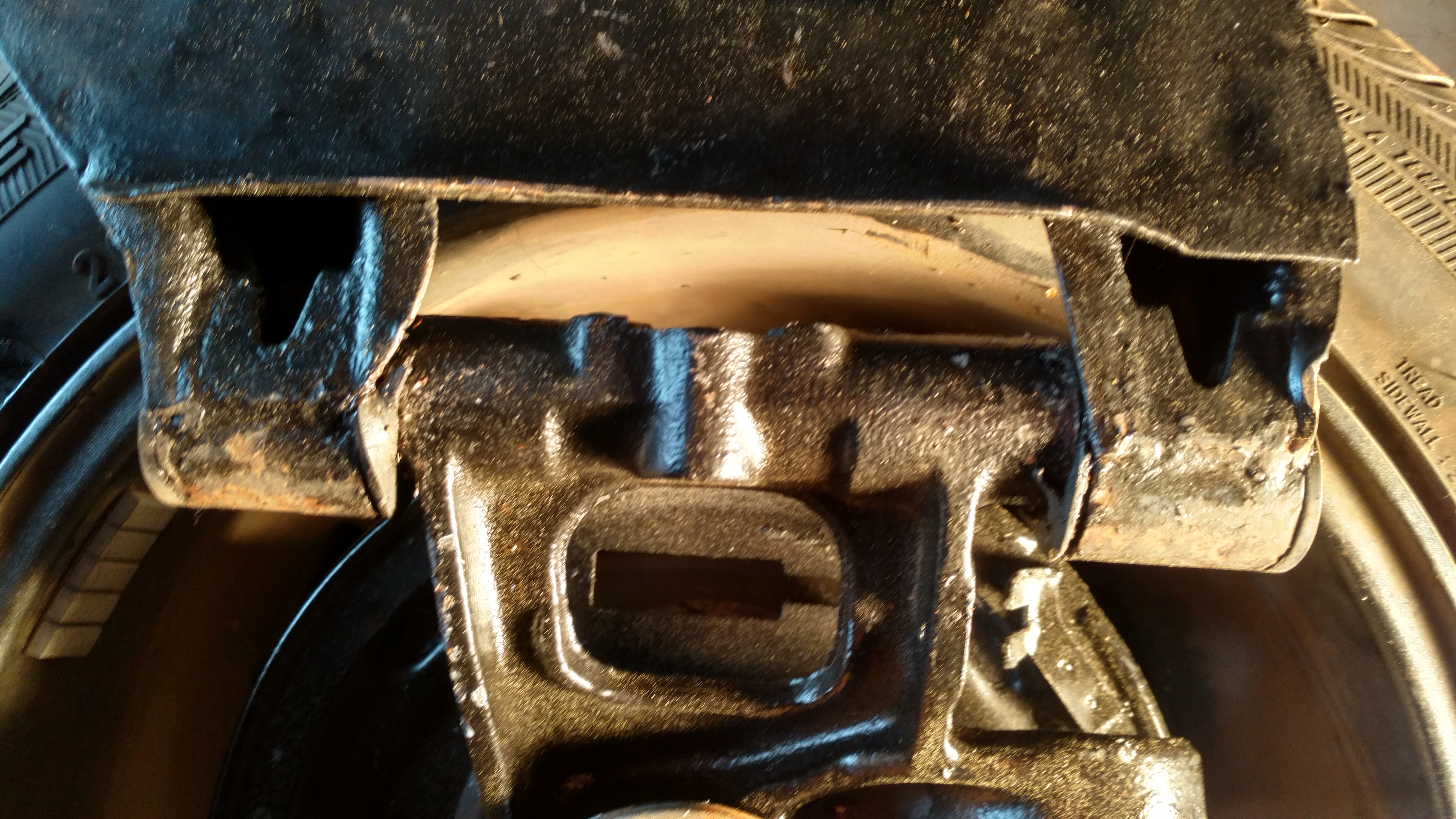

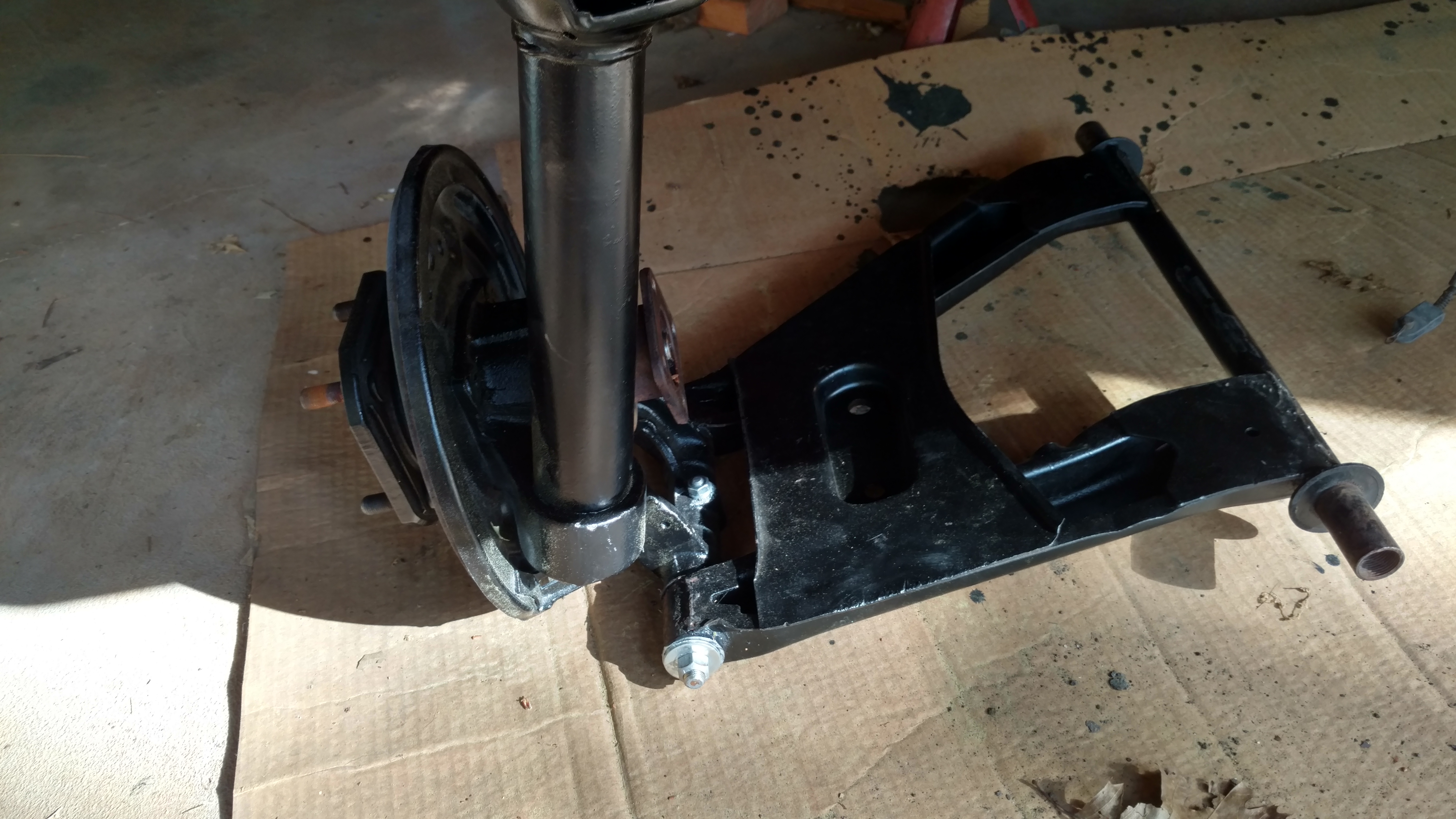

So here's where I'm at. Trimed the bushing and then used the bfh method but it's really torn the inner sleeve bushing to the point that it's ripped. Beginning to wonder about this kit. Any thought?
