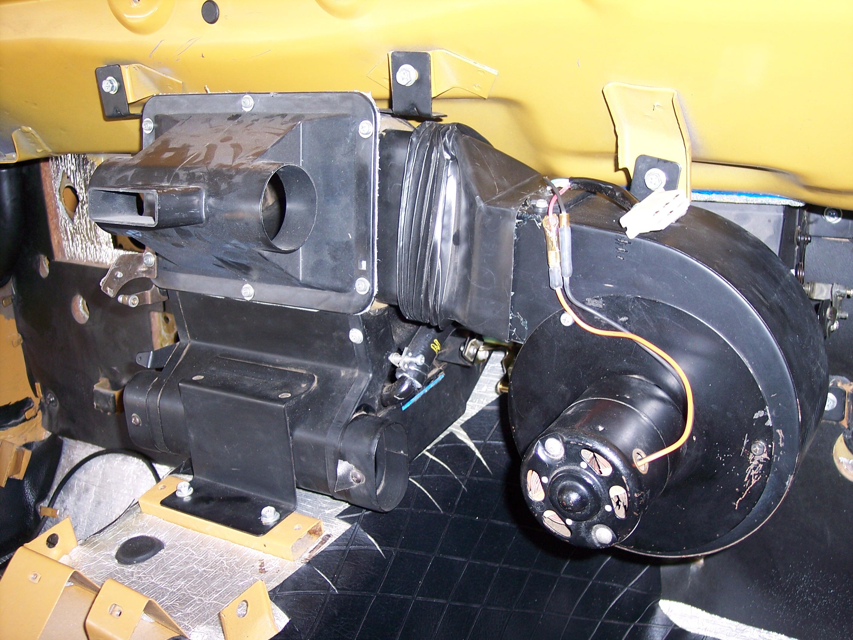

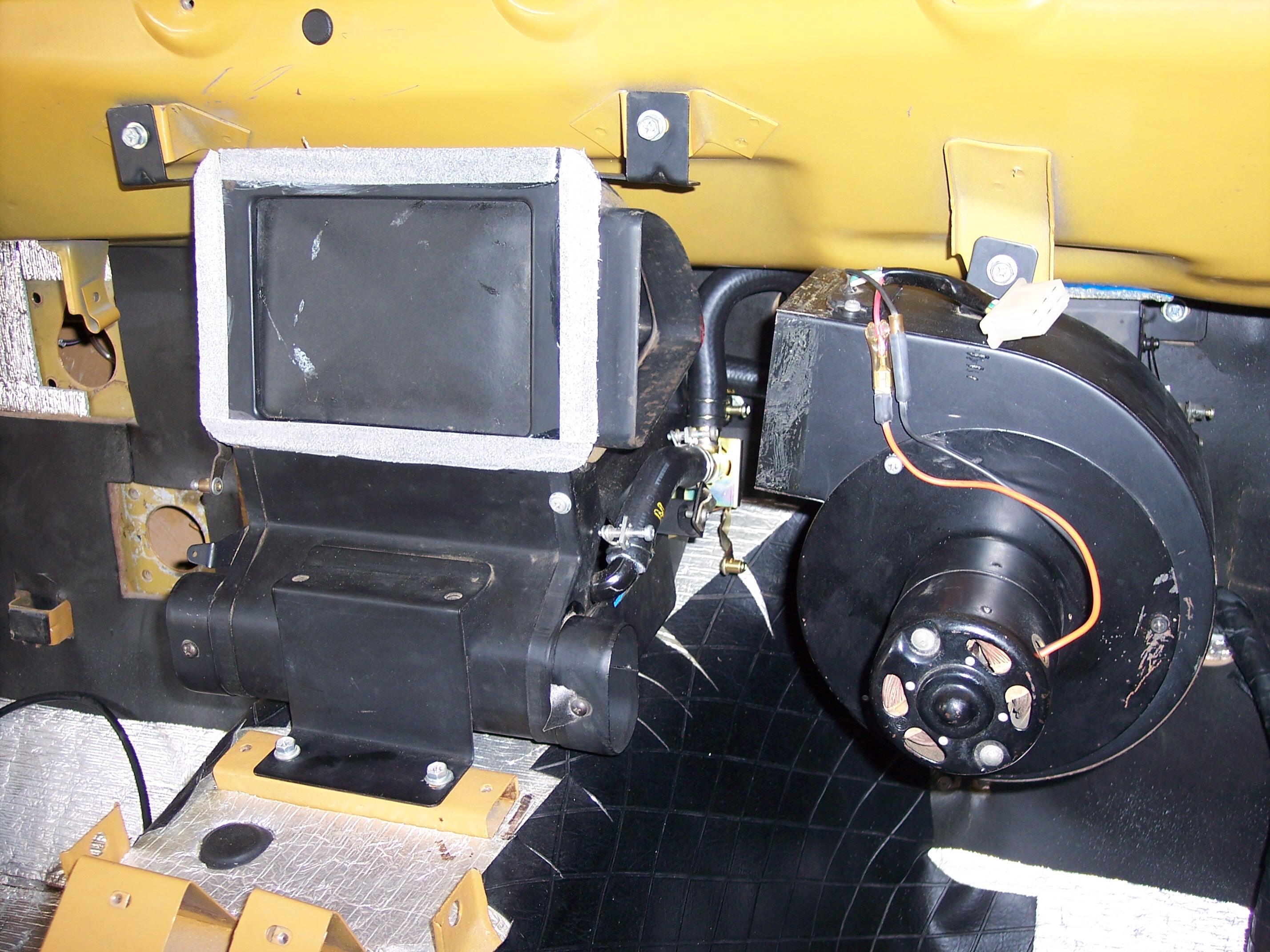

Also I could use some pictures.

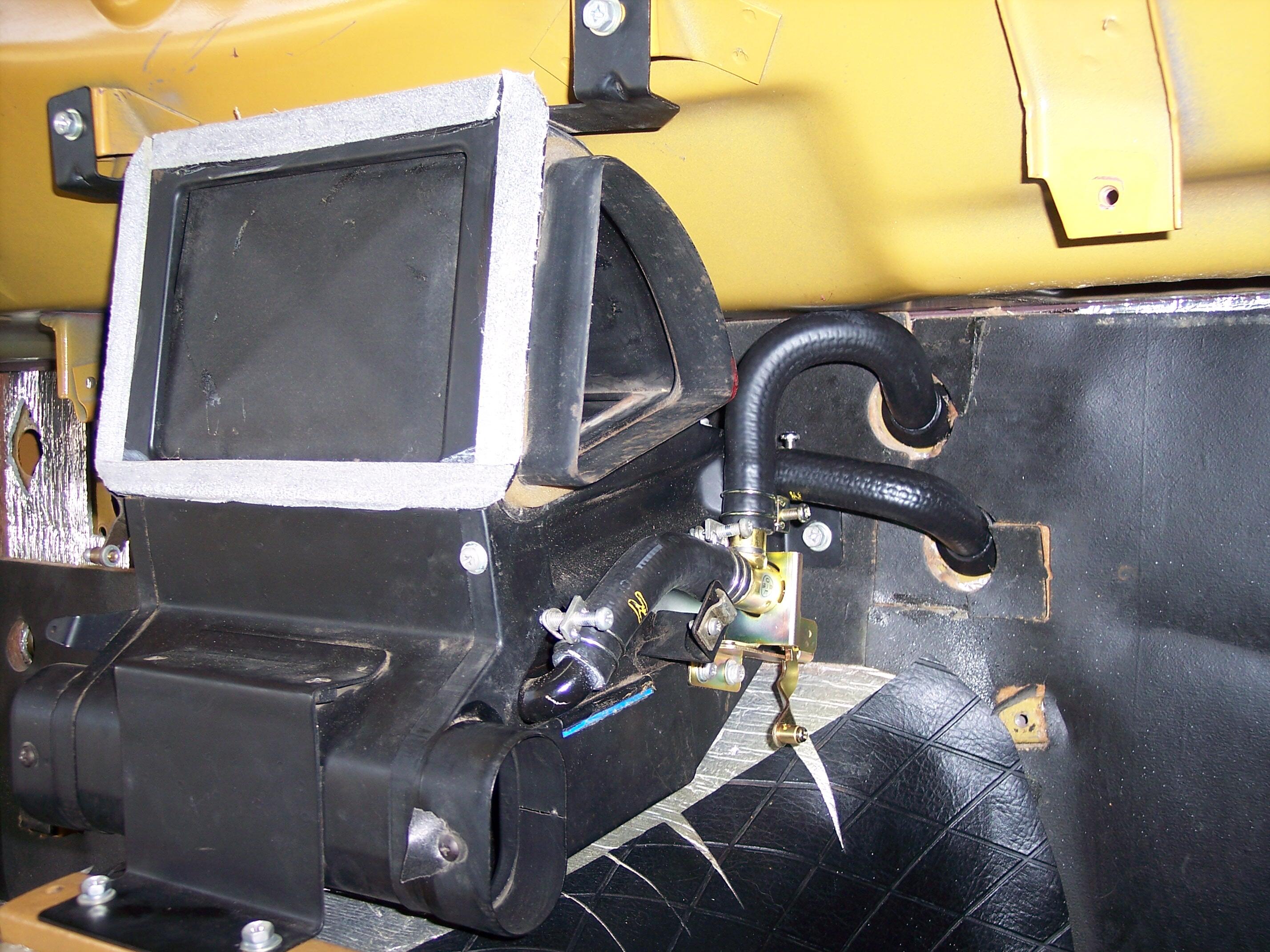

I need some shots of the dash area, preferably without the dash to see how all the heater system mounts up. Factory AC would be a bonus. I don't have any of my original disassembly pictures...
Thanks, C

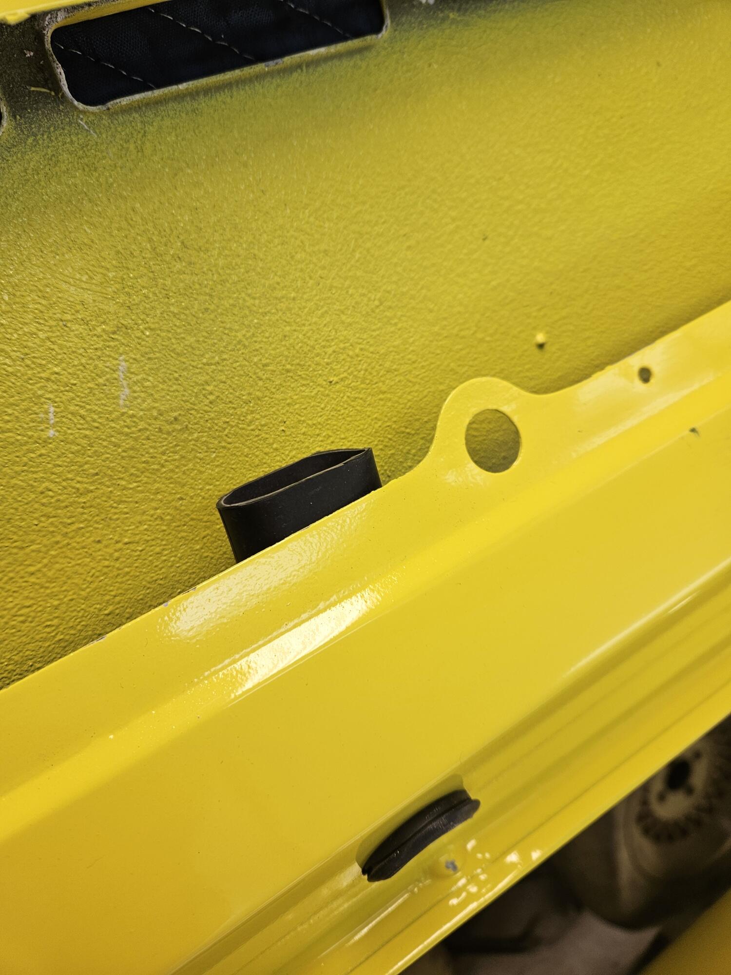

Did some tinkering on the hatch. Put the rubber bumpers and the plugs in the hatch jambs.

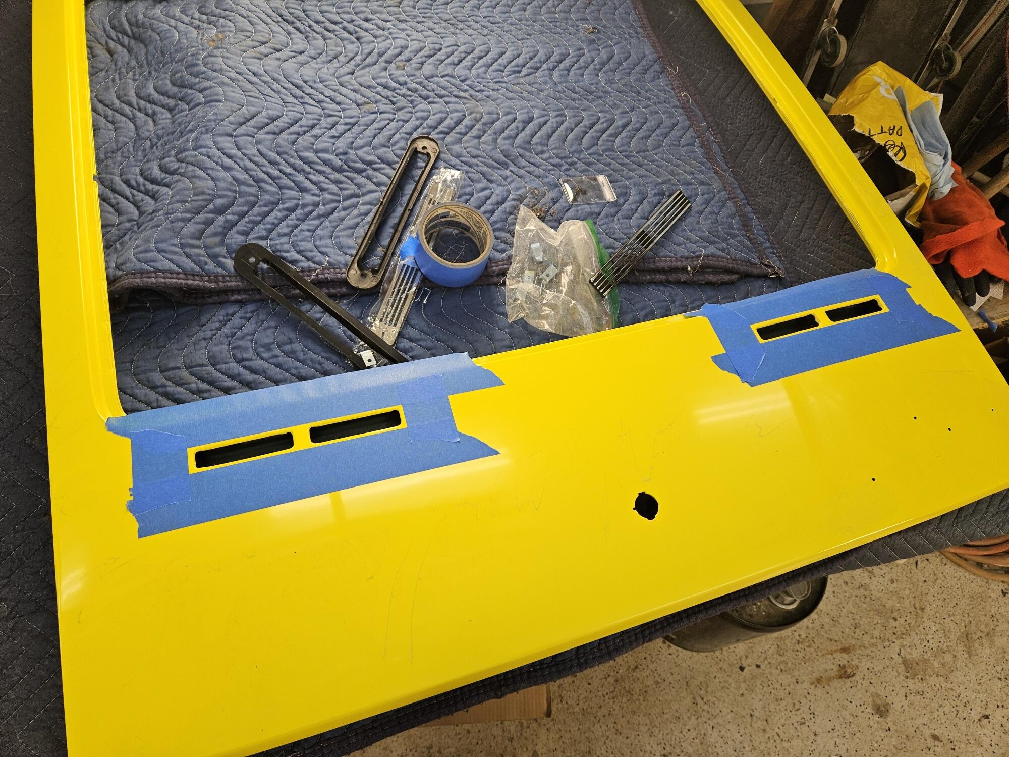

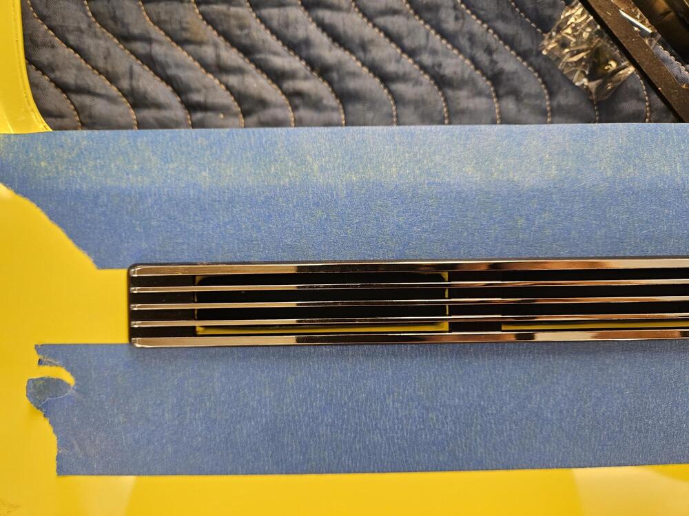

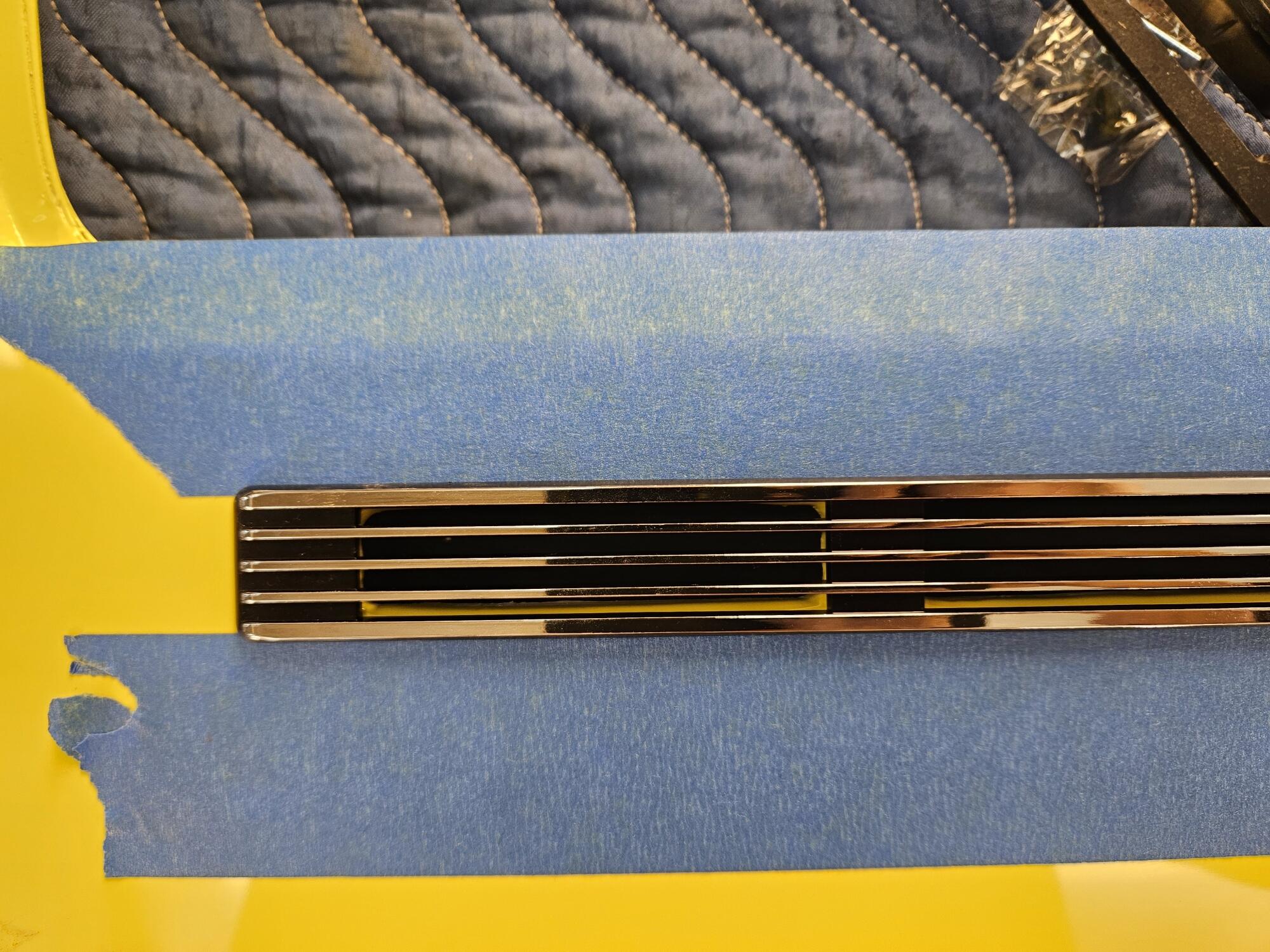

Then I started working on the hatch vents. Put the accordion boots into the hatch. Then test fit the scuppers and the gaskets.

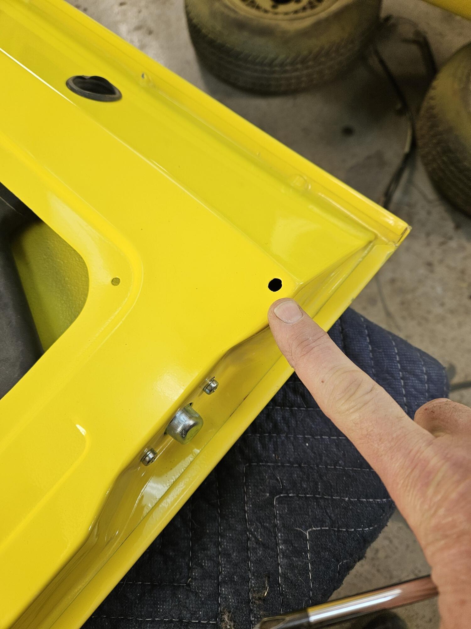

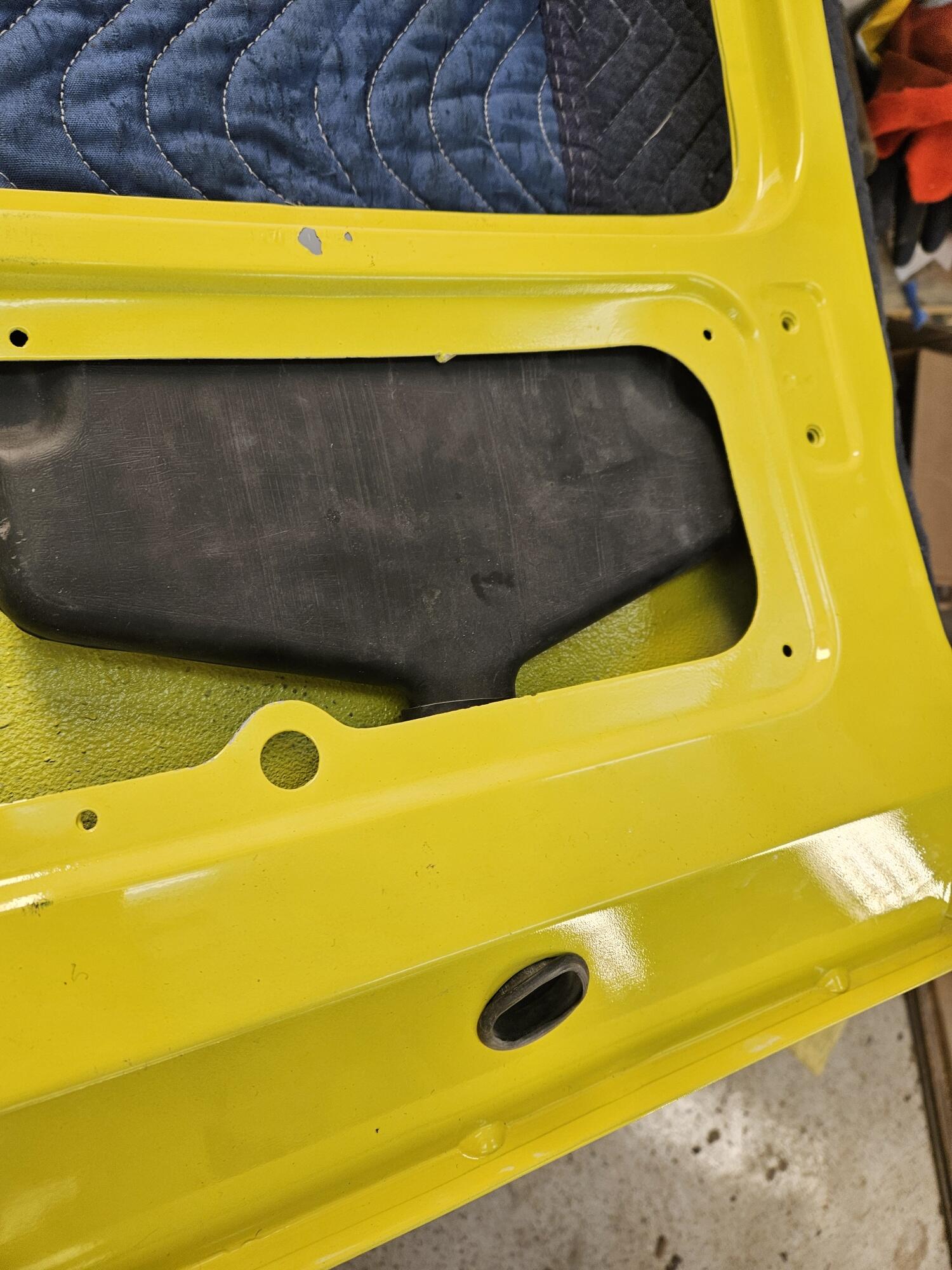

Is there something that goes in this hole in the corner
So with the grills on you can see some yellow inside. So I will black this area out

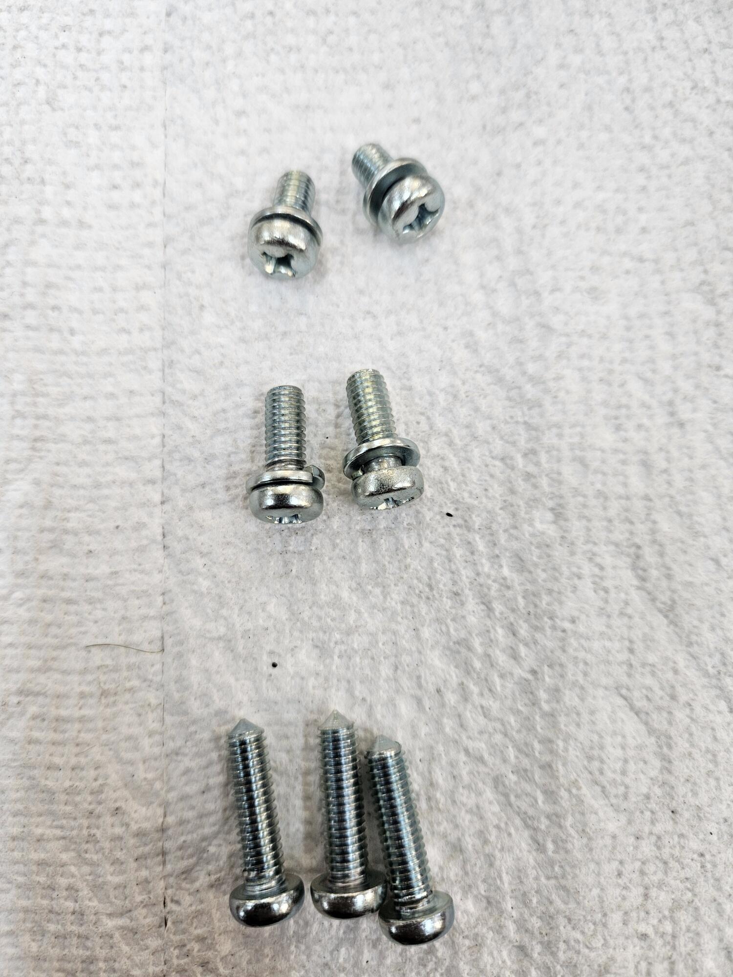

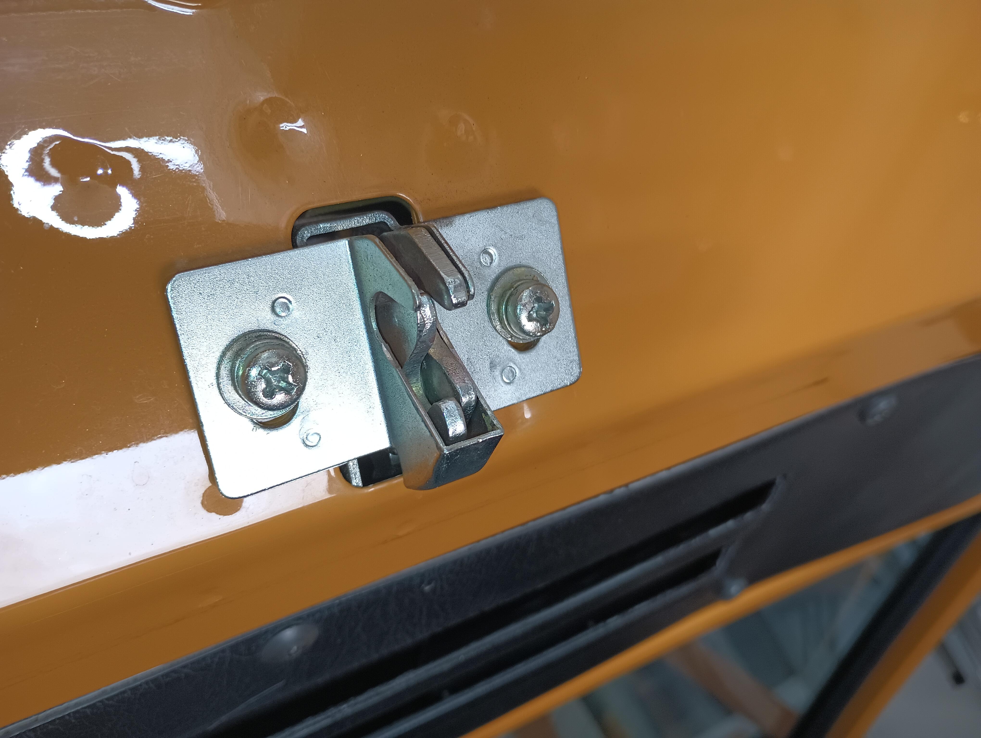

So I have these screws in a bag that say hatch hardware. Any ideas where they go?

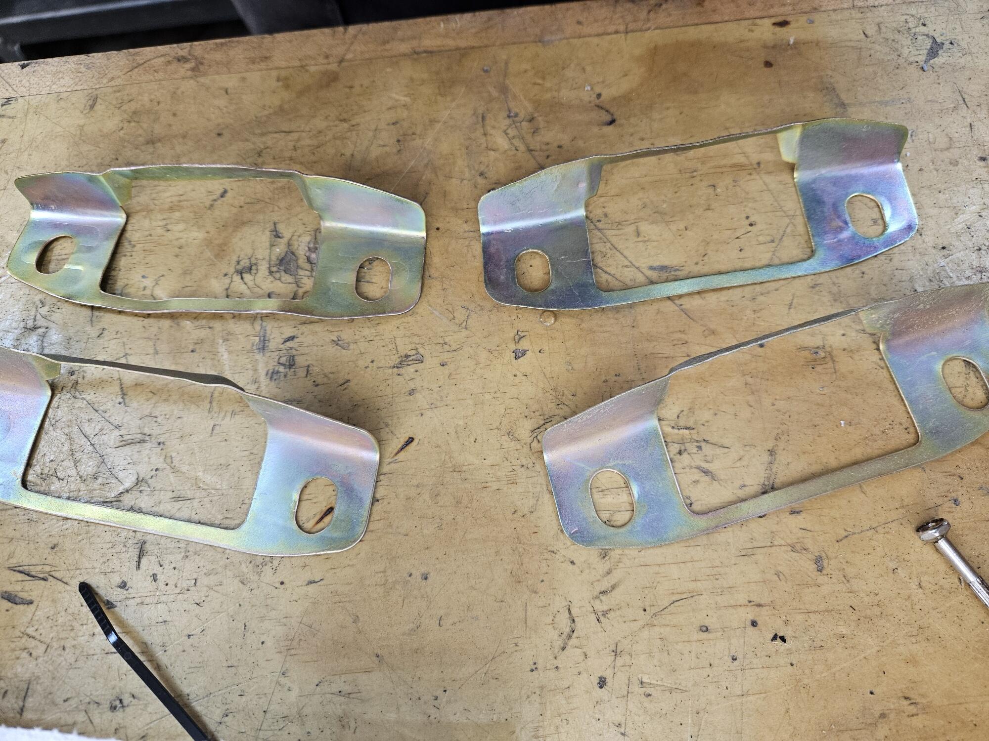

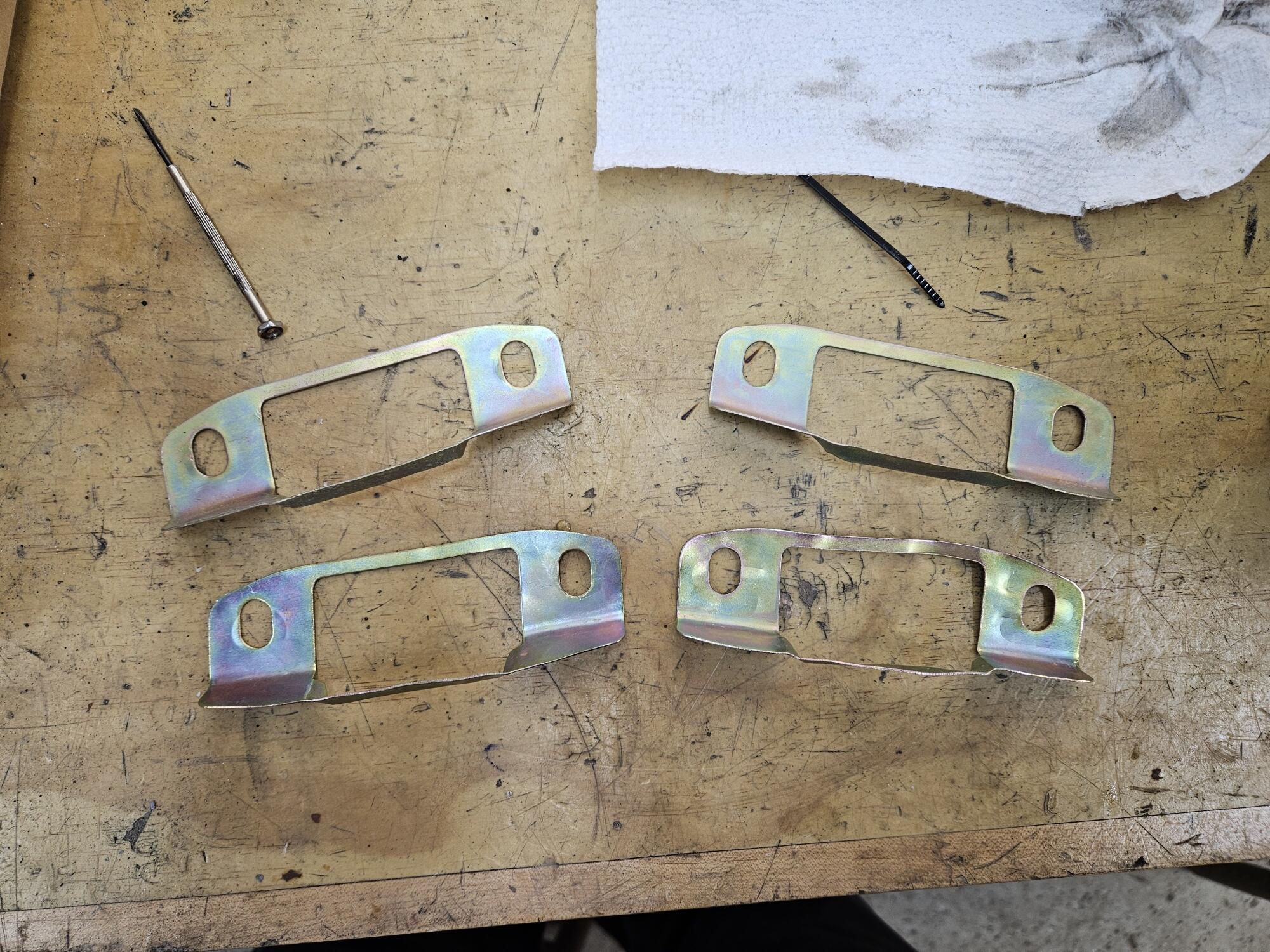

Here are the plates for under the hinge hatches. Any tips on the install for the hinge boots, plates and hinges??

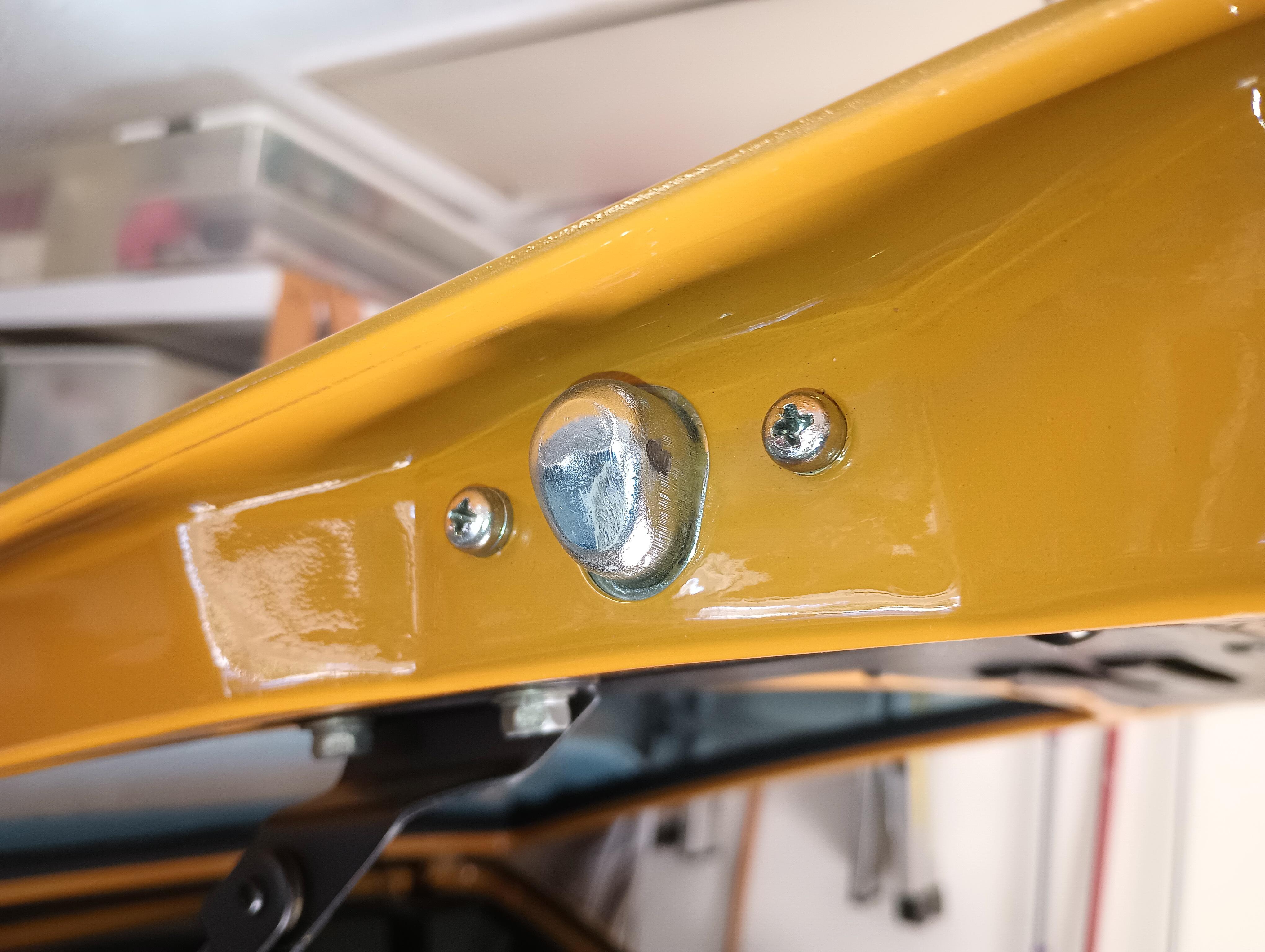

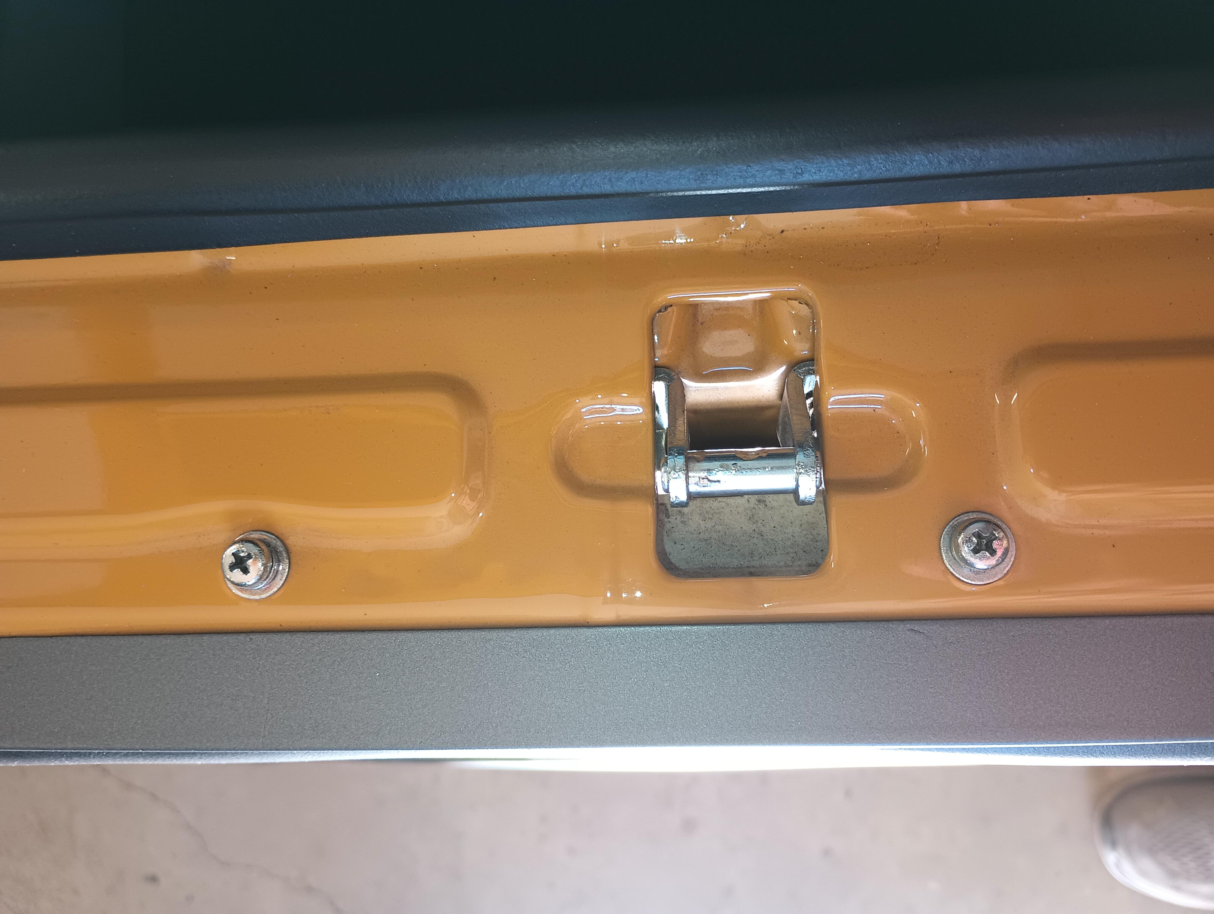

I also don't know what the hatch hinge bolts to body look like...
Also, do the hatch stoppers at the bottom use screws or bolts? Anyone have a picture?
The hole in the inner corner of the hatch is a drain and needs nothing. Picture of hatch hinges may be of help as my car is a total stock restoration.
Also, I have updated my 240z fastener information at this Google sheet.  The hatch hinge hardware is in the body section.  The other related hatch hardware is in the body exterior section.  I need to organize things a bit better in the sheet.
