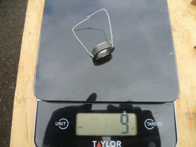

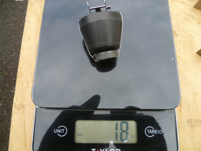

I messed around a little today with additional weight on the float. I wired a chunk of scrap steel to the bottom of one of my new aftermarket floats. The float weighs about 9-10 grams and I added about 9 grams of extra weight. For the test, I just wired it into place so it wouldn't fall off. Looked like this:

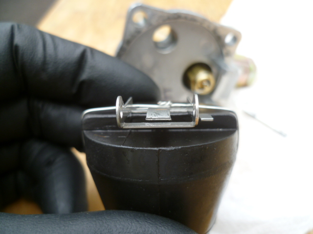

I put that contraption on the 72 short ear lid. Float tab looked like this:
Since this is the rear lid, it's still one mm low, but there's plenty of compliance in the tab bending to bring it up a mm:

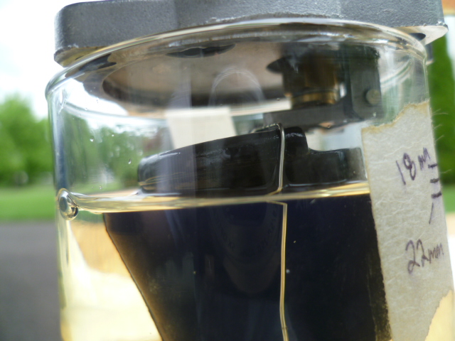

And then I took the same float, with the same tab and put it into the front long ear lid. The result was this:
With a darn near perfect tilt as well:

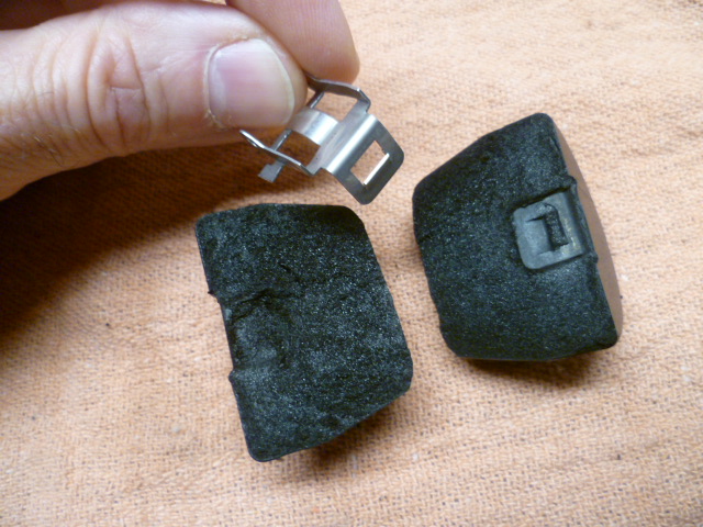

First of all... Anyone ever wonder what's inside the float? How is the mounting tab anchored? Well, it looks like this:

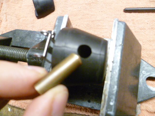

So armed with the knowledge that the mounting tab does not extend very far down into the float... I drilled hole in the float:
And made a brass slug to press into the hole:

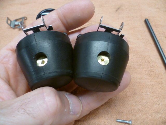

Rinsed and repeated for the other float and now I have these:

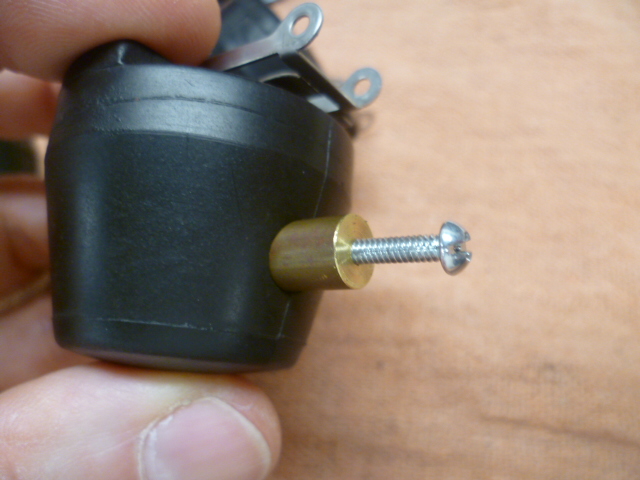

In case anyone wonders... The little threaded hole is so I can run a small screw into the brass ballast slug as a removal handle. I figure that until I'm sure about the amount of weight, I might want to pull it back out. And since the hole is blind (I didn't drill all the way through), there's no way to grab it. Works like this:

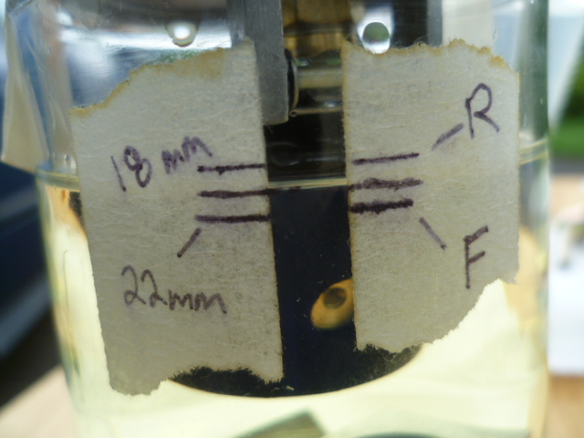

Here's the results in the front carb (long ear). Level is a little high, but that's easily fixable with a little tab bending:
Long ear float tilt looks like this:

Your willingness to destroy an old float 'to see what's inside' has led to an important discovery:  they're not hollow.  If someone ever proves that the specific density of modern fuel has changed relative to that of 1970's-era fuel, then this process of ballasting the floats might become a standard part of rebuilding Hitachi-SU's.  I'd be curious to know what Z Therapy have to say about this, though.  One assumes that they've successfully set the floats on hundreds of H-SU's by now and I don't think I recall any discussion on their part of special tricks being used to cope with modern gas.
