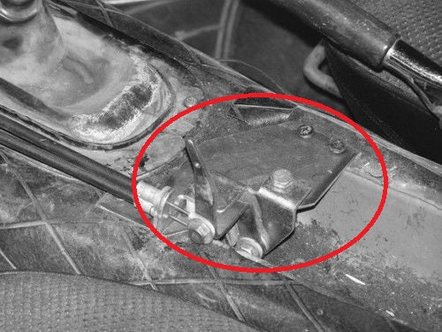

That stiff choke could be the hoses on the nozzles. From what I've learned the choke is actually just dropping the nozzles, no closing of the butterflies like most chokes. I bought one a few years ago somebody had put stiff fuel line from float chambers to the nozzles. It was so hard to pull the lever back I broke where the pull handle connects under the console. Lucky for me they make a better bracket that mounts to the sheet metal tunel.

Choke Lever Mounting Plate Reinforcement 240Z
Choke Lever Mounting Plate Reinforcement 240Z - 800-733 (). Choke and console reinforcement plate for use on Datsun 240Z 1972 to 1973 that use the series 2 console where the choke lever was shifted to
