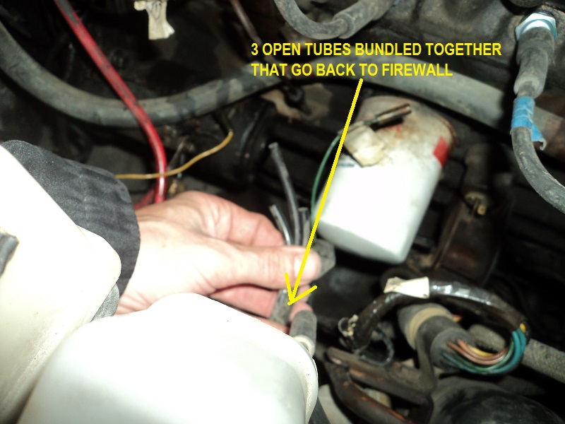

I have 3 vacuum lines bundled together coming from the firewall, passenger side (asssuming HVAC).  Do these go to the vacuum tank can (white bottle)?  Anyone have good pictures of their engine bays?

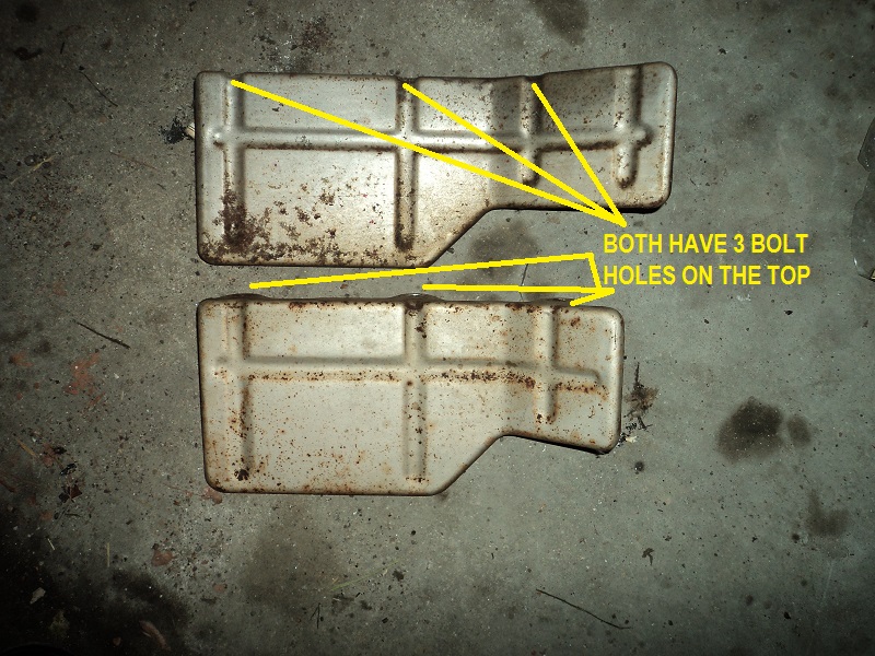

    My 76 has what looks like two broken plastic mounts by the brake and clutch MC, as site suggested.  Might go there if you're talking about your 76.  If they came with the 78/79 motor, they might bolt on to the bottom shield, like the small one on the 76 bottom horizontal shield.  There are drawings in the Engine Mechanical chapter, disassembly section.  Looks like a vertical shield, not horizontal.
    Those hoses would go to the "magnet valves" (solenoids) for the AC.heating system.  The vacuum bottle supplies the valves, which then control the system.  IF the hoses still have their little tags on them, with letters, leave them on.  They tell you what's what.  In the 1976 AC chapter.

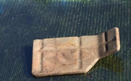

    The small heat shield in the picture looks like the one that sits between the exhaust manifold & the pcv hose to protect it.  Mounts vertical under the main intake heat shield.  It is reversed in your picture, goes on the other way when viewed from the driver side.  The one for the brake MC area is larger and more square.  You can see a good picture of it in Rossiz's recent injector parts for sale thread.

    The vacuum hoses aren't labeled, just 3 bundled together from the firewall.  And there are 3 coming from the vacuum can/tank.  So as long as they are just HVAC related, it will be ok for now.

    The actual pieces are just like this image, but one is the reverse of this one, not exact, but same general shape.  (there are two total).  I'll look again and see if they will work by the PCV or brake area.

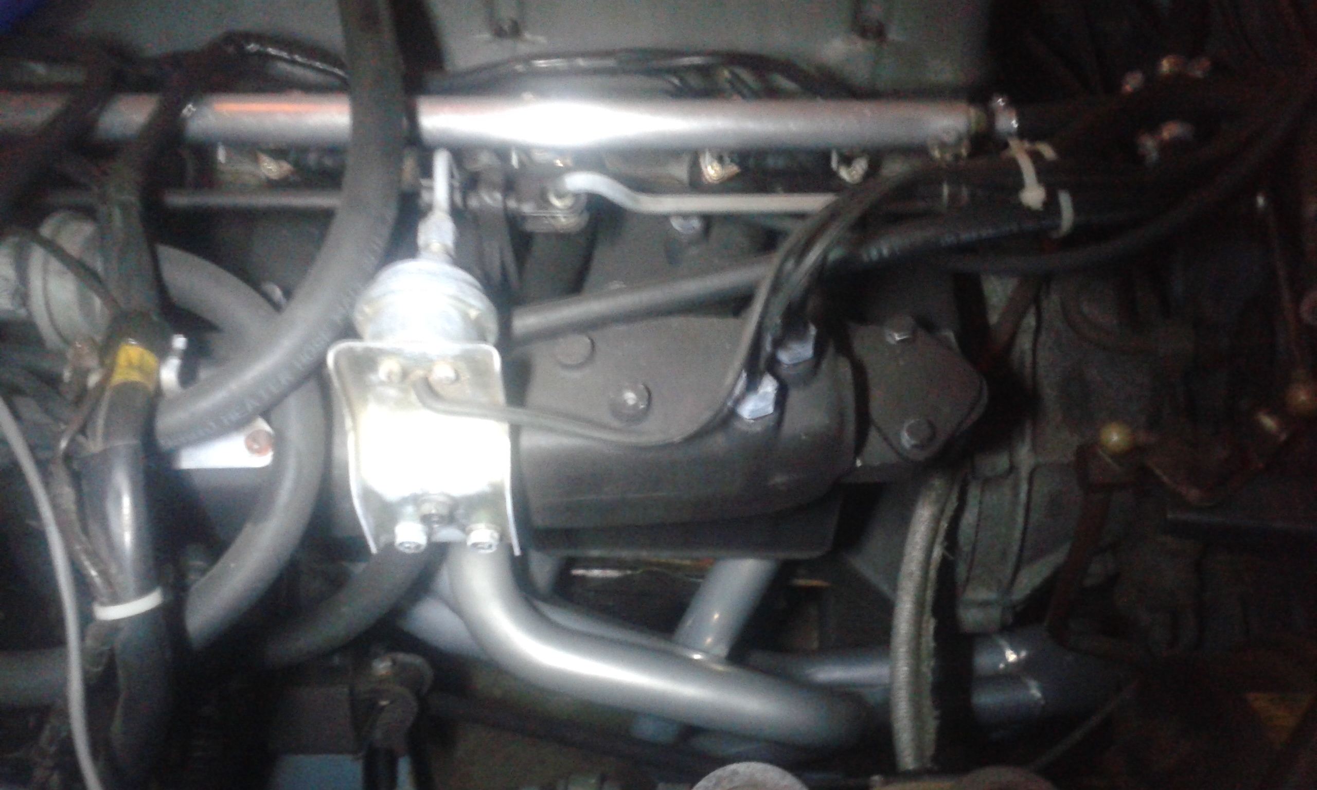

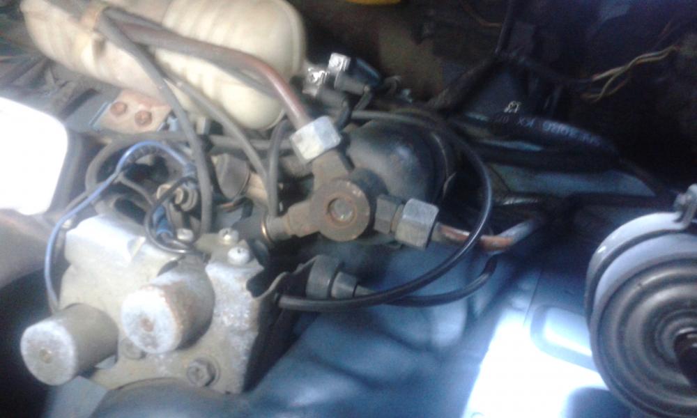

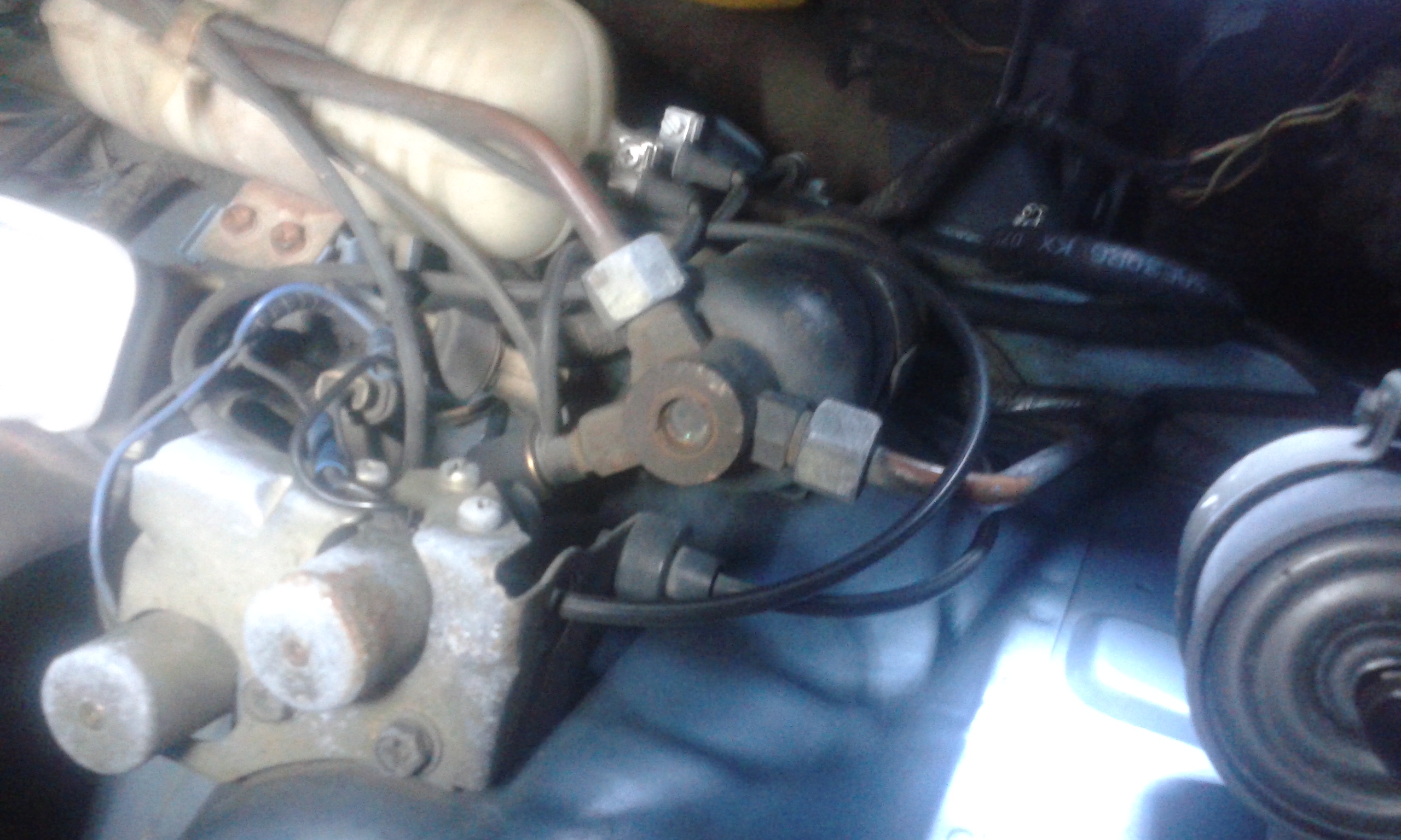

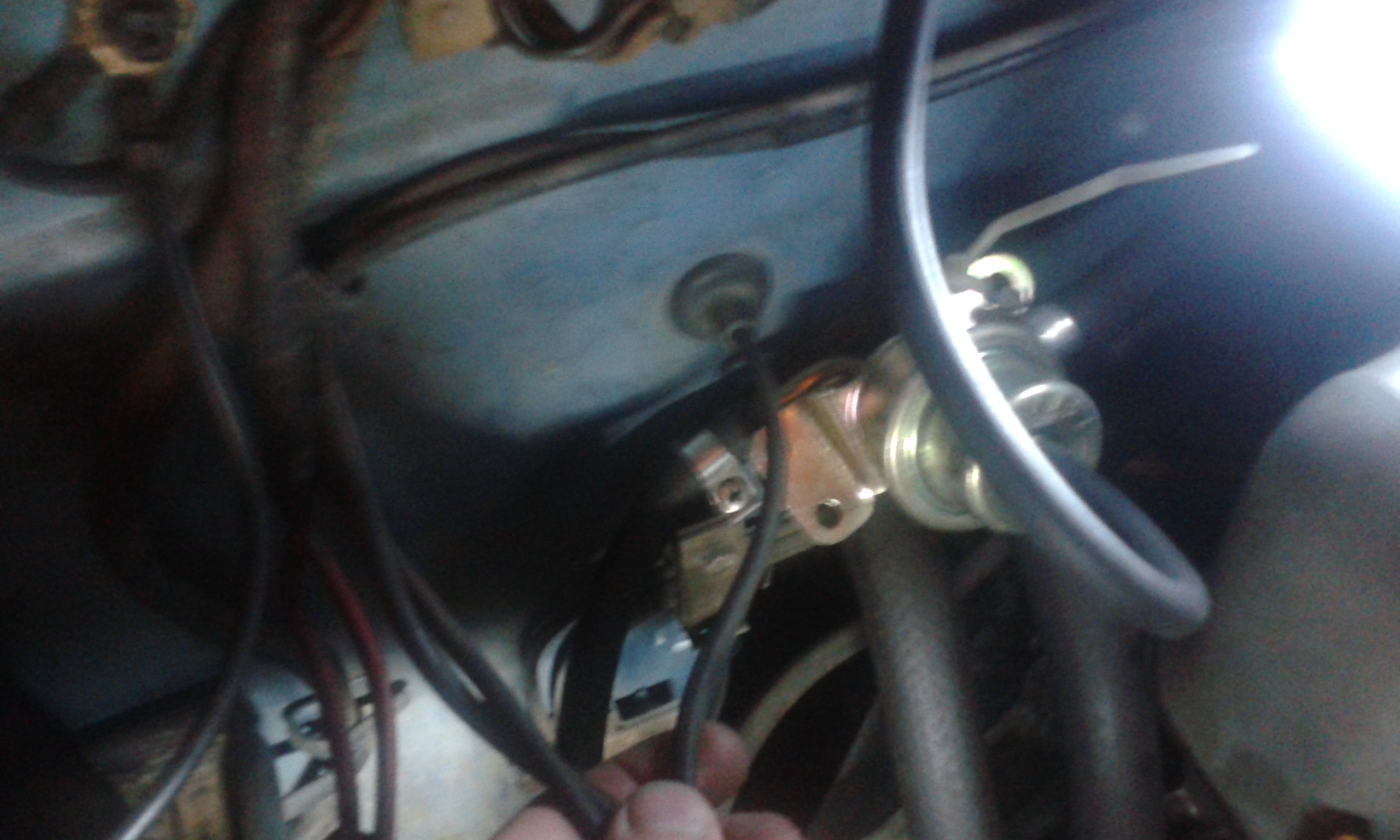

    I can tell you more later when im sitting down and using my laptop. But here's some pics showing small vac lines going to the white bottle. 2 pull vacuum off the intake and one goes through my firewall.
    Looking back, one pulls vacuum off the intake, the other goes to the fast idle actuator for the A/C.  The one through the firewall I suppose helps open and close the flaps inside the cabin???
    If I'm on the wrong hoses put a picture of your's up.  We'll figure it out. :)

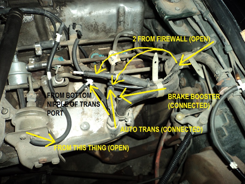

    Great info siteunseen.... I had thought to just take the 3 from the vacuum tank to the 3 bundled going to the firewall...

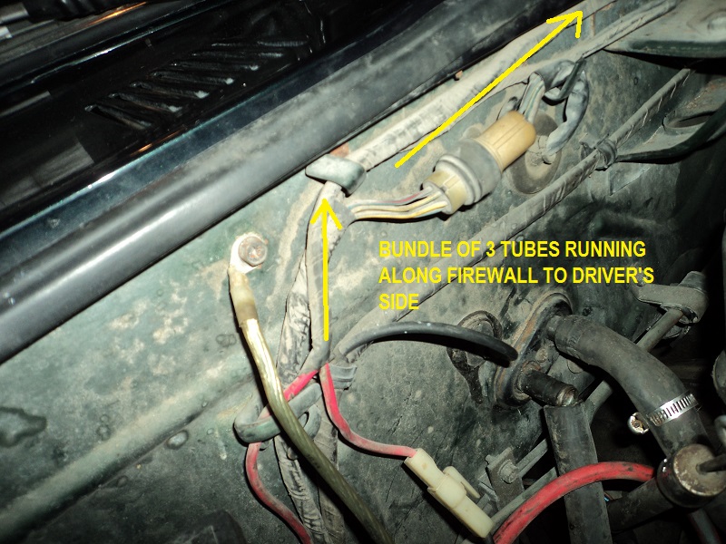

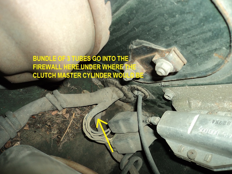

    However, your comment made me realize that would do no good:  The vacuum tank needs a source of vacuum to store it!   Some pics from now:  (stock '76 Z automatic trans.  Using the stock '76 intake manifold on the '78 or '79 N47 head)
    Showing situation by the vacuum can (passenger side)
    And here is the situation on the Driver's Side:
    I should mention the white vacuum fittings/connectors were added by me to make sure all hoses were plugged when driving 3 years ago.  They are probably not correct FYI.  Basically I have 4 unused vac tubes on this side.  2 from the engine (from the can thing and the trans nipple) and 2 from the firewall.
    And here are the actual heat shields I was referring to, can't seem to find any mounting points by the Brake MC.
