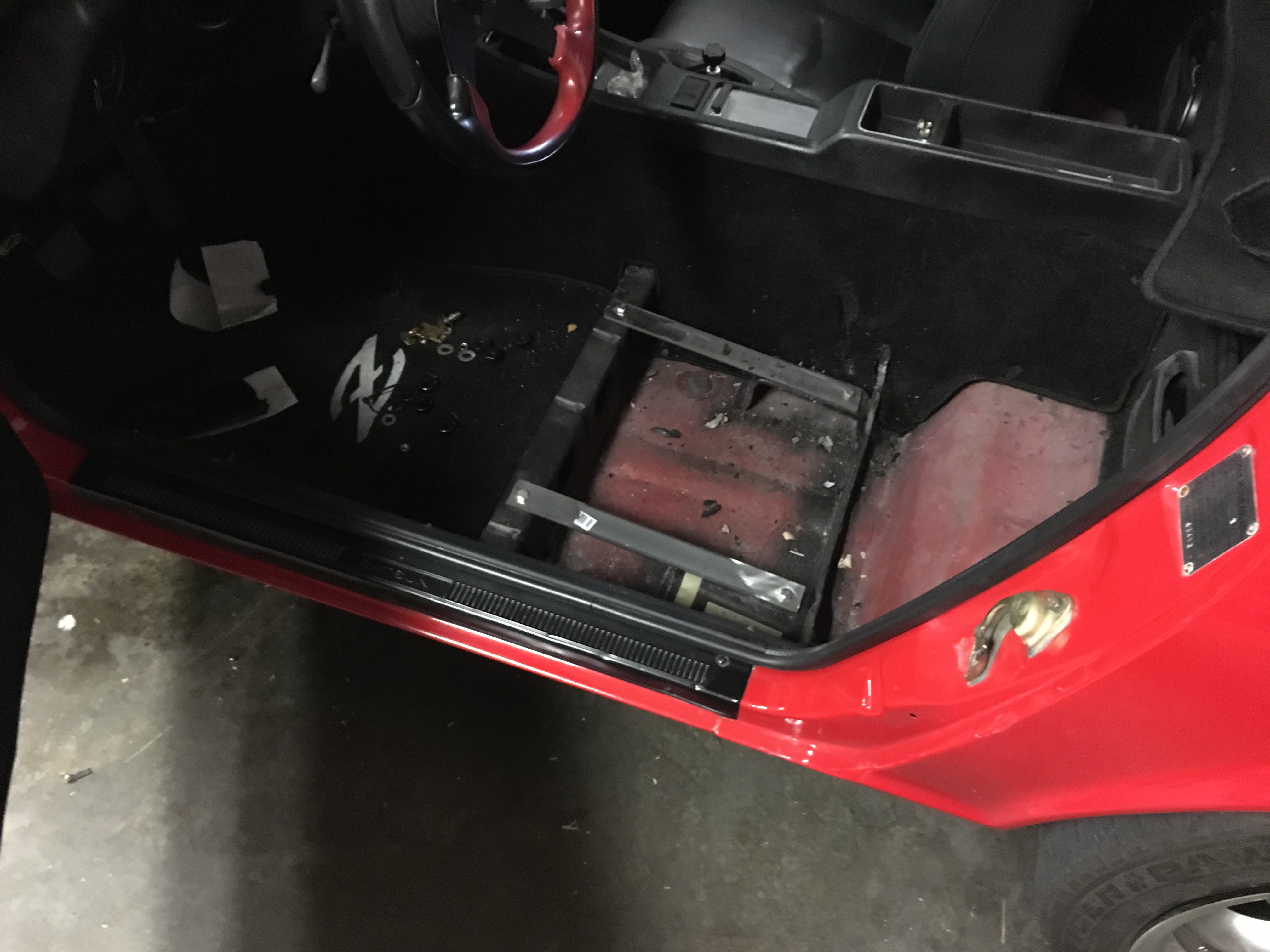

May 8, 20169 yr comment_494546 Steve, did you take any pics of the seat mount adapters you built? I haven't got to it yet but I will have to do the same thing. Yeah the Wesco inertia reels are really touchy, everyone who gets in the car gets the warning, " Now pull your seat belt out VERY slowly" Chris Link to comment https://www.classiczcars.com/forums/topic/54393-seat-upgrade-350z-seats/?&page=5#findComment-494546 Share on other sites More sharing options...

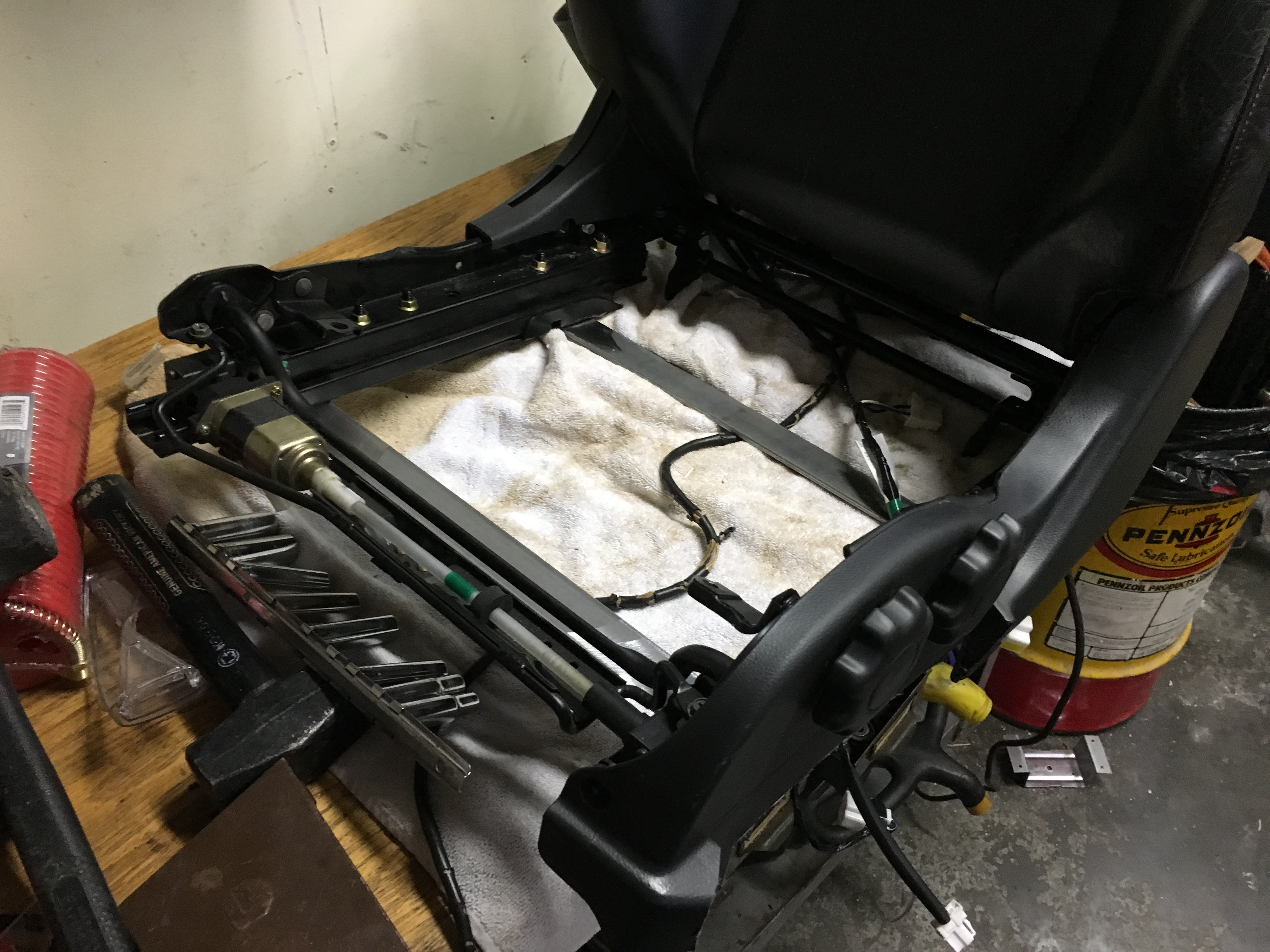

May 8, 20169 yr Author comment_494549 Well the uploader finally worked. You can see I had runners 3/16" flat stock from mount to mount and horizontal to go seat frame side to side. That was all welded together to make the mount brackets and of course welded to the seat frame. I need to pull them back out for paint and will take more pics Link to comment https://www.classiczcars.com/forums/topic/54393-seat-upgrade-350z-seats/?&page=5#findComment-494549 Share on other sites More sharing options...

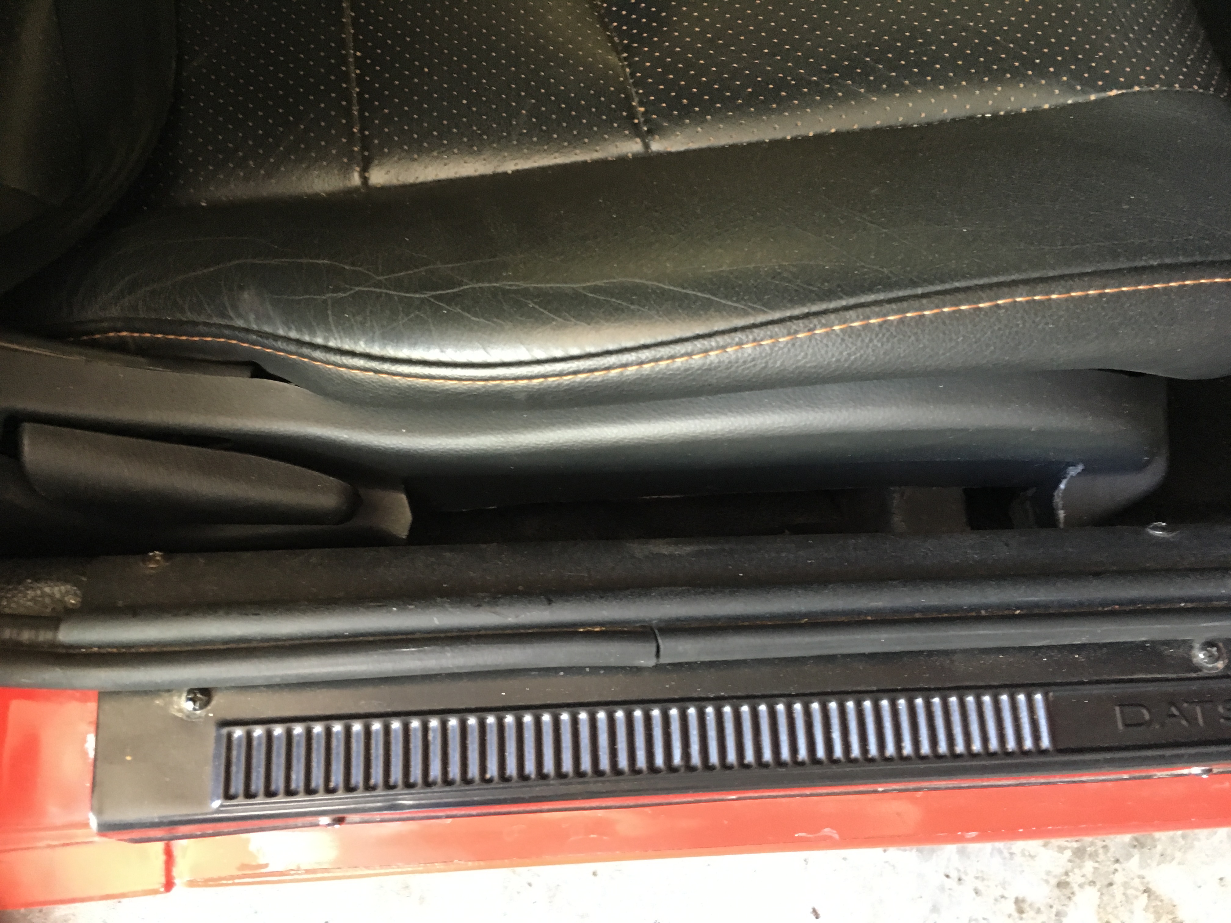

May 8, 20169 yr Author comment_494550 Another successful upload!!! you can see what I trimmed in this photo Link to comment https://www.classiczcars.com/forums/topic/54393-seat-upgrade-350z-seats/?&page=5#findComment-494550 Share on other sites More sharing options...

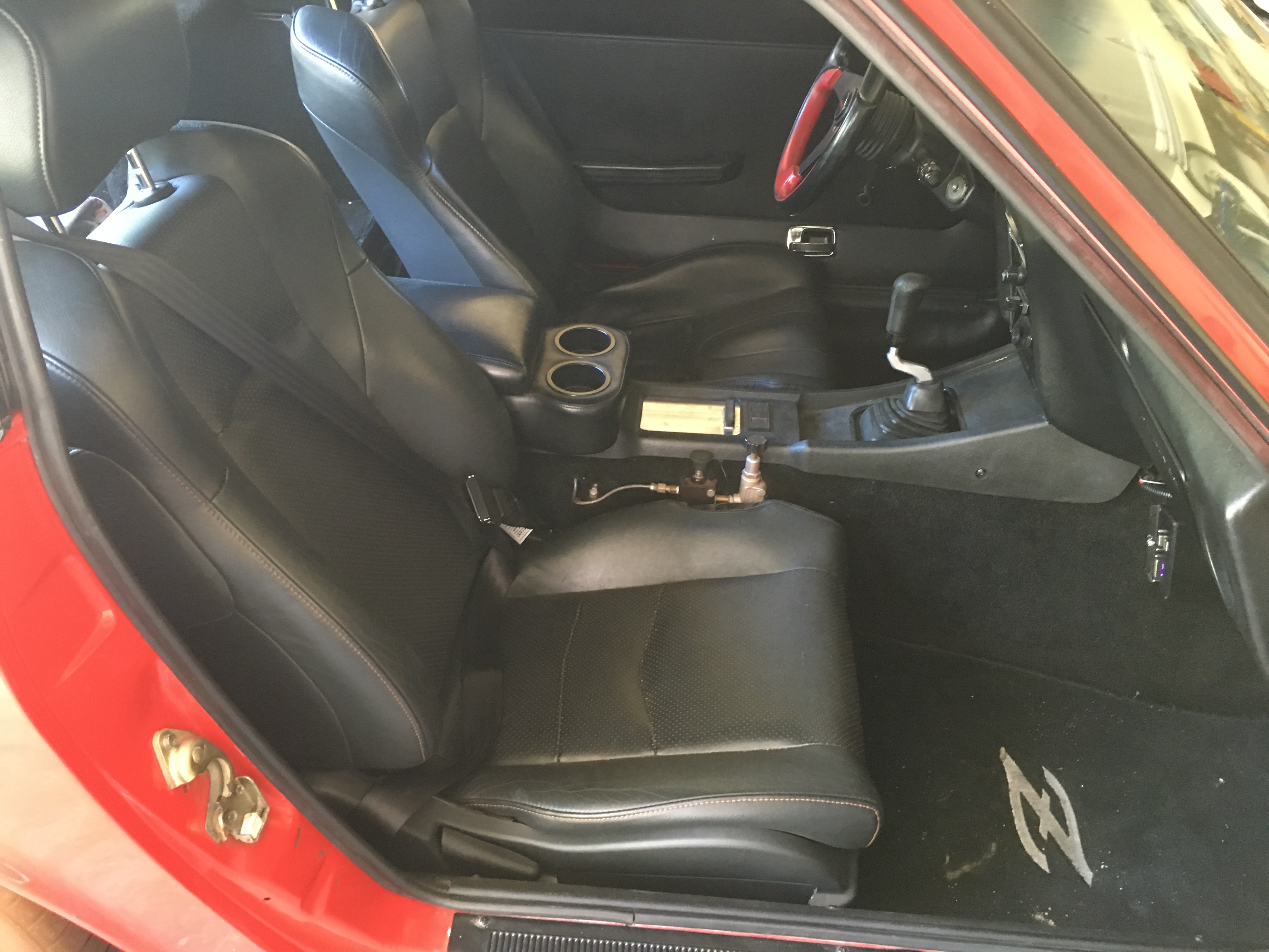

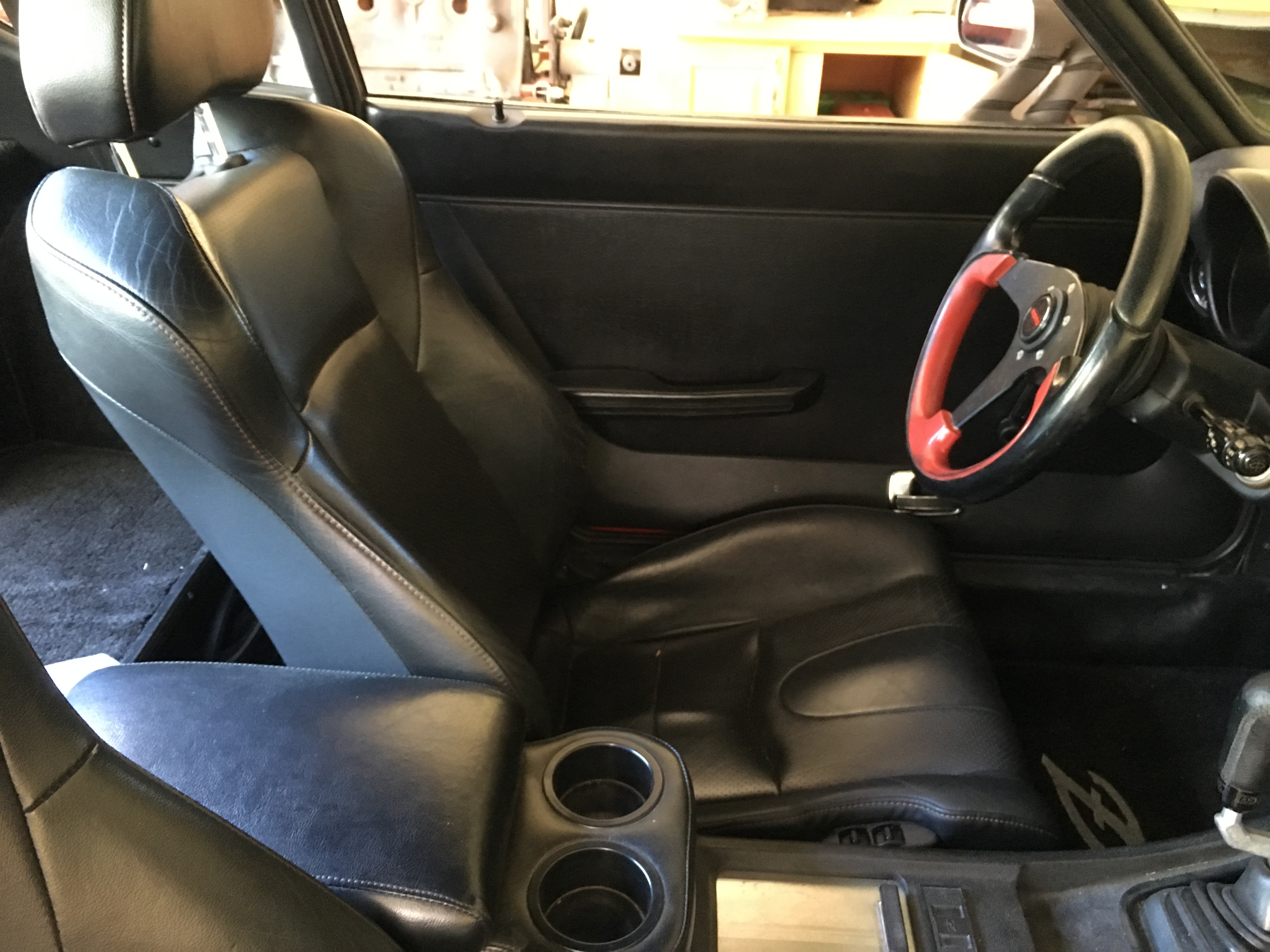

May 8, 20169 yr comment_494552 Love it, clean and simple. Is that a second adjustable knob on your brake proportioning valve? Link to comment https://www.classiczcars.com/forums/topic/54393-seat-upgrade-350z-seats/?&page=5#findComment-494552 Share on other sites More sharing options...
May 9, 20169 yr Author comment_494558 Parking brake and proportioning valve . Another obstacle to overcome with these seats. Link to comment https://www.classiczcars.com/forums/topic/54393-seat-upgrade-350z-seats/?&page=5#findComment-494558 Share on other sites More sharing options...
May 9, 20169 yr comment_494572 Madkaw - Those seats are awesome and look like they belong in there! I think the curves and style of those seats fit well with the 240z interior. Link to comment https://www.classiczcars.com/forums/topic/54393-seat-upgrade-350z-seats/?&page=5#findComment-494572 Share on other sites More sharing options...
May 9, 20169 yr comment_494585 Agreed. Those look very nice. Link to comment https://www.classiczcars.com/forums/topic/54393-seat-upgrade-350z-seats/?&page=5#findComment-494585 Share on other sites More sharing options...
June 8, 20214 yr comment_623029 On 5/8/2016 at 7:03 PM, madkaw said: That was all welded together to make the mount brackets and of course welded to the seat frame. Madkaw, I started on my seat project. I have 350z power seats. Iām worried about welding the frame to the seat tracks. There are plastic parts inside the tracks and thatās a lot of heat. Advice? Link to comment https://www.classiczcars.com/forums/topic/54393-seat-upgrade-350z-seats/?&page=5#findComment-623029 Share on other sites More sharing options...
June 8, 20214 yr Author comment_623031 Be careful? As you can see from my pics I had to take the seats apart to do this. Don't remember melting anything . I've slept too many days to remember specificsĀ Link to comment https://www.classiczcars.com/forums/topic/54393-seat-upgrade-350z-seats/?&page=5#findComment-623031 Share on other sites More sharing options...
