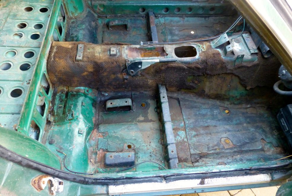

The only fly in the ointment that I can see are those little braces behind the rear seat mounts, I'm pretty sure that Nissan didn't start putting those in until late 1971 so... a third car is involved or maybe just it's floor pans, the plot thickens.
Just checking which little brace you're referring to. Do you mean the strip that crosses the entire floor pan and connects to the back of the rear mount pads and ties them to the floor?
I had no idea that was not there in the early cars! I have 8570 here right now, it has it. No surprise they wanted to ad more strength to these mounts though. The 280's seat mounts were 2-3 times stronger than the 240 mounts.
I had no idea that brace was not always part of the original design, but apparently it was not by this picture of #00051. I found it in the flickr album pointed to in this BaT link:
http://bringatrailer.com/2013/11/21/bat-exclusive-the-18th-earliest-surviving-datsun-240z/
@Gav240z shared this link in post #13 of this topic.
My 7/70, car 06521, does have those braces, I wonder when they were added?

my car is 01955 and it doesn't have those little braces so I doubt #72 would have it either.
From the pics that GeoJoe posted on the OntZCar forum you can see what could be a weld line running the length of the transmission tunnel, so could just be floor pans cut out of a later car.

Definitely got into #72 via the floor donor. I'd feel obliged to remove it!
Looking at the latest photos posted here (which are quite hi-res), you can see the full weld line.  As Chris notes, it's most obvious along the transmission tunnel. It runs to just aft of the aforementioned later-style floor brace, then across to the sill (notice that the floor kick-up behind the floor brace features the Series 1 tie-down tabs for the jack and tools).  Going forward, it looks like the join line between the inserted floor and the native structure runs along the bottom of the toeboard.  Looks like a pretty sanitary job, actually.  I wonder if #60 and #72 were both Alberta cars, or whether they found each other here in Ontario?  I would suppose that #60 may have been the victim of crash damage or a fire.  Floors this good wouldn't have come out of a rust-bucket.

1) I dont remember where I got the replacement floor pans but it was from a wrecked car- no idea of the actual year. Could have been a 71/72??
No biggie, it fit and was rust free so I bought them and had them professionally welded in. I was very happy with the job.
