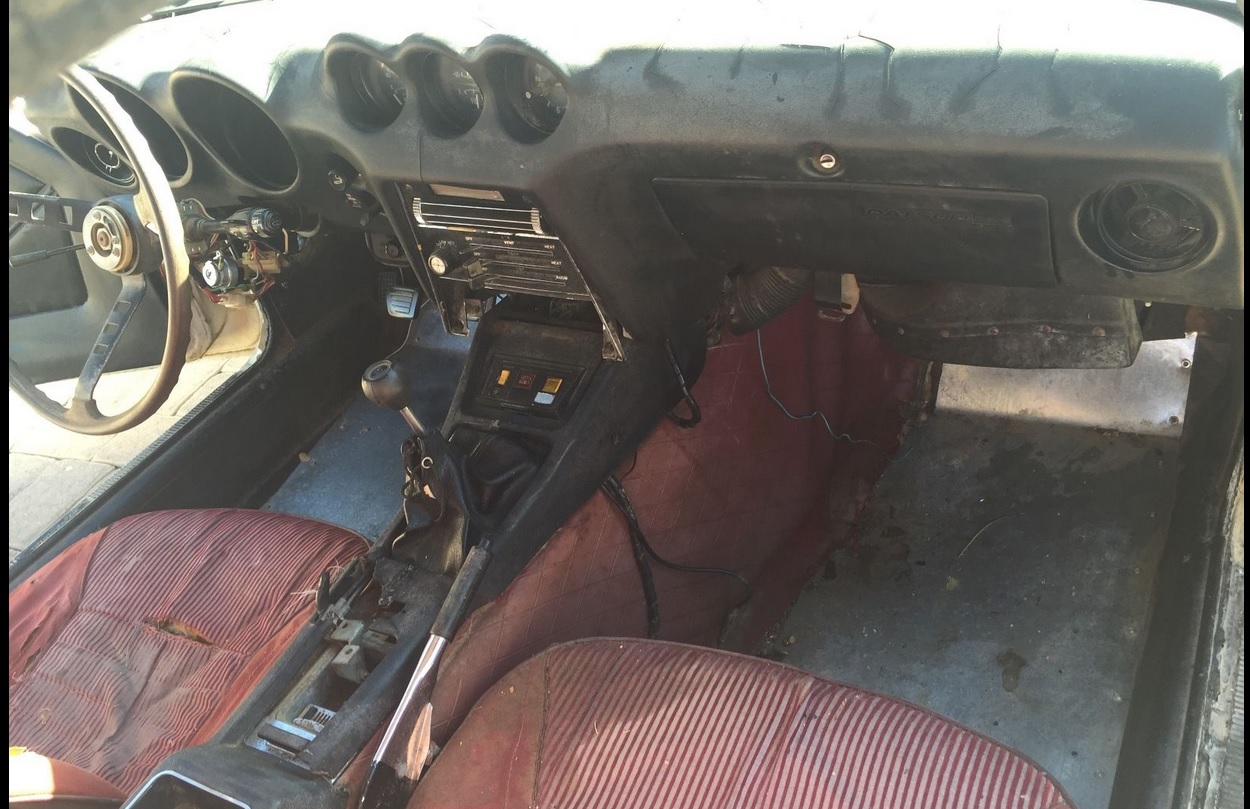

Which do you think applies here? This car is currently up for sale on an auction website.
"Only rust on the WHOLE CAR is a VERY small amount on the floorpan(could cover completely with less than a dollar bill)"

Trust but verify applies, I think.  Technically, it may be right.  The word disingenuous applies here.  It's an indirect form of lying.  Post the link to the site so we can see who the liar is.
Are those sheet metal screws?  Watch your head.

Ok, could apply too.  " I swear I never saw underneath those patches. That's work from the previous owner" LOL
No i'de rather not identify this individual. This is more of a humours poke at the ad's out there on the auction websites.
But my god how can you not notice those shiny new floors?

I'm not sure if any of those terms ("exaggeration", "lie", or "disingenuous") really apply here. From my experience the people selling Z cars have very darkly tinted rose colored glasses on. I've gone to look at probably twenty cars for sale and the story was pretty much the same at all of them. The owners don't see the car as it is right now... They look at it and picture how nice it could be if it were fixed.
So my read on the statement "Only rust on the WHOLE CAR is a VERY small amount on the floorpan(could cover completely with less than a dollar bill)"
Means "There used to be a lot of rust on the car, but it was all in the floor pans which have been replaced. So now that the floors have been replaced, the only rust is a small amount on the floorpan."
Of course, we experienced Z owners know that the rust you can see is a tiny amount of the total rust that you CAN'T see, and if the floors were so bad that they had to be replaced, then there are guaranteed to be other significant issues to be found if you poke in the right spots. But maybe (just maybe?) the seller hasn't that same level of experience.
So maybe I'm giving them too much leeway, but I don't see it as dishonest... I see it as inexperienced.
And just in case anyone wonders what I think about the cars condition...
I see a dash that has been sun baked and baked and baked. And baked.
Covers on the seats hiding who knows what!
Wrong shift knob (and missing the emblem to boot).
A center console that has been cracked up.
A wiring nightmare with hacked harnesses, splices and wires hanging everywhere.
Steering wheel missing parts, Clamshell gone and wires exposed.
Typical peeling vinyl on the scuff plates and rotted weatherstripping.
Looks like the radio has been forcibly removed.
Maybe even a theft recovery?
So my read on the car is that it was driven hard for many years in a very sunny humid part of the world and put away wet. Now it's someone's half finished project where they pop-riveted homemade floor pans in it and then kinda gave up on the project because they lost interest or money, or both. And it may have been stolen and recovered in there somewhere.
