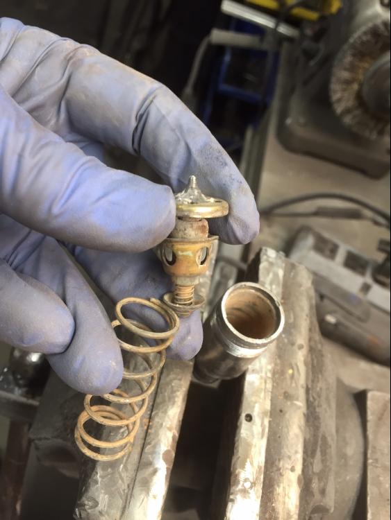

Hah!  Gentlemen, we have closure! :D   My manifold heat thermostat now performs perfectly.  Here's what I did (after the four-hour soak in C-L-R, of course):
The little adjustment screw and locknut that appeared to be seized together forever were, in fact, soldered together.  If you look closely at my #3 photo above, you'll see what appears to be a shiny-silver, crowned nut.  It was only when I put my micro-torch to it and saw things starting to melt that I realized the truth.
  • I broke the nut free from the (brass/copper) top plate first using a 4mm box-end wrench and then backed it off about one full turn.  Then I tackled breaking the adjustment screw free from the lock nut.
  • I rigged things up in my bench wise so that both thermostat housing and box-end wrench were anchored and could turn and so that the wrench couldn't lift off the nut when I tried to turn the screw (sorry, no pix -- not enough hands).  That left one hand free for the torch and the other for the screwdriver.
  • You need to find a screwdriver whose blade fits tightly in the slot on the end of the adjustment screw.  Otherwise, you'll round out the slot and it'll be 'game over'.
  • Heat with the torch until the solder melts enough for the screw to turn within the nut.  Then turn the screw in until you use up the available adjustment.
  • Now, put the torch way and turn the re-locked screw-and-nut with the box-end wrench until the nut snugs up against the housing's top plate.
  • With a small-dia. pin punch, push Item #6 ('Supporting Plate') down against its spring a few times, just to make sure it's moving freely.
  • Now test in a big pot of boiling water, using the test method mapped out in the FSM (see Zed Head's posting, above).  Do NOT accidentally suck boiling water up the hose into your mouth! :P
  • Assuming that your 'hot' test is successful, now dunk the assembly in cold water and verify that the valve re-opens.
  • Re-solder the screw/locknut pait to each other and to the housing's top plate.
  • Have a beer to celebrate your now-ready-for-action, 40-year-old, NLA-anywhere, 'Manifold Heating Thermostat / Switch' !

Alrighty. Found my stash of these valves.
Discovered there two slightly different ones, the cap on two are aluminum, the others are steel. All bodies are all aluminum. I took the cap off one of the aluminum ones, the threads didn't survive. Took one steel cap off, no problems. Clean threads. All my valves are plugged with deposits, but they disolve quickly with Muratic Acid. CLR is slow for sure.
Since the aluminum capped one is toast, I attempt to extract the guts. Success! Came right out. I used a set of bent nose c-clipp pliers as a pin wrench. Just twist until it gives. Now I can clean and rebuild the interior bits.
Can't see why most of these wouldn't be restorable as long as body threads are good and the inside bits are badly corroded.
One more observation. The fluid sealing cone is metal, likely brass. It seals against a tapered section of the body. No way this would ever made a perfect seal. Note the FSM statement above in the test proceedure about "little or no bubbles". Makes sense now.

Great photo, zCars.  Now we have a full understanding of what lurks inside the little cylinder.  Not sure if I'd be willing to try that if I only had one thermostat at my disposal.

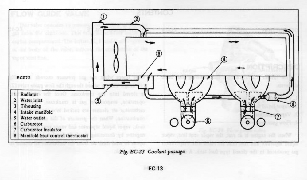

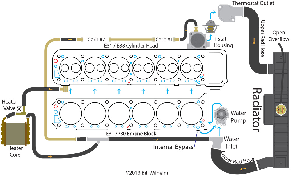

Good investigation, guys. I'm also puzzled about the "direction of flow" issue. Since the water pump normally sends coolant through the engine, thermostat, radiator, and back through the water inlet, I thought with the thermostat closed the coolant would go through the manifold, manifold heat control thermostat, and around to the water inlet, in that order. Where does the coolant come from if it's going the other way? Seems like position of heater valve might have something to do with it, if the heater's in the loop.
Regarding the cavitation issue, seem to remember seeing a little metal tube going around the front of the engine, connecting to a barb on the water inlet, on 280 Z's. Don't think there's a hot=closed thermostat in that line, but wondering if it's to reduce cavitation when the thermostat's closed.
I planned an experiment  (after reading the HybridZ thread a couple years ago) running a clear line from the outlet on the rear of the head to the lower outlet (OK, inlet) on the thermostat, just to see which way it flowed, but the "clear" high pressure silicon tube that I ordered wasn't clear enough to see flow direction, so I abandoned it.
Perhaps a beer will clear my thinking....
I saw Namerow's comment on flow direction but didn't ponder it deeply.  If direction was determined form the test procedure , maybe that's where the question develops.  Direction for testing probably wouldn't matter.  The flow diagram shows flow from the housing, through the manifolds, and to the water pump outlet.

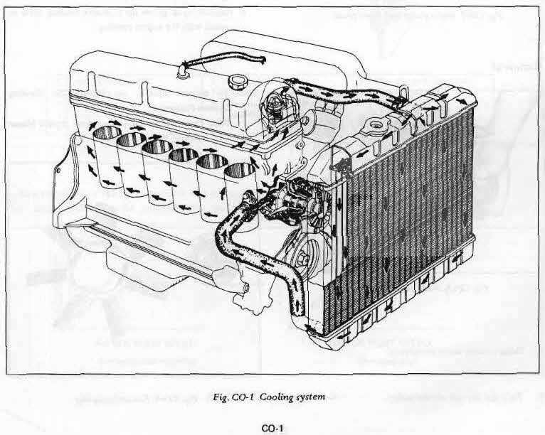

@ Zed Head and Stanley...
You're right, I'm wrong.  I was tricked by a my too-quick look at a different coolant diagram that appears right at the beginning of the '72 FSM's Cooling System section (see Fig. CO-1, below).  While re-visiting my notes, I found a nice flow diagram (copyright credit to Bill Wilhelm) that Blue posted some time ago - also re-posted below.  It provides some additional insights.  All in all, though, Fig. EC-23, is certainly the definitive one when it comes to figuring out how the Manifold Heating circuit works.  Specifically, until the main (rad) thermostat opens, the Manifold warming circuit is active.  Coolant enters and exits the main thermostat through the base of the main thermostat's housing.  Intersting that Fig. EC-23 was included in the Emission Control section rather than the Cooling or Fuel sections.  Maybe the tech writers at Nissan just treated the Emission Controls section of the FSM as the dumping ground for, 'little gizmos that nobody understands'.
I think the point still stands that if the Manifold Thermostat is stuck open (or removed), then the manifolds and carbs are going to be seeing some degree of heating even after the engine has reached normal operating temperature.  That is, unless pressure differentials change when the main (rad) thermostat opens, so that the flow through the manifold heating circuit is reduced or stopped.  The only way to tell would be try a different version of Stanley's aborted experiment by replacing the rear transfer pipe with some kind of clear tubing.
